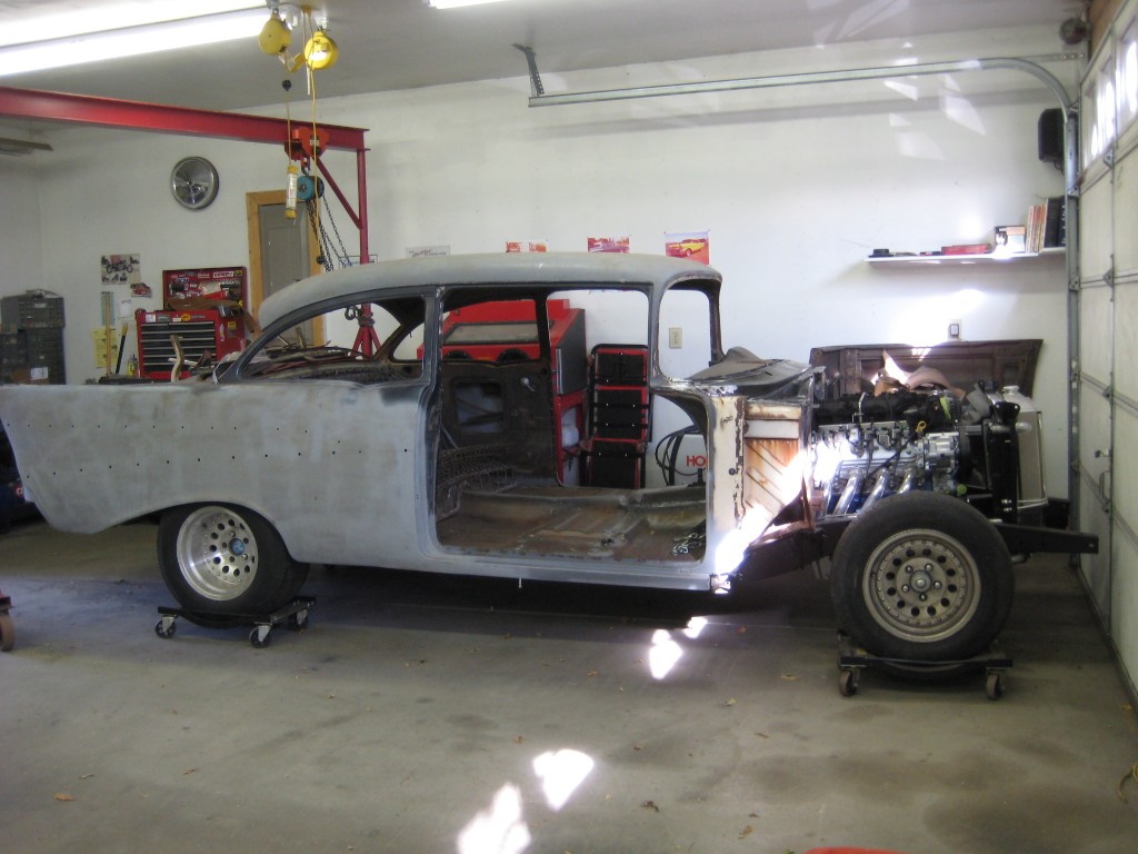

Adding a couple more pics of progress. The motor and transmission in for the last time!!

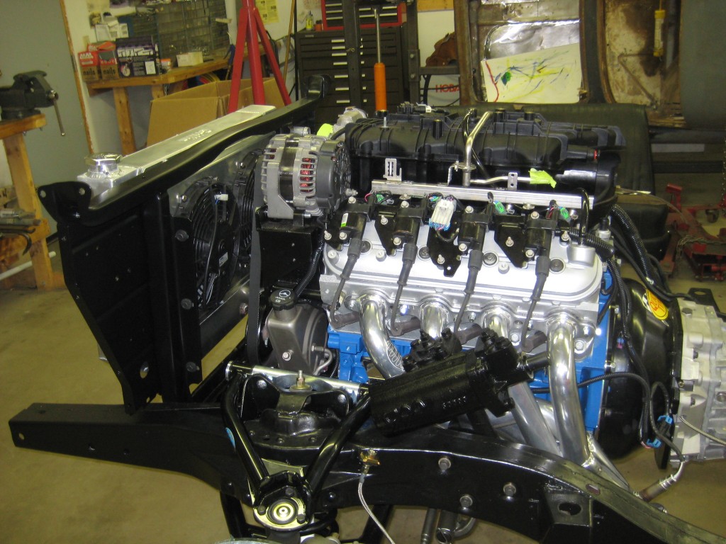

Added the headers, o2 sensors, AC pump and brackets, core support and radiator assembly.
-- Edited by bwild70ss396 on Sunday 26th of June 2011 04:39:48 PM
Start putting scratches in things now or you won't want to drive it...
Very clean build, Brad...

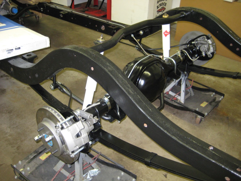

Brad - I'm using the same/similar rear calipers... Not to be the bearer of bad news, but looking at the photo (and not knowing your setup) it appears you've got things bolted on incorrectly.
The calipers and axle tube plates/mounts need to be exchanged side for side, and re-mounted with the calipers rearward - with the hole for the e-brake cable pointed forward.
(This shouldn't impact your hard line install, as the flex line will just go rearward, instead of to the (now) front.)

John after further investigation, you are correct. I will have to see how much I have to modify them to go on the correct way. Meaning putting Chevy parts on on Ford rear end. I guess thats what I get for a no directions, no clue how to do it deal and first time doing it. I dont think I would have noticed until I tried to hook up the e brake cable. The brakes would have functioned correctly.
On a happier note, I finally found a sway bar that will work and someone who would measure the end link center to center so I could get a front sway bar to connect to my control arms. Most kits are for stock lowers aand you have to drill the end link brackets or mount holes. I am glad its the same brand as my rear one. The first Hellwig one was to narrow.
-- Edited by bwild70ss396 on Saturday 16th of July 2011 12:40:48 PM
-- Edited by bwild70ss396 on Saturday 16th of July 2011 12:45:11 PM
It was a easy swap to change calipers and brackets around. Only some minor paint scrapage to be fixed later.

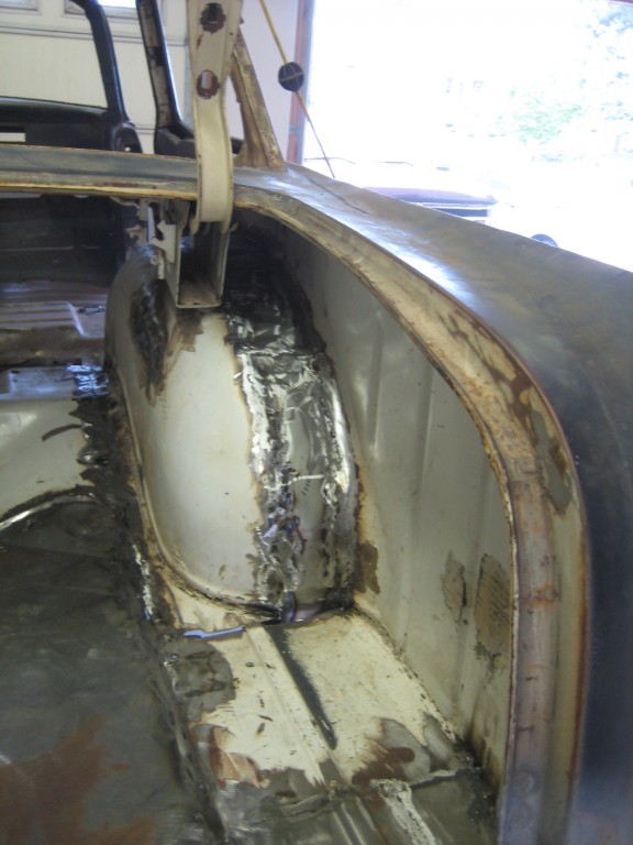

I have made some progress with one side of the mini tub. Its taking alot longer and being more complicated then planned on. Having fun welding panels with remnents of paint and undercoating that I could not get all the way off in the corners.
The fun of welding old, dirty metal. It'll all look great when it's done...

One side pretty well done and starting on side two. Hopefully no foreign particals in my eye this weekend to impeed progress! Made it past goggles and everything!

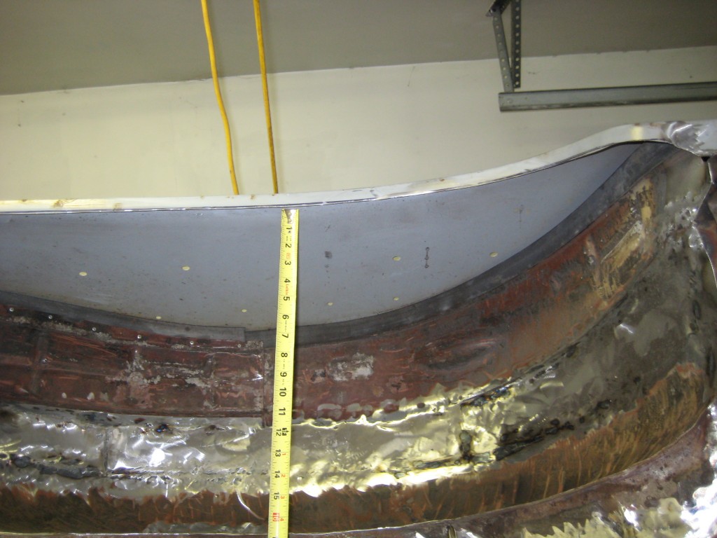

16" is a lot of space to fill! What are you going to run for tires & wheels?

At the front and back of the wheelwell it narrows to about 15" or so. I am planning to purchase 333/35/17" for the back on a 17"x11" rim. In the Pilots that size is about 13.5" wide, so about .75 clearance both sides I am hoping for? Does that sound like a nice amount? What I did was make the wheelwells what ended up being about 1/2" more narrow then the frame rails in back. I just went off a old article in a magazine called Classic Chevy and thats what it looked like they did. The Tri-Five forum also has a few guys that have done similar.

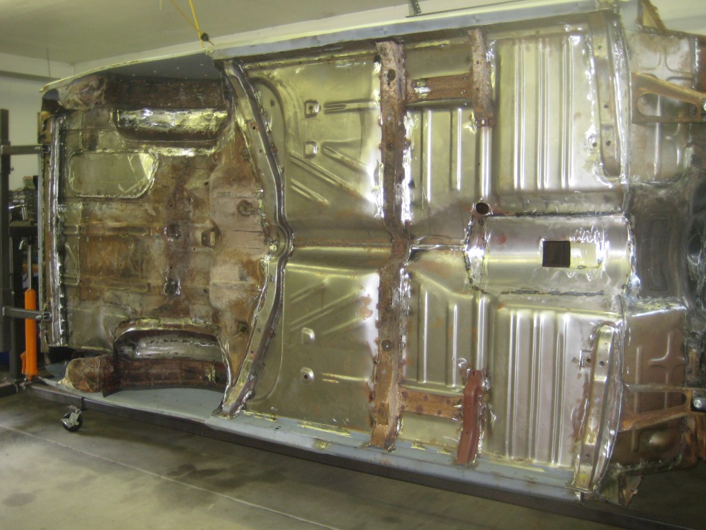

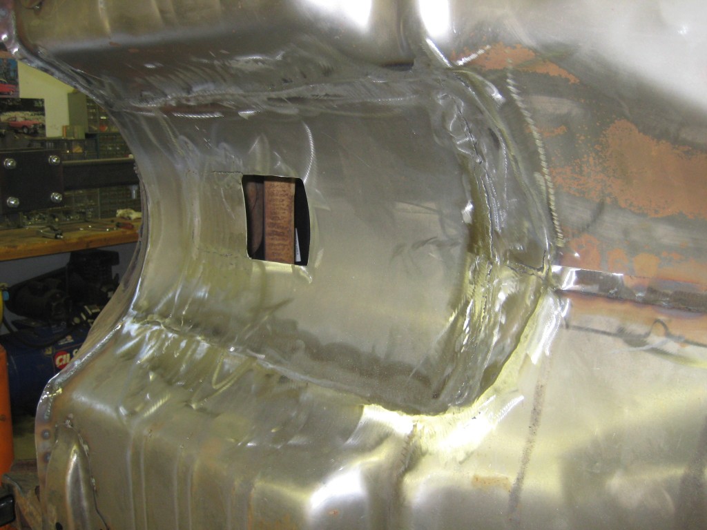

With the trunk patch coming a little late I redirected to work on the firewall a bit for some plugging of about 40 or so holes. It still needs alot of work, but it should look good when done.
I included a shot of the one of two found bullet holes! I am guessing while it resided in Texas it was used for rifle practice!
I also put in a before shot of trunk floor area that I will be working on also
Looks nice. You must going with Vintage air, since you blocked off all the vents and heater.
I think any car that sat in a field for a period of time became a target for shooters. I know I've added a number of holes to old cars over the years...

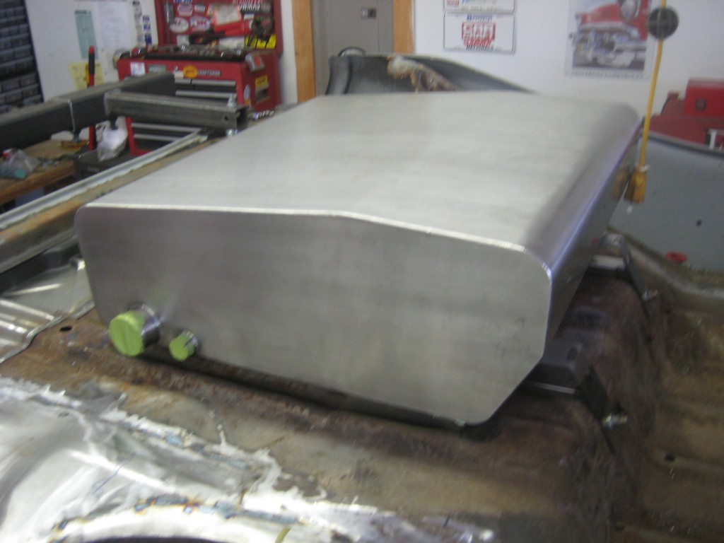

I am planning on going with a Vintage Air or Old Air system for heat and air conditioning. I also blocked of air vent tubes, wiper holes as I am going with a inside mount Raingear system, Throttle hole since DBW, Speedo cable hole since I while be running a wire, all holes for firewall pad since I will be using Dynamat or similar product, and clutch rod hole. I may have to drill that one back out for the hydraulic clutch system? I going to try to make most stuff more hidden if possible.

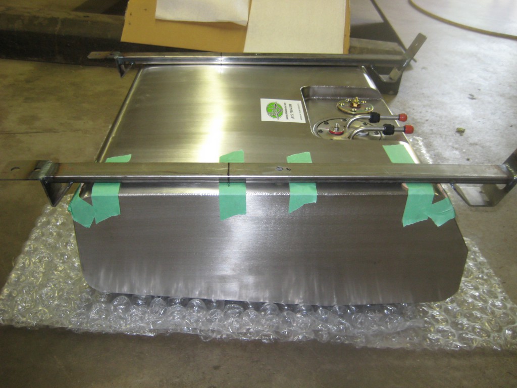

I am moving the battery also from core support to maybe between fender well and firewall area that the tube once ran through. I am checking into those newer small batteries.The picture if of other cars showing the area I am thinking about moving the battery too.

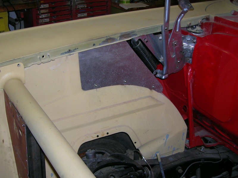

Made some tunnel mods for the 6 speed. It should fit no problem now. I may have to put curve mod in seat frame ? I have not check yet. A few pics of my hacking
A few pics of back panel / brace install and the rear seat fitting after back frame mods. Looks like seat will work out good. I am glad for a full rear seat.
Finished up on all the rear end stuff. Brakes, brake lines, modified sway bar and end links.

I am kinda partial to this tape measure pic myself!!!
helps make all the many hours and bodily injuries worth while!
-- Edited by bwild70ss396 on Friday 2nd of September 2011 09:02:49 AM

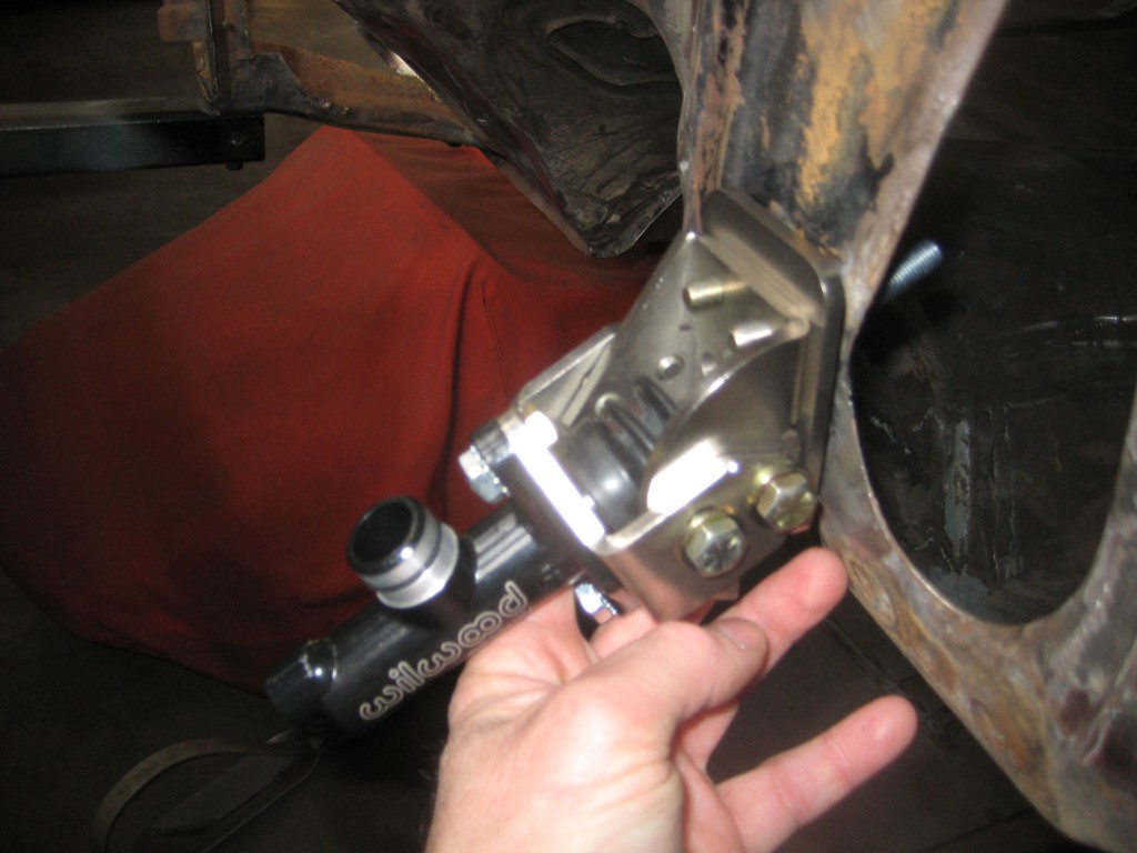

A few pics on progress, fitting Vintage air, fixing rusted glove box, fitting hyd clutch, cutting and fitting tank mounts and much grinding
