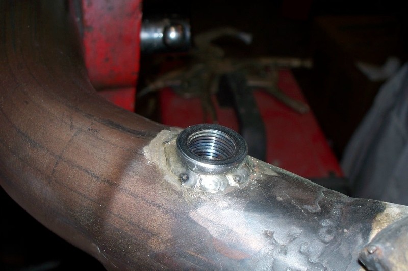

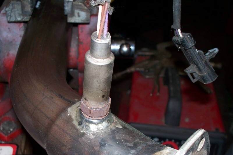

Some more progress pics... After marking my clearance issue points, and double checking the O2 sensor locations (for clearance and removal tool swing/access) I got the X-pipe assy. out from under the car. A little heat with the gas-axe and some love taps with a 2-pounder and the top of the pipe was flattened out a bit. Then on to the O2 bungs.
I ordered 2 mild steel bungs and 1 plug from an online outfit... www.o2bungs.com (catchy name huh, wonder what they sell? ). I don't need the plug, but I wanted it as a "sacrificial lamb" to screw in while I was welding. The last thing I needed was the threads to get bugger'd from heat or distortion. I used my Miller 100 MIG setup, with standard Argon/CO2 mix, on the "C" heat and about 4-1/2 wire feed settings.
The Pypes stainless has enough ferrous/carbon content to MIG pretty well, but it's vital to sand or grind off any scale and expose fresh metal before welding. A quick wipe with acetone before welding takes care of any oil contamination.
The X-pipe's back under the car, with fresh gaskets and the 02 sensors (with a liberal slather of anti-seize) screwed in. Now I've got to figure out how to get the E-brake working! I'm using the Caddy Seville calipers on the rear, and they require an occasional E-brake application to stay in adjustment. With the crossmember moving aft a few inches, the pedal cable and hook are in the wrong place. Dontcha love how one job snowballs into another??
John that was a great writeup. Sure made it easier putting them in the x-pipe and being able to work on it on the bench!
