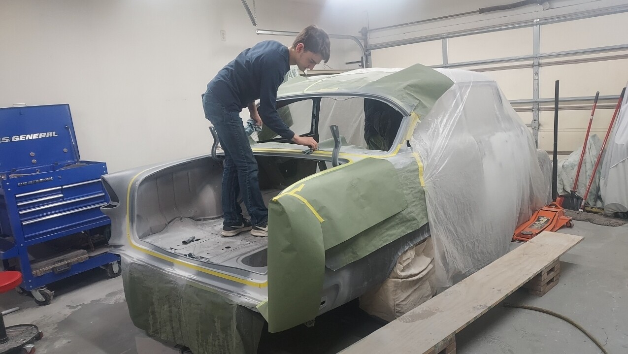

I wanted to get the sandblasting done on the shell before winter really set in, so he's been hard at it getting that all done. It uncovered a few more areas that need patching, but the blasting is done for now. The patches will need blasting again, but we can make pretty good progress on the car this winter in other areas if it gets too cold to blast outside. Time change and short days means we can only do outdoor work on the weekends now, so I'm glad to have that done.

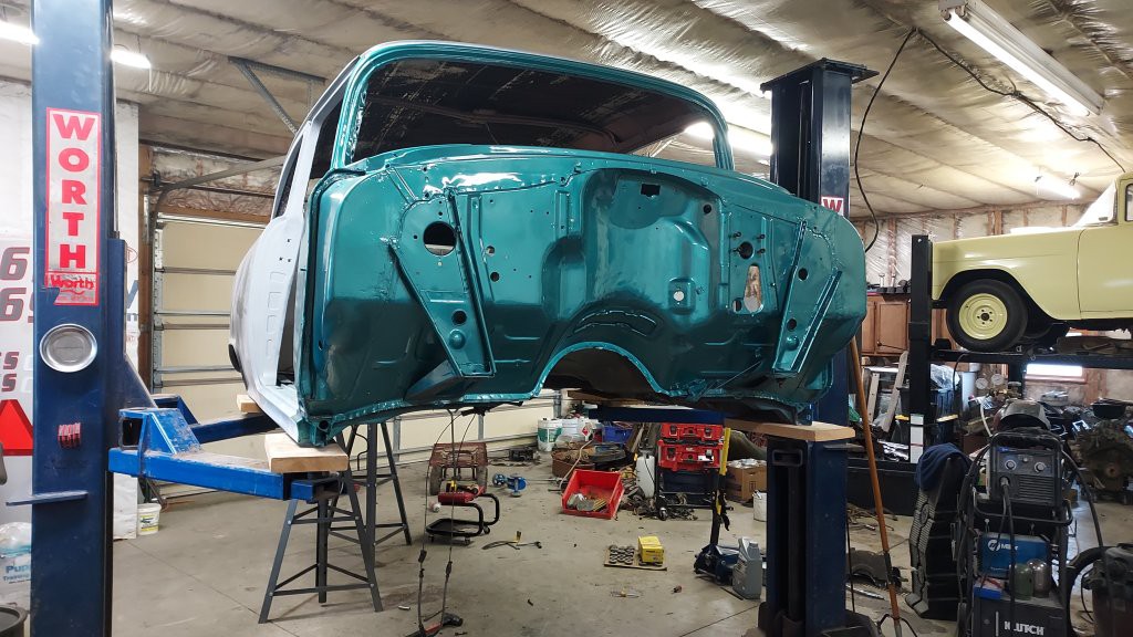

We got the whole car in epoxy primer, and I shot the jambs with high-build 2K.
We're starting body work at the dash and firewall so we can get paint on those, and start some assembly work as well... having some part look "finished" is always a good motivator for the rest of it.

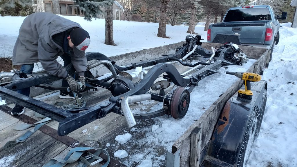

I've been slacking on the updates here... about 6 weeks ago, we bought this chassis that's all been rebuilt with new bushings, disc brakes, power-steering, new brake lines, sway bar, and a freshened up rear end, from a guy who turned his '56 Chevy into a gasser.
Should save a lot of time, money, and effort to make his car roadworthy.

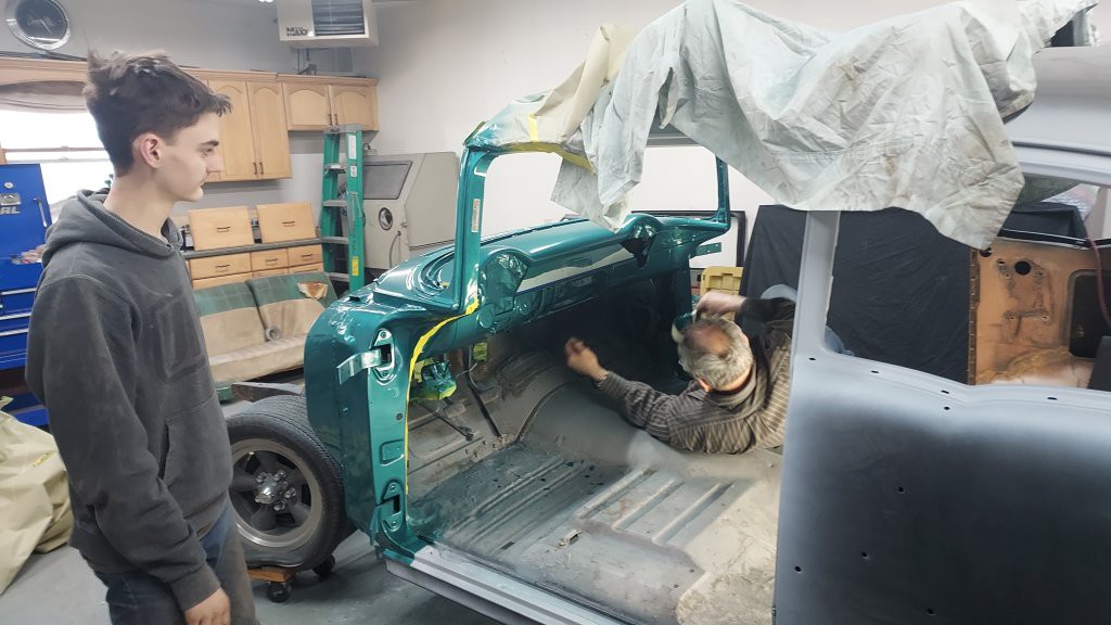

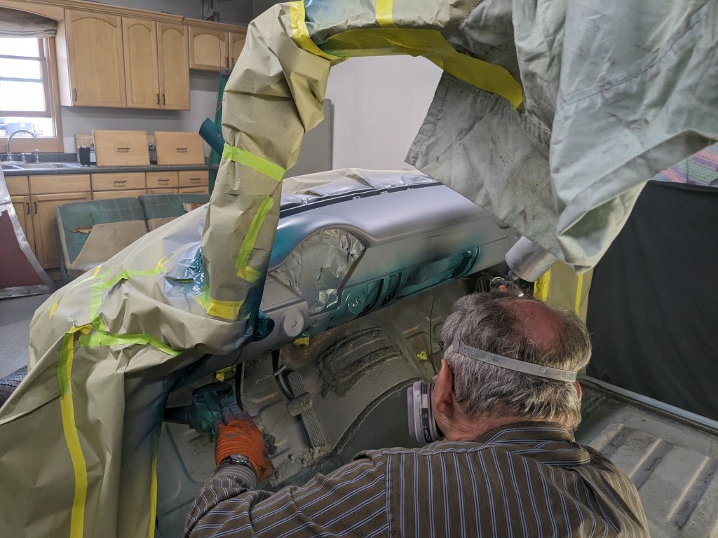

Since Cale has the week off for spring break, he asked Grandpa, a retired body-man who apparently works cheap for his grandkids, if he could come help work on his '55. Grandpa stayed with us for 3 days.

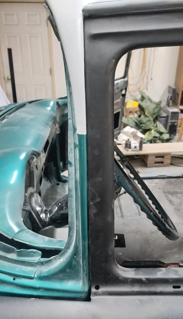

(Monday) Day 1, the center of the dash is now painted.
-- Edited by Derek69SS on Thursday 23rd of March 2023 08:44:07 AM
BUT how can he not want to continue the bodywork over the summer. I'd be so pumped, I'd be out there until Midnight until it was ready for the next paint.
Working on getting the Camaro bodywork to the point of final SPI sealer/primer by summer and MAYBE in paint.
That chassis IS going to save a LOT of time and cost. Beautiful looking work on it.

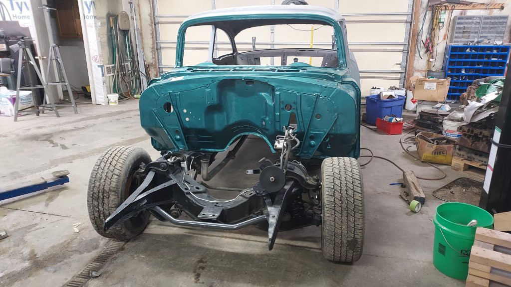

In order to get Cale's new chassis indoors without taking up any more space, a quick frame swap was in order. With the body in-place, he can figure out where to place the engine and trans mounts, and maybe get an engine out of my way too.
Looks better instantly with those wheels/tires and a clean painted frame.
I have a tubular conversion kit for side mount engine install if that is what he/you decide on. Bought it for one of the past projects that never got off the ground. Engine mounts bolt directly to it, in place of the frame stands.

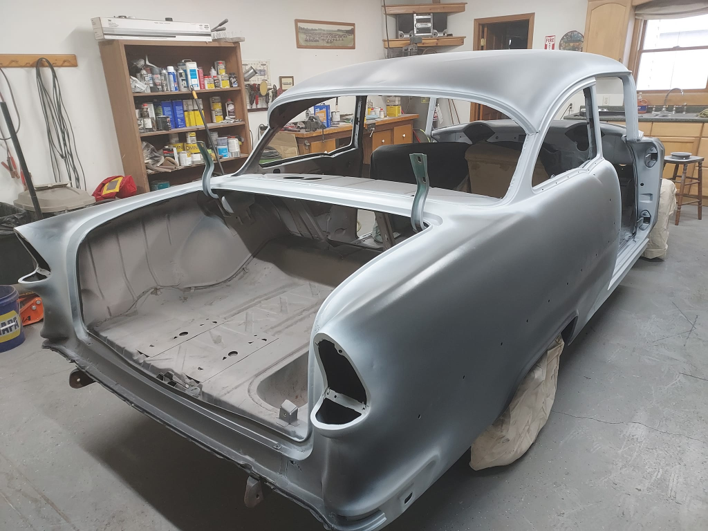

I've had a lot of people asking about progress on Cale's 55.
During race season, I knew we wouldn't get much done on it, so we stored it for the summer and finally moved it back into the shop around the beginning of December.

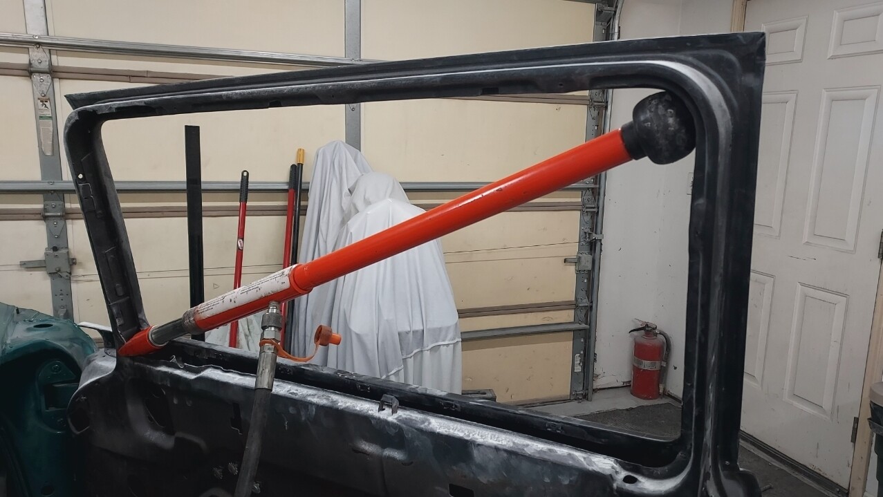

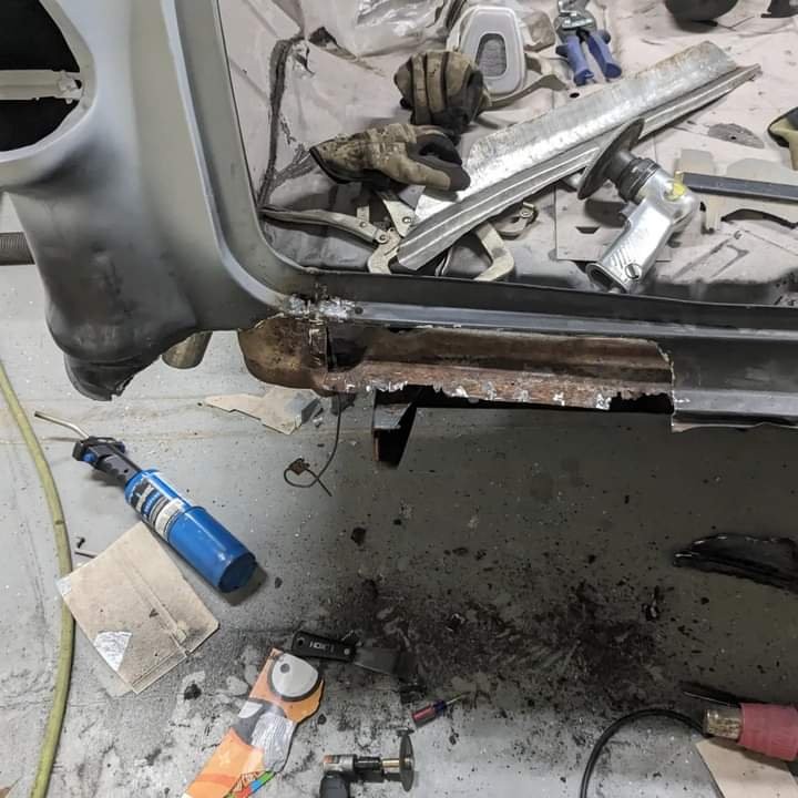

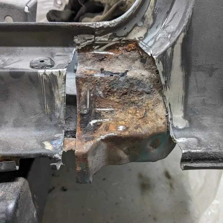

Cale got a bit too aggressive sandblasting some deep pits behind where the emblem goes on the hood, and blew holes in some thin spots, so we cut out the area and made a patch. He also cut a hole for a hood scoop, and used some of that metal to shave the hood-bird... he went a little too fast welding, and warped the hood quite a bit. We're going to need to do quite a bit of hammer and dolly work on it, but it will turn out fine. I made a lot of these same mistakes when I was his age.

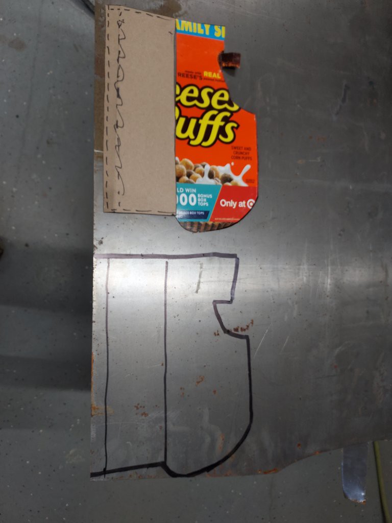

The last of the rust issues on the body that we're going to address is the panel between the trunk and bumper. He made the patches, and then I hammered on them for a while to make them fit better... he'll get them tacked in tomorrow night then we'll test fit the trunk lid before finish welding them.
Christmas break is coming up soon, so hopefully he'll make some real progress in the next couple weeks.

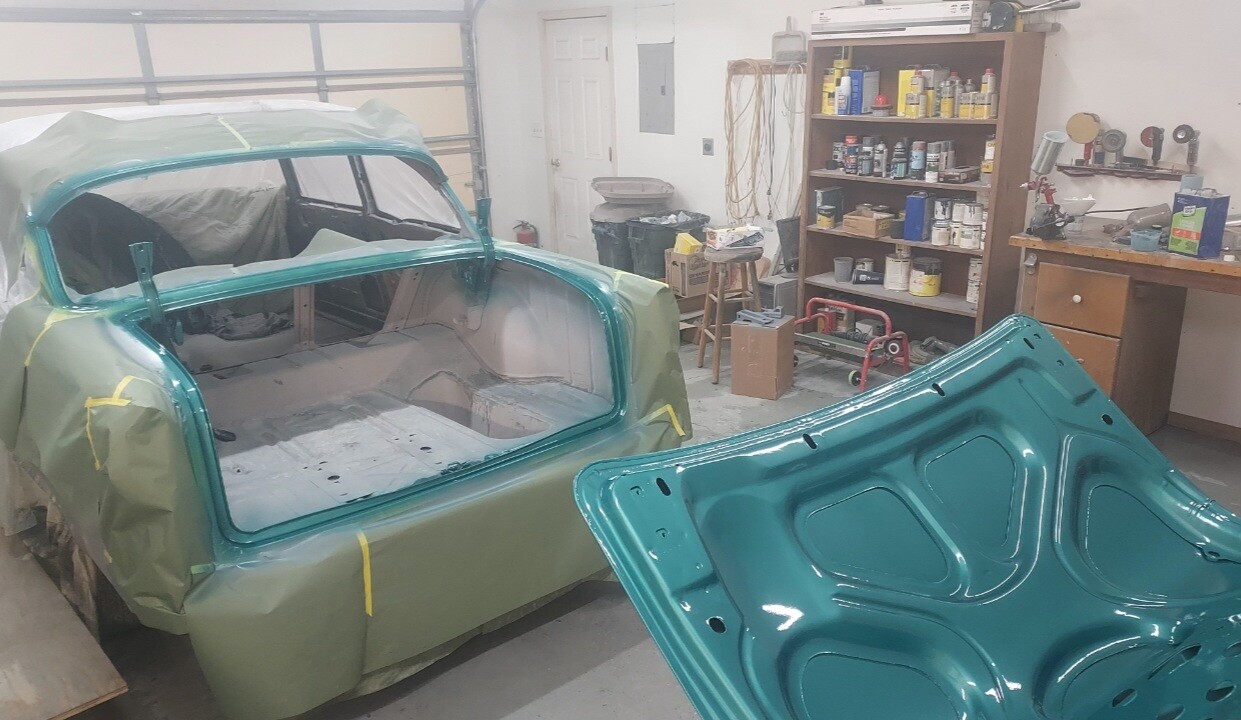

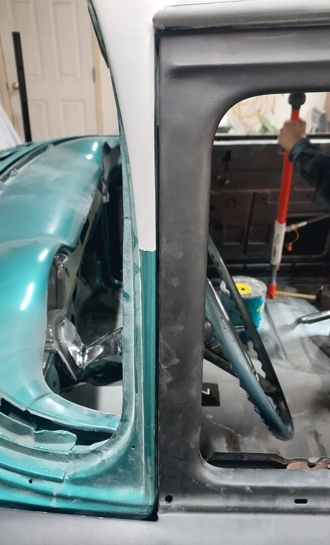

Karl, the jambs and dash are Omni MTK Acrylic Urethane single stage. We will use base/clear the body when we get to that. I'll do some spray outs first to tint the basecoat if needed.
I like to do the stages for the reasons you mentioned. The downside is it's more effort to mask when moving on to a different area, but it's nice having the trunk lid installed and gaps aligned for the final time. It's ready for its final wet sand, and is one less part that needs to be stored that could get knocked over, dropped, or damaged.

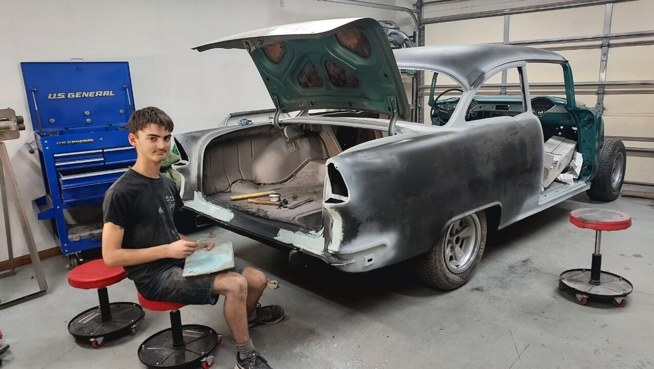

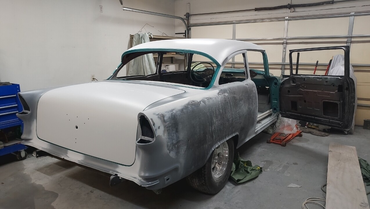

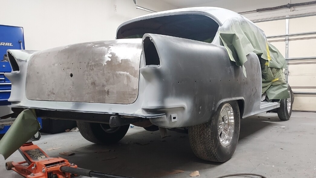

Saturday we put the trunk lid back on and aligned the gaps for the final time and moved on to gapping the doors. Both doors had window frames that were not square to the roof pillars. These were pretty easy to flex into shape.
We're not going to do high-end SEMA car level gapping perfection, but it should look a lot better than these cars ever were from the factory.

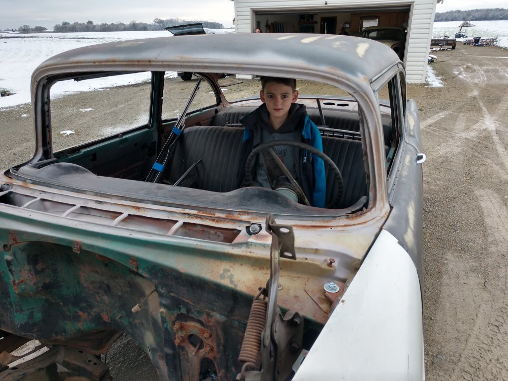

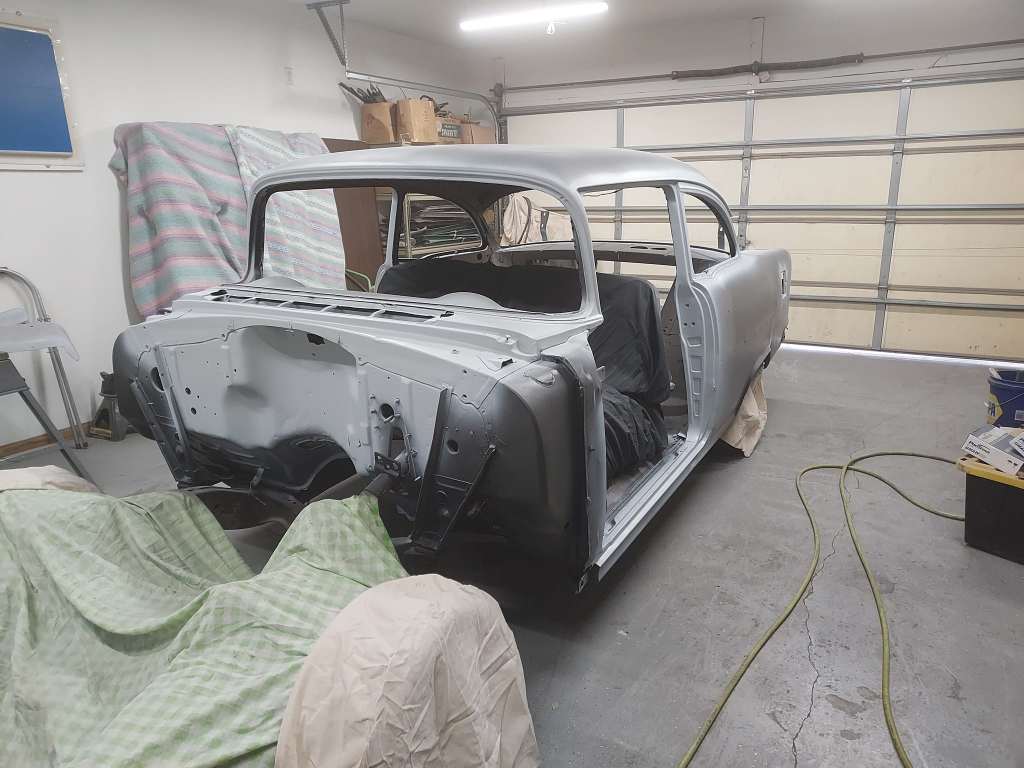

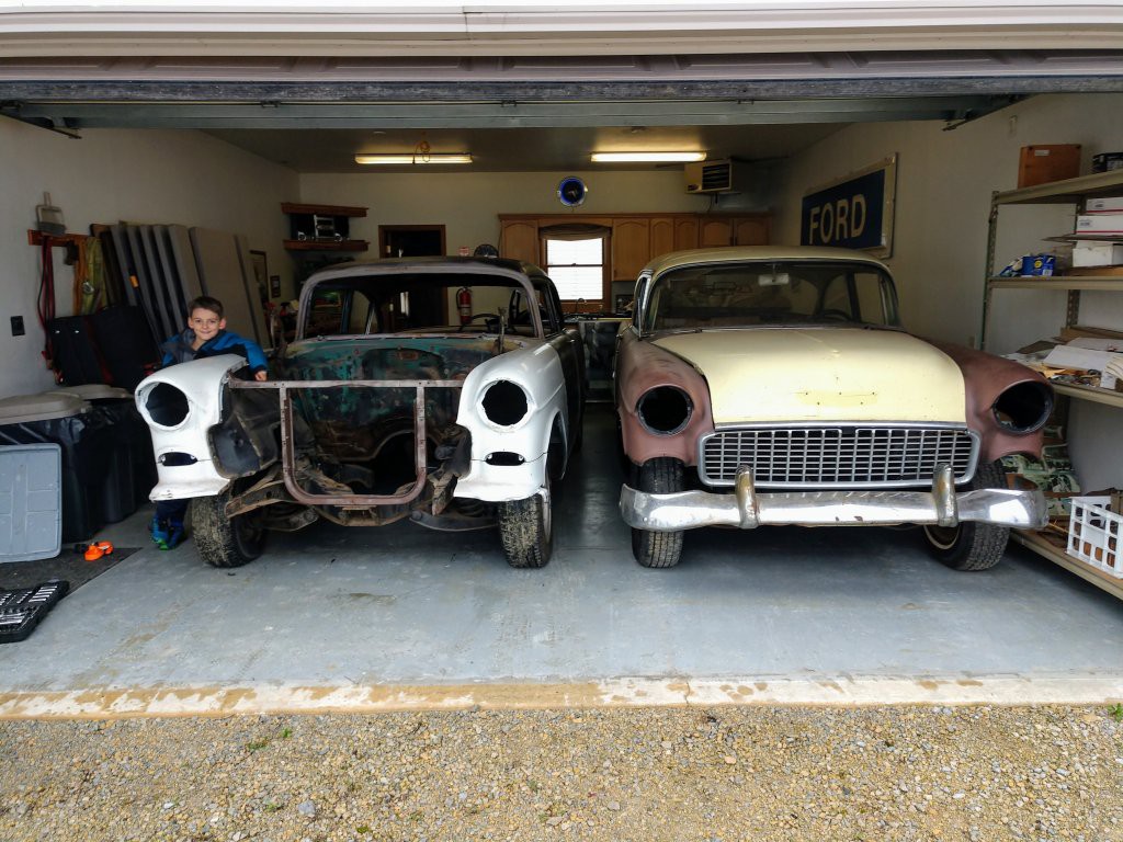

Figured I'd share here a project we're working on...

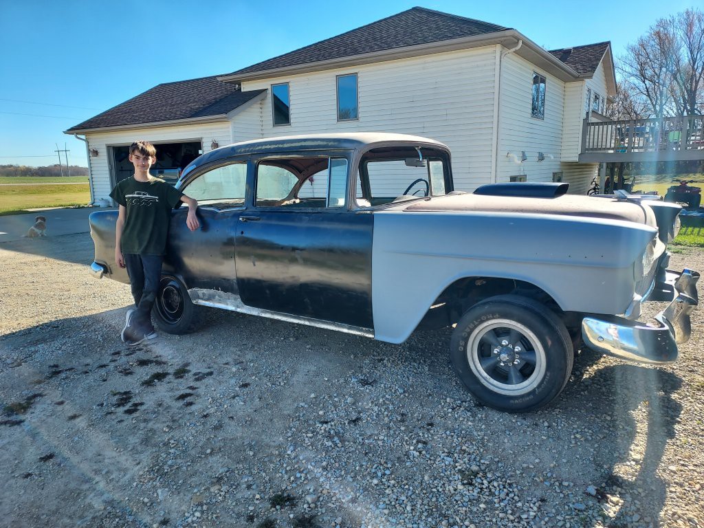

When he was 10, I helped Cale buy a '55 Chevy 210 2-door sedan basket-case project car.
It was originally Neptune Green with turquoise interior, 6cyl 3spd. It's a pretty solid car, but has a few rusty areas.
I have a '55 210 2-door sedan also, so my extra parts will go a long way toward making this one complete.
-- Edited by Derek69SS on Monday 28th of November 2022 09:22:58 AM

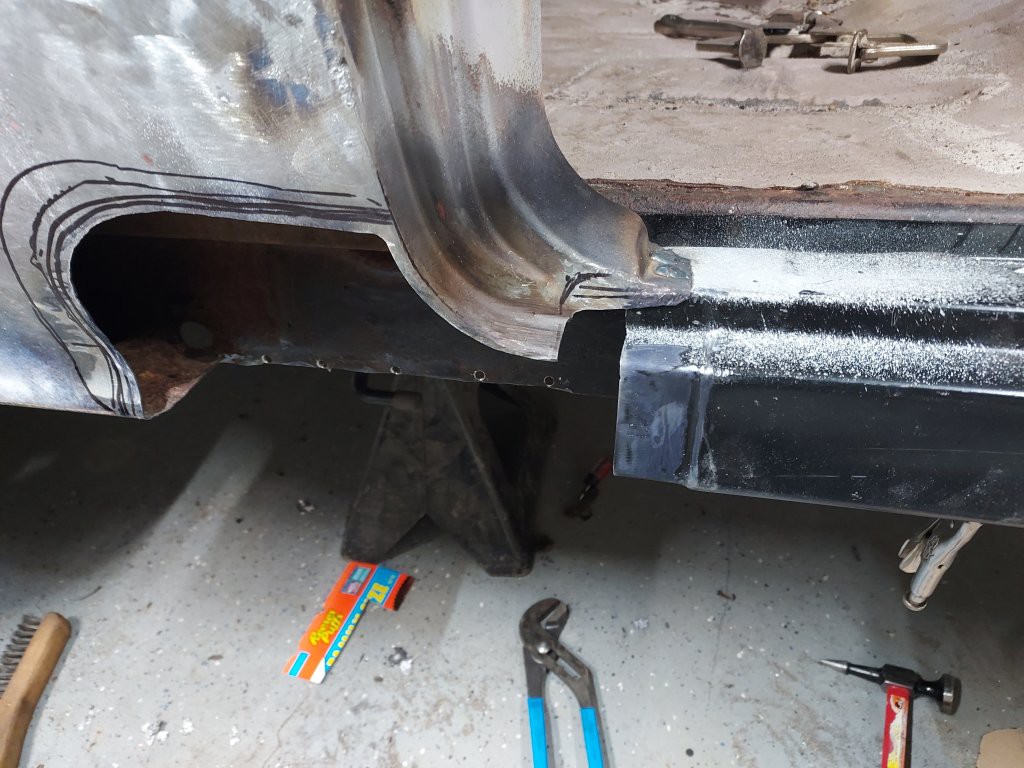

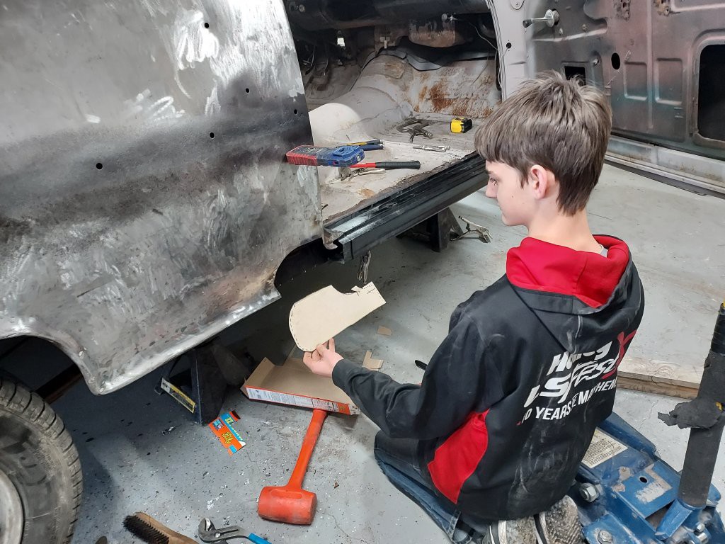

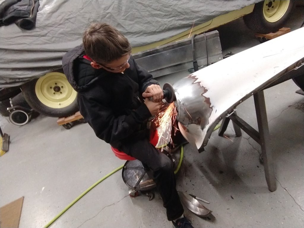

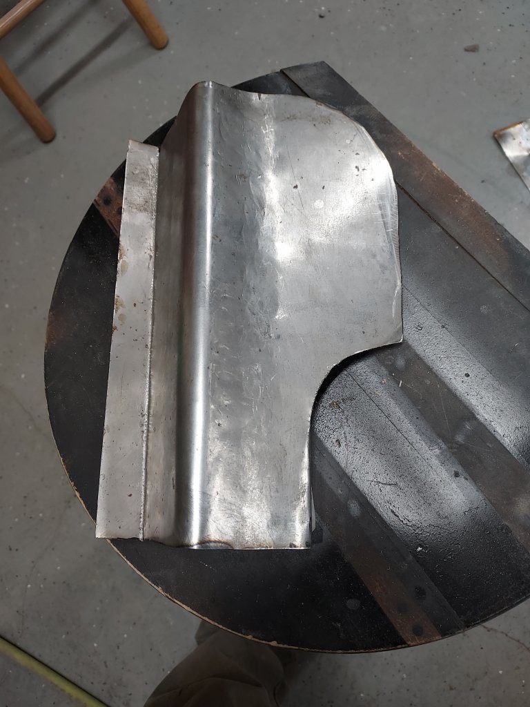

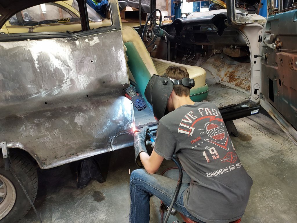

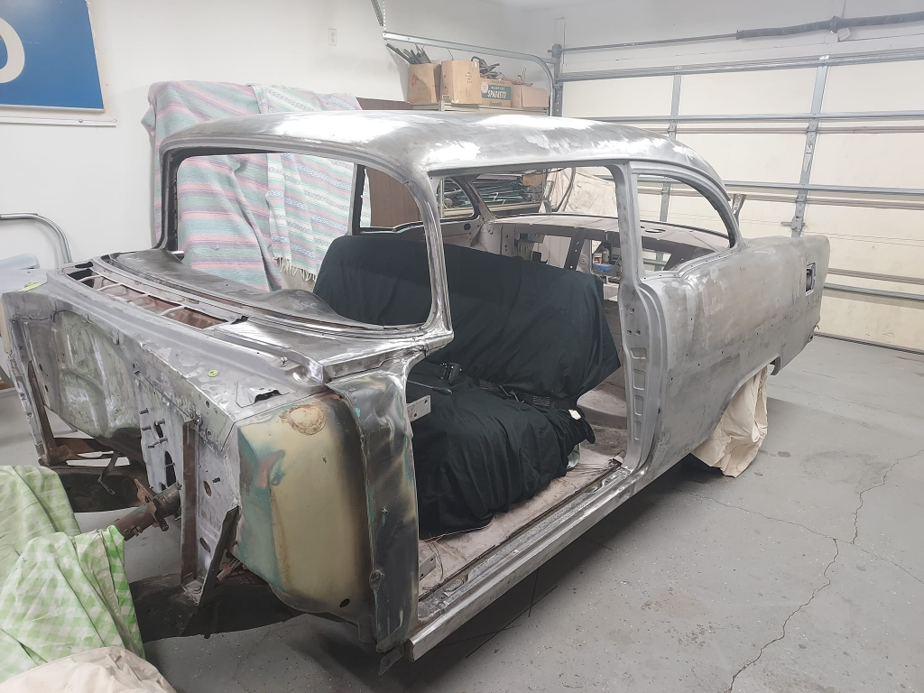

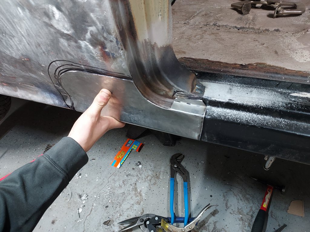

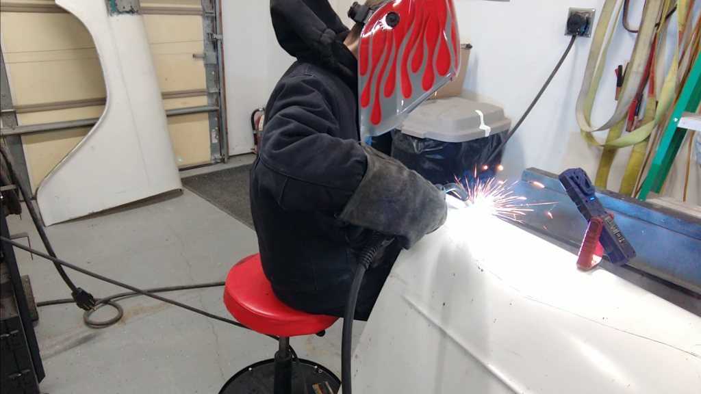

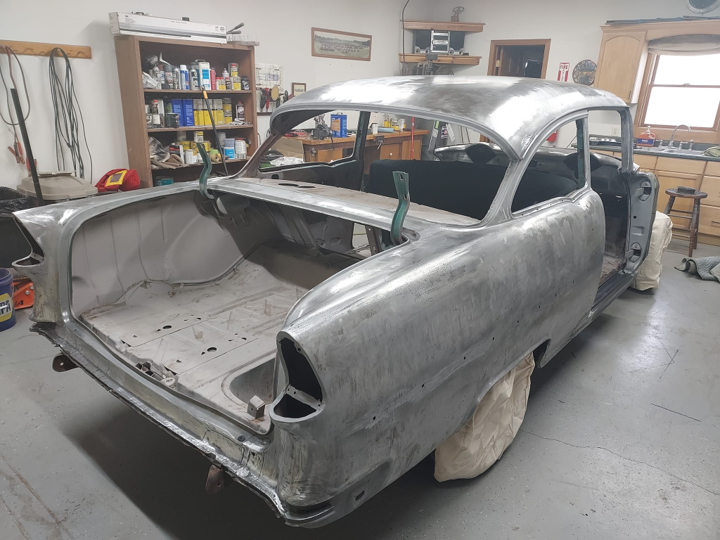

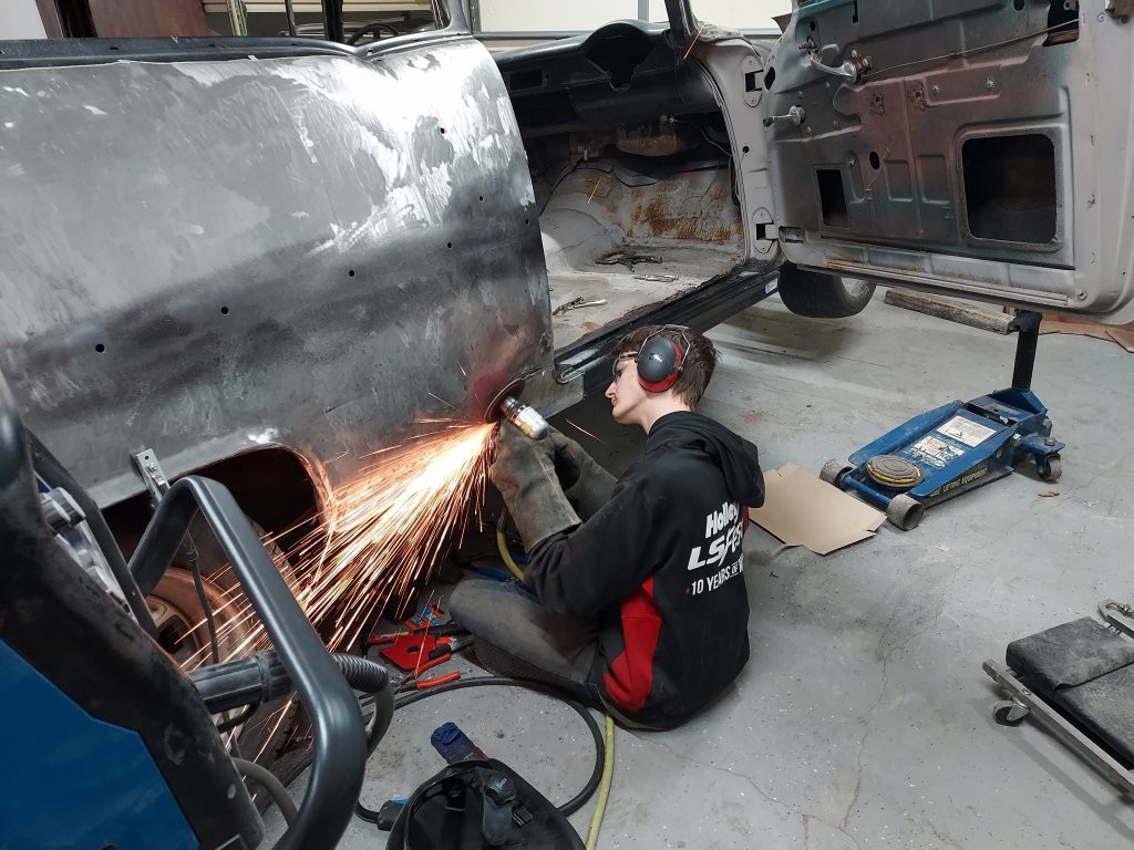

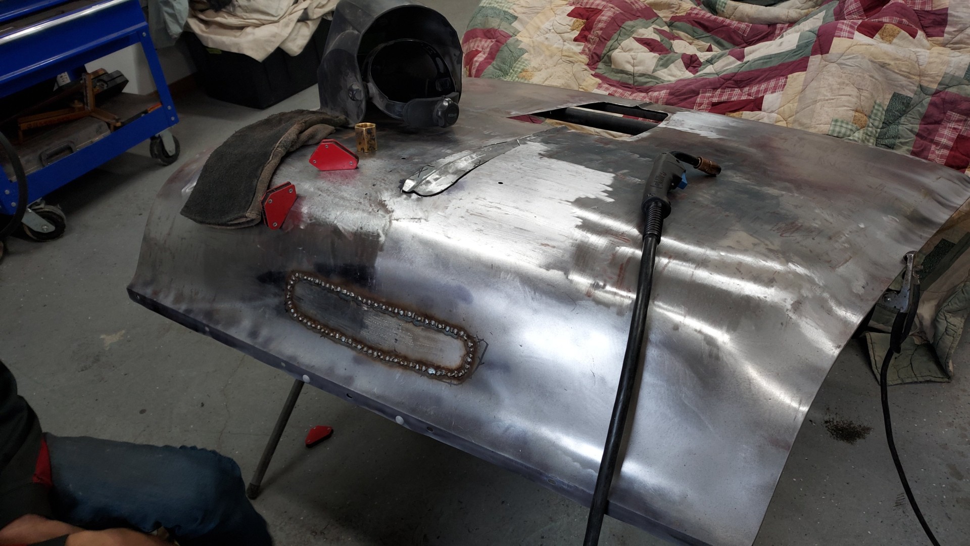

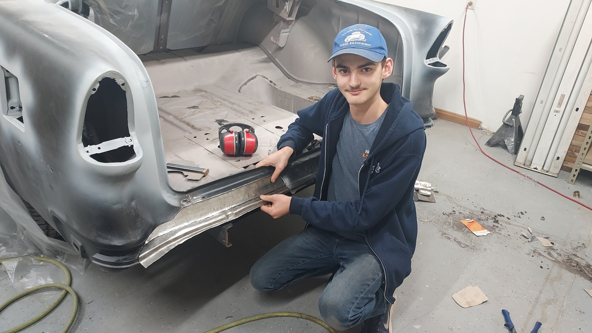

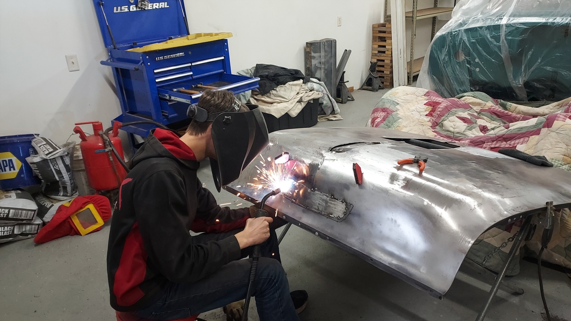

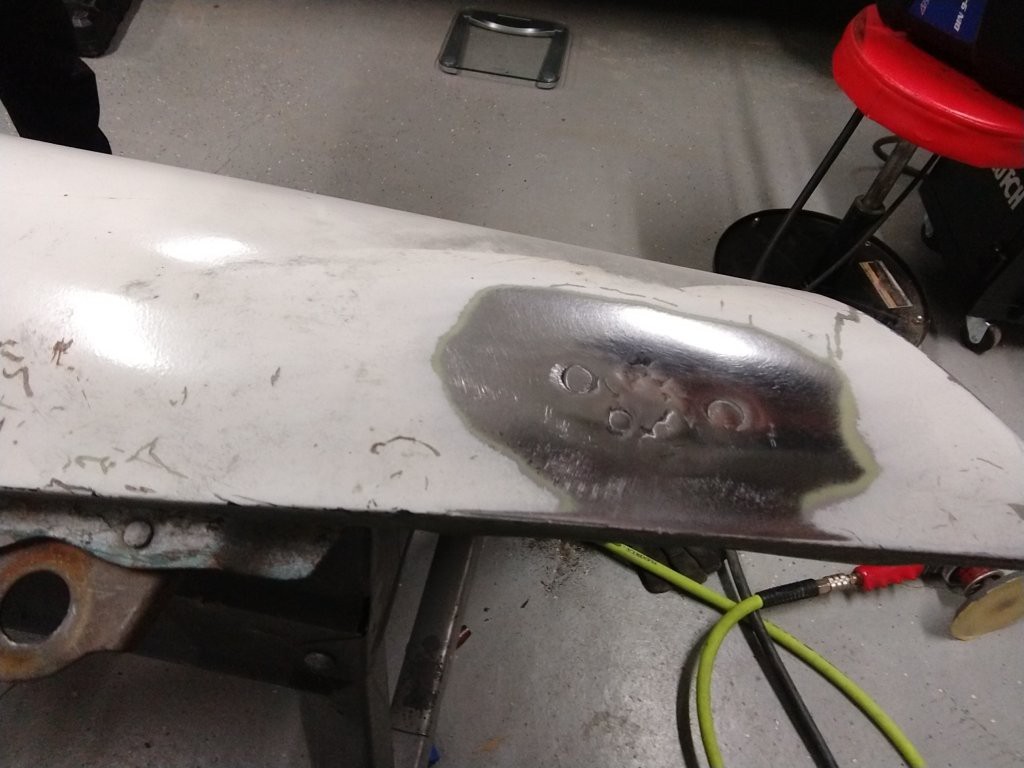

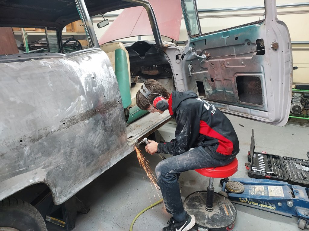

A couple years passed before we started working on it. At 12, I taught him how to weld, patching the fender eyebrows and antenna hole on his fenders.
Last winter we started on rust repair on the body. Passenger side needed a full rocker panel, and a patch on the lower quarter panel.
Summer race season we didn't do much on it. He cleaned up his welds, and tacked any pinholes the grinding revealed.
And the addiction, er, I mean, passion, carries on...
He does nice work and that hand formed quarter patch is really cool...
I'm going to go out on a limb here and guess it will be LS powered ??

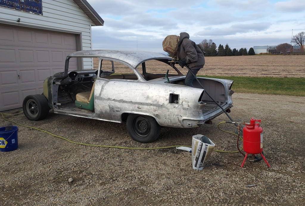

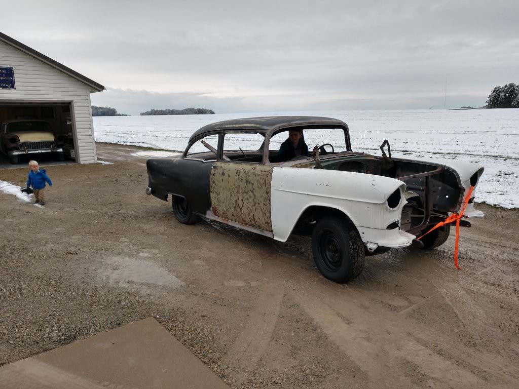

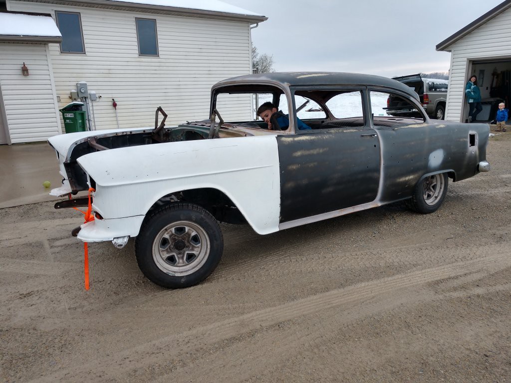

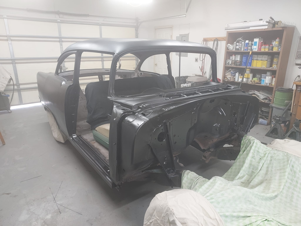

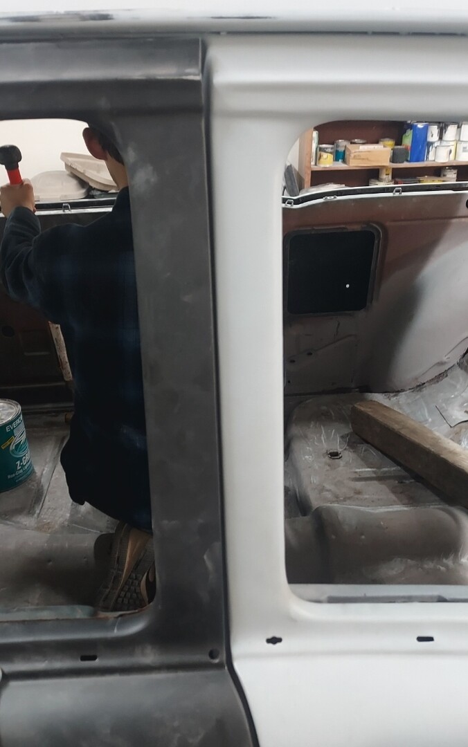

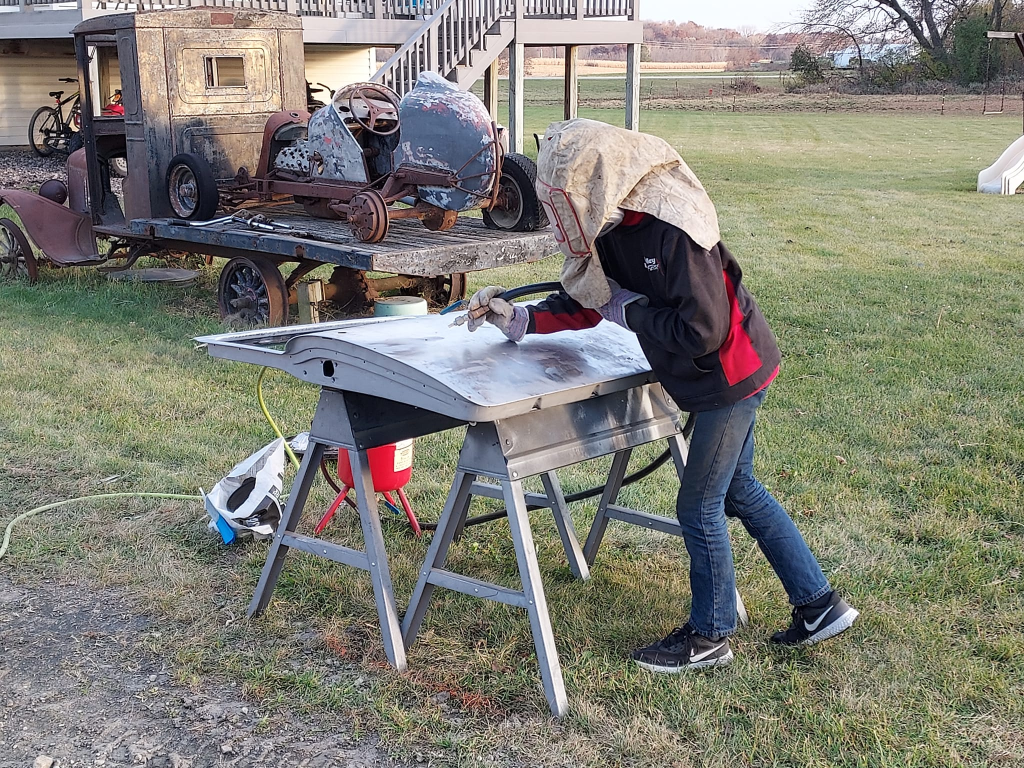

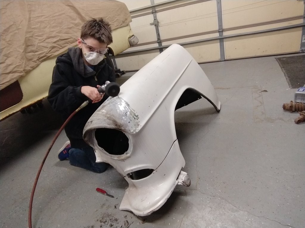

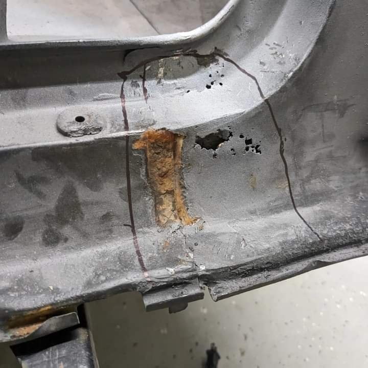

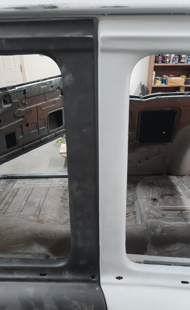

This fall he stripped a door, sandblasted the jambs and the rust-pits hiding behind the side trim, and I primed it for him while he was at Driver's Training class.
His long-term goal is dual-quad 409 with a TKX 5-speed.
Short term high-school budget will probably be the 2bbl 350 out of my Malibu, and the Muncie 3spd out of my 69 SS. We'll put together some sort of decent drivetrain out of the junk I have laying around.

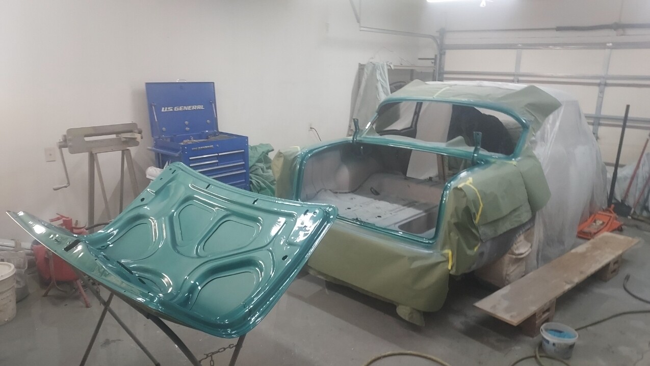

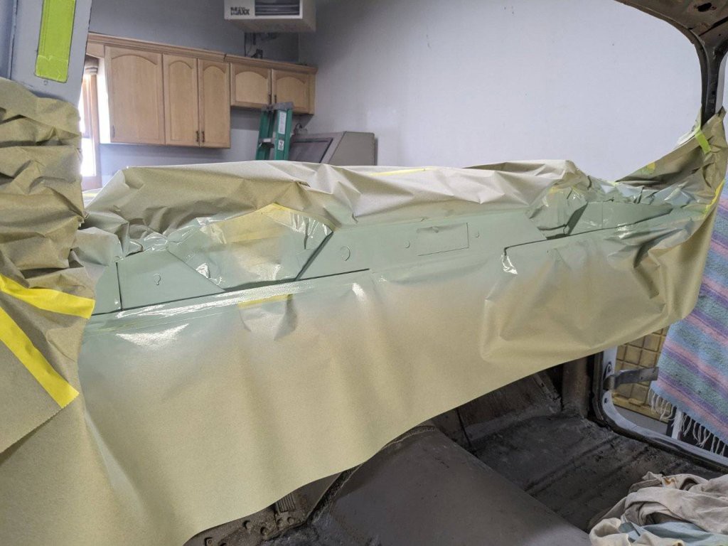

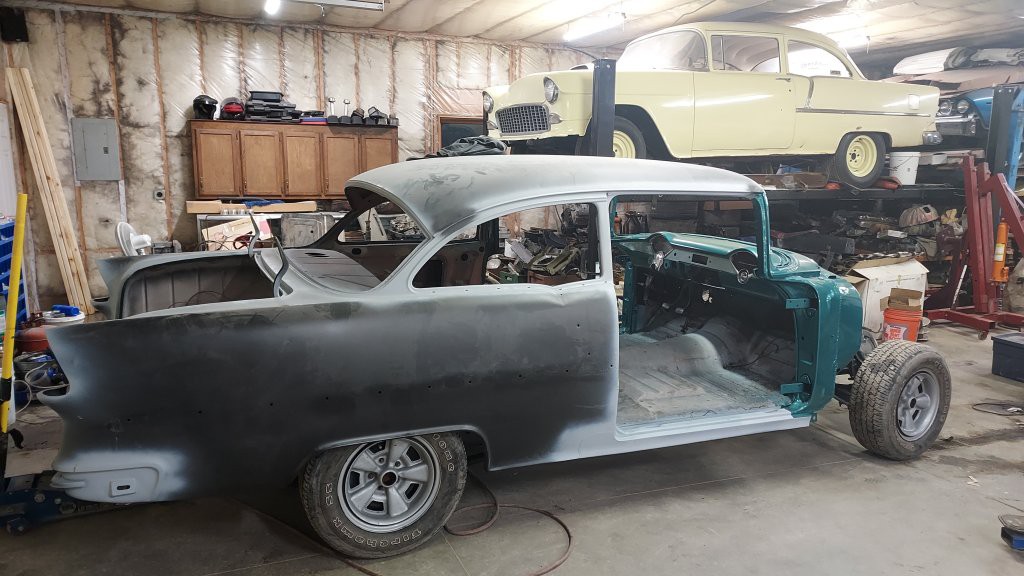

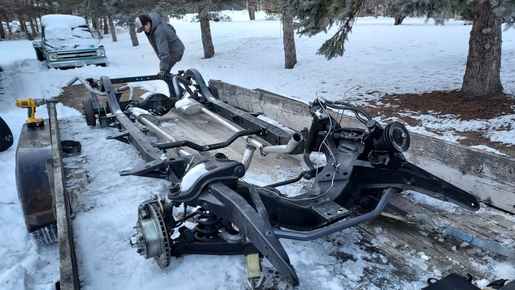

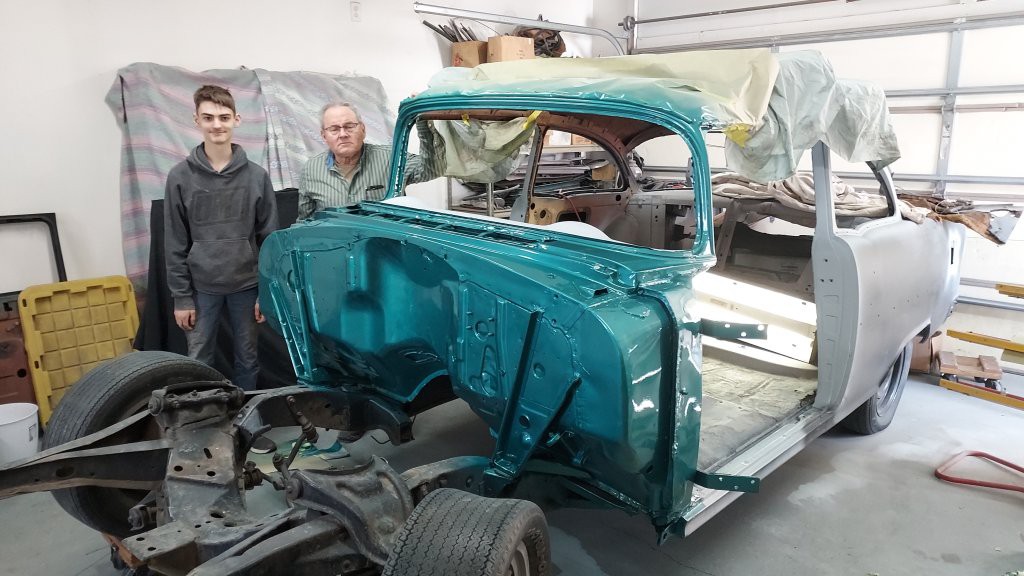

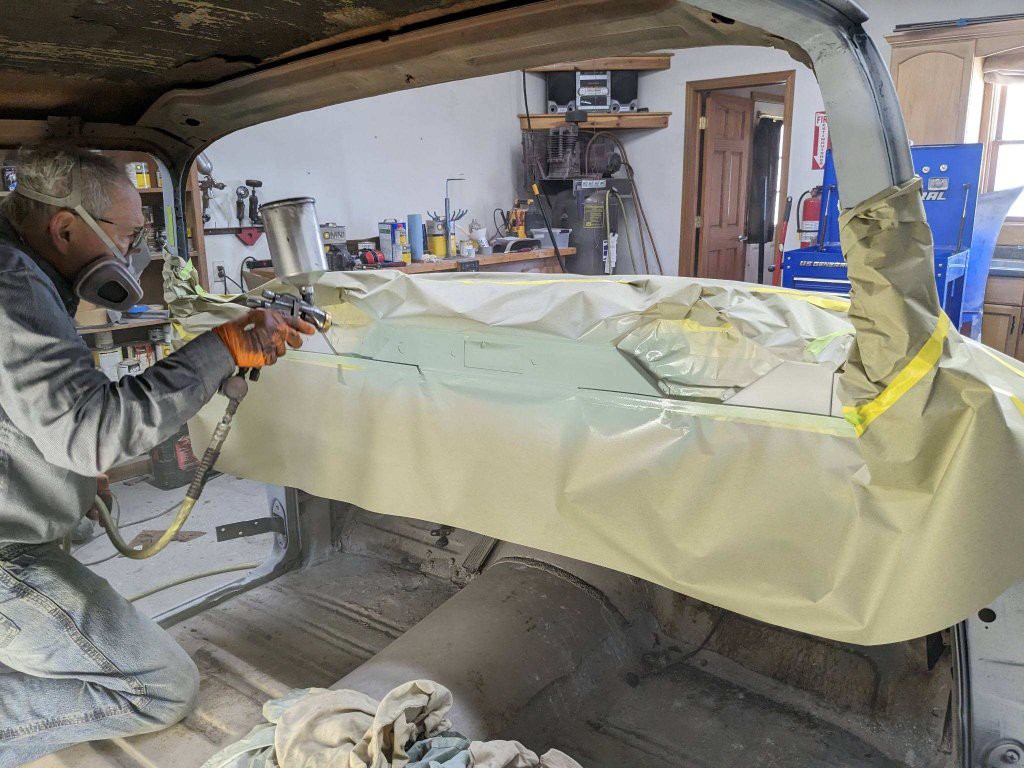

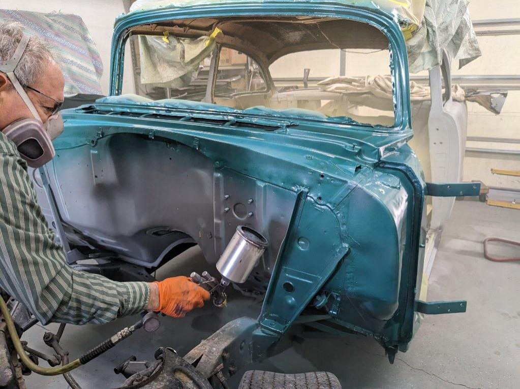

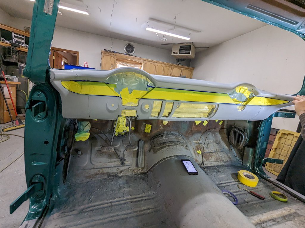

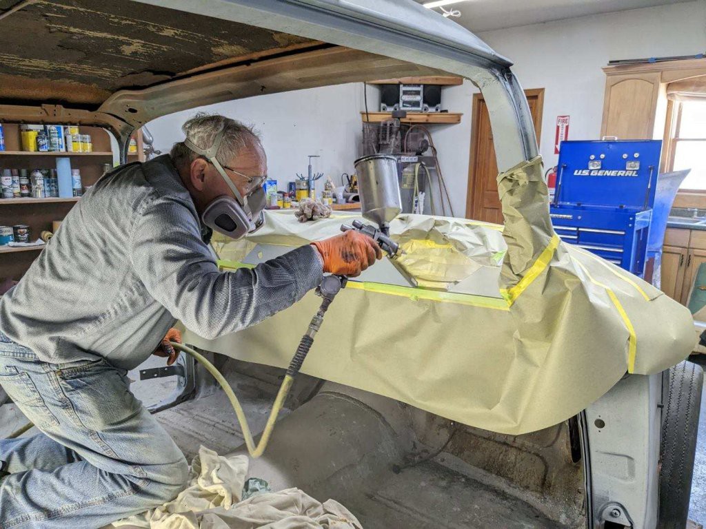

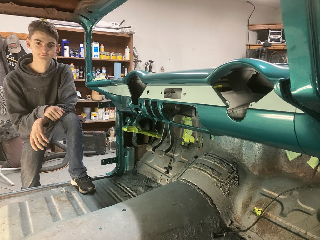

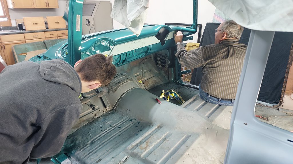

(Tuesday) Day 2 of spring break, firewall into the jambs painted before noon.
(Wednesday) Day 3 of spring break, the dash is fully painted.
Now Cale can start some assembly work over the summer and we'll get back to body work next winter.

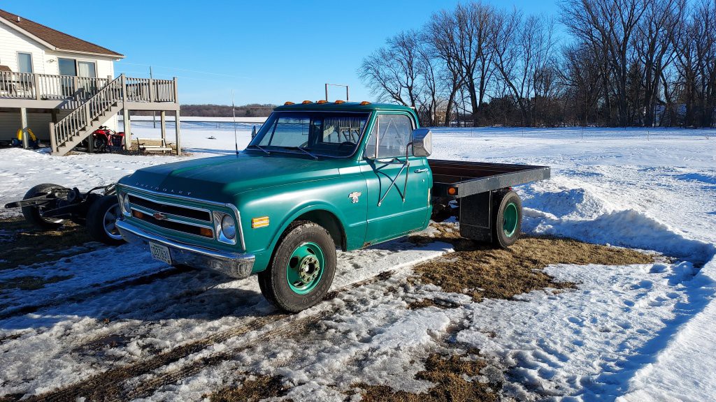

AND how about the '67-'68 flatbed in the first pic ???? Curious minds need to know if that is for sale too. I have 2 C10 projects I could trade...
I'm sure HE wants to continue, but I get too busy for big projects during racing season, and he doesn't have enough experience yet to do a lot of the work on his own. Things like wiring harnesses and dash assembly he can figure out from his assembly manual and keep things moving without quite so much of my help. We might still make progress on smaller stuff like fenders, hood, and doors, but definitely won't be pushing to try to finish anything big over the summer.
I kind of accidentally bought that too while I was there... It's a '67 C30 (with big back window and '68 fenders, so it looks like a '68)
Hmmmm....weren't all '67's small window ? Sounds like a '68 with a '67 title. I can start hauling the 2 C10's down any time now...
-- Edited by Lost in the 60s on Thursday 23rd of March 2023 03:02:20 PM
VIN tag appears to be original and not tampered with, and decodes to a 67 C30.
It's pretty well optioned for a 1-ton cab-chassis model. V8, 4spd (w/granny-low), factory AC, and PS. Someone added a later seat, tilt column, and disc brakes.
The truck runs and drives great. I'll mess with it a little bit and probably sell it this summer since I don't really have room for it.
Did the old frame have mounts for a trans crossmember too ?
Yeah, locating the engine/ trans is fun. Maybe cut out the firewall and do a setback for better drag traction...
New frame I think they used front mounts judging by the PS pump bracket.
I'm going to try to line it up so we don't have to change the exhaust that's already "done" on the new frame. Sticking with SBC to keep it cheap and easy. He's going to use a '70 265hp 400sbc and have free reign over my pulley and bracket assortment to make everything work. Just need to line up the Rams Horn manifolds and make sure we can make a Z-bar fit. Maybe swap to short water-pump to keep it more period correct looking.
Shortening the pipes is easy, if you locate the engine rearward some.
I have a tranny crossmember i bought for the LT-4 project.
Would be 1/2 price to you if you want to play with it.
Most of the other cars are put away for the season... time to get back to body work on Cale's 55.
He worked on filling and sanding some seams and areas we patched while I hammered out the dents in the roof last night.

Another small step in the right direction on Cale's '55. Any night with color in the gun is a good night!
Looking good. Basecoat/clearcoat?
What breed of paint are you using?

Looking great !!
PPG base should match up with the single stage quite well out of the can.
