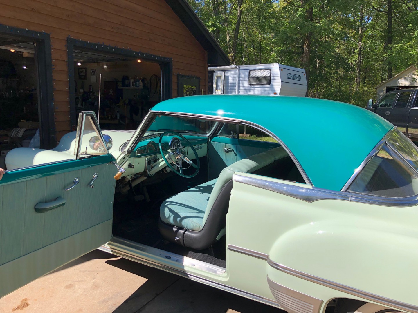

Looks like the car is a "2537SD" making it a Chieftain Super Deluxe Catalina Hardtop One of 1382 made that year, so about 4X rarer that the 71 Convert.
Starting in the very early 60's, the SD designation became Super Duty, for their new high performance program. Maybe keep your future options open to locating a Pontiac 389 engine and 400 trans and put 'er back to purebred...

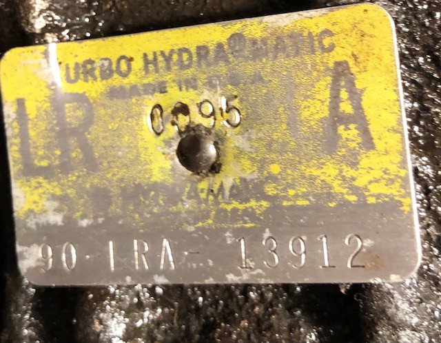

Looking for help on decoding this tag, not anything found on line yet to help with a "LRA" version
Is there a number stamped on the left side of the case ? Should be a partial vin there somewhere.
tried but still cant find it
Sep 26, 2021
Most commonly in the area in red above the pan, but some have been found on the bellhousing flange also. Either location may be difficult to see in the vehicle.
Sep 26, 2021
Being it has the electronic speedo setup I would have to believe that trans is likely going to be an 88-91 model year range.
Sep 26, 2021
Yep, the "90" on the tag should indicate it's from a 1990 model vehicle. Other than that, I can't find anything else to help either. The "net" is letting us down.
It could, also, be named a 3l80, as GM changed the name in that are, but that designation has even less info.
Mitch = It could, also, be named a 3l80, as GM changed the name in that are, but that designation has even less info.
Thanks. think you guys have it right
"In the 1970s, the TH400 was used in heavier-duty GM trucks and it was available in 2wd and 4wd configurations. The naming of the TH400 was changed to 3L80 (3-speeds, Longitudinally positioned, 8000 lbs. GVW or Gross Vehicle Weight) in 1990 to make it easier for buyers to identify the transmission."

Bruce, I've spent a couple hours over the past few days, trying many different search terms and formats to track down ANY help decoding the LRA on your tag. If the info is out there, I can't find it, good luck. I suggest calling John, the transmission expert and see if he has any insight on the code. I would, but we are out of town on a camping trip all week. I am sending his contact number via PM for you.
Thanks Mitch,
guess I'm not the only one to strike out on the searching. for now its enough to know it was just a name change and that the 1990 TH400 was called a 3L80

I'll check tomorrow to see if I can cross that LRA code for a 1990ish trans. If you can find the Vin from the case, that would be ideal. Should be "L" and then 7 more, possibly "LZ" and 6 numbers.

0LRA transmission code is for a 1990 1500 Pickup, 2 wheel drive, standard cab, 6 foot box, with a 4.3L engine. It is option code M40.
I also checked up and down other models and 1989 and 1991 to verify. All had different codes.
What is that code? That's the specific "programming" inside the trans for the specific model and options of a vehicle. It's pretty much a designing of how the fluid runs through the valve body.
for example: option code 0HKA is for the same 2 wheel drive, 1500, standard cab, 6' box but with a 7.4 engine. Understandable, that's a 7.4L.
Here's where it can be a little goofy: 1990 1500, 2wd, 1500, 6' box but now EXTENDED CAB is code 0LFA.
Why? It has a different weight and the engineers actually take that into account.
Codes for a 1990 1500 2 wheel drive with the 3 speed auto: 0HKA, BA, HA, 0LFA, 0LRA, and 0LFA.
Same year, same model, GM also had the MD8 trans (aka 700R4/4L60) available and that had 15 programming version codes for that year alone.
What is that code? That's the specific "programming" inside the trans for the specific model and options of a vehicle. It's pretty much a designing of how the fluid runs through the valve body. for example: option code 0HKA is for the same 2 wheel drive, 1500, standard cab, 6' box but with a 7.4 engine. Understandable, that's a 7.4L.
Here's where it can be a little goofy: 1990 1500, 2wd, 1500, 6' box but now EXTENDED CAB is code 0LFA. Why? It has a different weight and the engineers actually take that into account.
Wow, thanks for the details on the tranny. with all that said, it sounds like it should be okay for the 51 and when the speedo drive gear is replaced i will be able to know just how fast its going

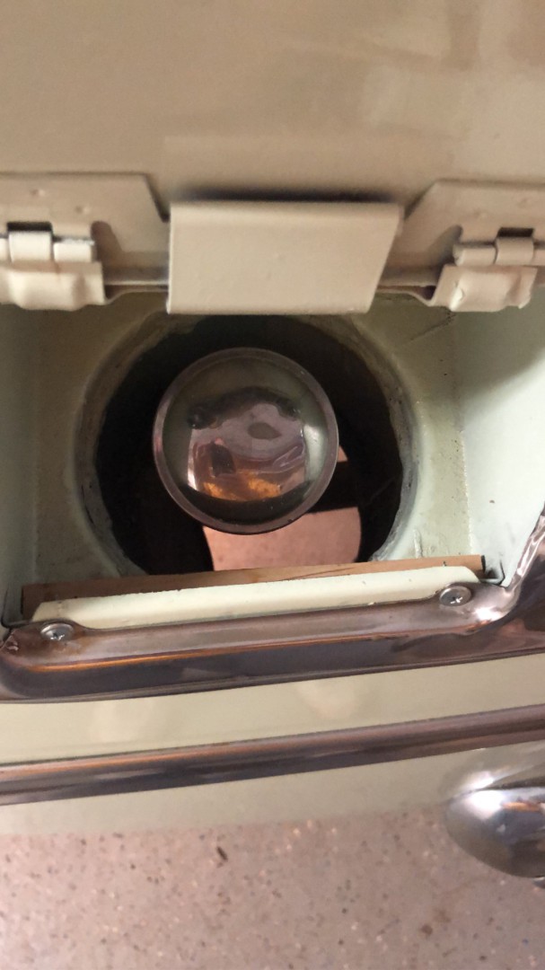

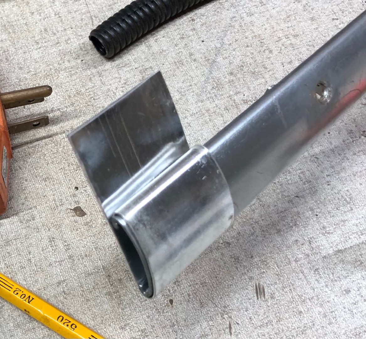

1- Need to get better on taking before pictures 2 - Since I am still trying to figure out the gas gauge wiring.... (gauge is good, stepped the 12 volt down to 6, checked the grounding, ran a jumper sender wire....) 3- Decided to rework the drivers side seat mount, which lets say was very strange. Also decide to work on the car during the Vikings game and not just sit on the couch for 3 hours
Happy with the choice, even though it looks like the tank may need to come out
-- Edited by BLyke on Sunday 28th of November 2021 07:12:14 PM
Much better use of time. Your part turned out great, and the Vikings disappointed - again.
I have never remembered to take before pictures. Since my '79 Malibu will remain pretty much stock looking, I took a series of pictures of the engine compartment so I can get all the routing like it was. Since I have almost nothing else to do, I am having trouble finding time to work on either car.

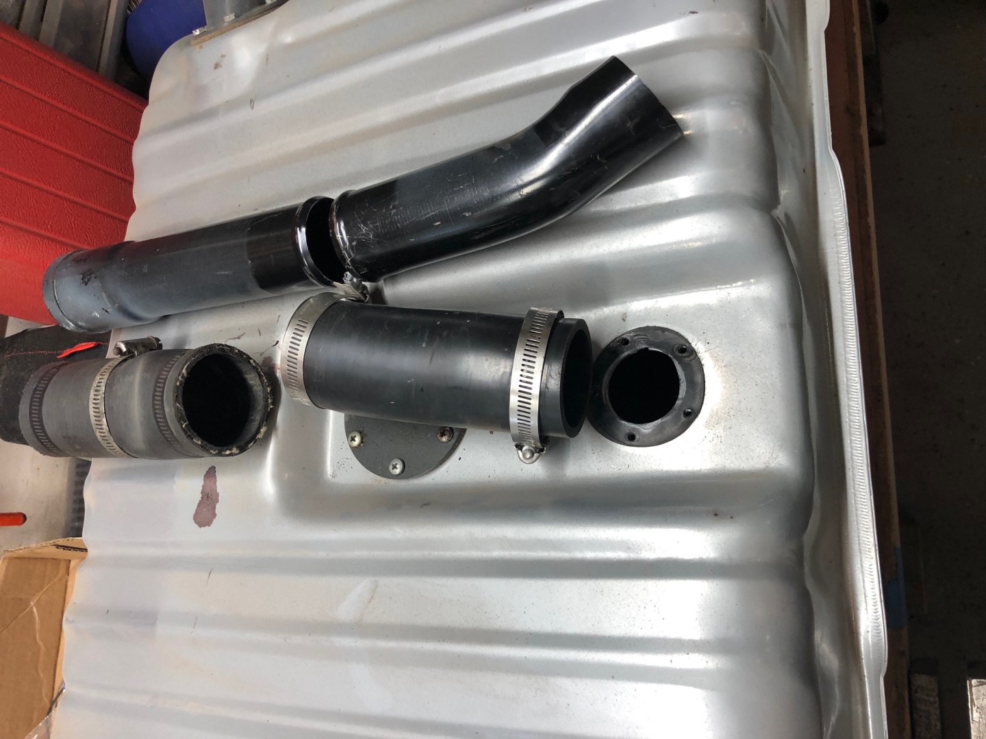

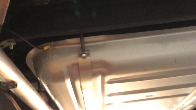

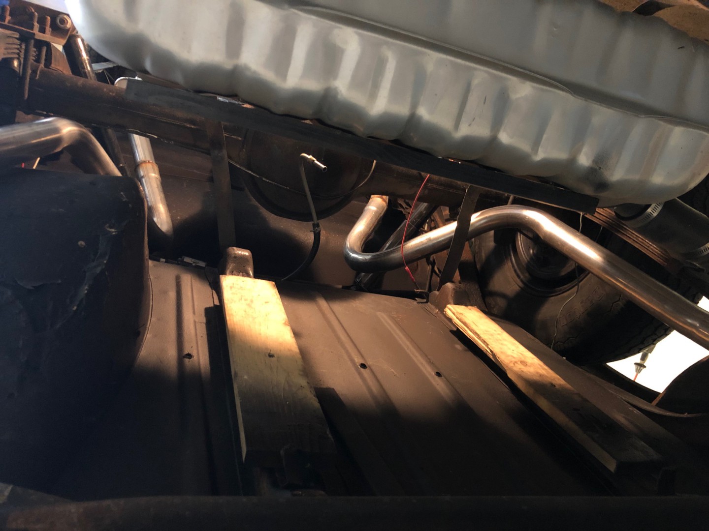

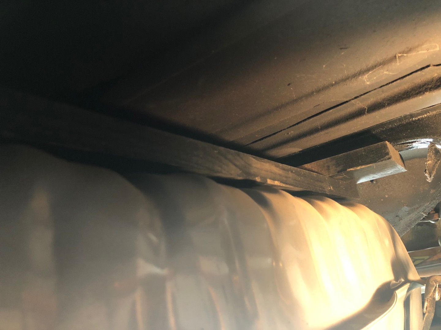

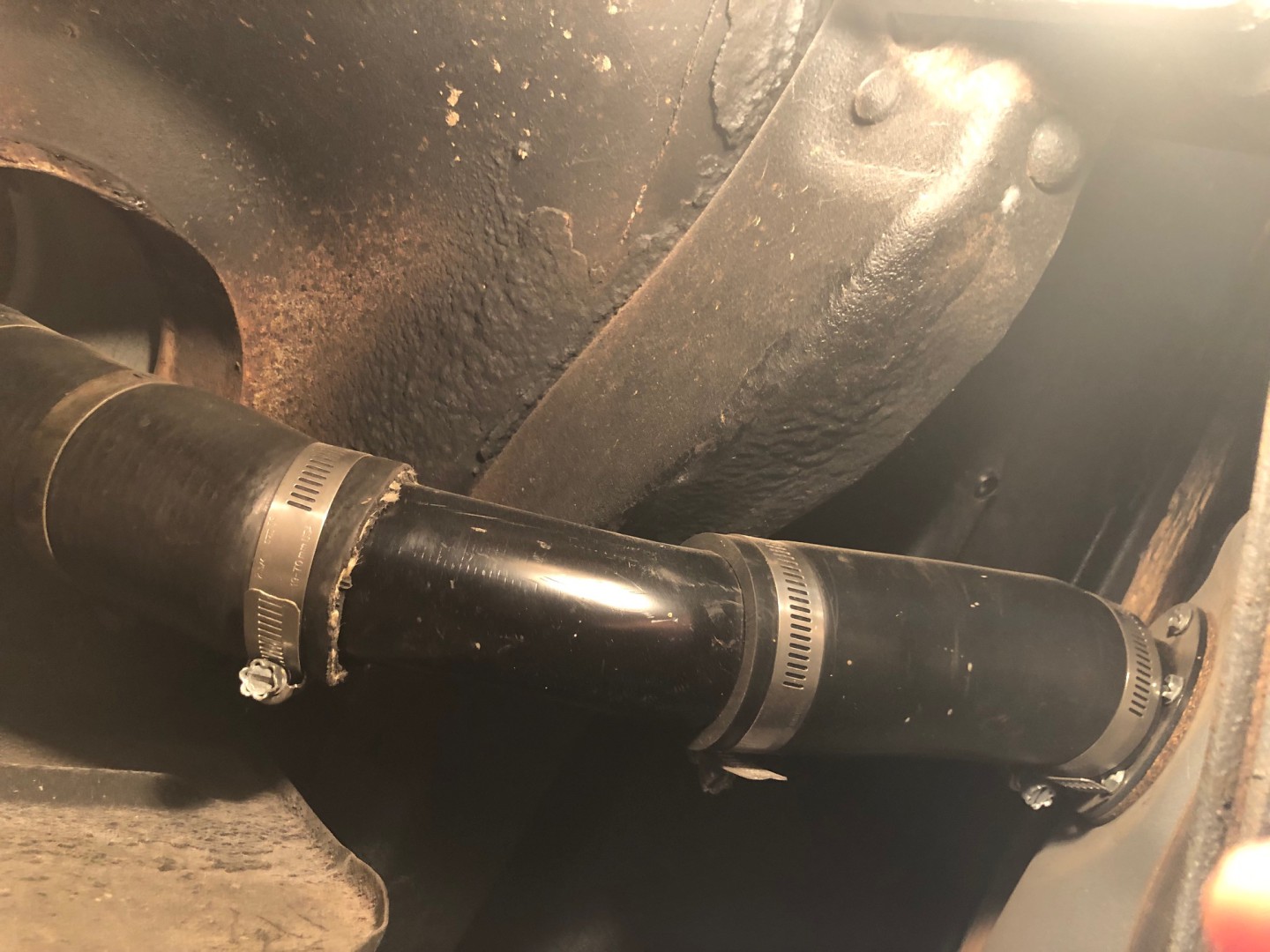

Tanks, but no Thanks?! Since is is now December and winterish, and the sending unit seemed to be bad, it was time to pull the gas tank to figure out what exactly the PO had in mind
From what I can surmise, they either had, or inadvertently purchased a 1953-54 gas tank (which was identified while searching for the correct one).
The bad news is the filler tube would not clear the frame, so they installed some 1X4 wooden cribbing to lower the tank. hey also cut the tube and added a joint.
And yes, the sending unit is bad and seems to also be the wrong ohm range.
Sold the wrong one on Marketplace to a guy here in Lakeville
New tank is on order.

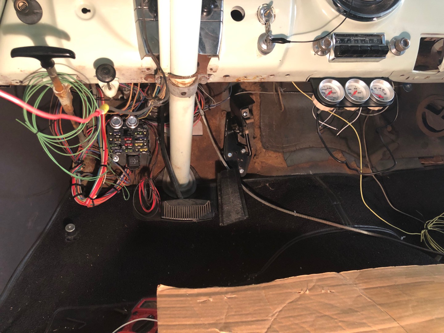

On deck is the rework of the Painless Wiring install and the conversion to 12 volt from 6 Volt. think it is still ~28-29 weeks to BTT50's, its all good.
-- Edited by BLyke on Thursday 2nd of December 2021 05:08:33 PM
-- Edited by BLyke on Thursday 2nd of December 2021 05:09:58 PM
Well, you're dug in for a while now.
Good Luck with the Painful wiring. I'd be looking at an AAW or M&H replacement, but that's me.
Dec 2, 2021
Well, you're dug in for a while now. Good Luck with the Painful wiring. I'd be looking at an AAW or M&H replacement, but that's me.
Since it was already 75% in and converted to 12 Volt, its what I'm going with

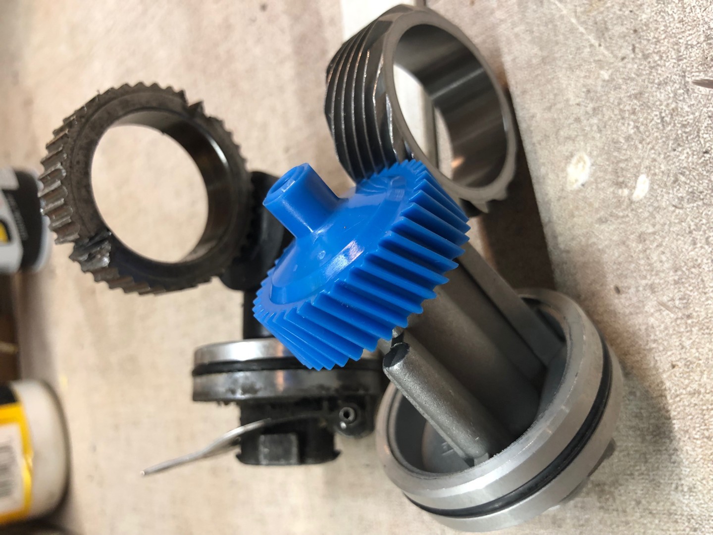

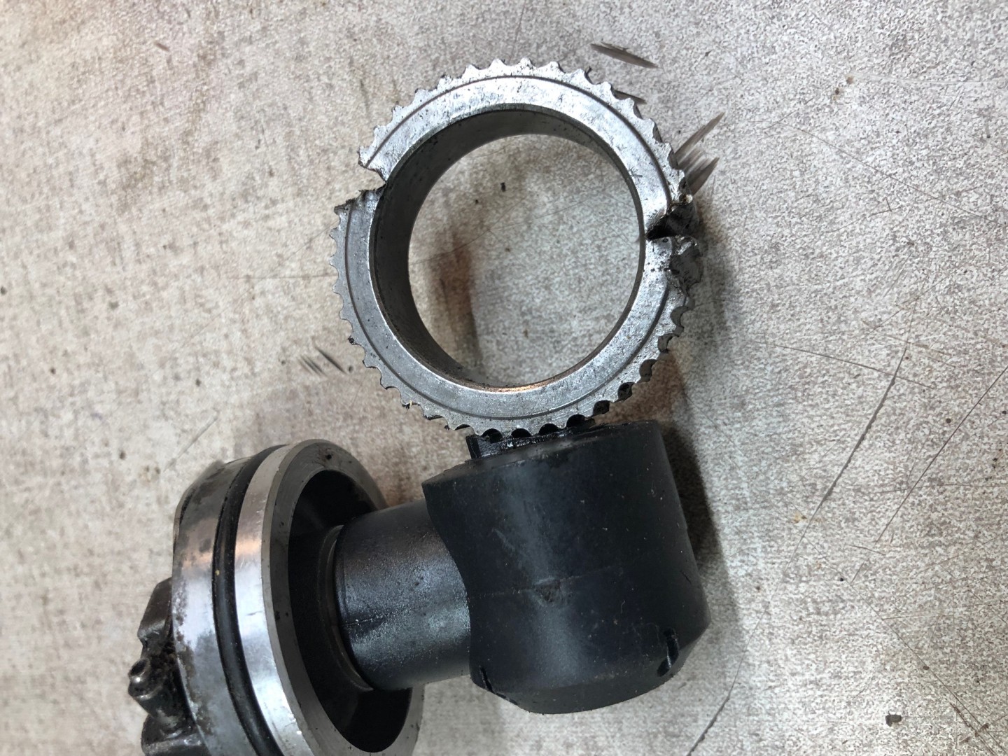

Finally "faced the dragon" of getting the TH400 converted to gear drive speedometer that will work with the 52 Catalina original dash. After a lot of effort to remove the press fit electronic drive the plan is now to use the plastic gear and clip. Seemed like a lot could go south with a ~500 F gear while trying to get it on to the shaft and in place.

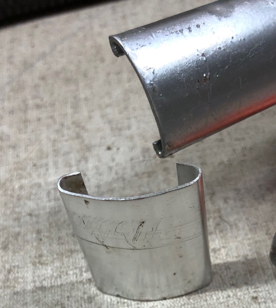

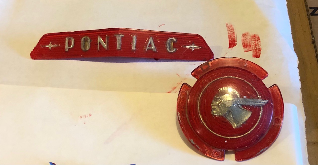

Yesterday i decided to try and make some trim pieces to clean up the windshield, there was a gap from replacing the glass with a one piece Old's style
The material used was some i had saved from my Chevelle rear trim that i thought might be good for shimming at some point
Dang, that's cool, Bruce. Looks nice.
Thanks Mitch

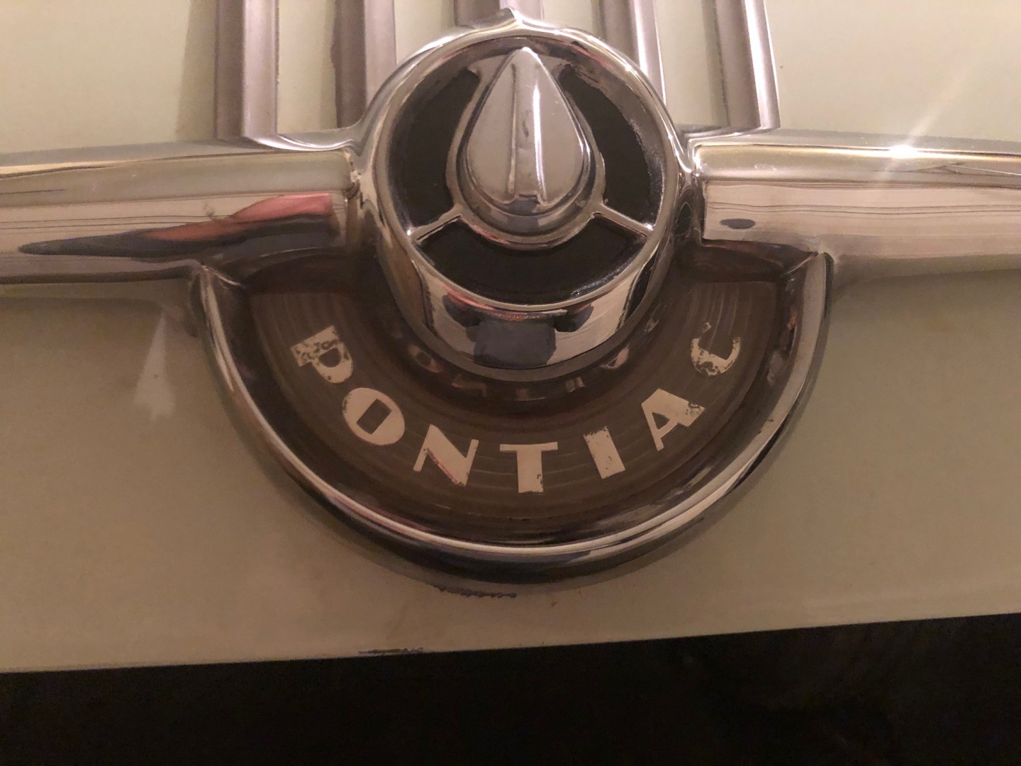

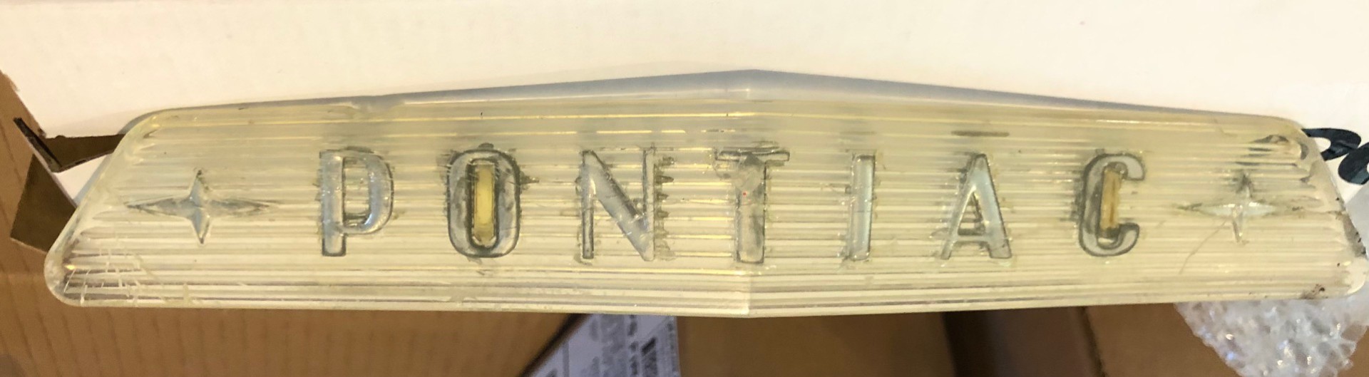

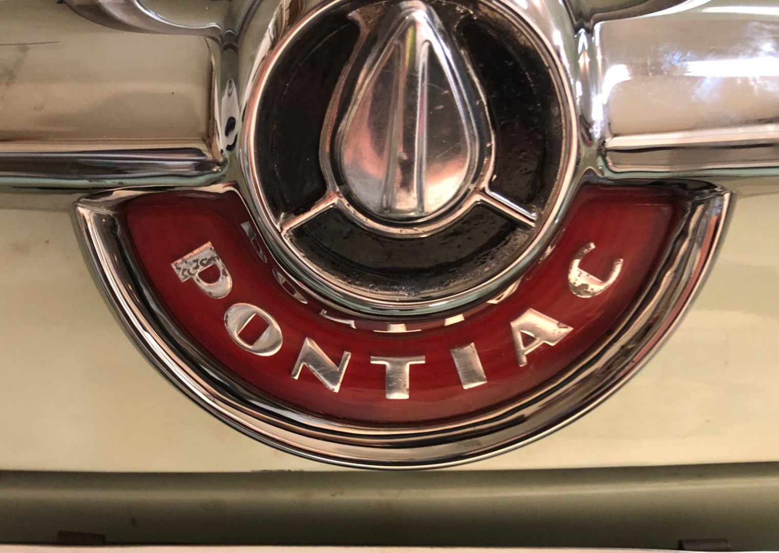

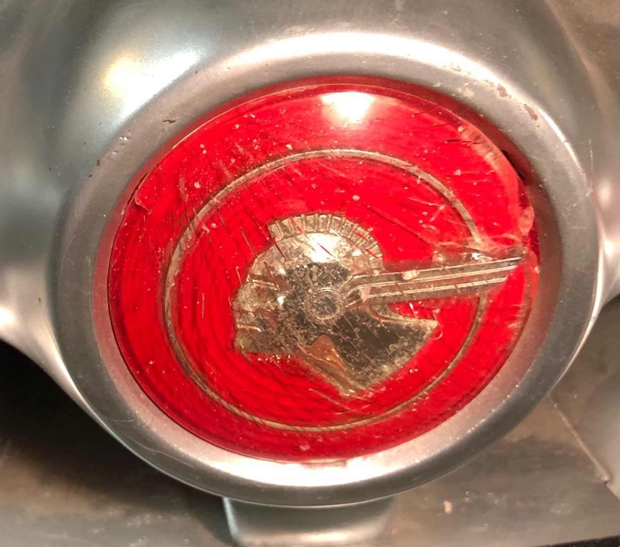

I need to get better on taking the before pictures

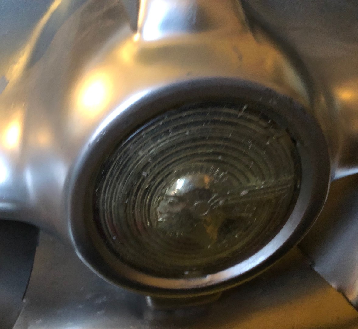

here is a few on the badging
Went the $2 route (VS $500+)
-- Edited by BLyke on Thursday 11th of November 2021 08:13:26 PM
-- Edited by BLyke on Thursday 11th of November 2021 08:15:11 PM
They look 1,000% better than all faded...
It was actually easy, once I figured out what to use and how to try doing it.
The first one didn't turn out
Got the new tank is and now have a functional gas gauge.
Also now have a filler neck that is where it should be and is not flopping around.
