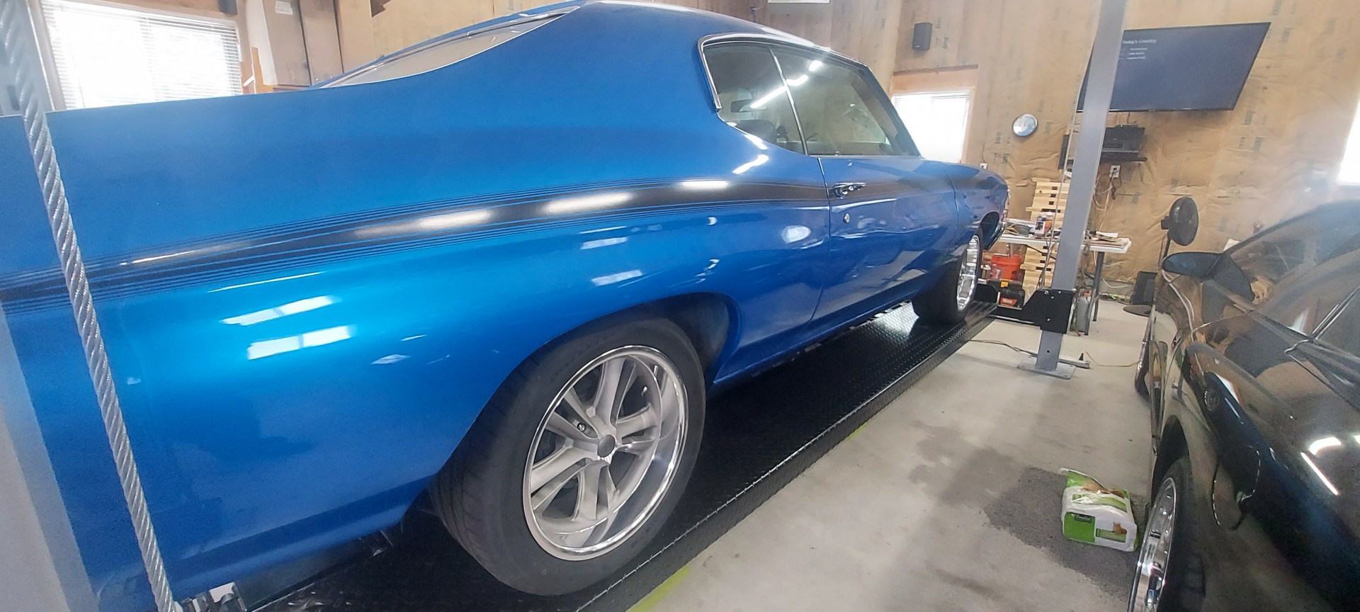

Thought I'd start a thread here for all the projects on the Heavy Chevy.

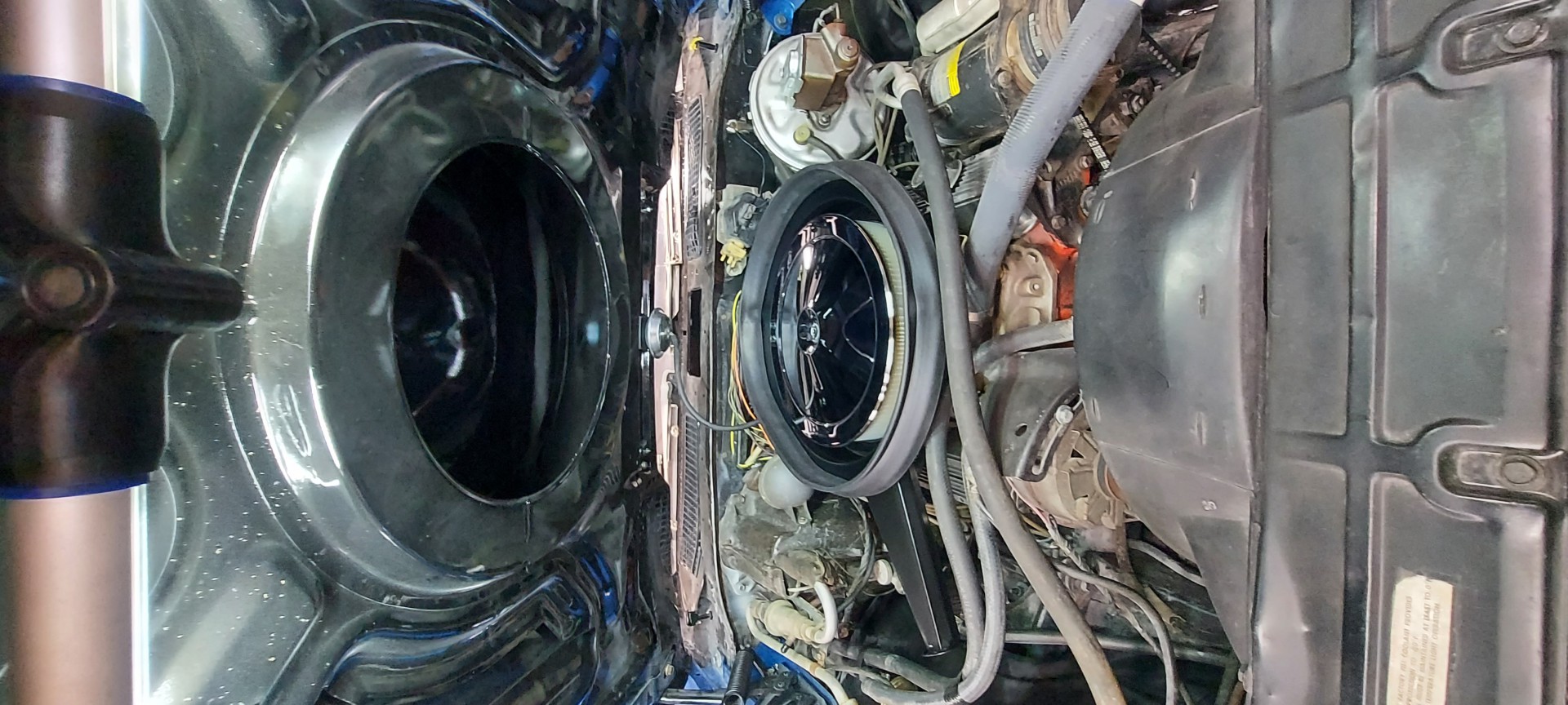

Yesterday I picked up some jewelry from Denny at Auto City Classics in the form of a cowl induction air cleaner kit and trim for the grill.
Before putting the air cleaner on, I took the carb off to see why there were massive amounts of gas leaking from it, and found that every screw and bolt on it were loose. All the gaskets looked pretty new, so I'm guessing someone rebuilt it then when sitting and not being driven things loosened up. Or, they weren't torqued enough to begin with. Anyway, she's running great now and not a drop leaking.

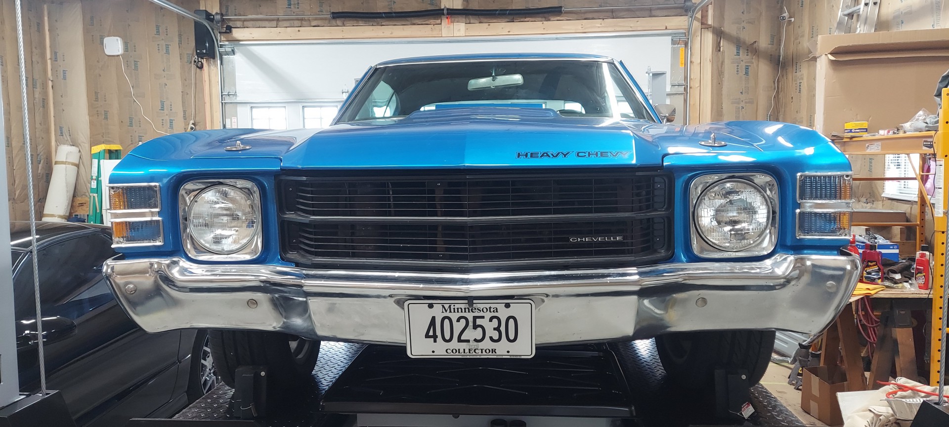

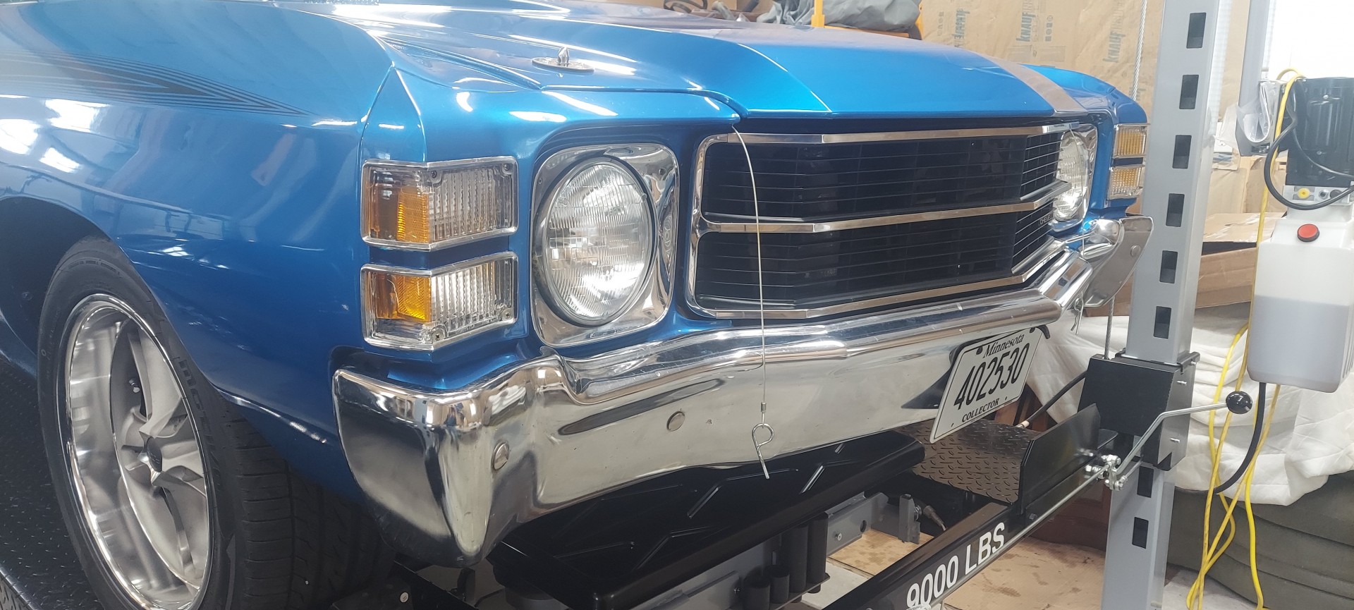

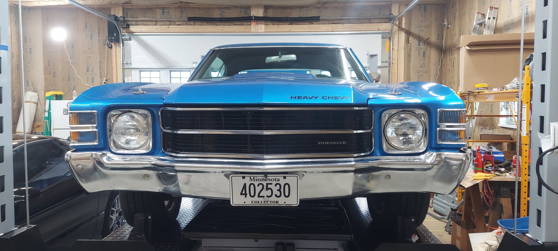

The grill trim was pretty easy and definitely completes the front of the car.

Everything I've read about them said the grilles were blacked out in '71 and had only side trim in '72 ???
Jan 1, 2021
I like the way the grill looks with no center emblem. Very unique look
Jan 1, 2021
I also like the grill trim. Have you thought about blacking out the headlight surround.
Jan 2, 2021
I have a rubber eraser wheel you can use to get the heavy chevy off the hood, since you, now, moved the grille to a Malibu status.
Thanks Mitch.
The Heavy's had the chrome grill trim too though. The PO hadn't installed them.
The base 71 Chevelle grill was unpainted with a bowtie in the center.
The Heavy was painted black with 'Accent trim' and no bowtie emblem.
The Malibu grill was gray with Accent trim and the bowtie. Mike Sabbys is like that.
So lots of combinations.

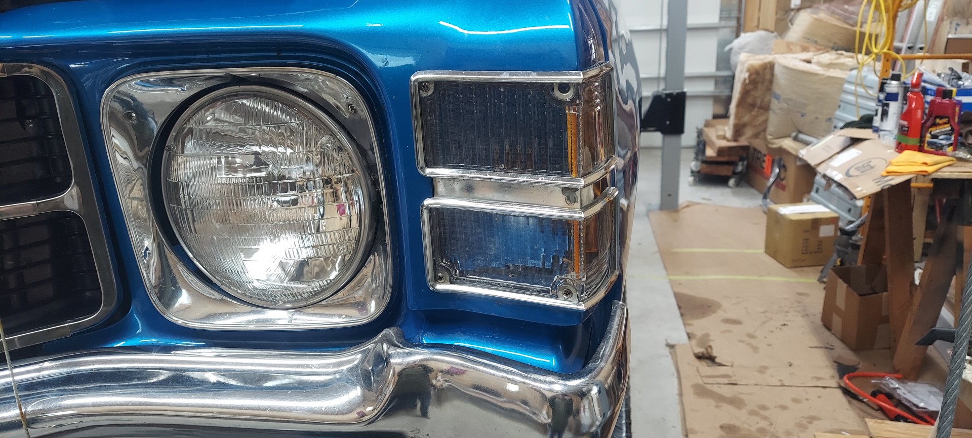

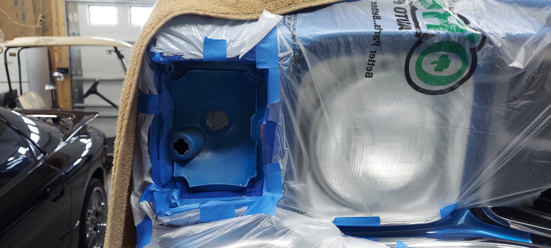

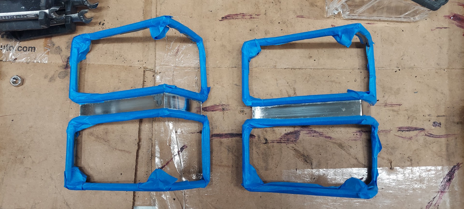

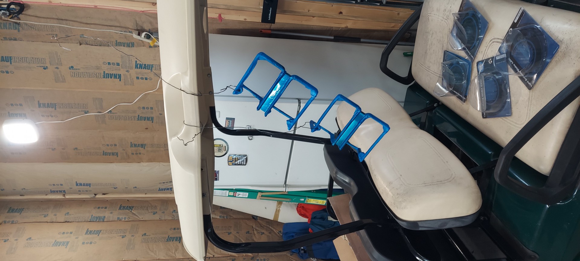

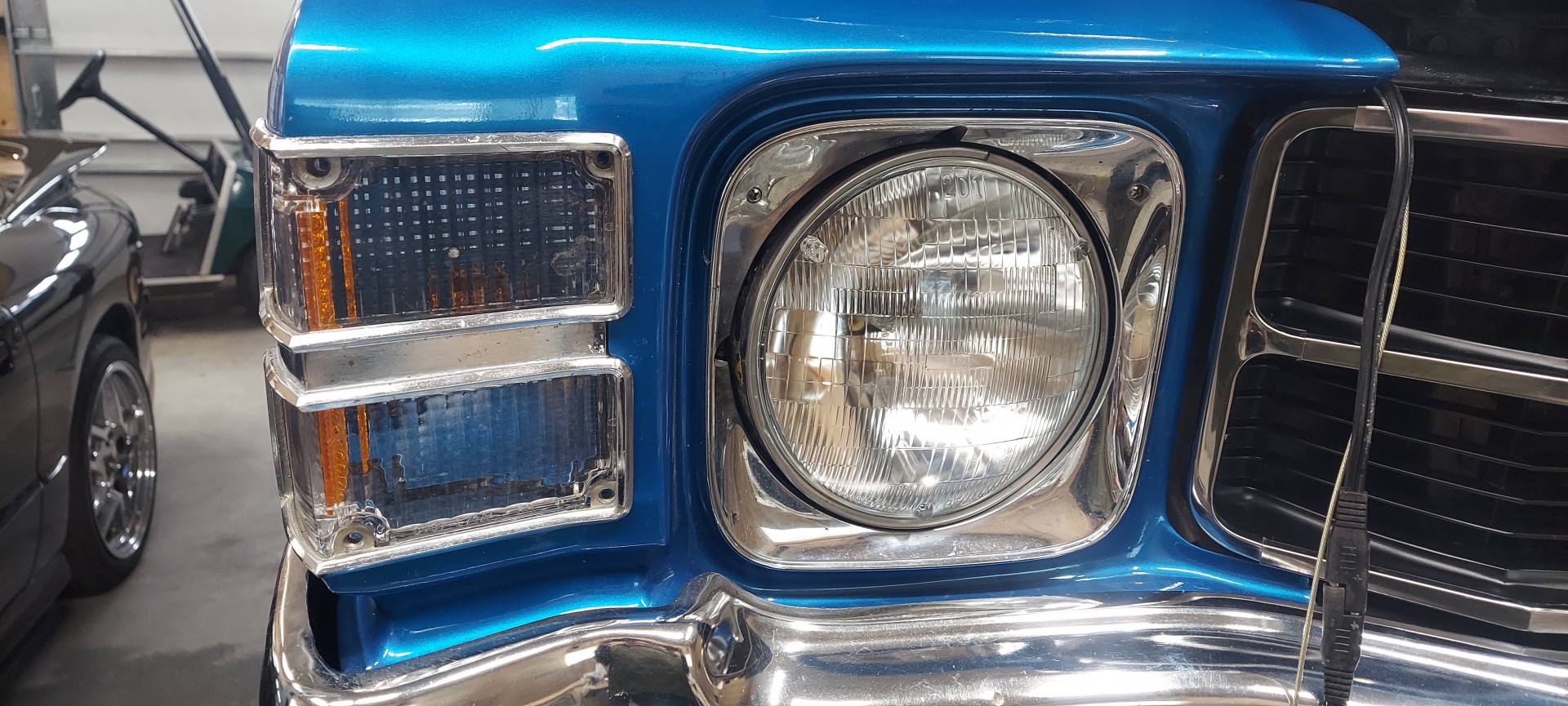

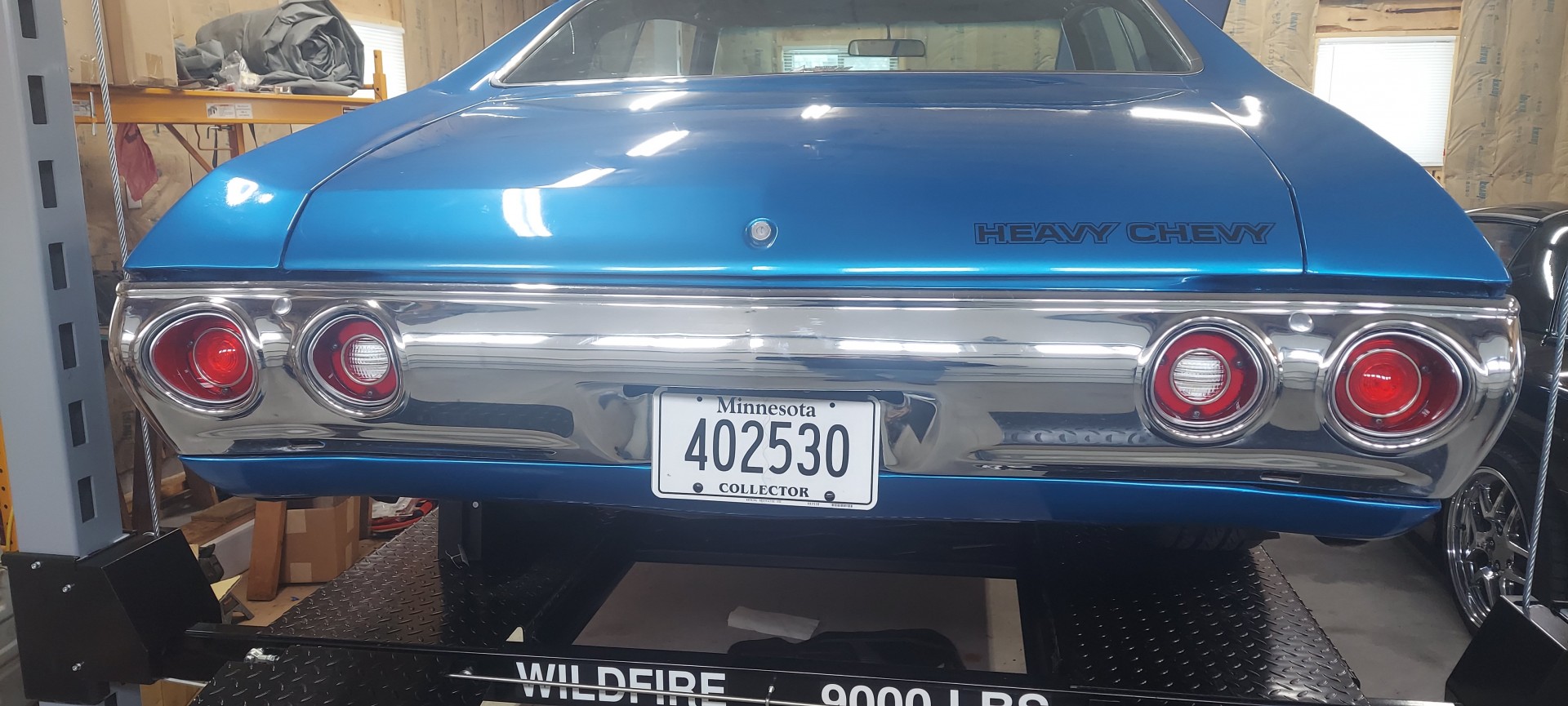

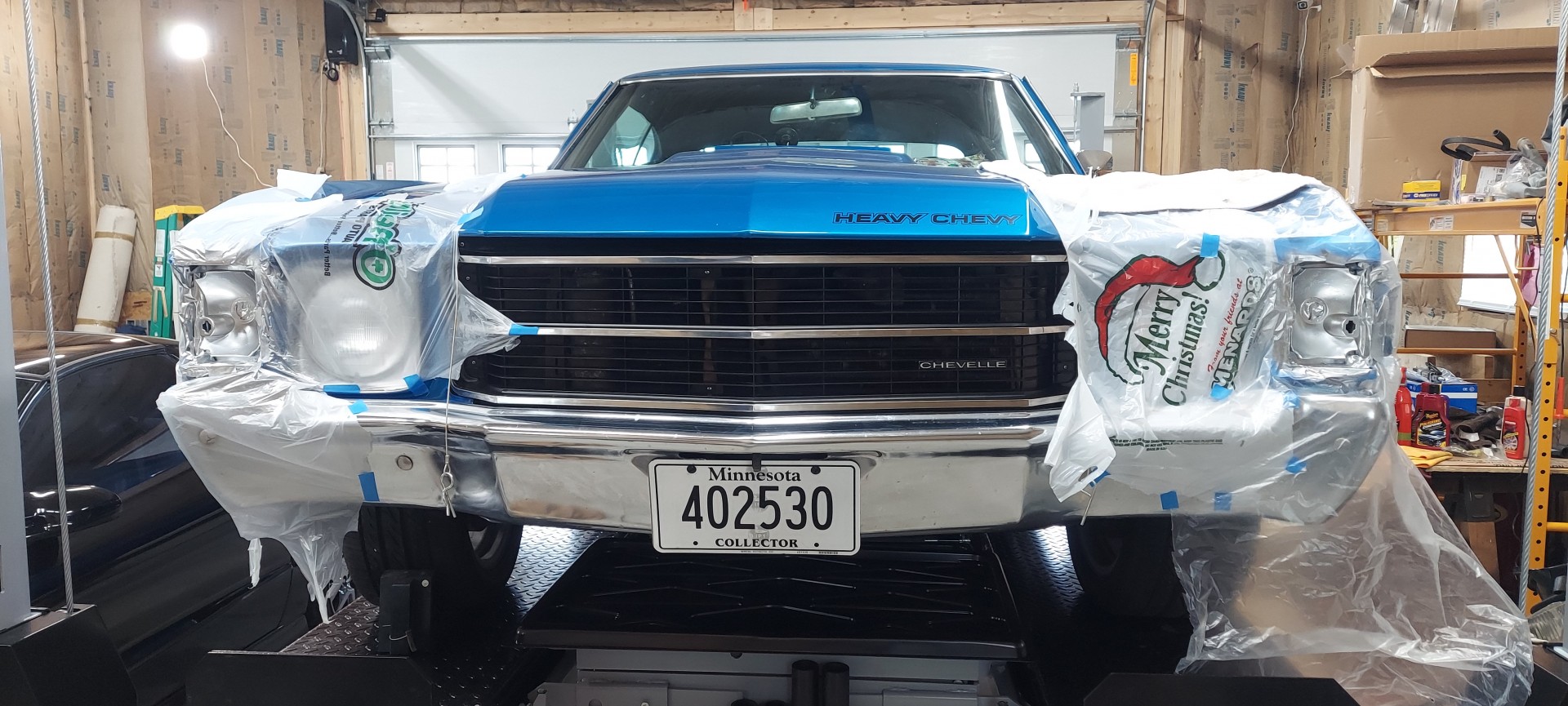

More cosmetic mechanics on the front and rear end of the HC.
- Painted the front turn signal buckets silver
-Painted the space between the turn signal trim body color as it came from Chevy
-Replaced the rear stop and reverse lights with new lenses that have LED's
-Turned the golf cart into a paint hanging stand
The LED lenses are from United Pacific, and have the direct plug in bulb connector, so no wiring them in.
Next project will likely be tearing into the steering column to tighten up the bolts in the tilt mechanism, which my research shows this is a common problem.

"-Painted the space between the turn signal trim body color as it came from Chevy"
Looks Good Stan,
What did you do to prep the chrome to take the paint?
I'd like to do the same when i get around tp buying some new trim and lens's
Looks Good Stan, What did you do to prep the chrome to take the paint? I'd like to do the same when i get around tp buying some new trim and lens's
I used a green scotch Brite pad and degreased them before taping them off.
You might also be able to find some red vinyl tape that matches and cut it to size. I did that with the white 71 I had a few years ago.

Looks really nice Stan. Painting the inner portion of the light fixture in chrome makes a big difference in light brightness.
I’ve started using an adhesion promoter on plastic and chrome parts. Jury is still out on its effectiveness. I do notice the paint lays out better.

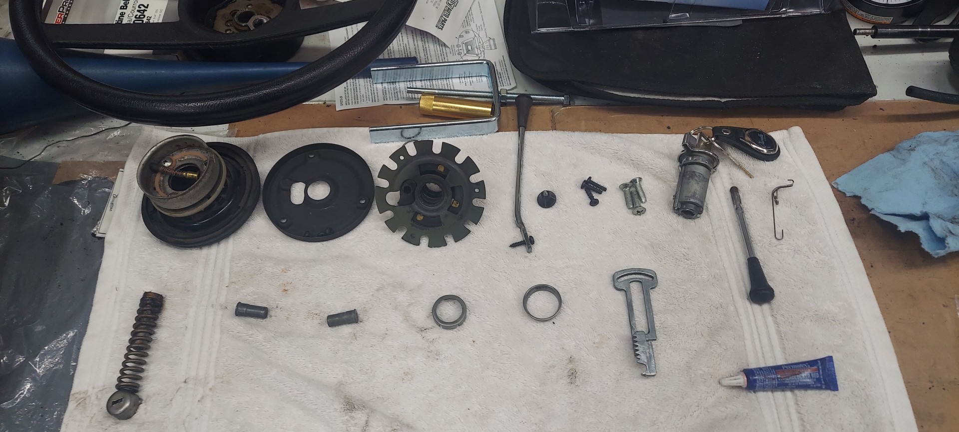

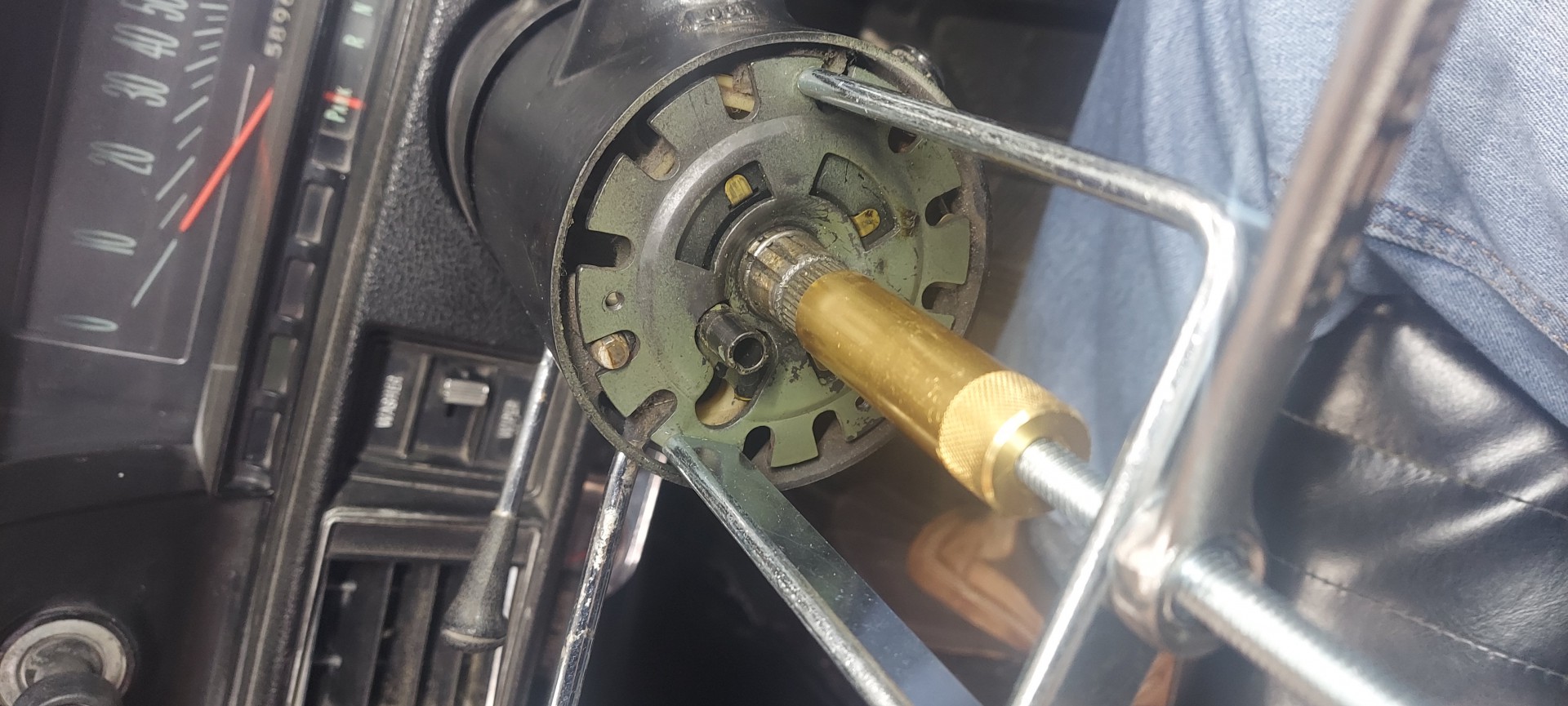

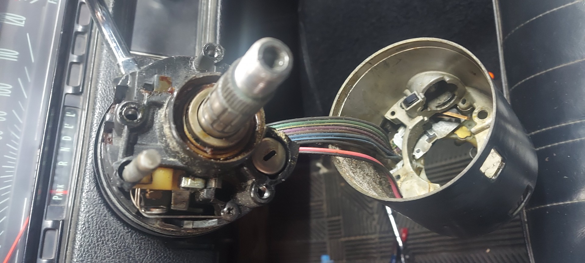

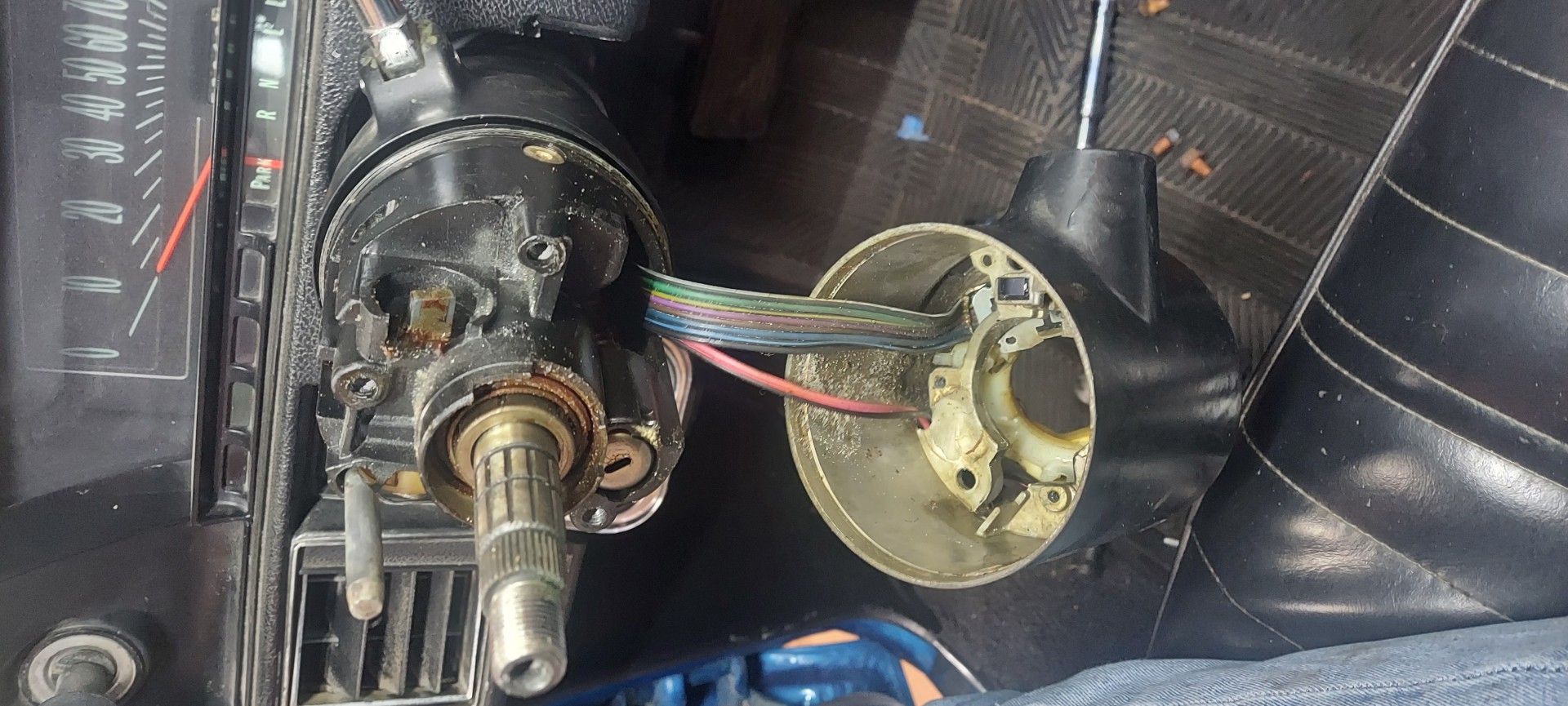

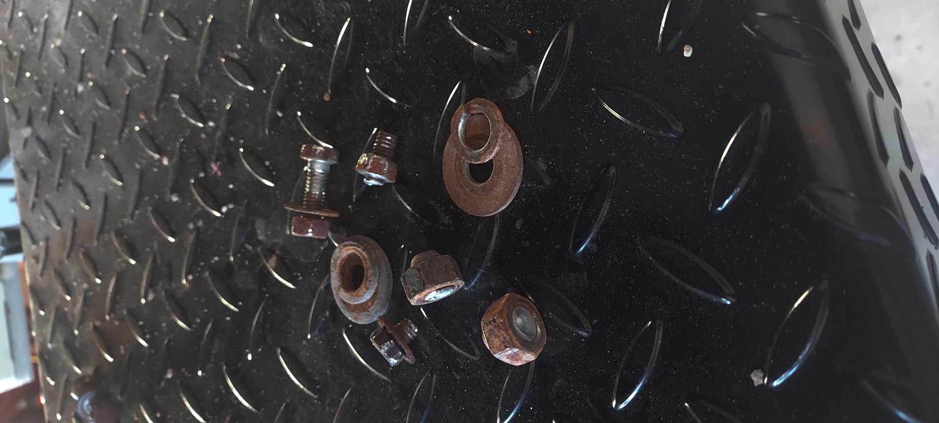

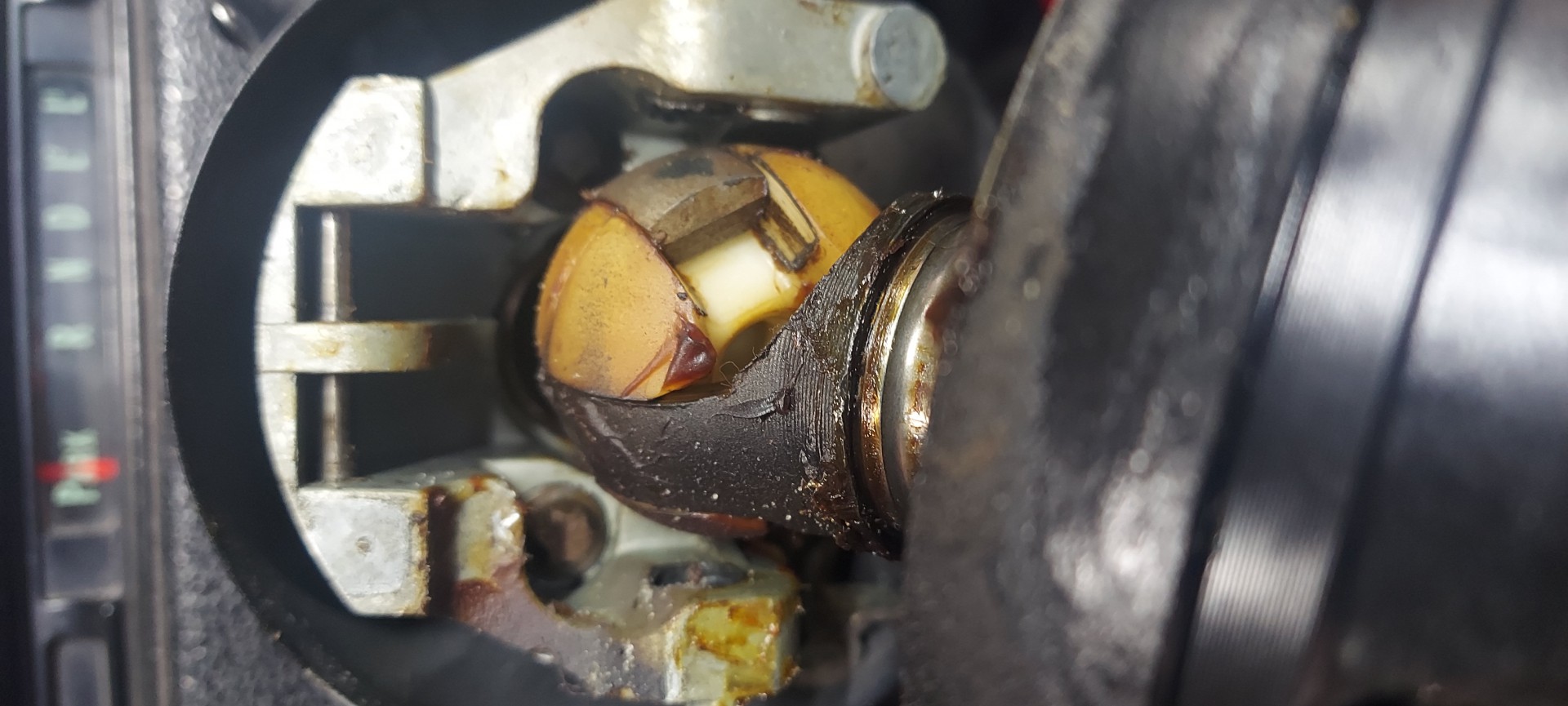

I mentioned the tilt steering column slop of about an inch in any direction, and that this is a well known GM tilt column issue over the past few decades. Well, I'm now much more intimate with the internals of a column and could probably tear down the top side and rebuild it in an hour or so now. Lol

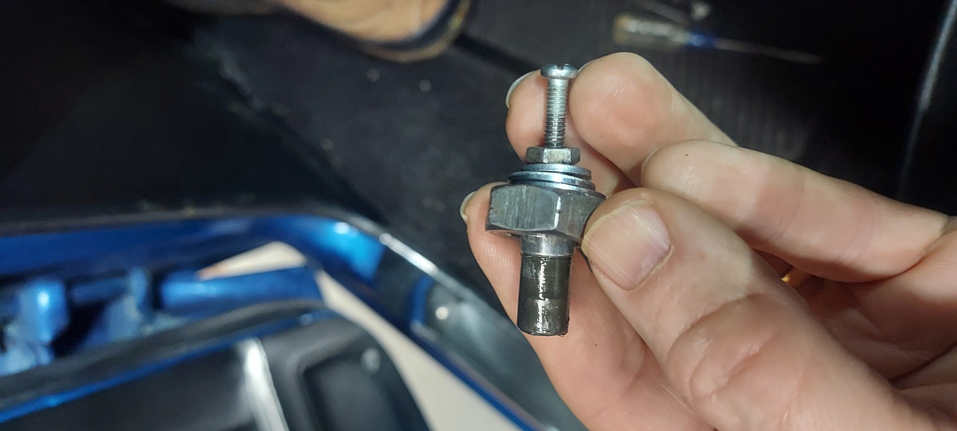

Hardest part of the project was getting the two pivot pins out of each side that are pressed in. Of course there's a special GM Tool PN 0U812 that's made of unobtainium, so I became a You Tube mechanic and found what a guy put together with a screw, a few washers, and a nut to make a pulling device that actually worked.
I also got to learn how to pull the ignition cylinder, which was actually easier than expected once I figured out the release trick kind of like a headlight switch pull knob release.
There are four bolts that hold the swivel ball mount onto the column that work loose over time that cause the problem, and every one of them had backed out at least 1/4 inch and were only finger tight. Some cleanup and red thread locker and it's back together and rock solid.
This is one of those projects that are intimidating at first, but if you keep everything organized when disassembling and take lots of pictures, it sure helps.

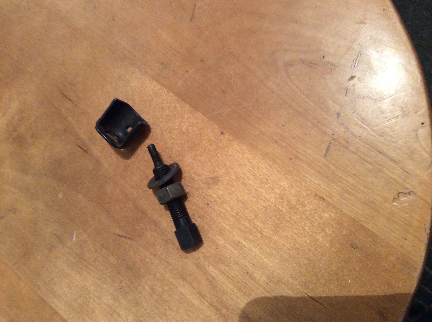

Awesome Job! Keep that picture showing the parts you took off. An item that broke on me was the ignition switch gear. There are 2 different ones. If I recall, the difference is the number of teeth on the gear. There is one that is readily available at auto stores, etc. The other is harder to find and cost is much higher. I had the hard to find/higher cost one. Ugh!

Sorry Stan I have that tool for pulling the pins. Did lots of those columns in the 80’s and 90’s.
-- Edited by 67ss on Monday 18th of January 2021 08:21:04 PM
No worries Chris, I should have put out an APB to find one. Although I will say I only stripped out one nut since it wasn't hardened enough, so my home made tool worked o.k.

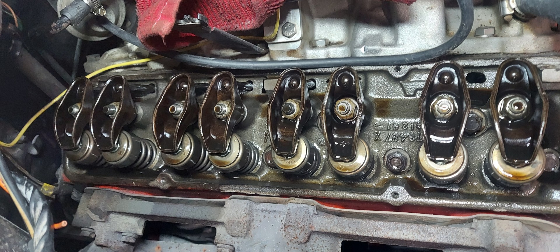

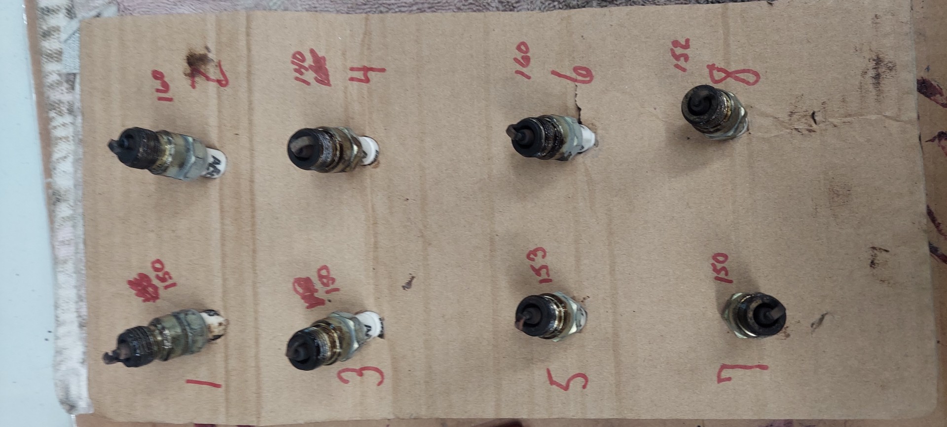

Spent a couple of hours in Jr's Garage this morning doing some investigation work on the 71.
I started her up and let it run for a bit to get the engine nice and warm, then pulled all the spark plugs, wired the throttle open, hooked up the battery charger, and did a compression check on all 8 cylinders.
The compression ranged from 140 to 160 psi, and most were 150 psi. Cyl 4 was the 140 psi one, so a bit low, but within the range of the others so not going to worry about it.
The plugs all looked pretty good other than a tad rich, so happy with that also.
I also pulled the passenger valve cover to identify the heads, and interestingly they are '71 heads so now I'm wondering if it's the original engine. I wiped the paint off the block pad on the front passenger side, but no numbers are stamped other than there is a faint 'T' towards one end. I'll have to pull the AC brackets on the drivers side to see if there's any numbers on the other block pad.
Otherwise, the heads are 3978387X which according to Mortec.com are a 1971-1972 75 cc either 1.94/1.4 or 2.02/1.6 valves, and also used on '71 350 c.i./330 HP LT1 engines. So, nothing high compression, but they are so clean I'm guessing they've been gone through at some point, and hoping they have hardened valve seats to burn unleaded gas.
Now onto a similar CAC project that Bruce just started on his '71 as I'm going to pull the rear air shocks, springs, control arms, and install the same F41 factory handling package. Hopefully the bolts aren't seized either.

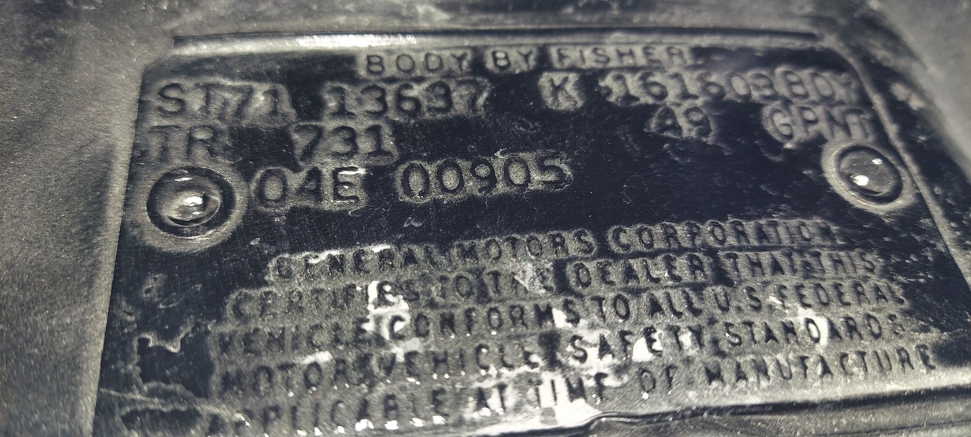

Head was cast 1/29 1971. What is the build date on the trim tag ?
The exhaust manifold looks like it's from a truck. I believe all the car engines would have had smog tubes on them by '71.
Jan 23, 2021
Head was cast 1/29 1971. What is the build date on the trim tag ? The exhaust manifold looks like it's from a truck. I believe all the car engines would have had smog tubes on them by '71.
See pic. I'm not sure what the build date is.
The 04E is the build date... April, 5th week
Your trim and paint codes are interesting. It started life as a triple Green car. 731 is Dark Jade vinyl interior. 49 is Antique Green paint and G is Dark Green vinyl top.
I can't find any info on if the HC's had vinyl tops to determine if it started life as that.

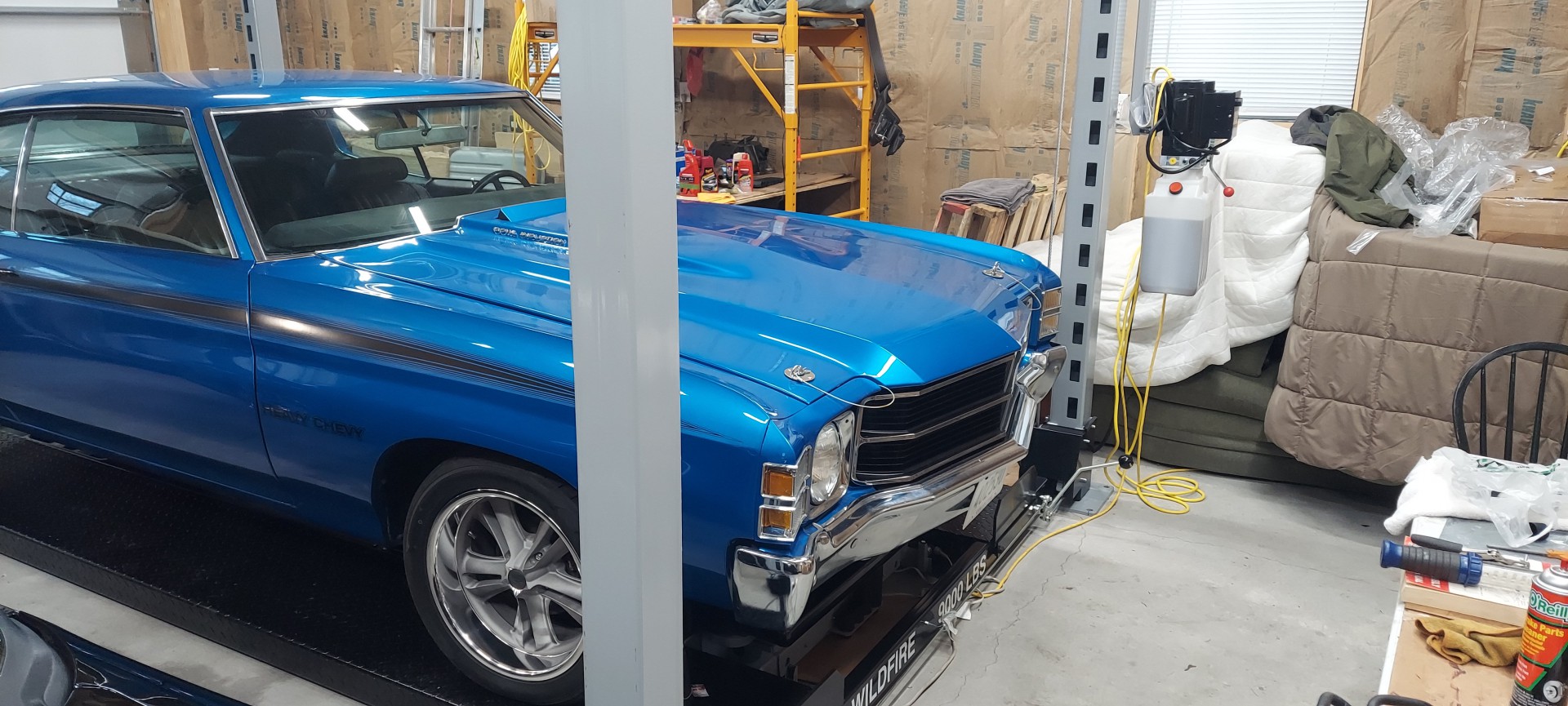

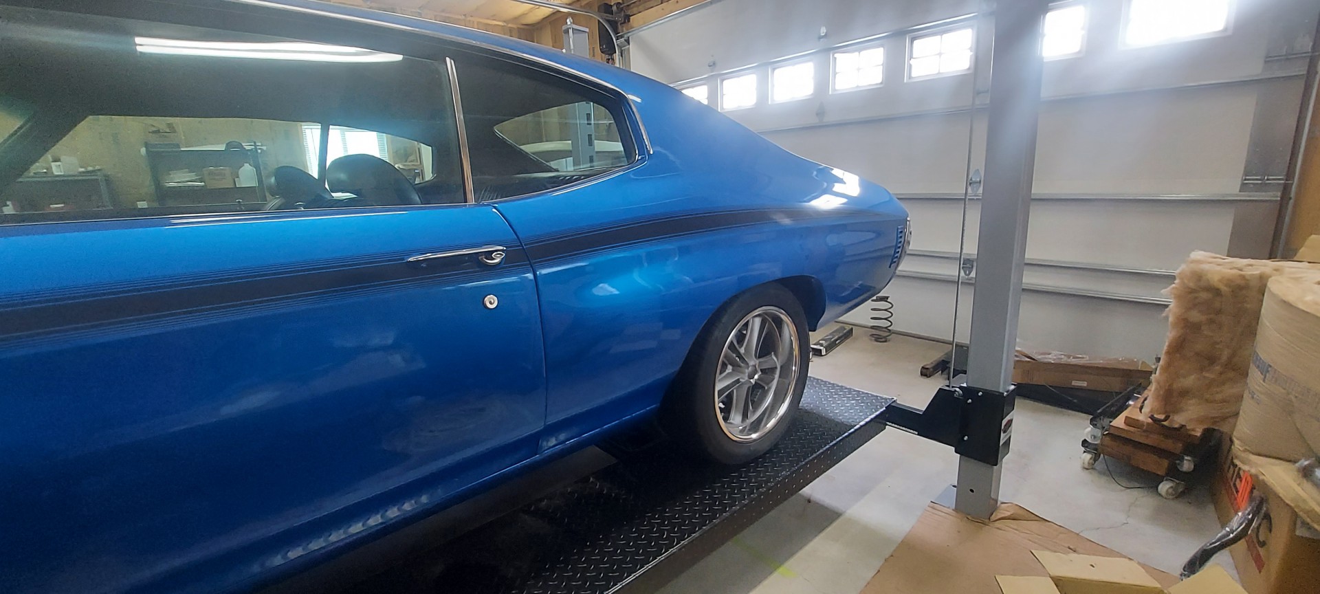

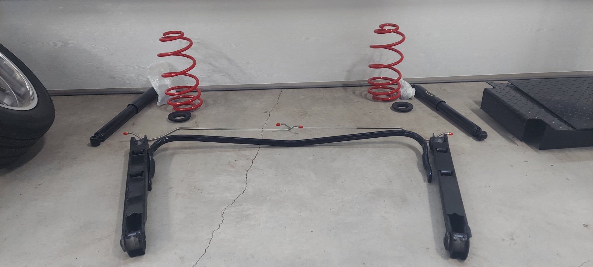

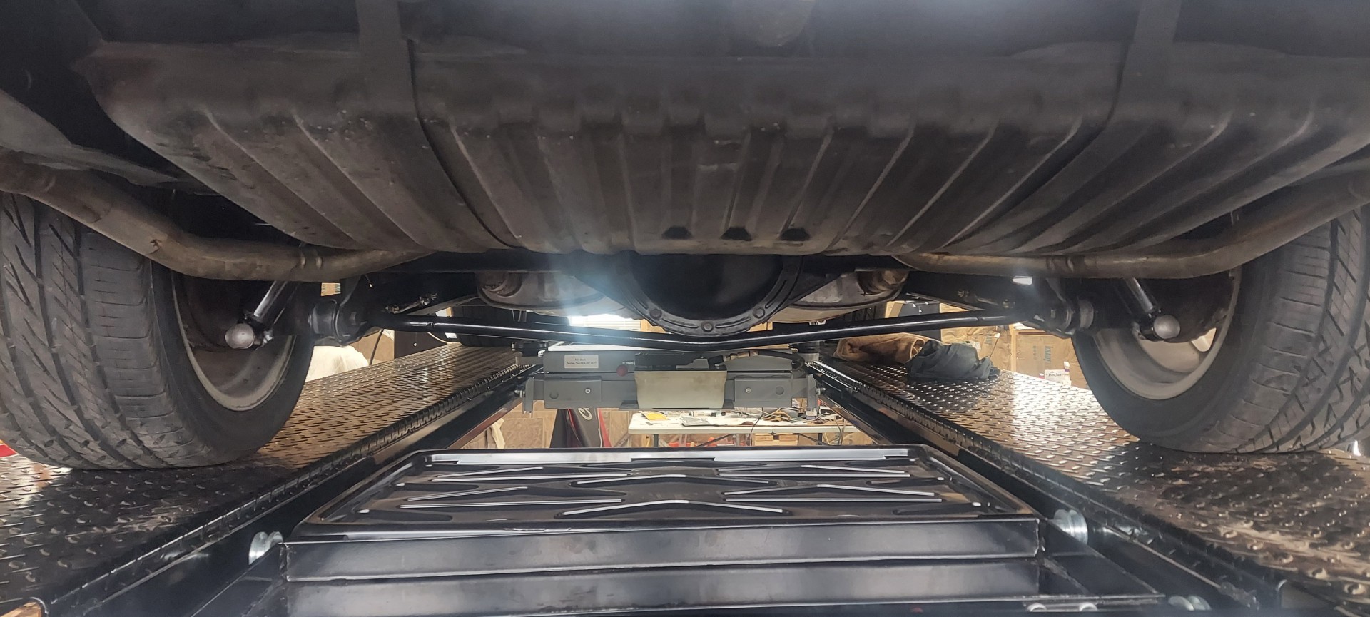

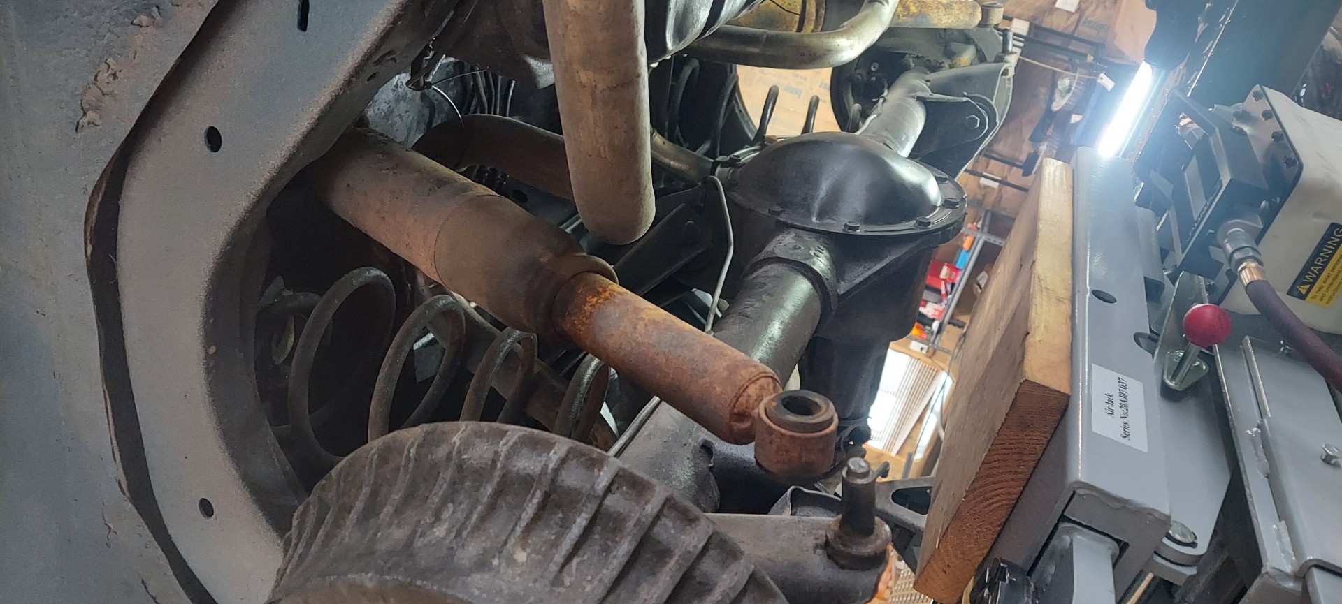

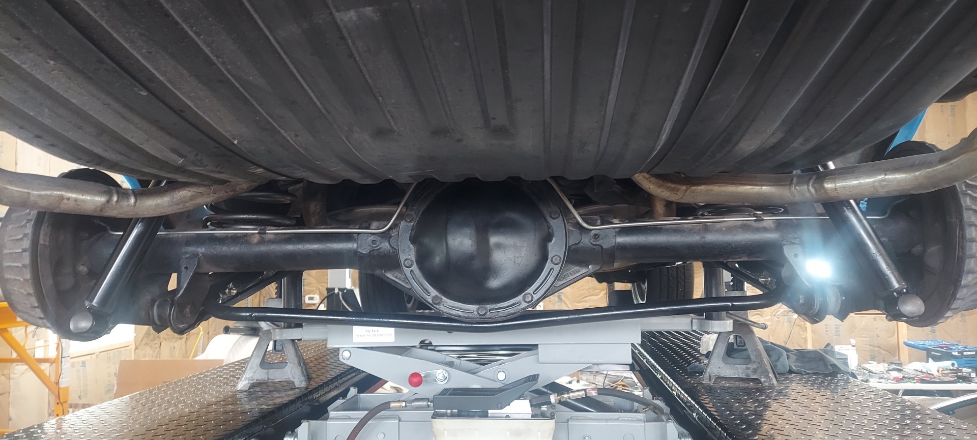

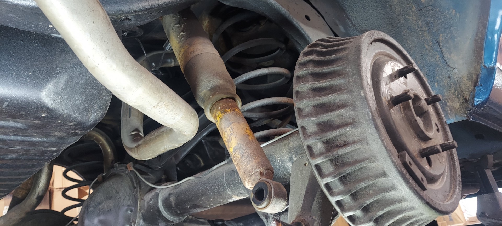

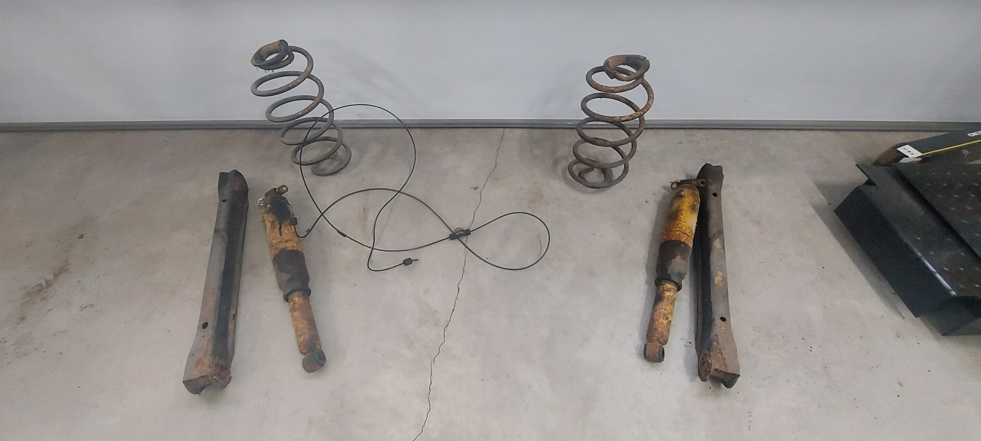

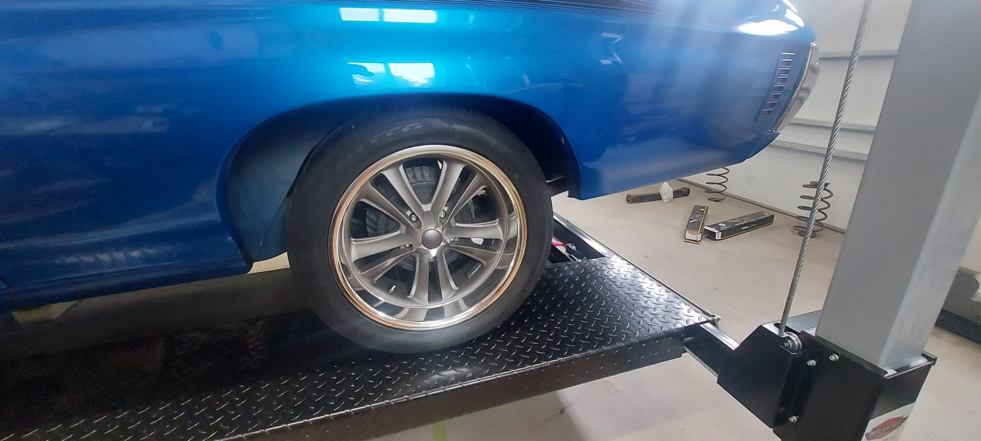

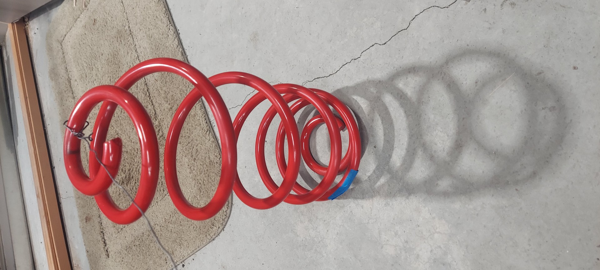

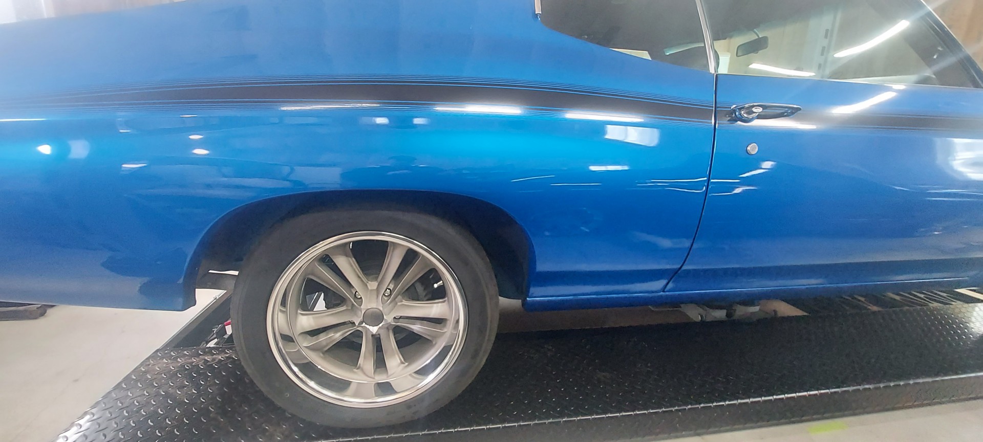

Rear suspension is done!
BMR 1" Lowering springs (They are red, but after I put one in, I had to paint them a hammertone silver)
Boxed control arms
7/8" rear sway bar
New shocks
New brake lines since I found the drivers side was pinched in a bad way. I've only driven the car from the front driveway to the shop, so guessing that rear brake wasn't doing much if anything.
The old rusty hardware fought me some, but I overcame it.
The top of rear wheel opening is now 25.5" to the ground, which is where I like them to sit. Interestingly, both sides are exactly the same which I've never had happen on any of the Chevelle's I've owned.
Front end is next for the disc brake conversion, new bushings in the control arms, and the matching 1" lowering BMR springs, a 1.25" front sway bar, and once things warm up I'll go over to U Pull It near my house and grab another Jeep Grand Cherokee steering box for the swap.
Oh yeah, since Bruce posted about his Chevelle has the control arm braces, I looked and sure enough my '71 has them as well. I'm not sure where the theory about only 12 bolts having them, but the '72 vert I restored also had them. I think it's kind of hit and miss, or as someone said...with the lives these 50 year old cars lived, who knows if someone added them or if it came with them originally.
That’s going to level out turns. And the best part, all done standing up, thanks to your new lift.
I'll be staring on suspension work pretty soon.
Looks good. Excited to hear about the progress through the winter.
Make it YOURS!
(as usual)
Thanks Mitch.
Larry, I'm finding most 71 HC's headlight trim is left chrome, but I did find some vintage ads that show 71 with them blacked out. In 72 they were blacked out across the board for HCs.
Many "sources" of info on the www with conflicting info from most. Hard to believe any of them anymore.
I tried to search info on Team Chevelle and that site is so butchered now, I can't find anything.
The only, somewhat, consistent info I find is that the HC was a mid year '71 introduction with running changes until the '72 production and they seemed to have settled into a more predictable pattern of build specs.
Build it the way you want it. I'm with ya on the bright trim and prefer that, also, anyway..
Looking good. Thought you might want to know, there was a guy who works on Tilts that has a shop right near S & M electric in Blaine.
Larry L referred him to me.
Looks Good Stan,
VANZ AUTO located at 9197 Davenport St NE
The detailing is a major improvement.
I think he is moving from where he was.
He did the column for the White Elky.
Still has two others he is doing for us.
I believe so, wasn't he on Xylite, by S&M ?
Davenport is on the west side of the airport.
Was thinking something like that would work.
He's still doing work, but dropped the business location.
I replaced the ignition switch/lock and found the on line video's helpful
Kevin, I have not done a 65 tilt column to know how different they are.
The Jan 29 head seems like a lot of lead time for the most popular engine in Chevrolet's history to be sitting around waiting for the end of April. There are no engine application codes with T in them. I suspect the block may be from a truck. You could try spraying a dusting of dark paint on the pad and brush lightly with a very fine scotchbrite pad to see if shadows of other letters/numbers will appear.

This isn't a true HC. It became a sort of HC clone when the previous owner had it painted and put the decal kit on.
I have found a couple of spots of the original green paint, but someone in the past obviously changed the interior to black. Like a lot of 50 year old cars, this one appears to have had a 'life' of changes.
I'll keep looking for other signs of original drivetrain parts. It's not a big deal if none of them match since it's a plain jane Malibu, just kind of a cool factor if they are.
The Blue is a great color on these cars, and if you do the Pearlescent White interior with it, it will be a knock out.
Boxed control arms
7/8" rear sway bar
New shocks

That's for sure Kevin. I did have to play with how high I put up the lift working over my head, but that's a first world problem.
Spending the extra money on the roller jack paid for itself already. It made it so much easier, and I even used it to press in the control arms so saved me using the BFH.
