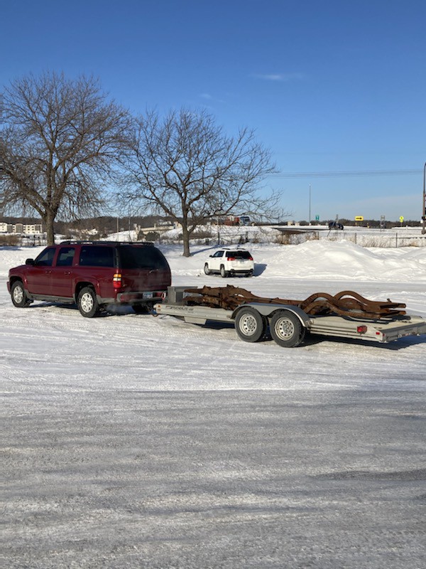

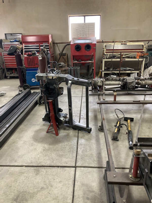

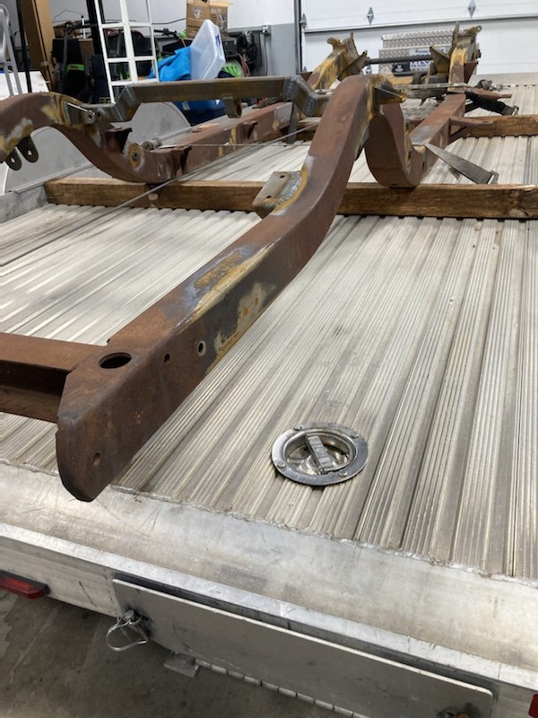

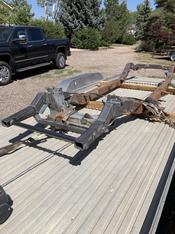

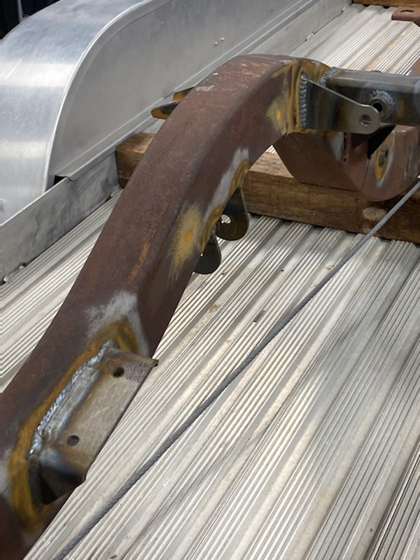

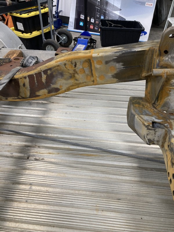

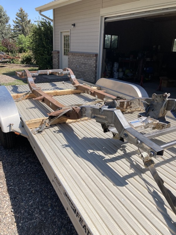

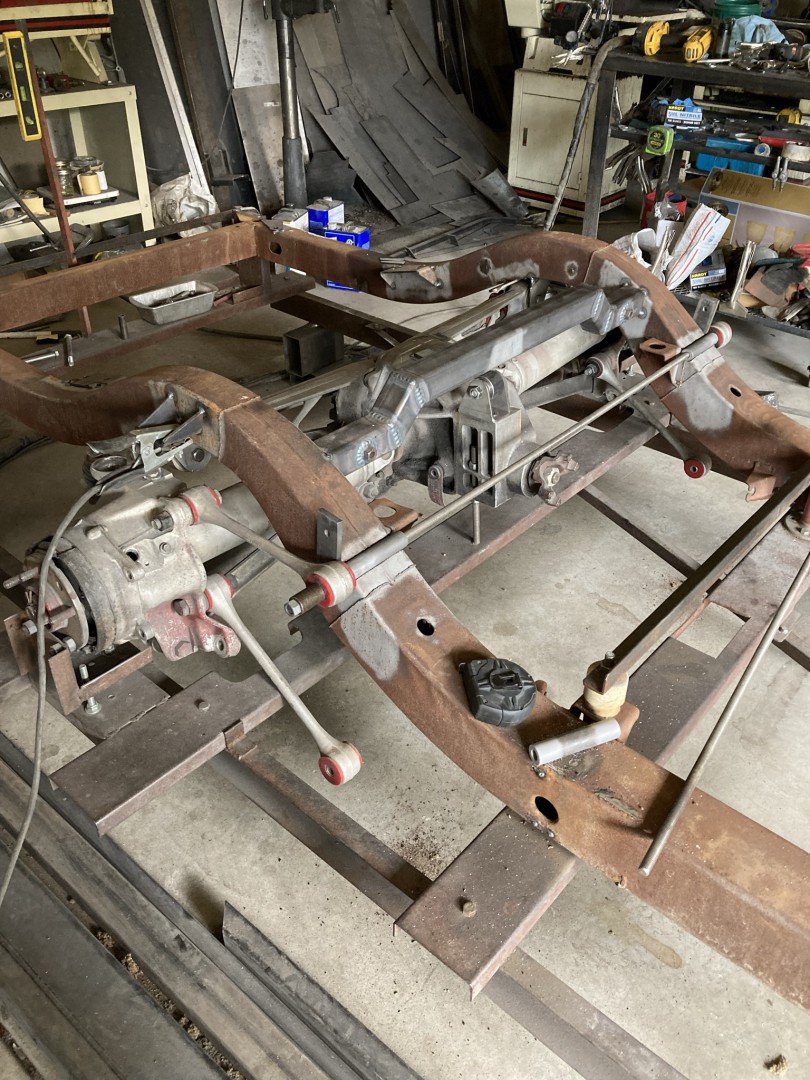

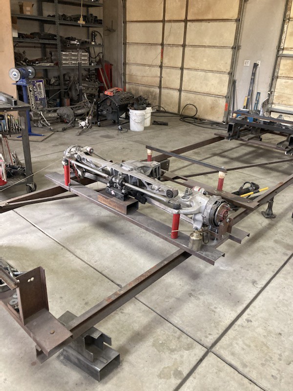

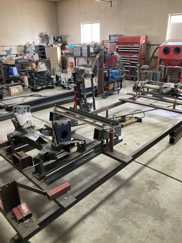

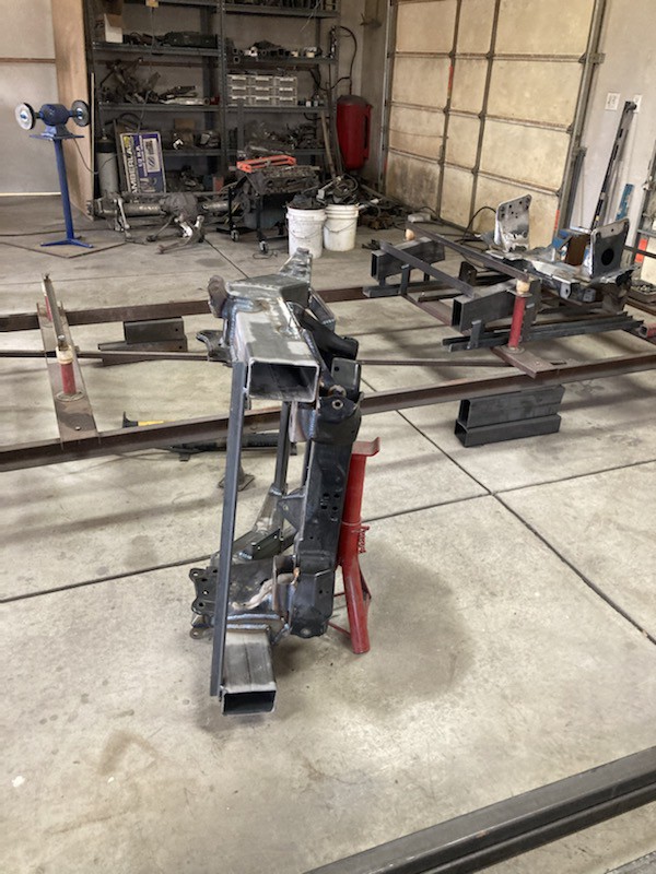

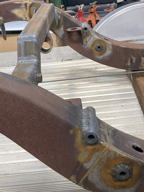

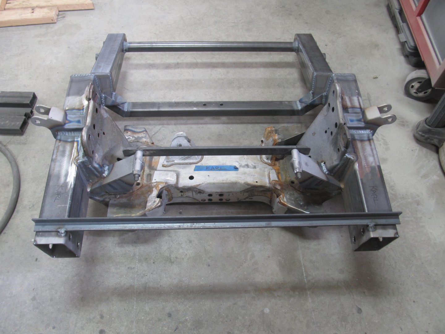

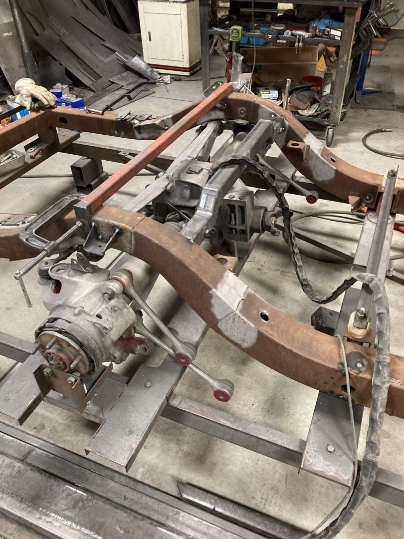

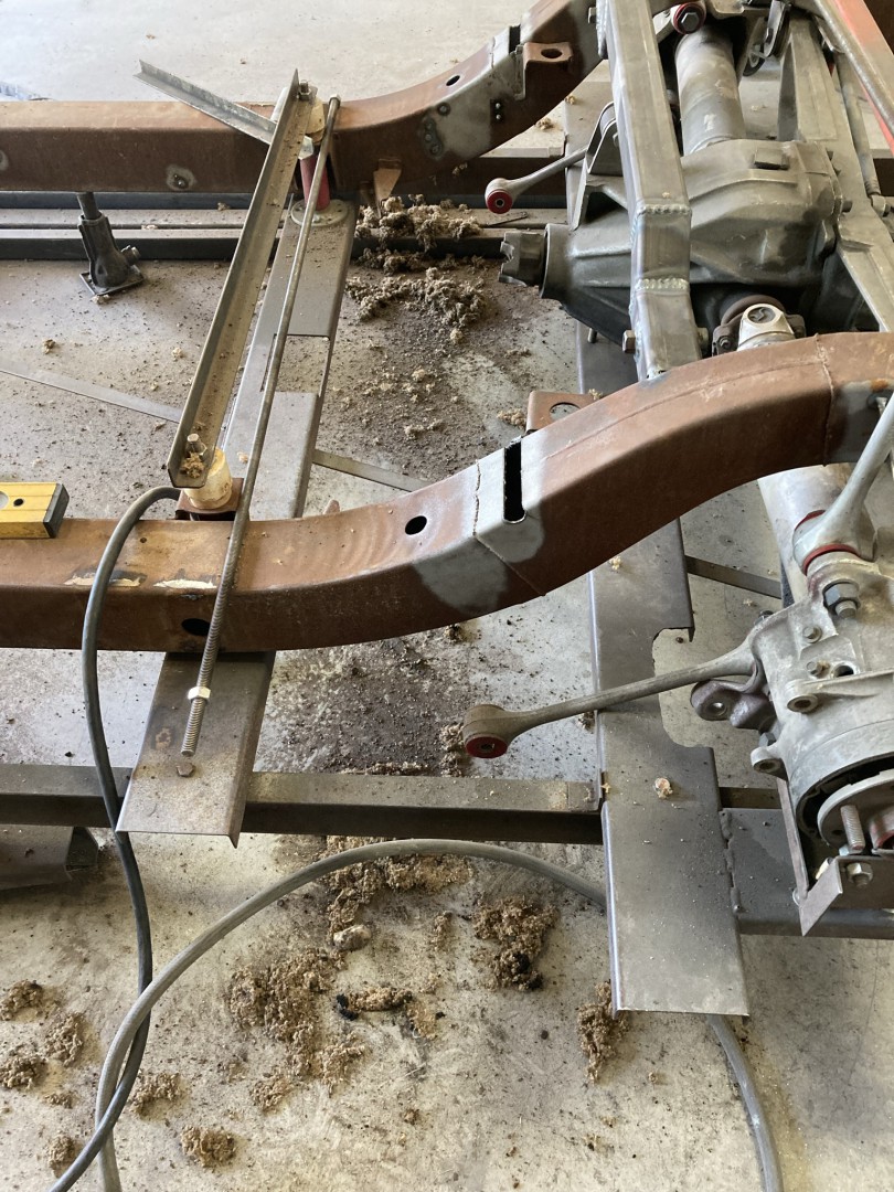

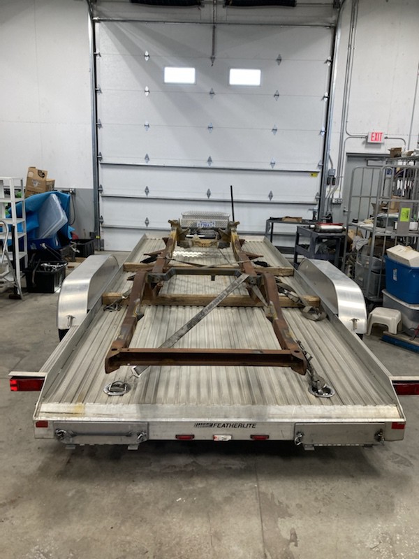

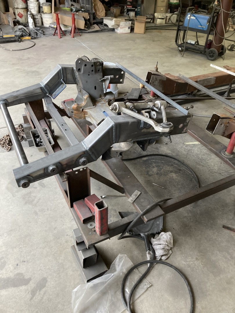

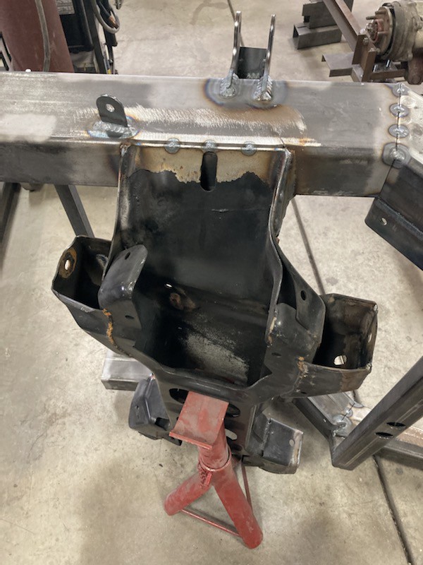

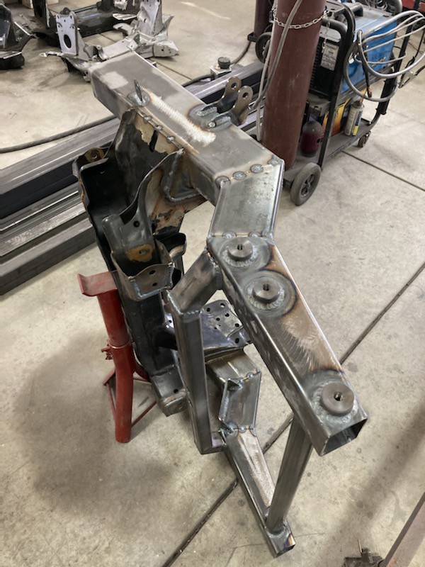

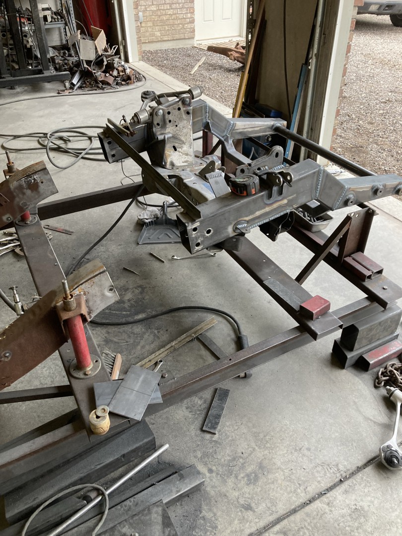

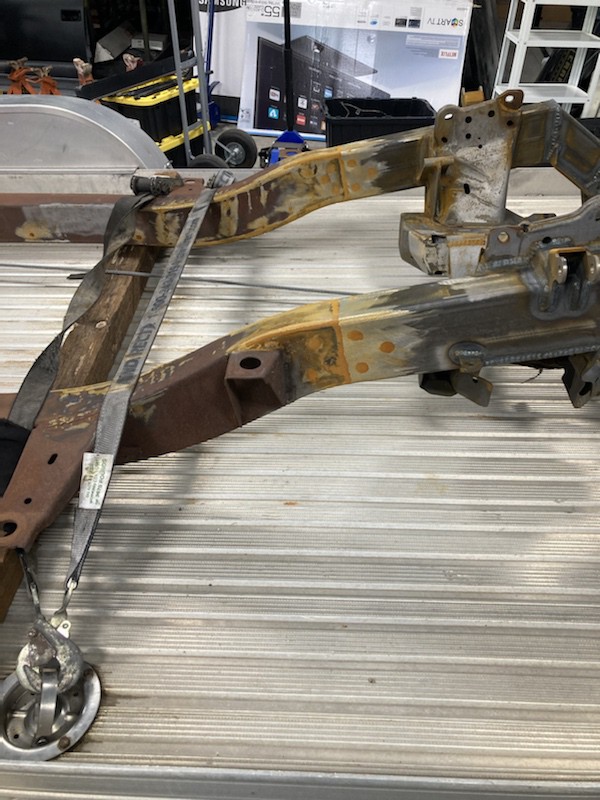

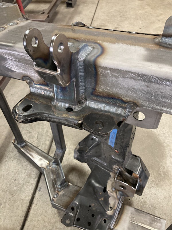

Took Seamless frame and one regular frame to fort Collins Colorado. Will be having custom stub frame and mounts for Corvette drivetrain/suspension conversion.
Pictures show jigs and equipment he uses. He has a 1956 Nomad of his own he is also doing. His fussy factor is similar to John Delke.
Name of company is Classic Edge Designs. Lazlo, is owner, he is trying to wind down business and move to Montana.
He has done over 100 of the front stub frame fabrications. Seems to do very nice work.

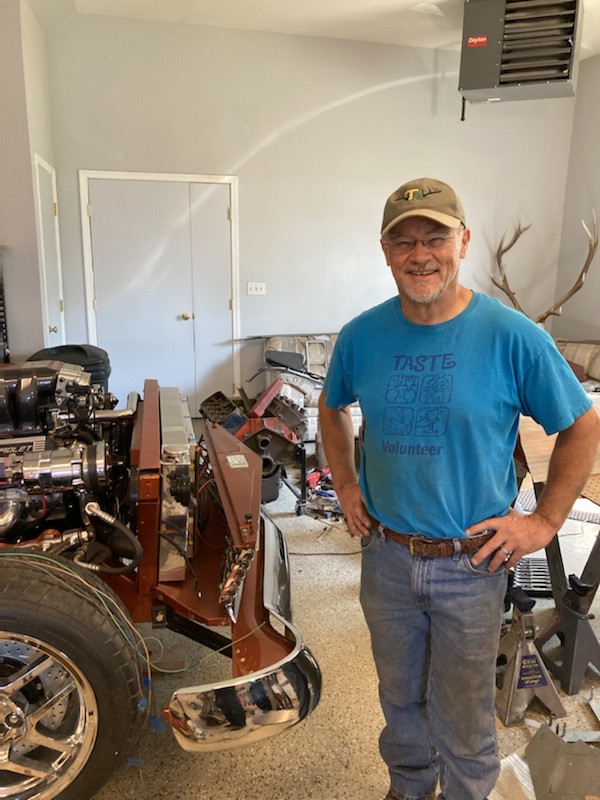

Buffy (dash picture) is my Road Trip buddy. Roger and I snuck out there Monday, back Wednesday afternoon.
Fun trip, really nice guy. Looking forward to outcome.

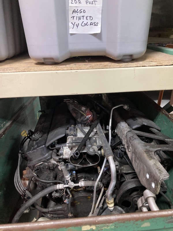

No major progress here except I did sell the LT-4 Vette. I learned what I needed to know by driving it.
Mounts in subframe are for traditional small block, if I move far beyond that configuration, there are multiple conversion mounts available. ITZHIZZ was too nice, complete and unmolested to carve up.

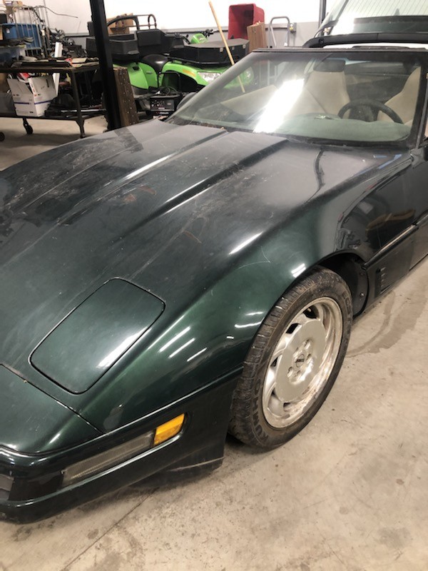

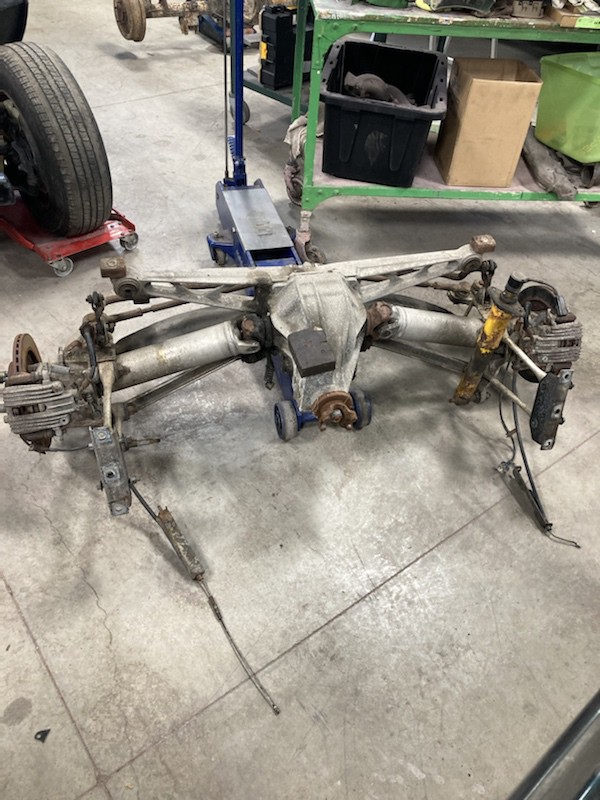

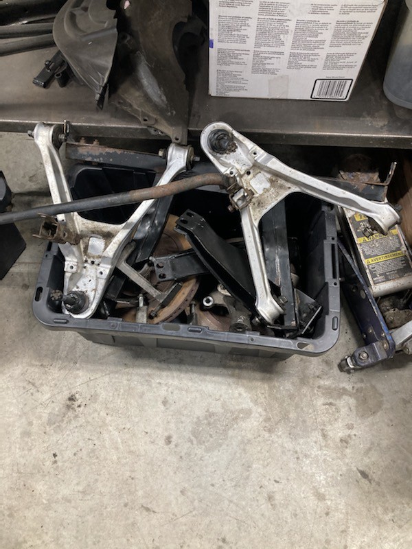

When I bought the green 1995 Vette it gave me everything needed for the suspension conversion. (at far lower cost) I will review drivetrain options AFTER all suspension and steering is mocked up. Pretty sure that will be at least another year from now considering my other irons in the fire.
Still have the other 1996 Vette to verify assembly. That one is complete, runs, drives, has salvage title.

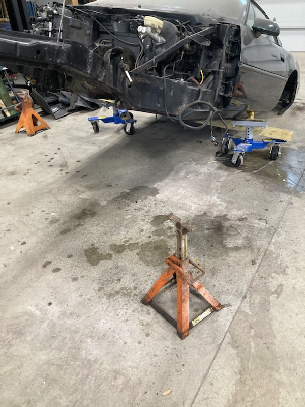

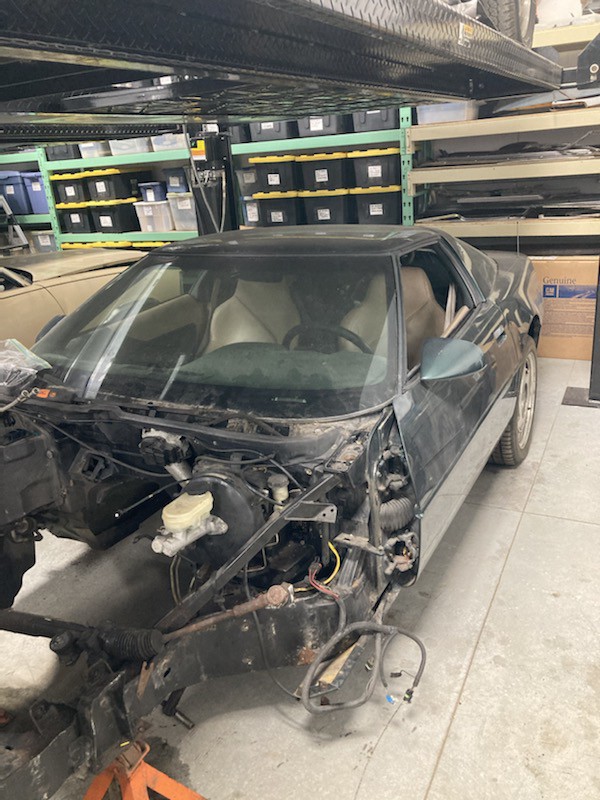

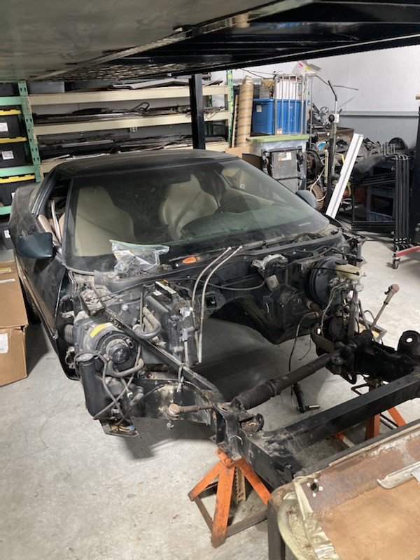

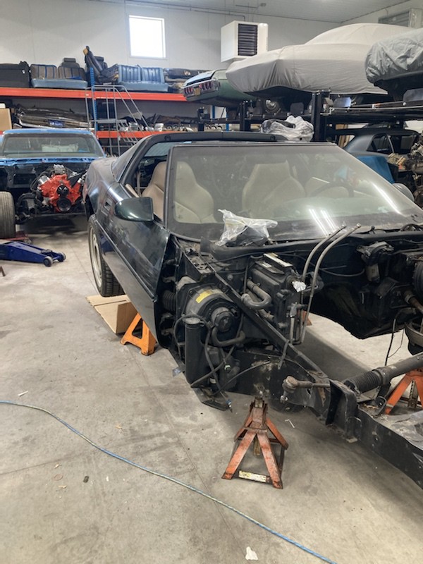

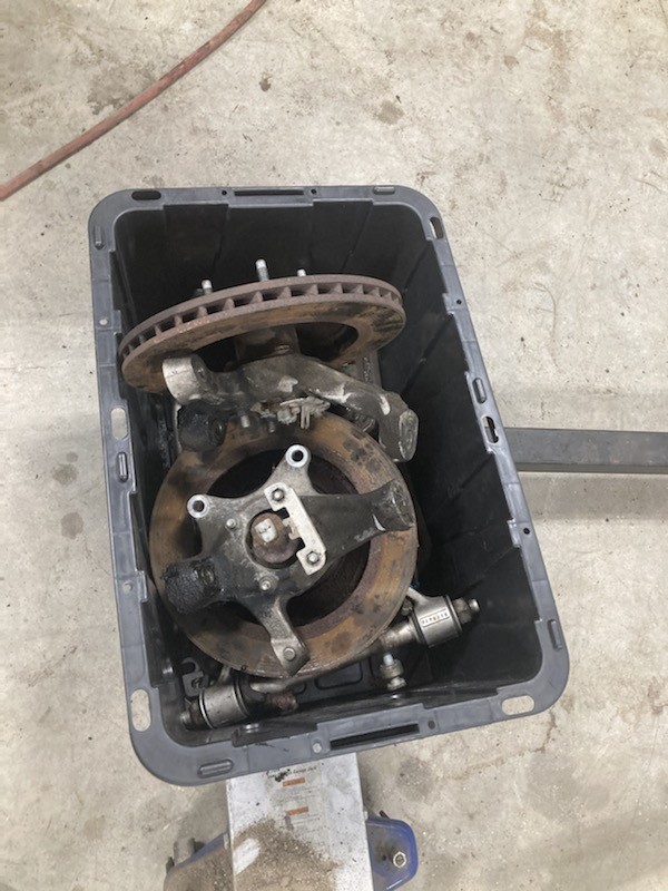

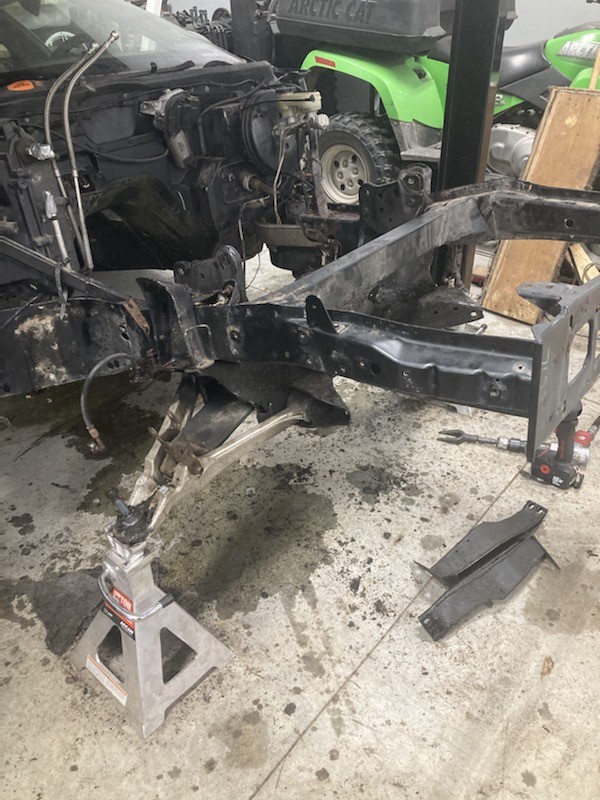

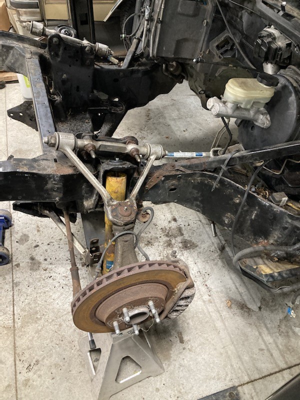

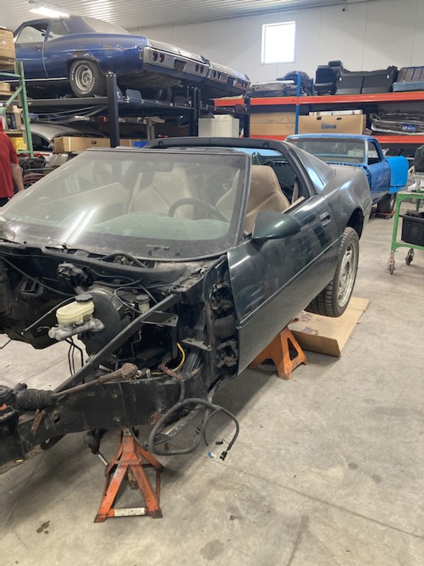

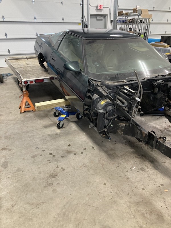

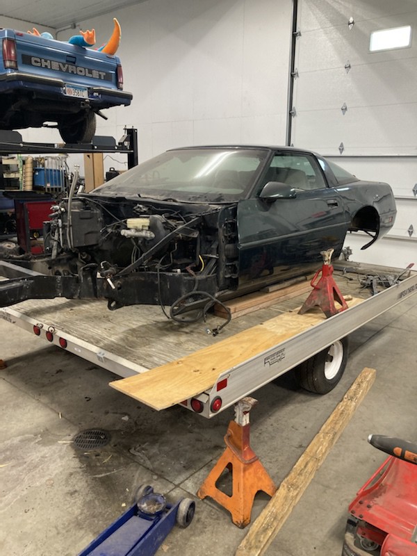

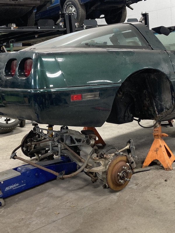

Getting serious again. Moved Donor shell out of stall, placed on Stands.
Now drop rear suspension and harvest other stuff i think i will need.
Then shell will get planted on old snowmobile trailer, covered and set outside.

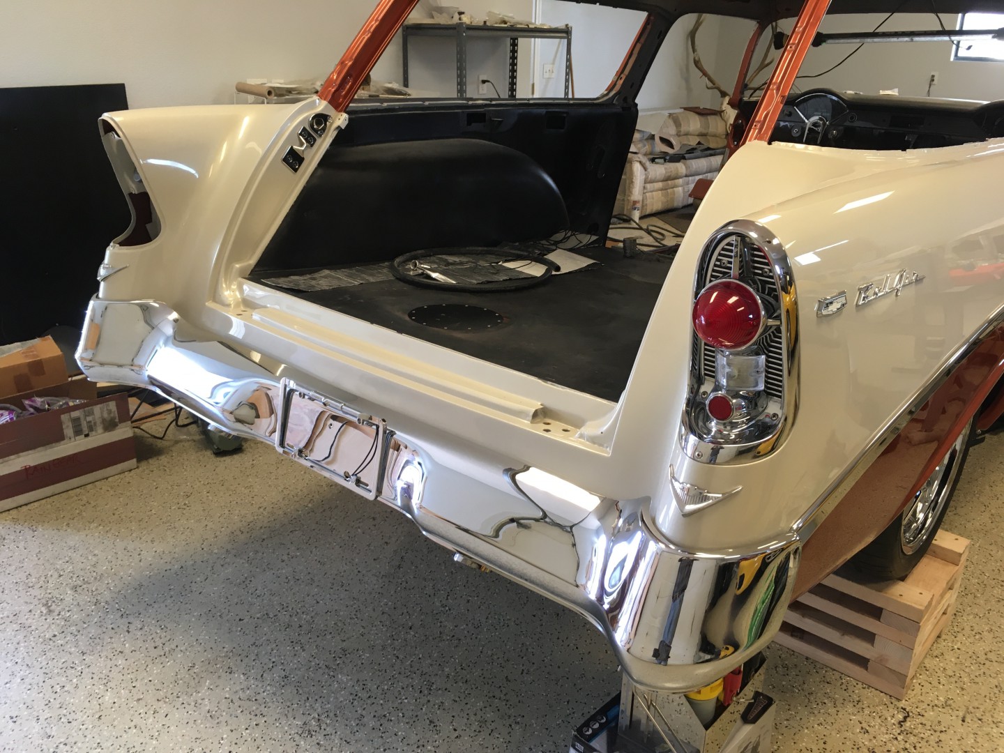

There's a black '55 150 Handyman wagon I see at a lot of local cruise-ins that has that same C4 conversion chassis by the same builder.
I talked to him about it a little a couple weeks ago, and he really loves it. :)

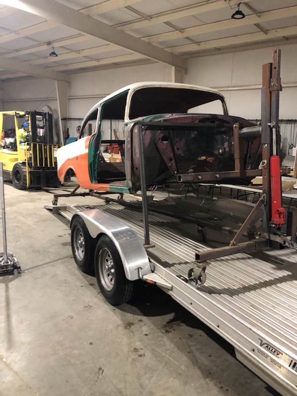

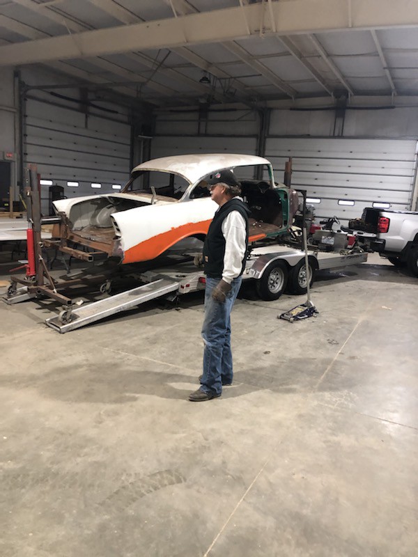

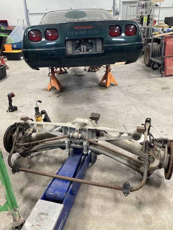

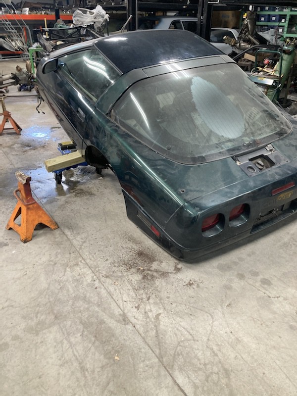

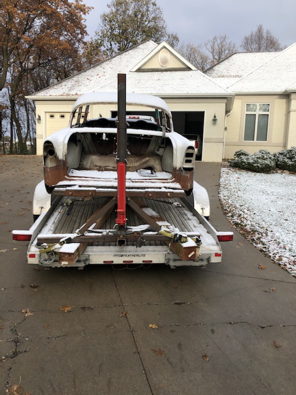

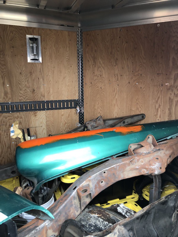

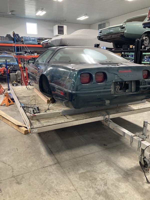

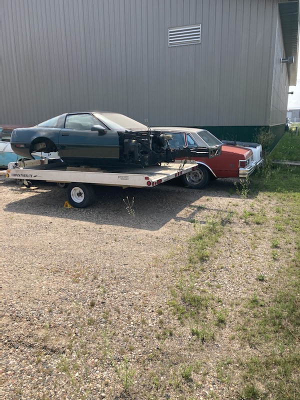

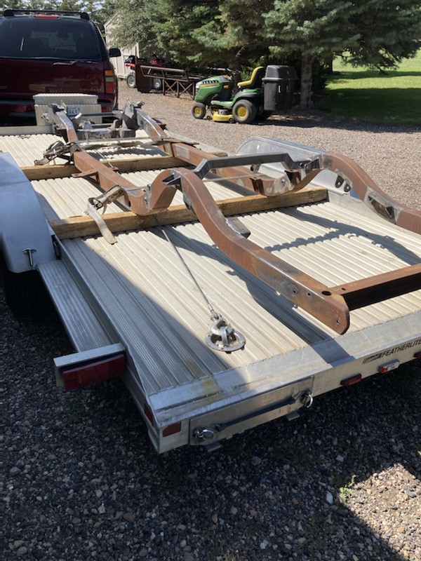

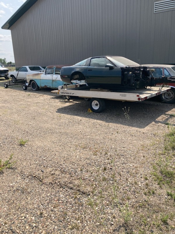

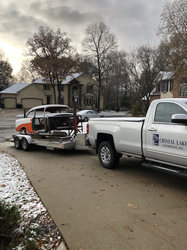

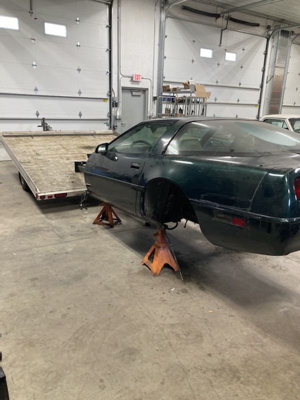

A couple mor pictures of the Corvette storage loading.
Roger suggested reversing body on trailer, made sense as far as balance goes.
Some shots of that plus the crash to floor
-- Edited by more ambition than brains on Monday 19th of July 2021 12:34:09 PM
Going to be exciting !!

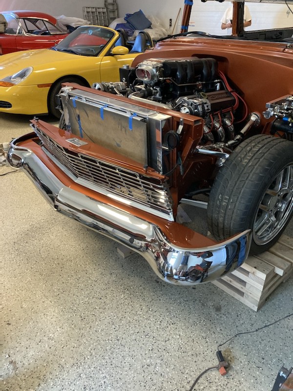

Wow, nice car. Dave, Centerline owner, had me order a 1 piece floor for his Nomad and a cargo floor without the spare tire well. I ordered a sedan tank for it and the filler neck will still be behind the tail light.
Aug 27, 2021

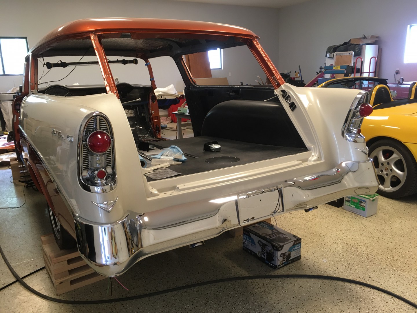

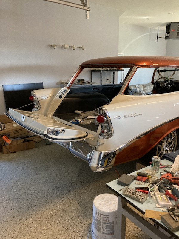

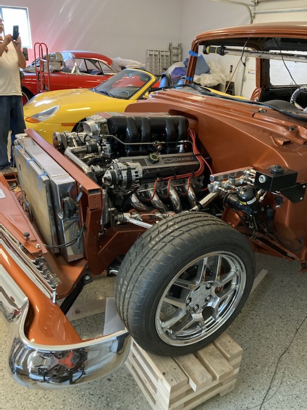

Back from Fort Collins Colorado. Rained all the way through Iowa and Minnesota on the way back, therefore the new bare metal is gaining the same patina as original frame. Some Pictures:
These are shots of Builder and his 1956 Nomad, in process for a while.
Reminds me of my Blue Elky timeline, but his car is INCREDIBLE!
Looks great !! Yep, get it blasted and painted. Easy to touch up after mods down the line.

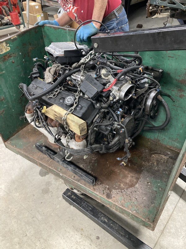

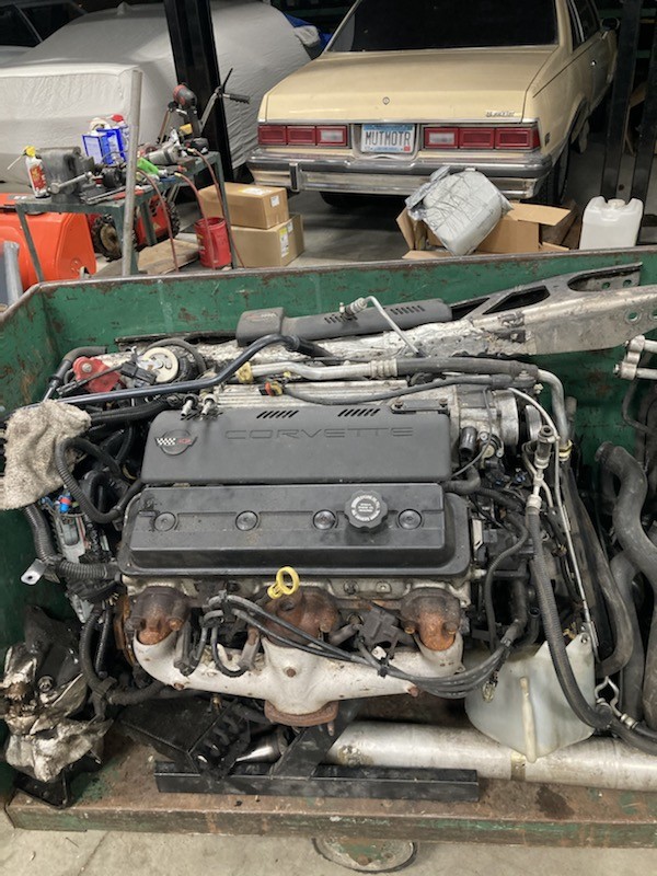

OK, now committed on engine. Purchased a 30,000 mile 1996 LT-4 drop in package from a wrecked Vette. Car was pristine, damage to left rear.
Have been watching for possible engines since I sold the other 1996 Anniversary LT-4. Trying to find a low enough mileage unit so it dos not have to be "refreshed" Hopefully this is the one.
Should arrive in a couple of weeks from Ohio. Now, l need a Chevy bolt pattern 200R4 core to either get built locally or use as core for exchange. Going with Overdrive automatic, I can shift Biskwik if I have the urge.
Pretty sure my Tranny Shop buddy Duane can loan me a bare core for mocking up and fitting drivetrain and suspension. Most major decisions are made now on Engine, transmission, differential, steering and suspension for this 56.
Fuel system, brake system will evolve as I move forward. My Frame builder in Colorado can fill in a lot of knowledge voids on best choices.

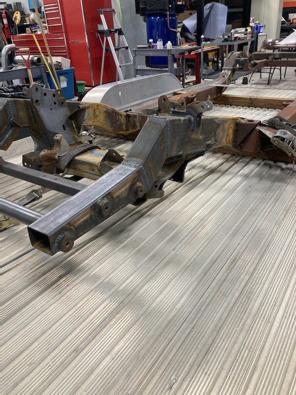

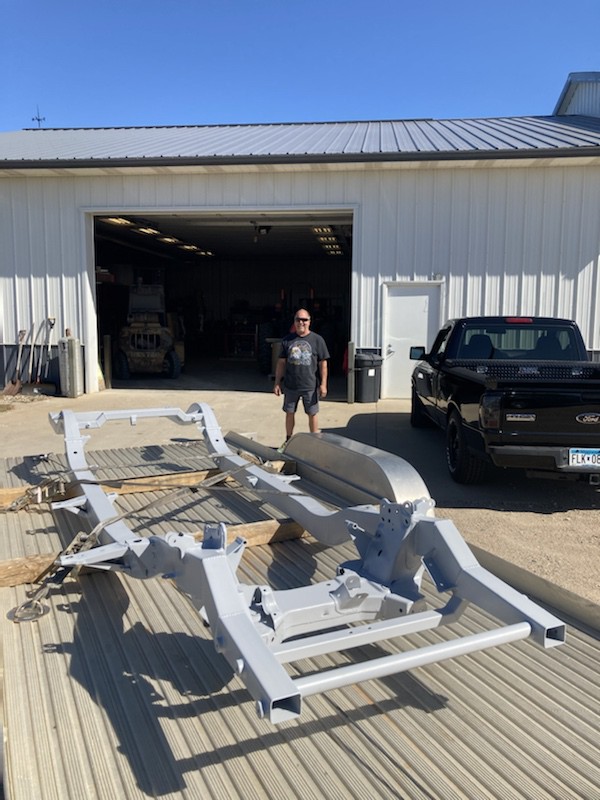

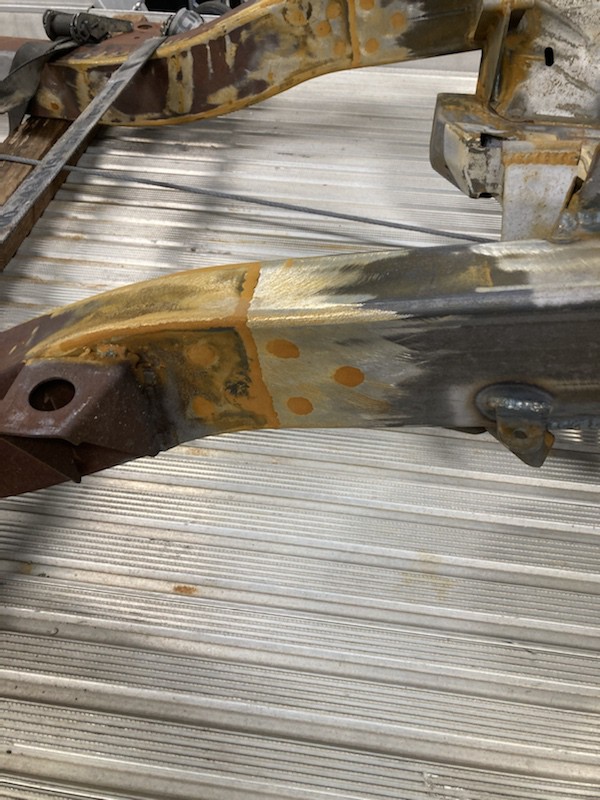

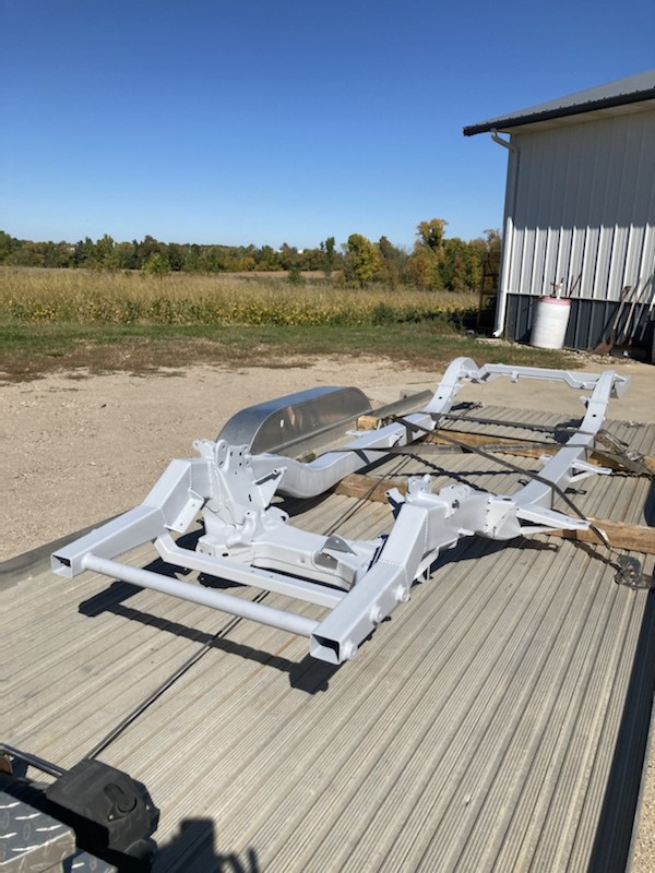

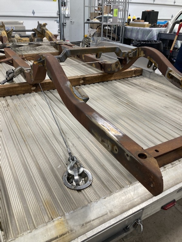

Frame went to sandblast last week. He also epoxied it to protect. Picked up today.

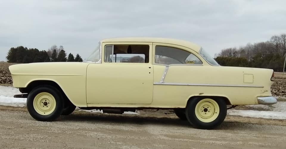

As previously stated in the Elky thread, my first real car was a 1956 Bel Air 2 door post that was wrecked and partially repaired.
It was a 265, three speed on column. No other options to speak of. Crocus Yellow and Black.
I pretty much beat it up, destroyed it and ultimately parted it out. It was gone by the time I was 19.

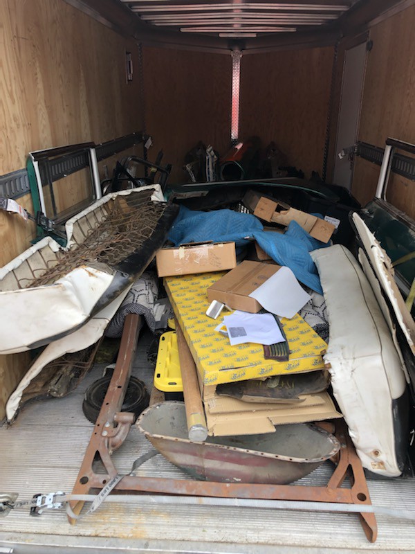

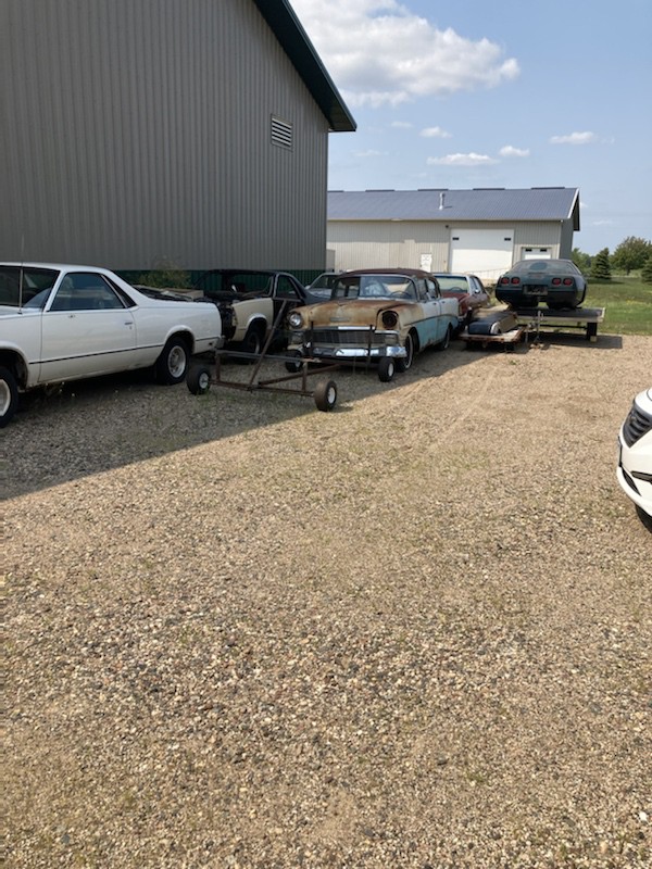

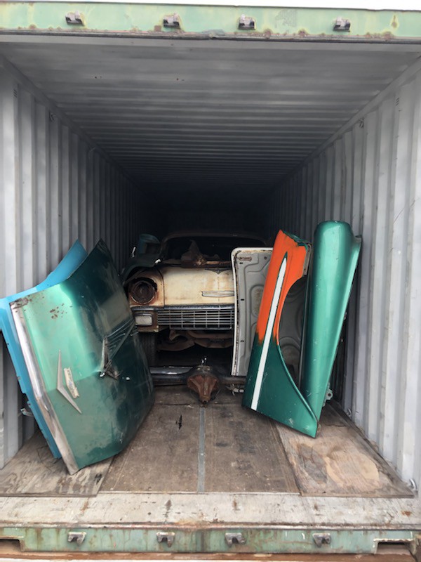

Auction in Iowa provided another puzzle piece last year.

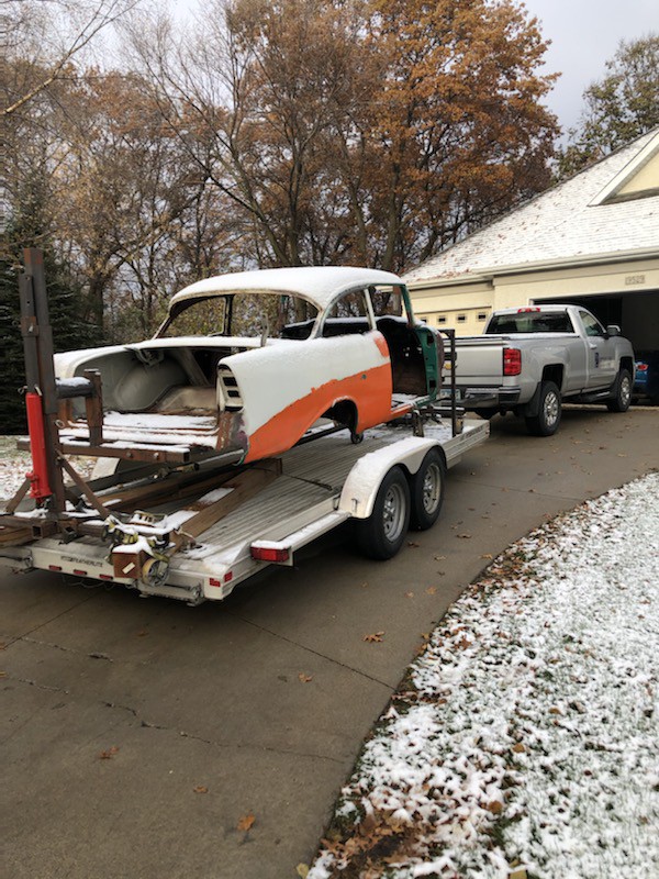

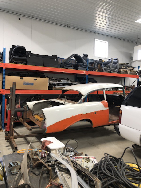

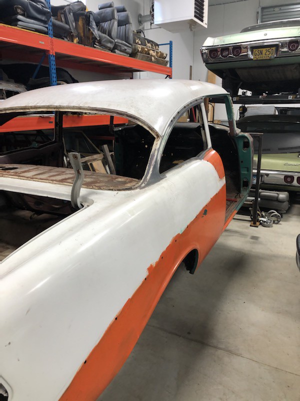

This is my "Basket 56" with title and a bunch of parts. Picture shows the car prior to when it was taken apart.
Bought the car, rotisserie and the parts pile. Roger and I used two trailers to bring it "Home"
Basically a "Pile of Bones" with title.

I always wanted a red and black one.
I never liked the Crocus yellow.
I am mellowing with age though.
I used to call it baby s**t yellow.
Frame to be modified is on trailer, crossmember is going out for chemical stripping.
Need to haul to Colorado for stub frame and modifications.
My '55 was "Harvest Gold" (yellow) with white top and turquoise & beige interior... awful combination.
I've never been much of a fan of yellow either, but for now it's going to stay. Eventually if I ever do a full resto on it, I want to paint it '66 GM "Aztec Bronze"
With Cortez Silver highlights somewhere, to commemorate the donor...
Those are the colors, however, Bel Air trim and colors reversed.
If I am going red/black, hood must be red.
Donor Car/Parts
Scattered all over the Shop.
LT-1 motor did run, will use for Mock-up after Frame returns from Colorado.

ROAD TRIP!!!!!!

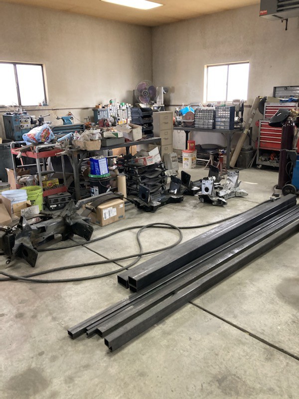

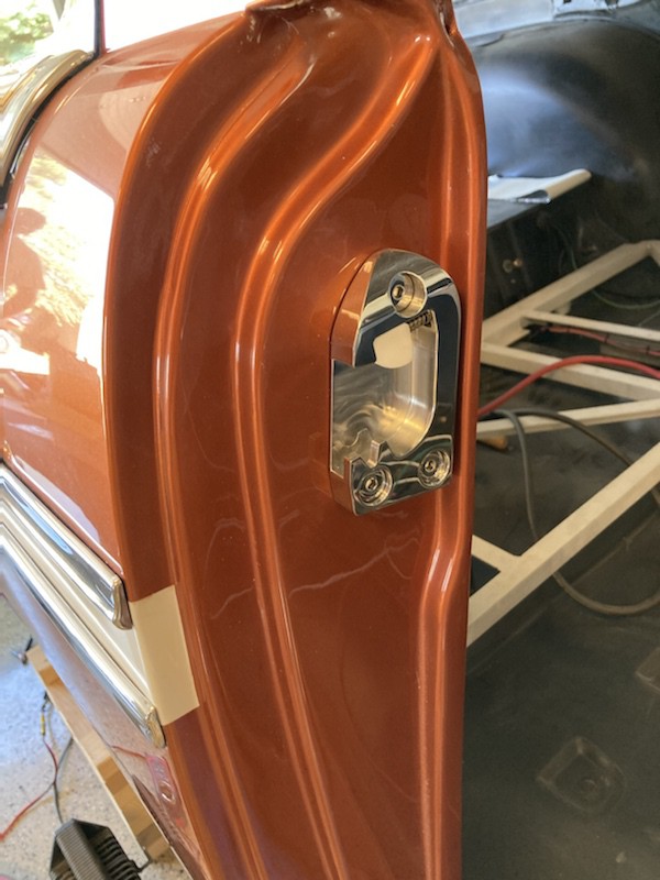

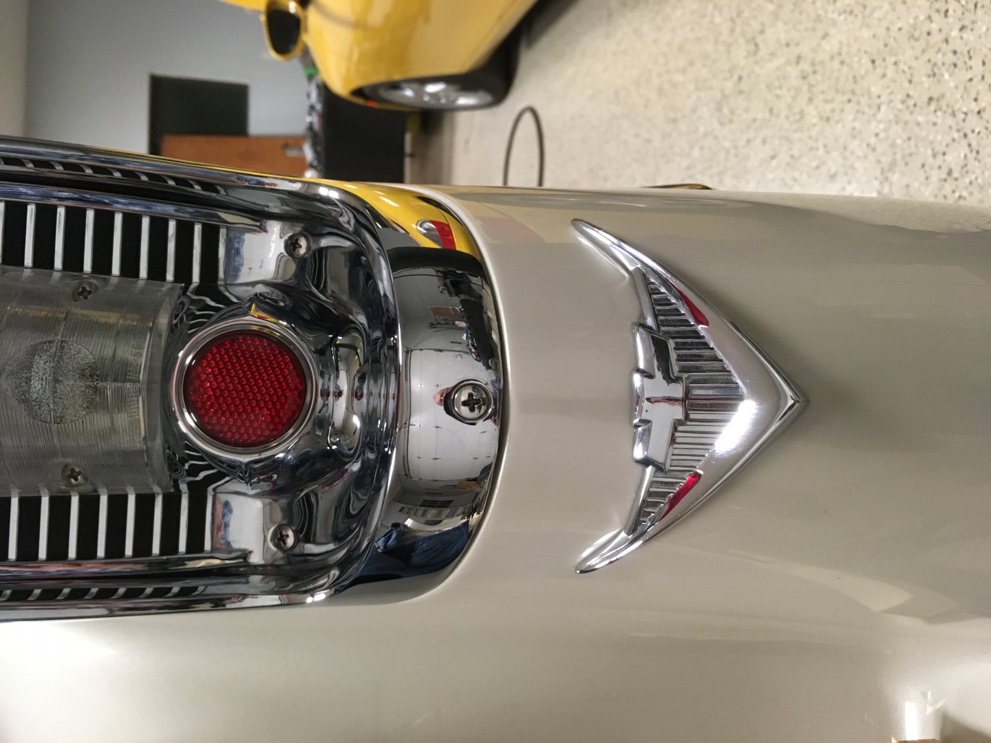

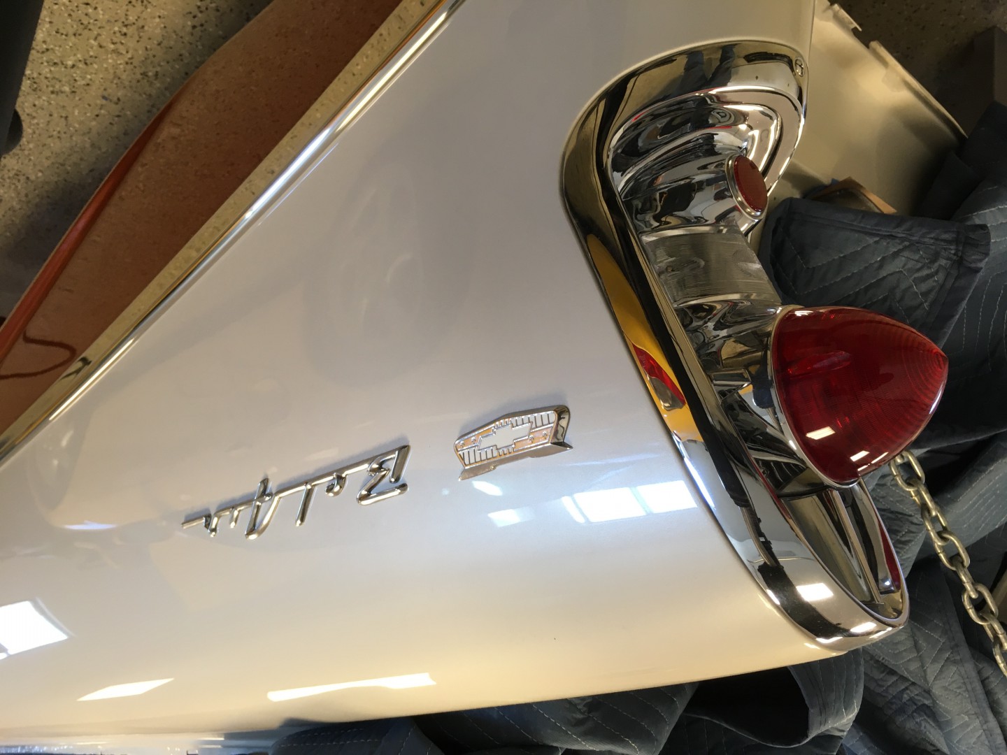

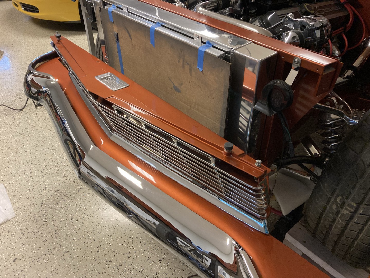

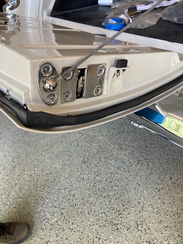

These pictures are of the 1956 Nomad my Frame fabricator is building.
A level of detail that is AMAZING!
John D. should approve of the color combo.
Are these bc/cc paints of the original Sierra Gold and India Ivory ? The Ivory appears to have a hint of pearl in it, unless it's just the lighting.
Definitely Pearl on the Ivory, probably Tri- stage on both.
Gorgeous, almost the best finish i have ever seen.
Pictures do not do it justice.

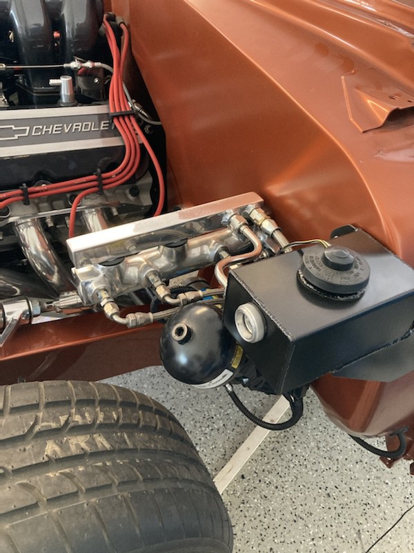

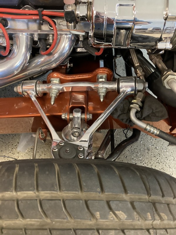

Front frame stub us built, Corvette crossmember fitted and welded in place.
Small block motor mounts fabricated, fitted and installed.
Don't really know why on the branded title, but for my purposes it is all I really need. Now I have only six (6) cars for the Shoebox project instead of seven.

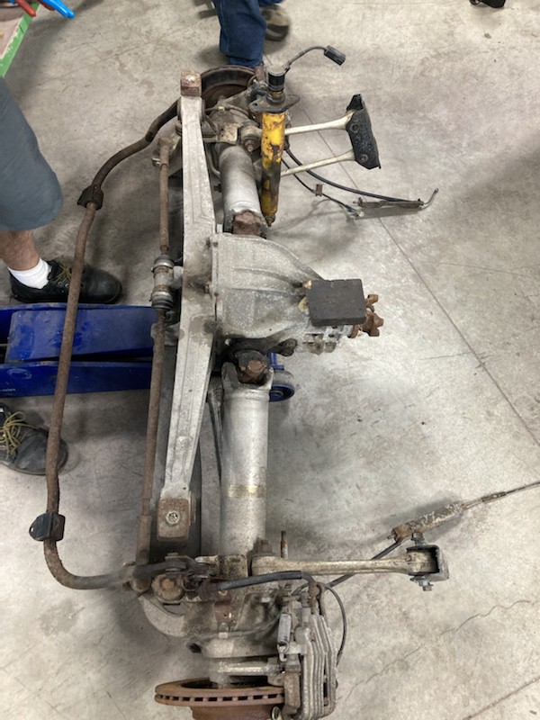

Carrier assy. removed all together.
It is a Dana 44 HD as hoped.
Now strip a couple more items, swap top from other silver 1996 silver Vette. and set on snowmobile trailer for storage.
Will cover with tarp, still may need some pieces.
Carrier assy. clean and wait for modified frame to come home from Colorado.
More pictures of load.
Can get a lot done if not too worried about scratches.
Cable puller 101, plus skates.
Cable pullers to coach in place.
Used engine hoist on front, skate center rear, blocked up middle when in place.
THE BONEYARD
-- Edited by more ambition than brains on Monday 19th of July 2021 10:07:38 AM

More Nomad pictures
Some Pictures:
His anal pucker factor is significant!
Amazing build, amazing guy!!

He and his son:
Cleared all old hardware, installed replacement mounts for C-4 suspension front and rear.
Modified, fitted and installed front C-4 crossmember.
Now back in my court for assembly of suspension an everything else.
I am beyond pleased with the outcome. Have to love the welds.
I can only weld if there is a grinder nearby to "dress" my miserable effort.
His son is the welder.
I may have my sandblaster give it a shot, so i can dust some epoxy or something on it, it is too pretty to stare at the rust.
Picked up today.
See the smiling Sandblaster/primer specialist.
Now start bolting together.
