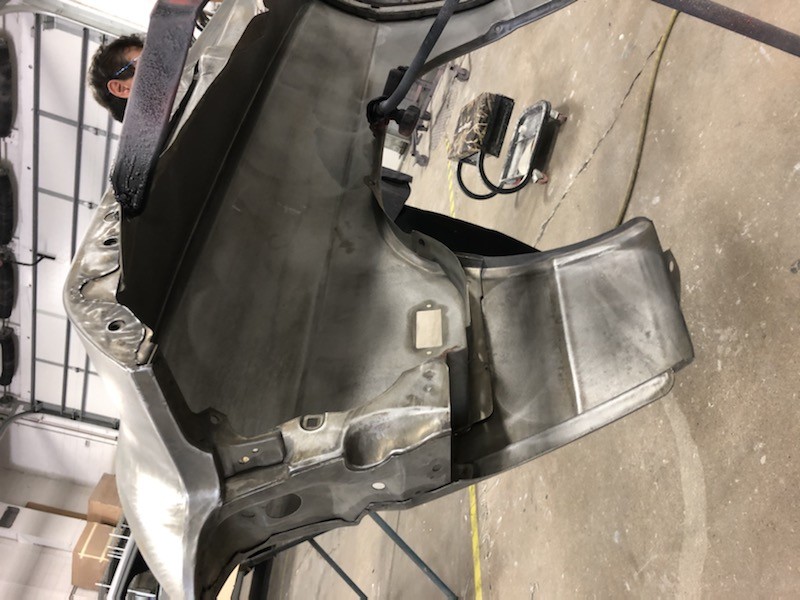

Ron ground many of the factory welds, knocked off the slag and retouched many of the weld seams.
We had it Sandblasted in Shakopee, he detailed it a little more, then down to Blooming Prairie.
They cooked it to remove oil from inner rails and touched up the sand blasting.
Did the Prime, bake to gel primer spray color and re-bake.

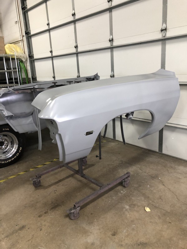

Jul 31, 2020

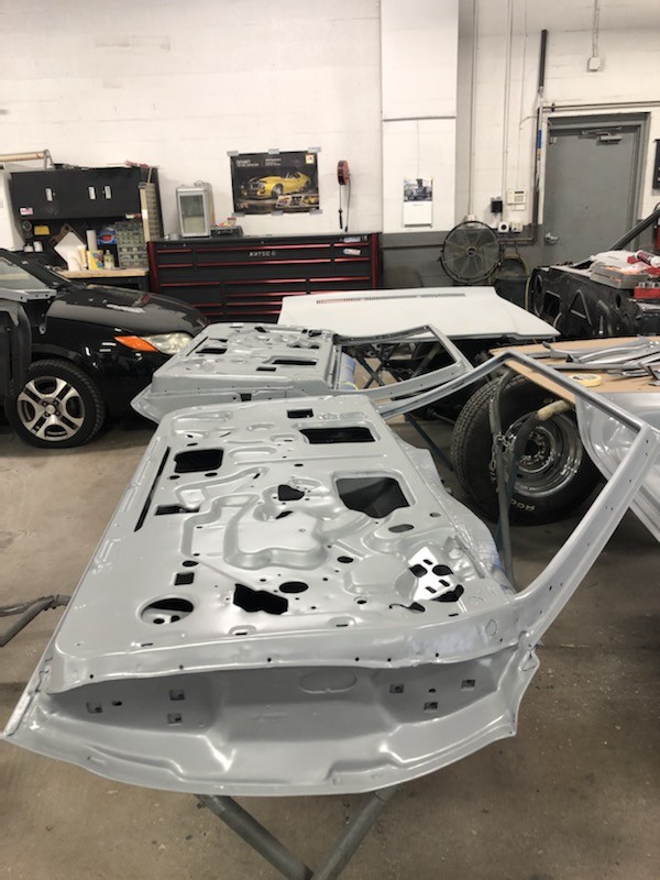

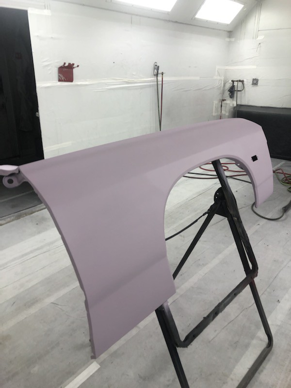

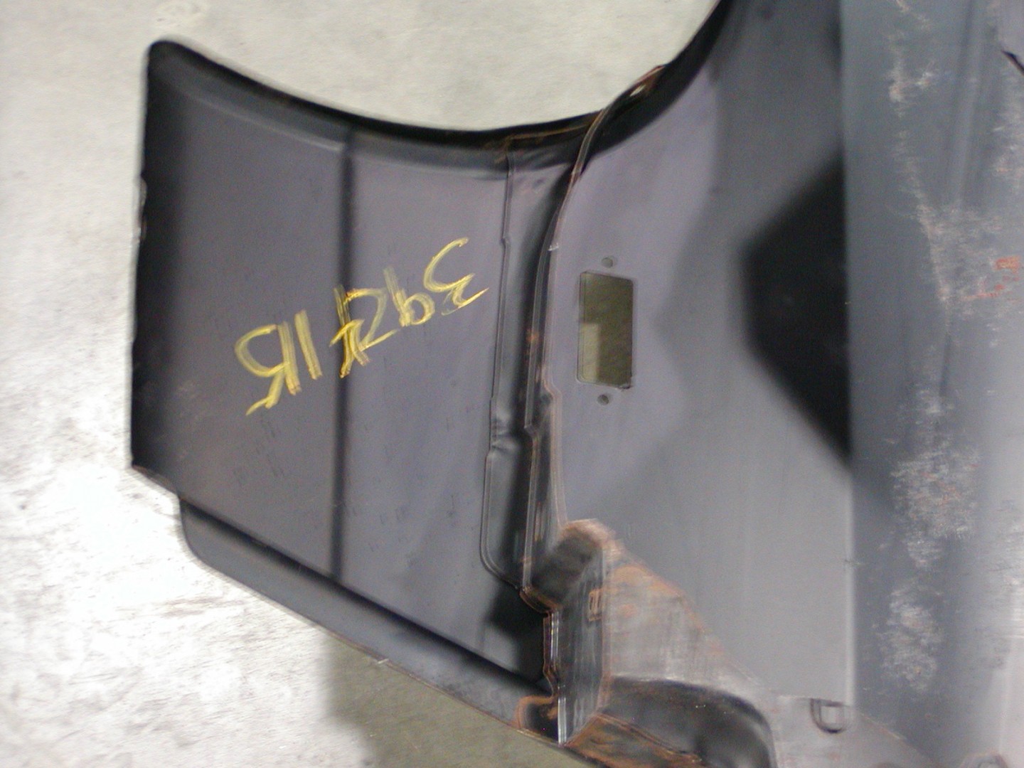

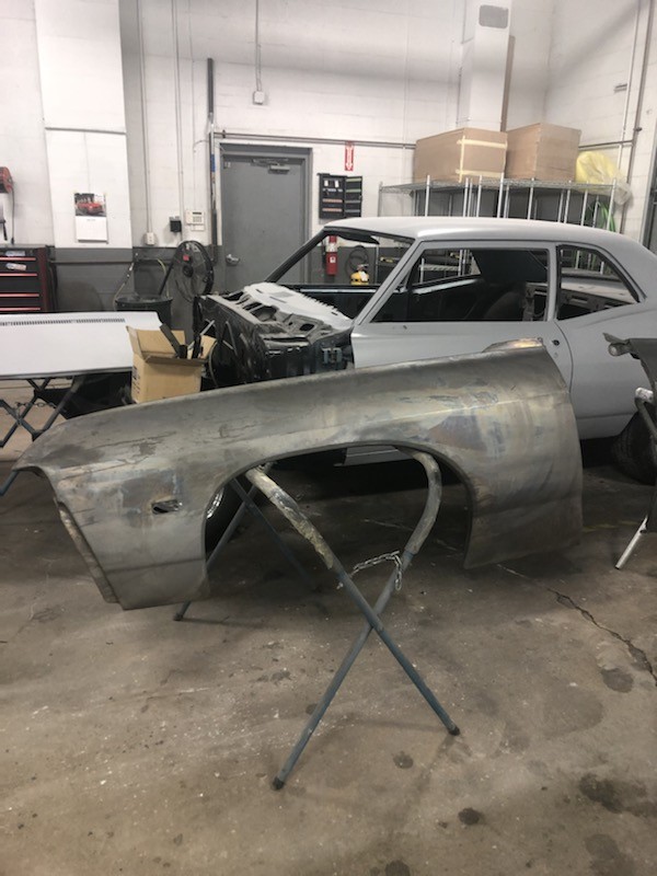

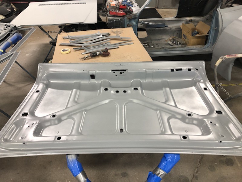

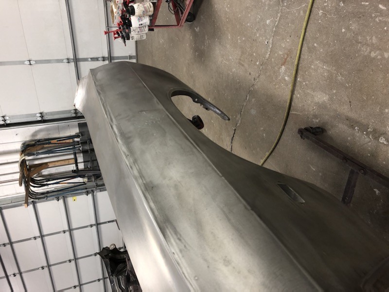

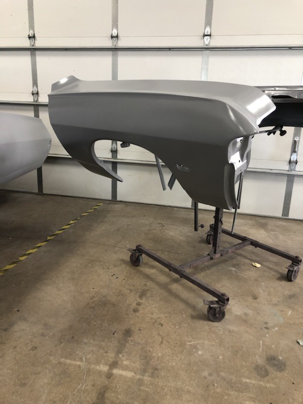

Fenders being prepped for Epoxy and sprayed.
Now they are ready for repair of dents.

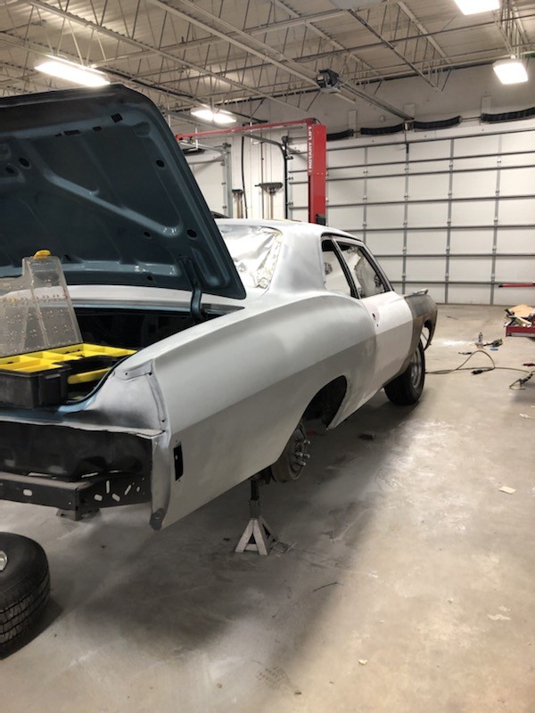

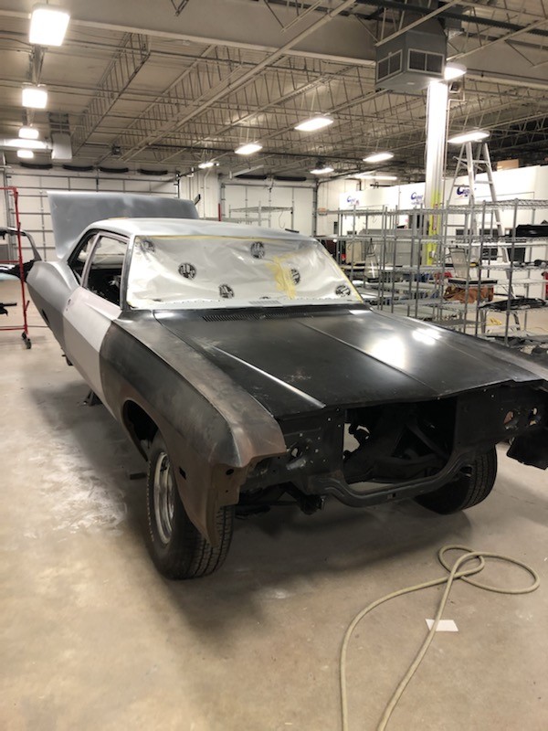

Aug 5, 2020

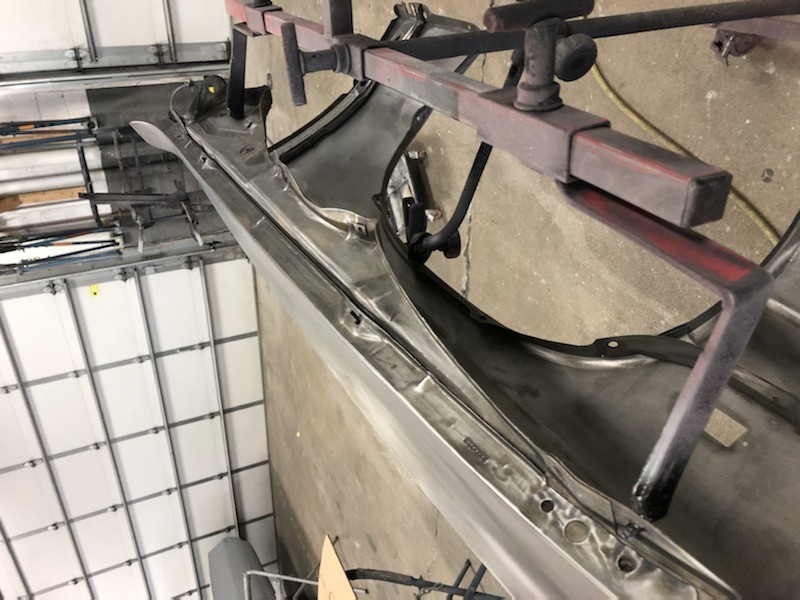

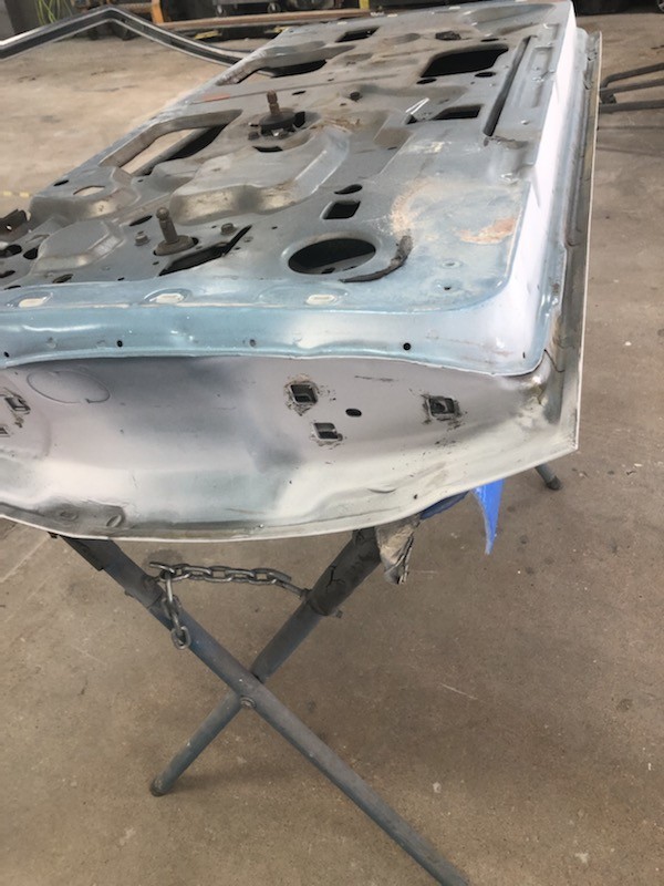

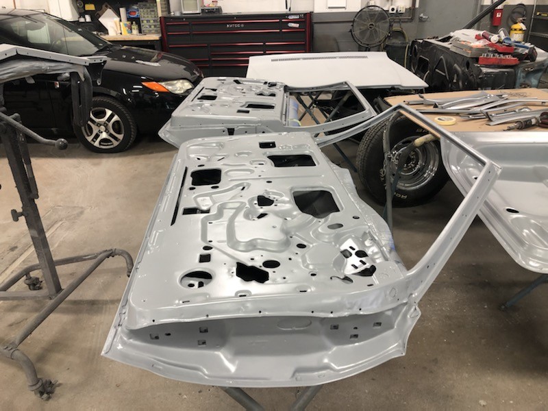

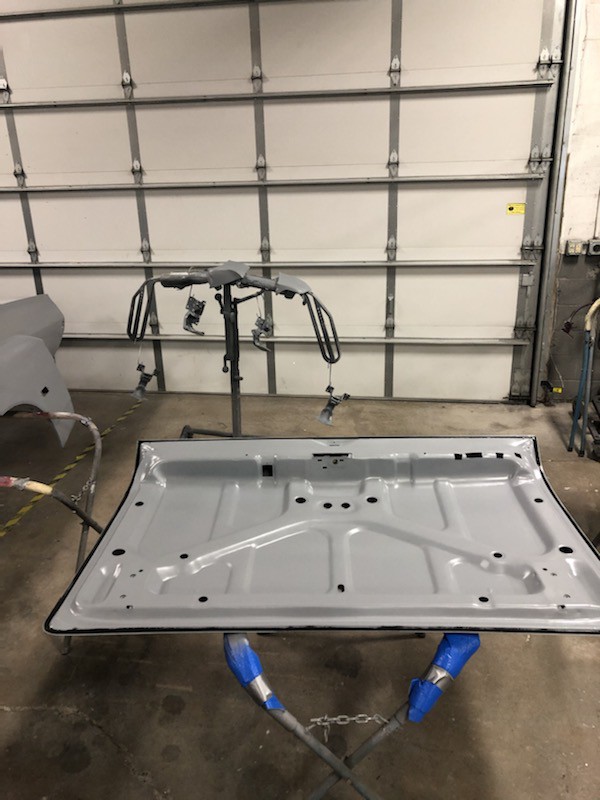

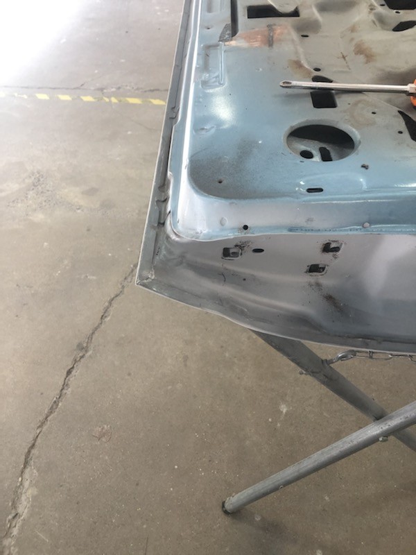

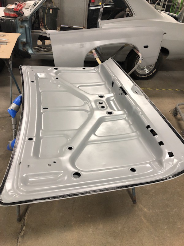

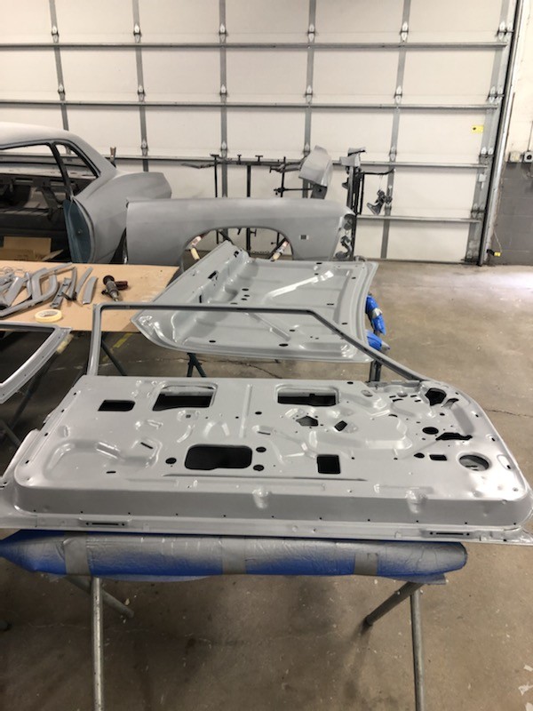

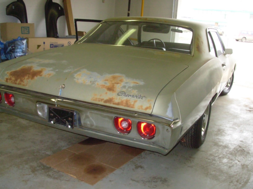

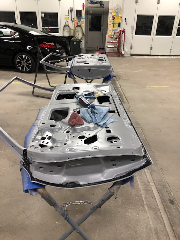

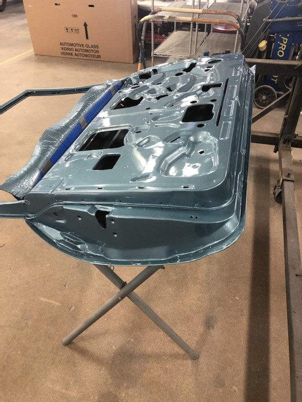

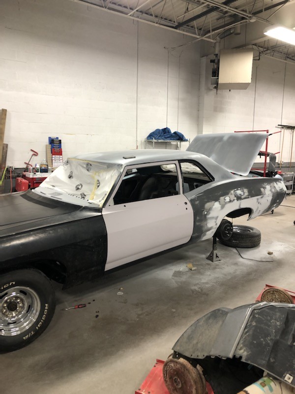

Doors and deck lid removed for Edging (cut-in) I bought this car because it was almost rust free and partially repaired. Many major things completed. The door bottoms are an example of that, PRISTINE!
-- Edited by more ambition than brains on Wednesday 5th of August 2020 05:54:21 PM
I'll second that !! Did it have the light blue cloth interior too ?

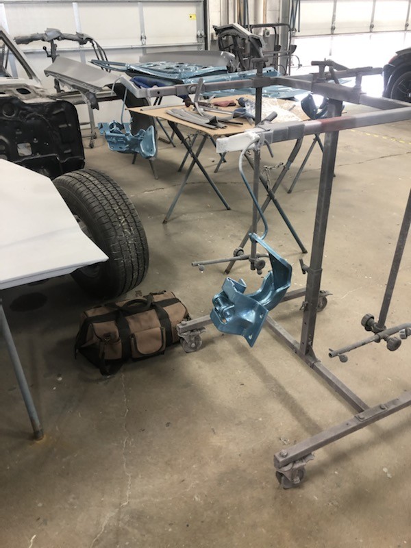

Aug 22, 2020

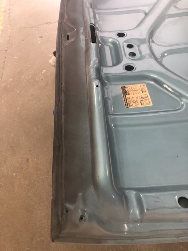

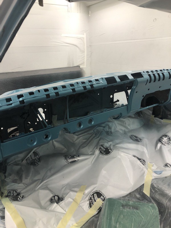

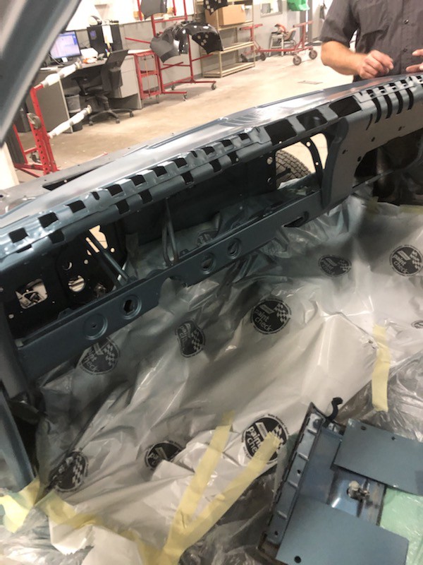

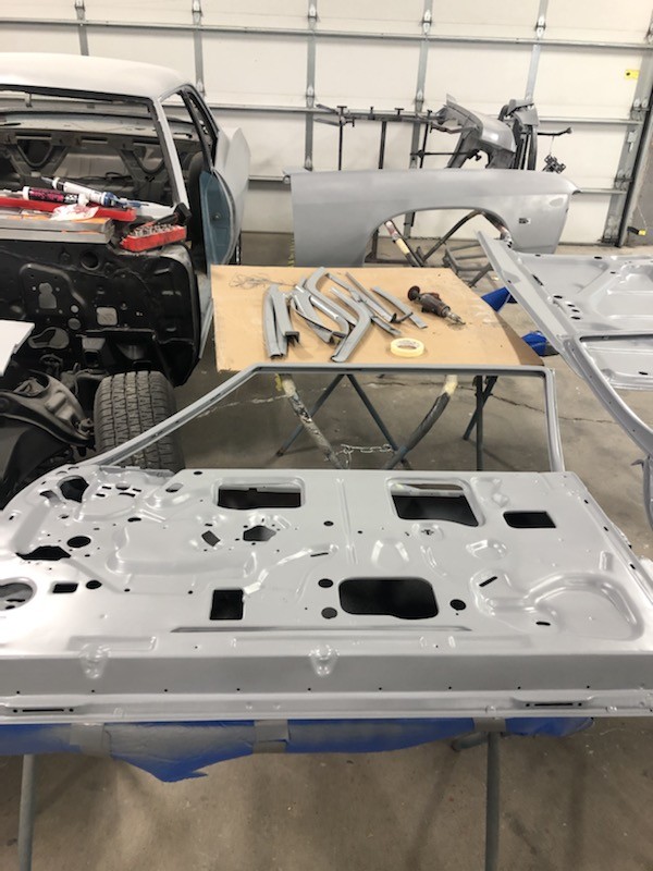

Trying to match the OE color, except basecoat/Clear. Does have Blue cloth, headliner nice, still in car. The earlier pictures In this post do sneak some shots of the interior before I boxed it up. The only place with the original color now is the cowl hinge area, trunk opening and a bit on the rockers.
Next project, caulk, color underside of dash at interior firewall. Refinish correct semi-gloss darker blue color on dash, upper door frames, windshield and 1/4 glass opening inside trim and rear glass opening.
Install Weather-strip on doors, fit doors and hinges. Doors will come back off, unbolting at cowl when everything gets painted.

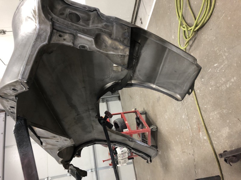

Floor pans on outside on this one also need to get touched up, will be mounted on rotisserie next, after dark blue on dash and trim is complete. Upper shell probably will get painted still on rotisserie. Use two booths, one for Shell, one for parts.

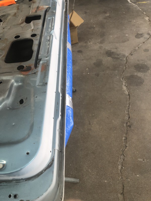

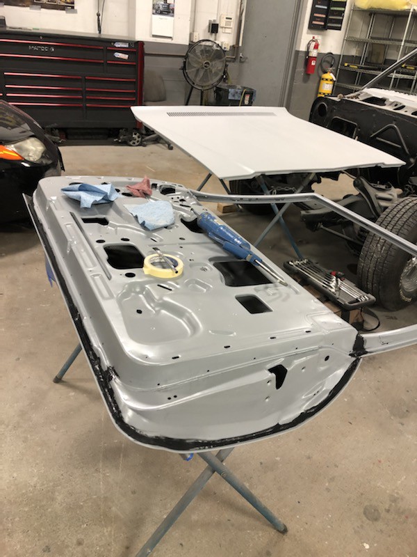

I have a question regarding the seem sealing on your doors. Did the factory use seem sealer where the inner and outer doors are joined together.?

Karl, I’m always in awe of your project's, all of them, too have so many going at once and the quality of the builds is a little mind blowing. I have a question regarding the seem sealing on your doors. Did the factory use seem sealer where the inner and outer doors are joined together.?
Yes, a thin swipe that didn't stay on long. You can see the remnants of it on this '66 door.
Aug 24, 2020
I most cases, yes on seam sealer. It was a pinkish white color for most of the 60's. My "guy" removed most of it with a scuff pad style wheel. My Caulking was with a Rubberized Crest product. Brushes out very much like the 3M product we also use. Mitch's picture is consistent with most, however there are a few other areas that they spread product on also.
I think the thickness/appearance could very significantly from Plant to Plant and Model to Model Full size tended to have a little more.
I am not the "caulking god" I do have one Technician that is a true artist.
I just smear it on and hope for the best. I still come back over it, scuff it, to knock it down.

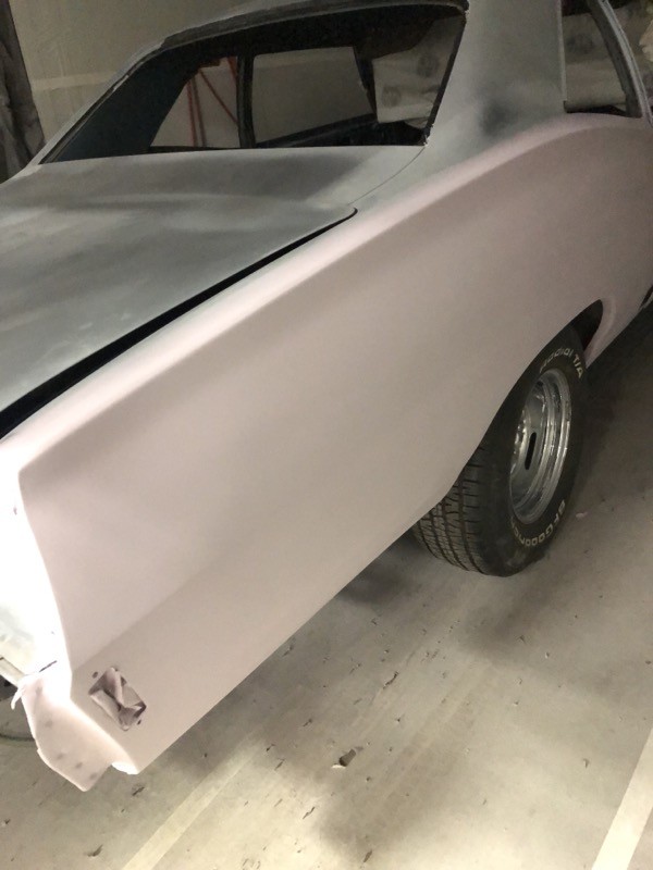

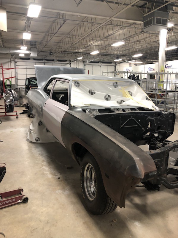

Sep 8, 2020

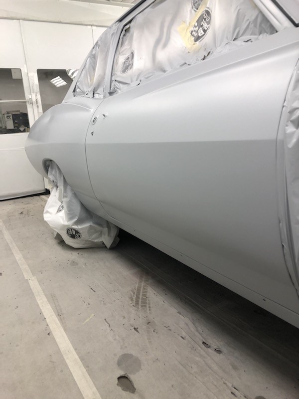

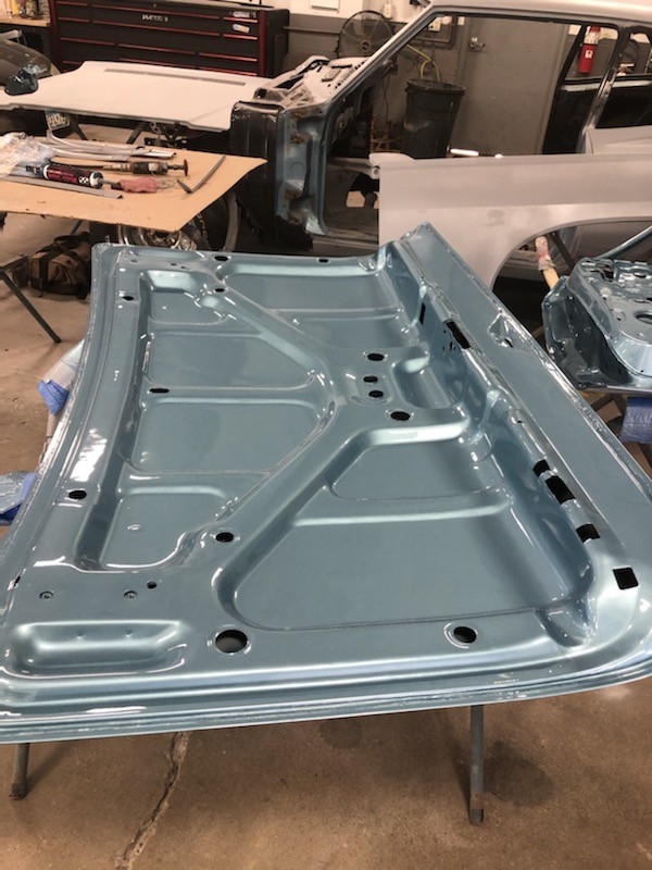

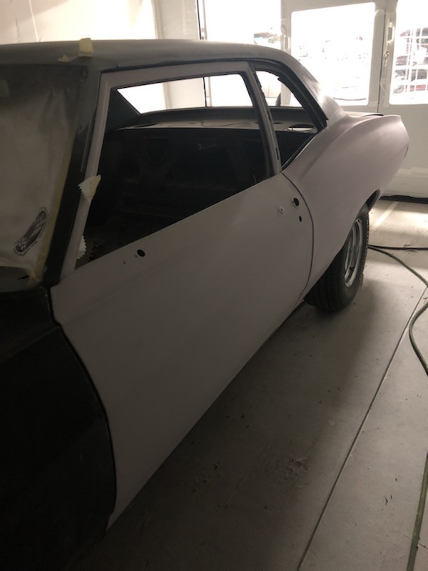

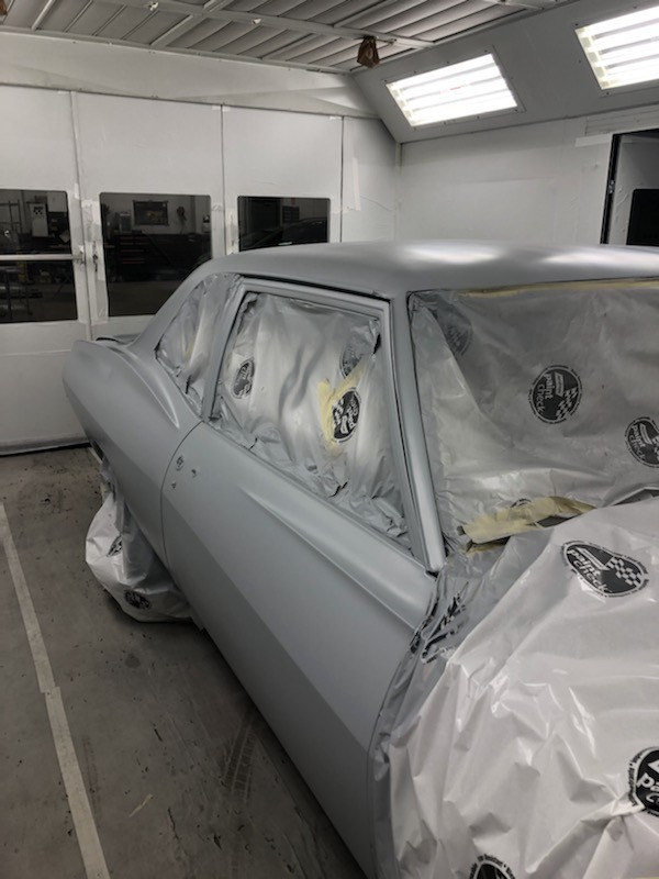

Mitch is not the only one that struggles with interior colors. My painter shot this last Friday, did not do test panels to compare with correct color. Result:
Second time around, with test panels, we are good.
Next:
Install doors, fit with weather strips.
Install decklid, fit to 1/4 extensions.
Drill fenders for Biscayne emblems, and marker nameplates with engine designation.
Block fenders, final prime.
Pull Body place on Rotisserie.
Detail floors.
Getting there!

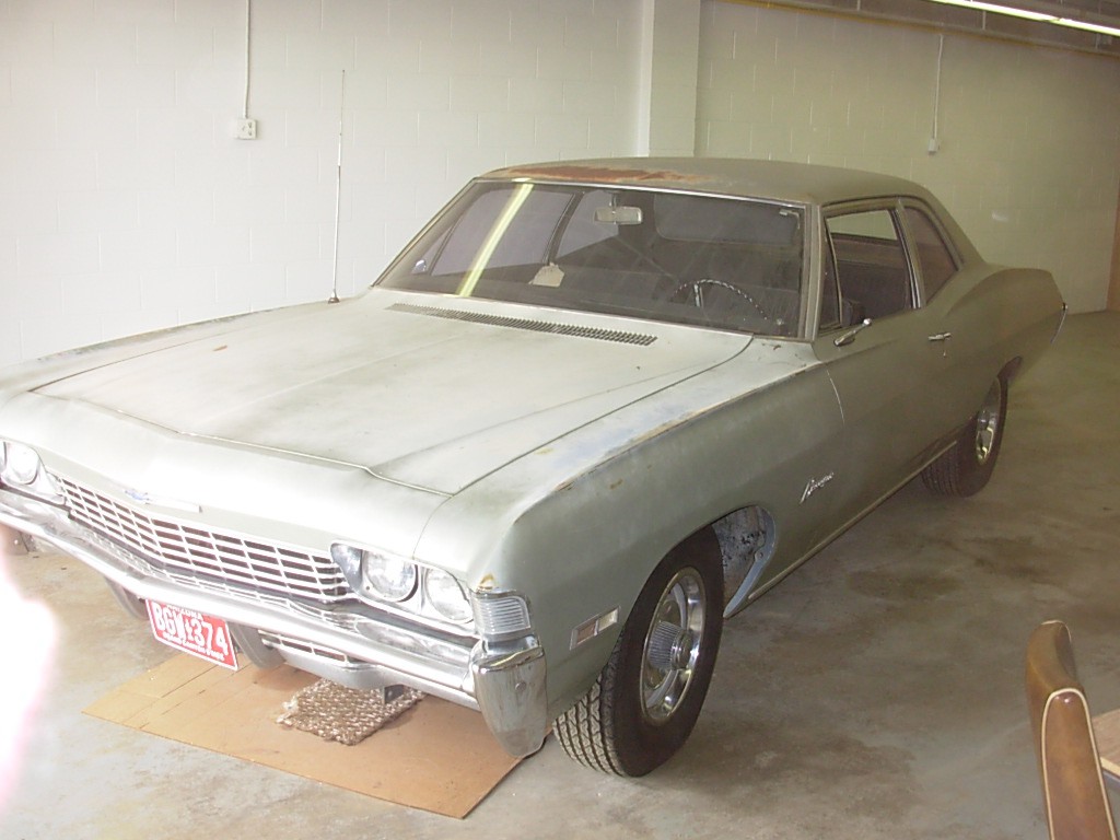

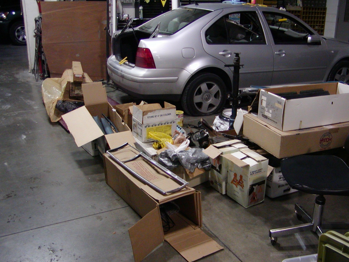

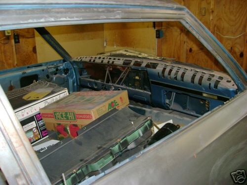

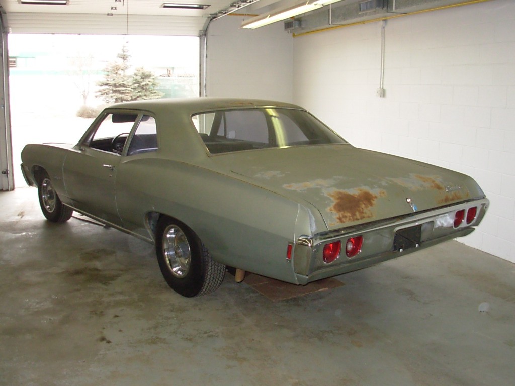

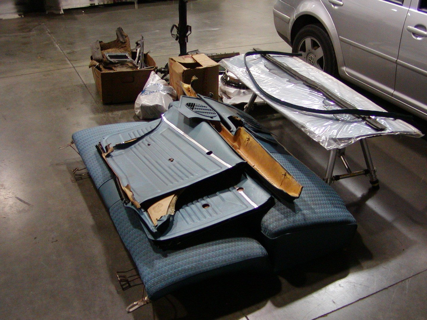

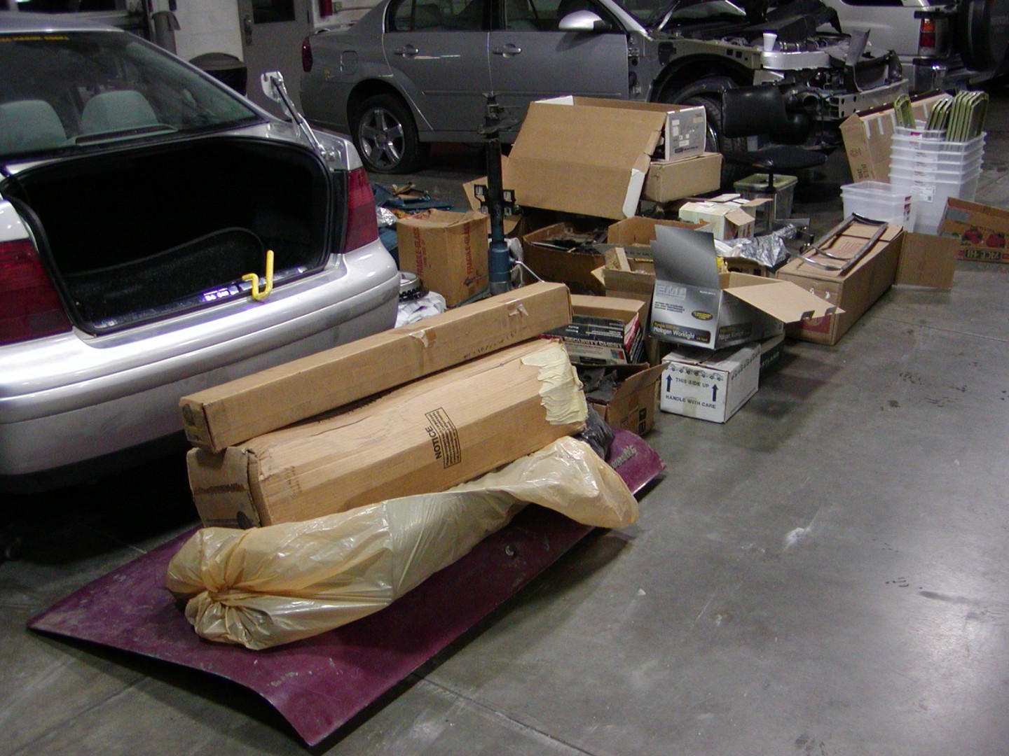

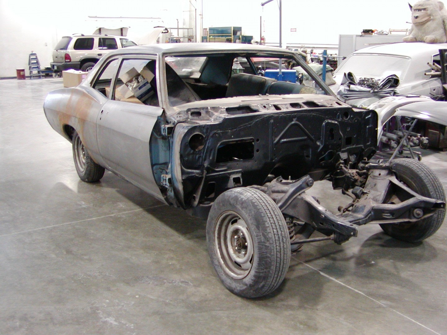

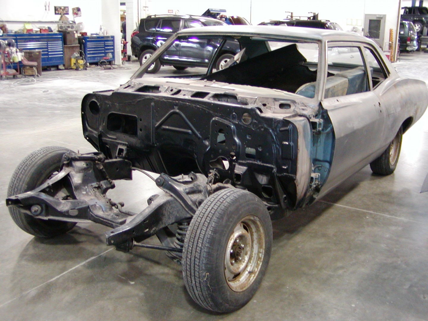

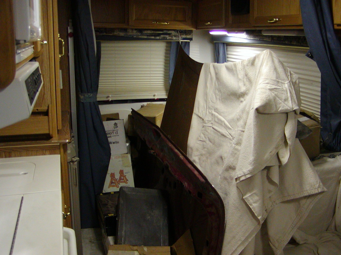

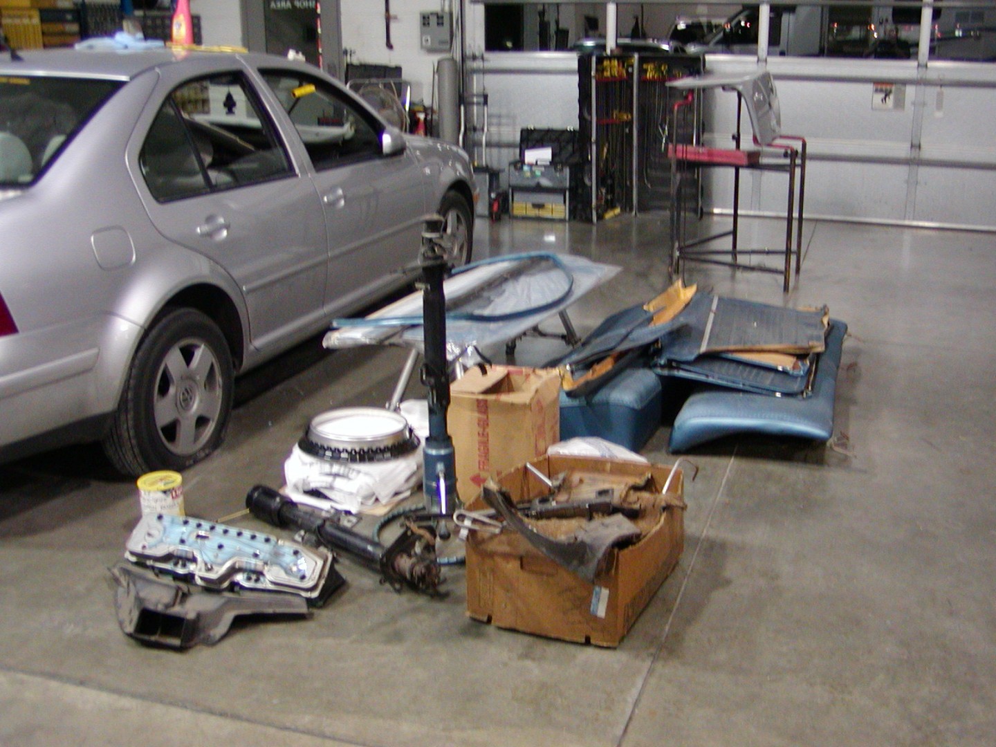

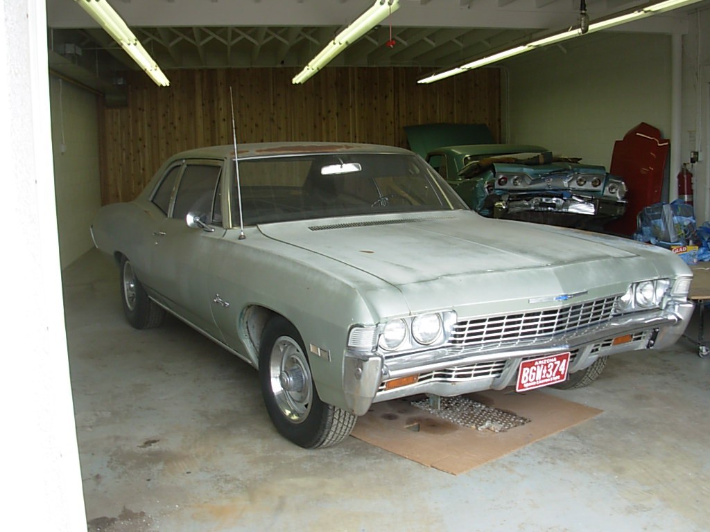

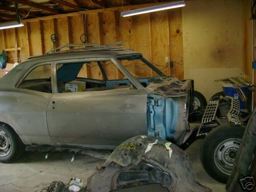

Figured the pictures would overwhelm the other thread about "Mitch's transmission for Biskwik.

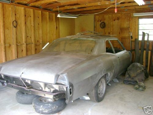

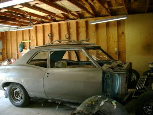

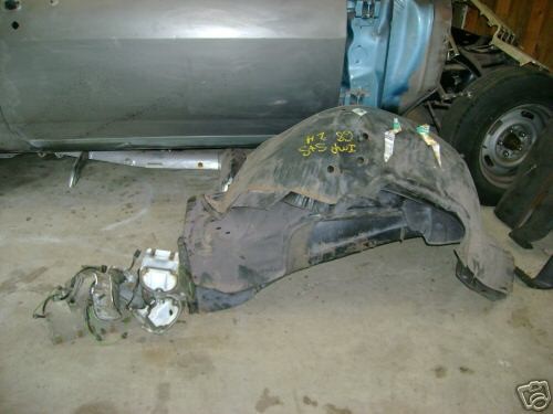

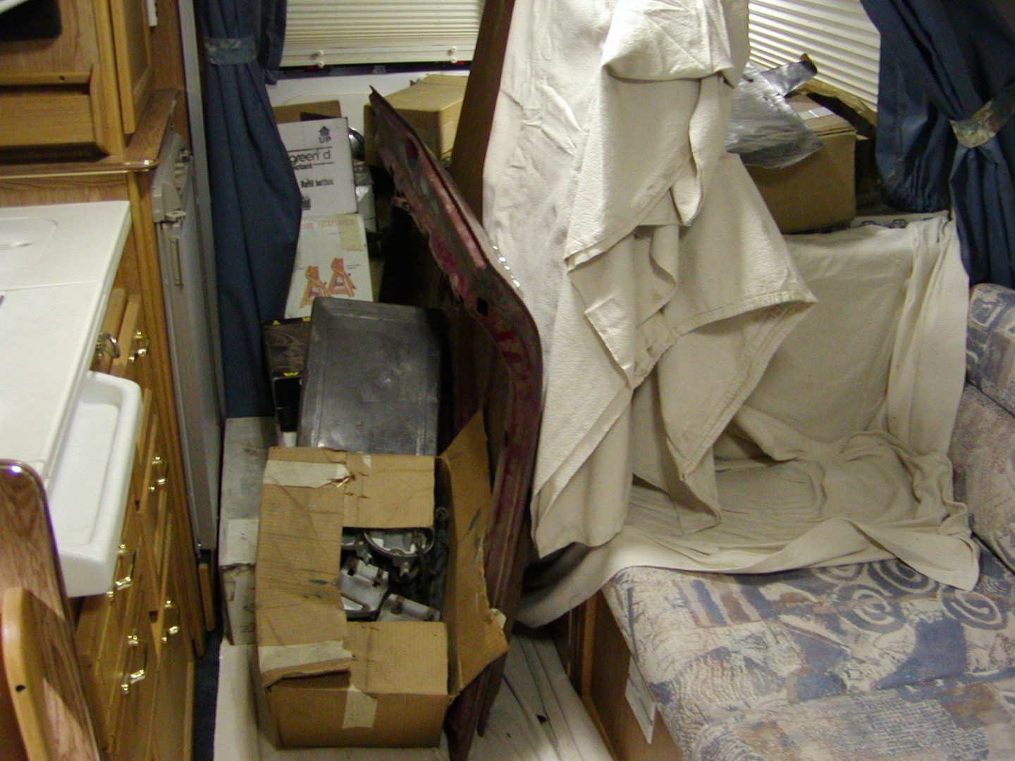

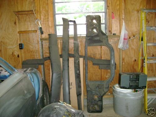

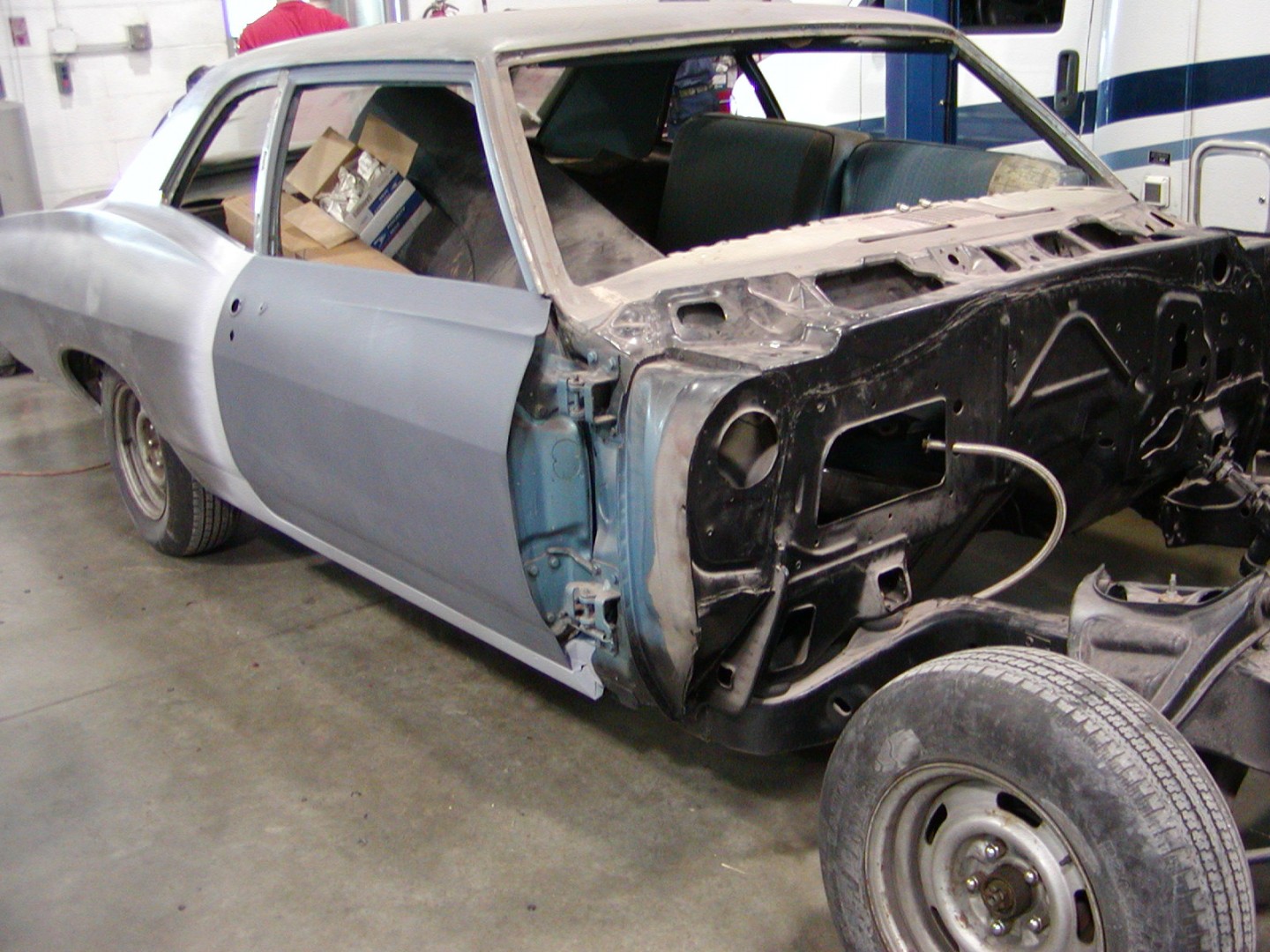

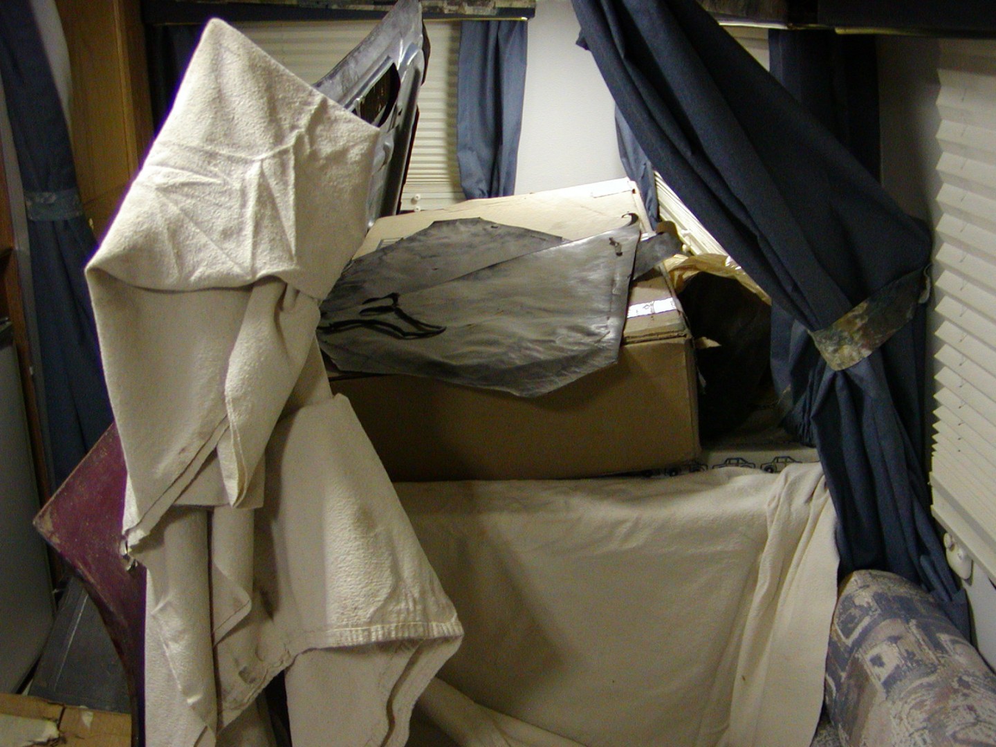

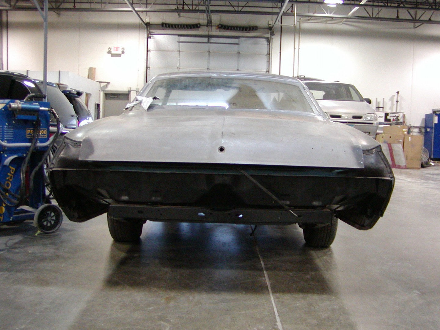

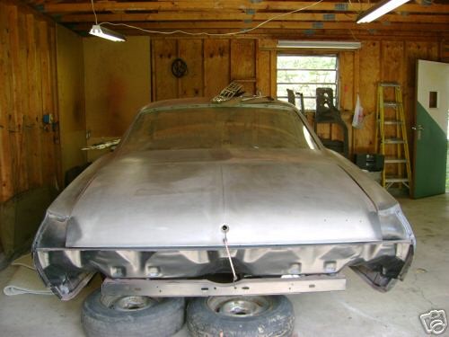

These were mostly taken when I first got the car plus piles of parts, fall of 2006.
Needless to say, completing car has not been a top priority. Still isn't.

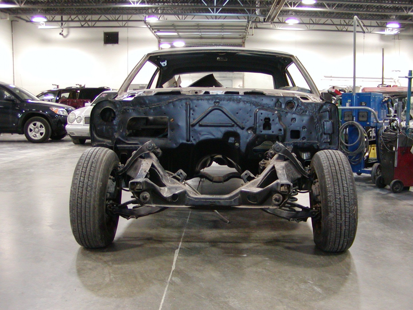

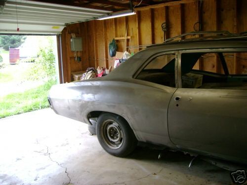

Car was in Pennsylvania, sitting in garage, bare metal, body patches, repairs incomplete.
Garage pictures.

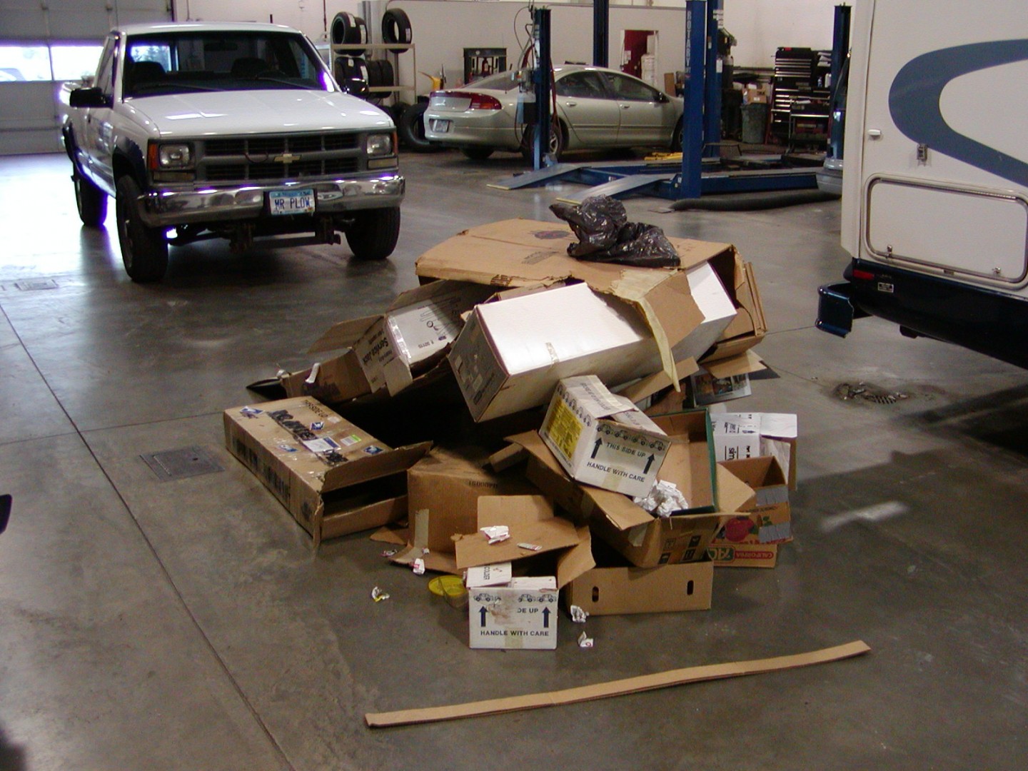

Pieces loaded into my Van to come home.

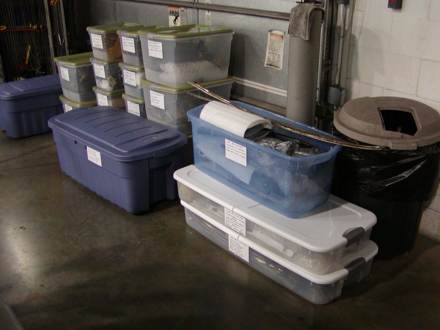

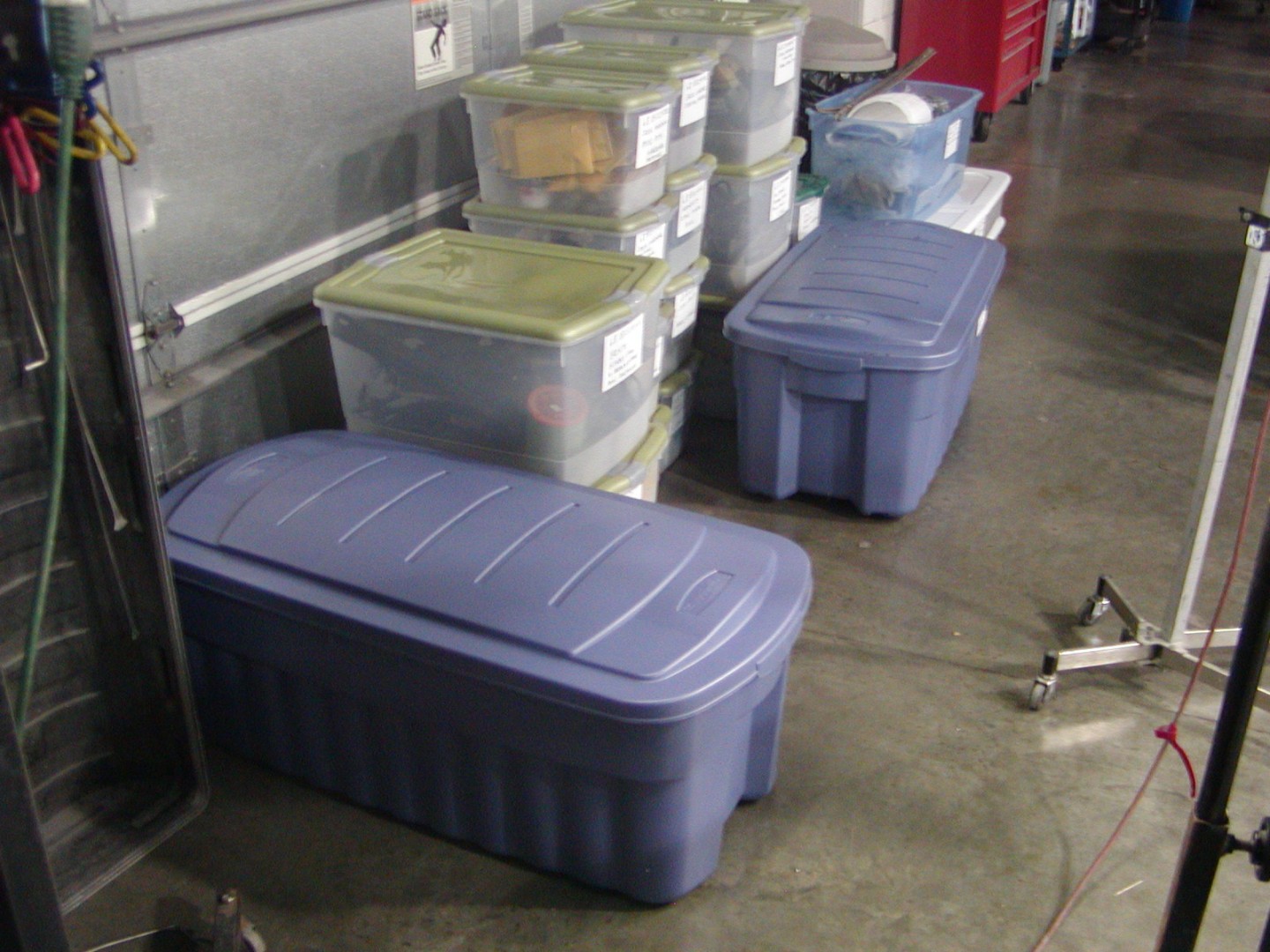

Inventory and repackage.
Rained all the way back, bagged it, but needed to prime right away to protect.
Off trailer, prior to prime.
This car has been moved thru five (5) different storage locations since I bought it, not counting when at shop.

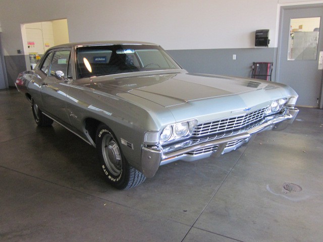

I bought it because I felt it had great "bones"
Was original 6 cyl. manual tranny, 39000 mile vehicle.
Frame was done, outside floors were done, inside still original paint, NO rust or pits.
12 Bolt, disc brakes all urethane bushings, etc.
Original owner planned to "clone" up a big block.
He also had a really nice done 66 post big block car.

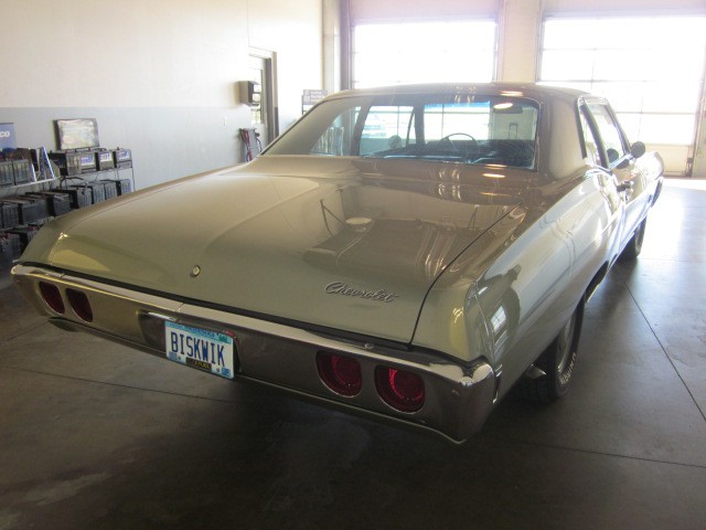

Here are some old pictures from when I purchased, when done and one from the drag strip, "back in the day"

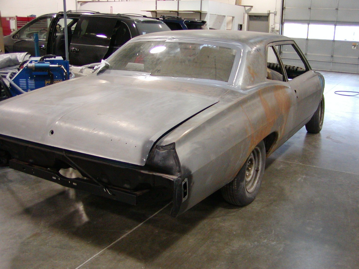

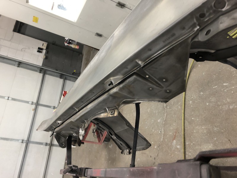

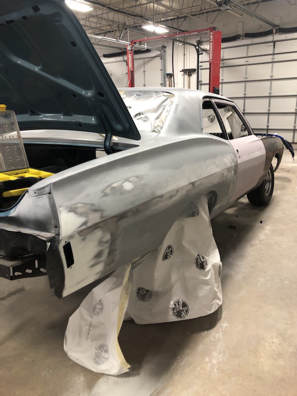

Some pictures from yesterday and today.

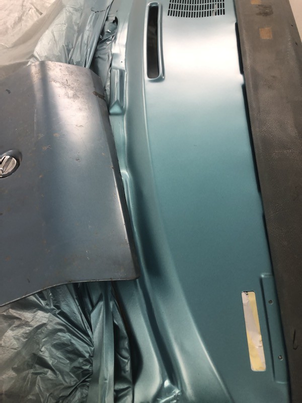

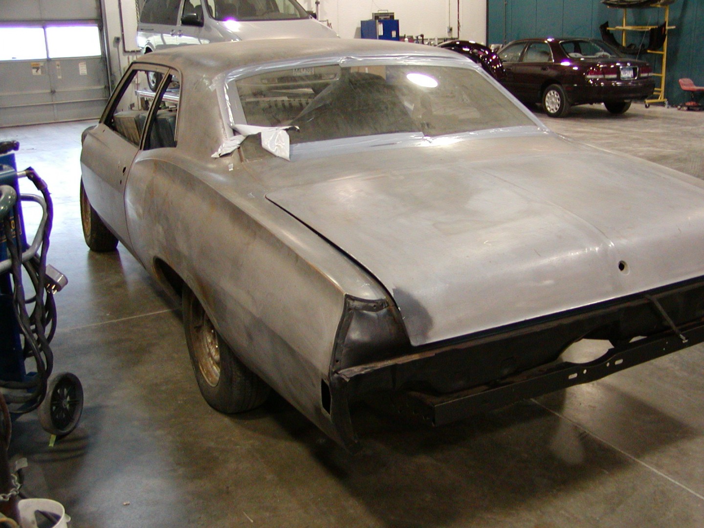

More pictures of current status.

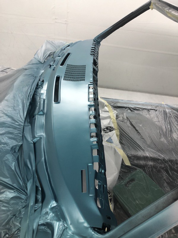

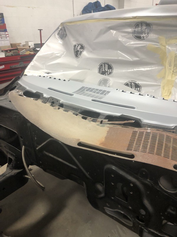

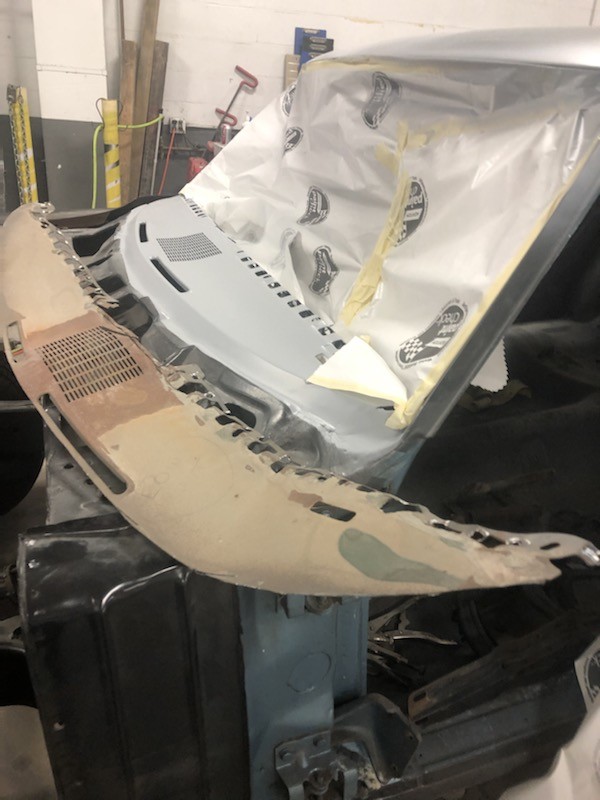

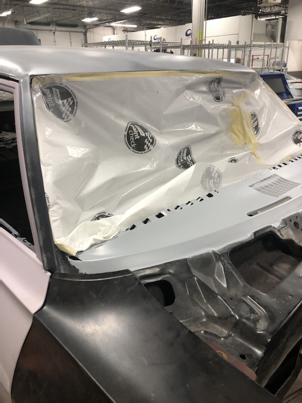

Dash was warped and hacked up replaced upper area, came out well.
I have saved several upper dash panels because they rust out badly.
As of yesterday.
Looks like you will be buffing in no time

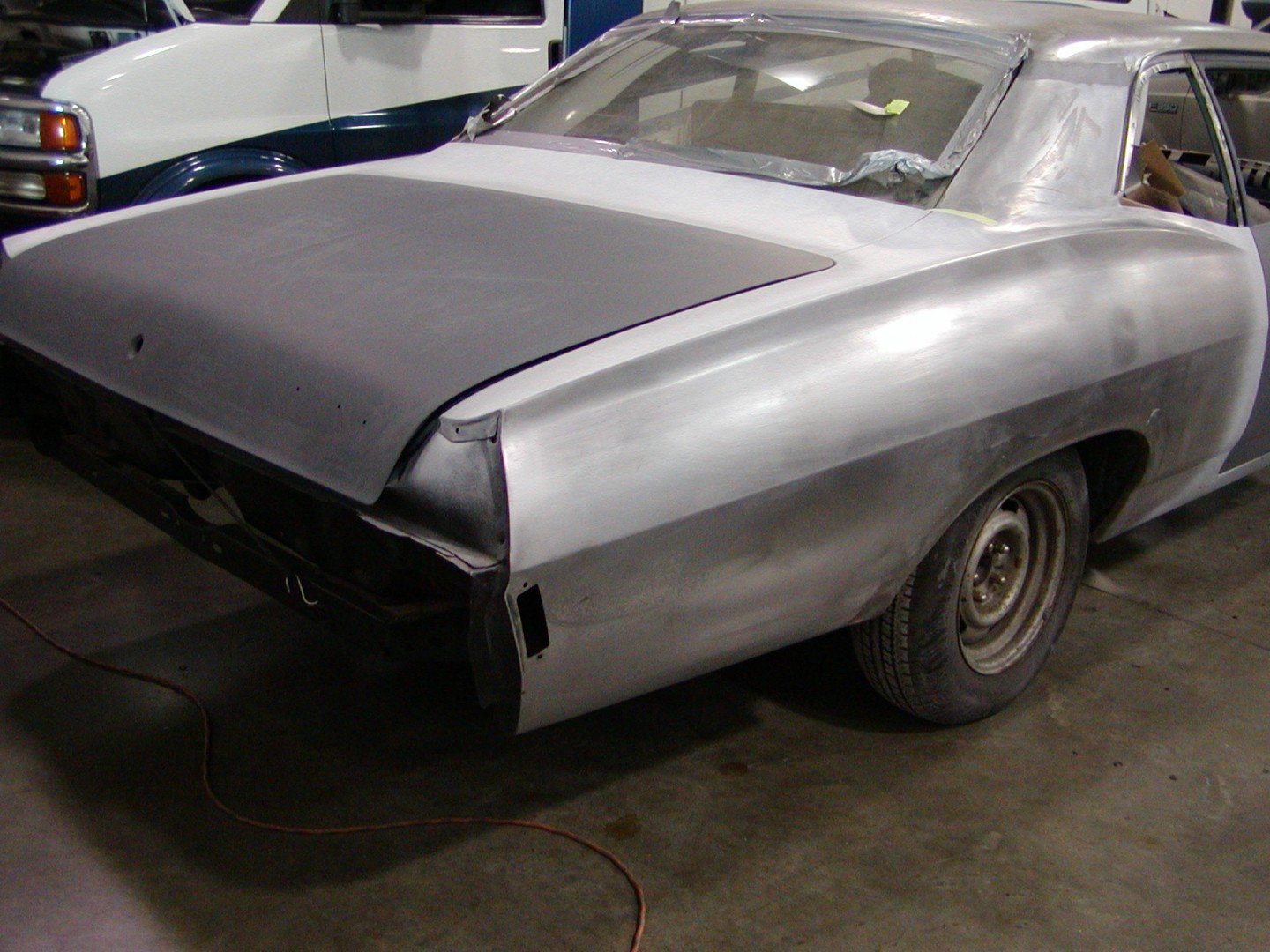

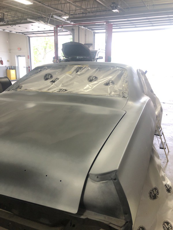

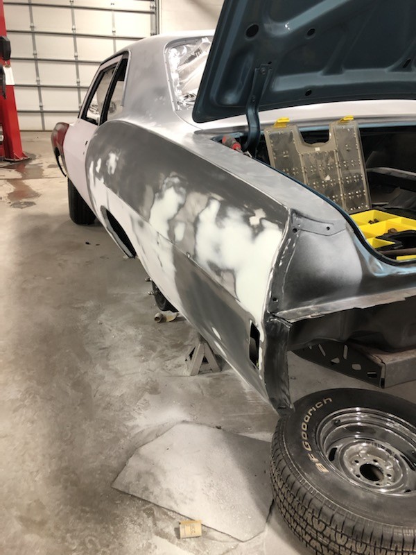

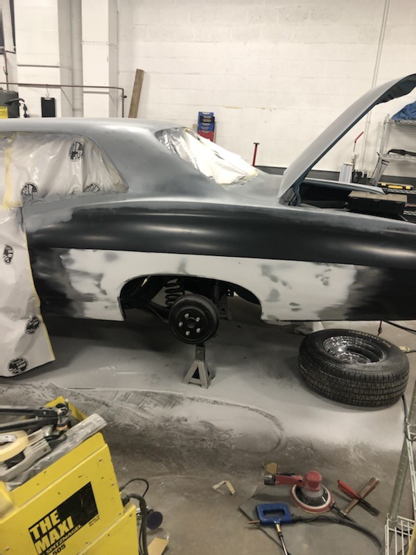

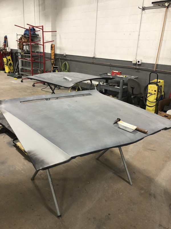

This is a sprayable polyester filler/primer.
This will get blocked and re-sealed with epoxy.
The frame for this car is the roller platform for the 427 "Mitchs' transmission project drivetrain.
Body will go on Rotisserie for floor pan detail once in final prime.

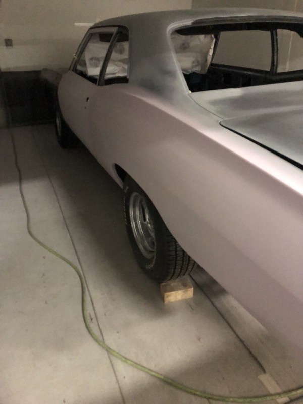

Basket Case polyester being blocked.
May even have in final primer-surfacer by end of week.
CHUG-CHUG-CHUG
Had no expectation this body would be this far along, this soon.

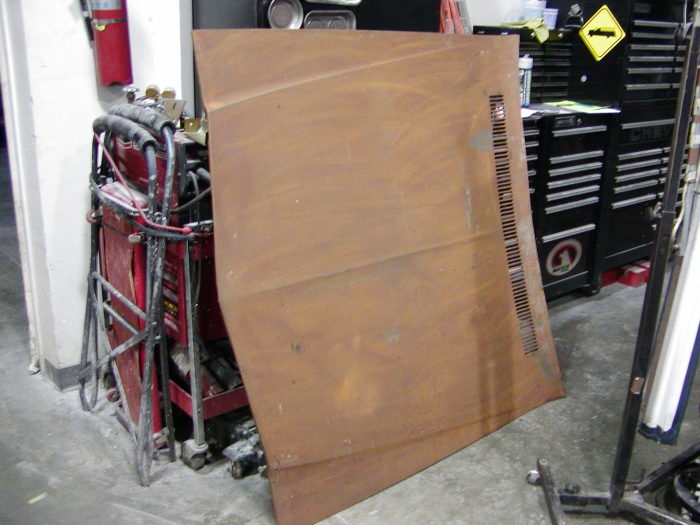

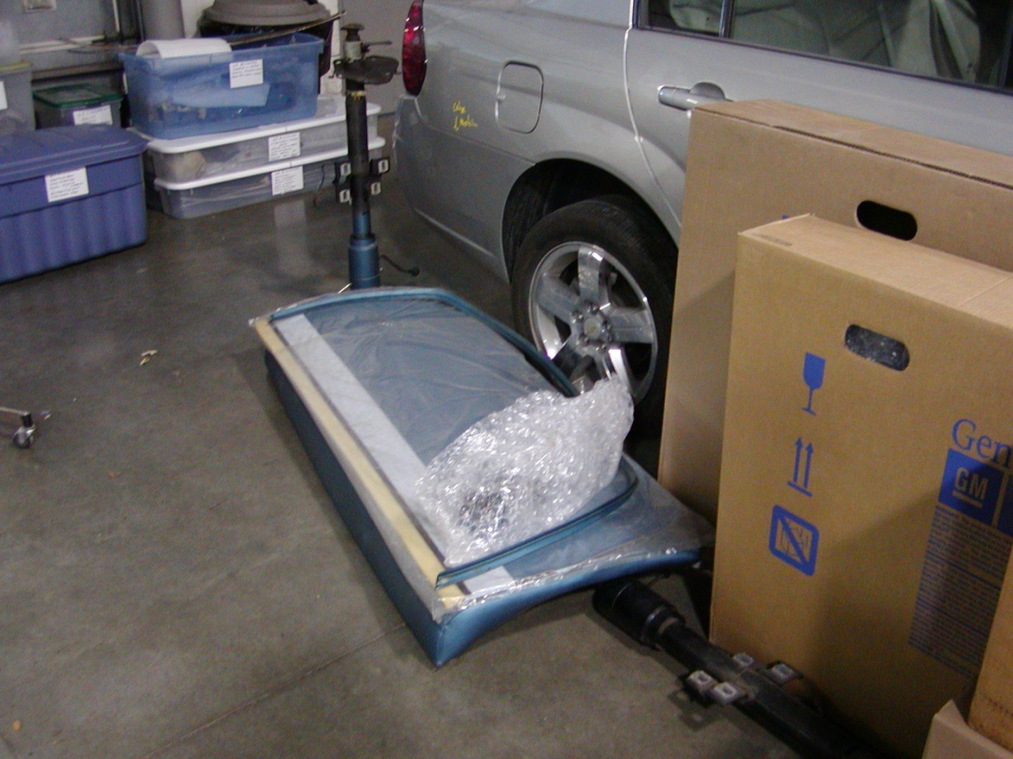

May end up using original hood from car, instead of NOS, less damage, may save NOS hood for another day.
Fenders (NOS) will go out for stripping and cleaning.
Shell will end up on Rotisserie when Blue Elky comes off.

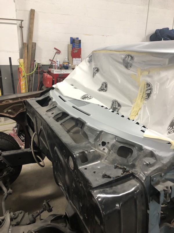

Once re-primed, dash, upper inner doors and rear glass opening will get refinished in low gloss medium interior blue.
-- Edited by more ambition than brains on Tuesday 23rd of June 2020 12:54:46 PM
Pretty sure we are just going to use one of my already reconditioned hoods, save NOS for later.

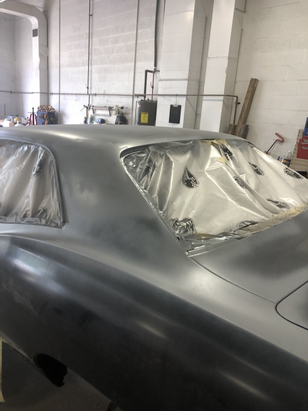

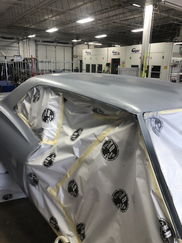

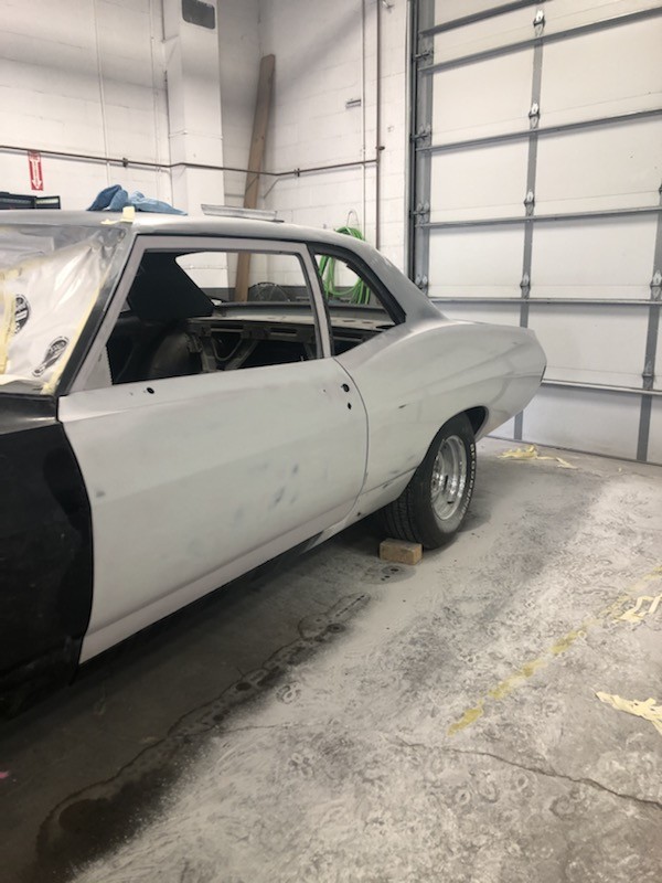

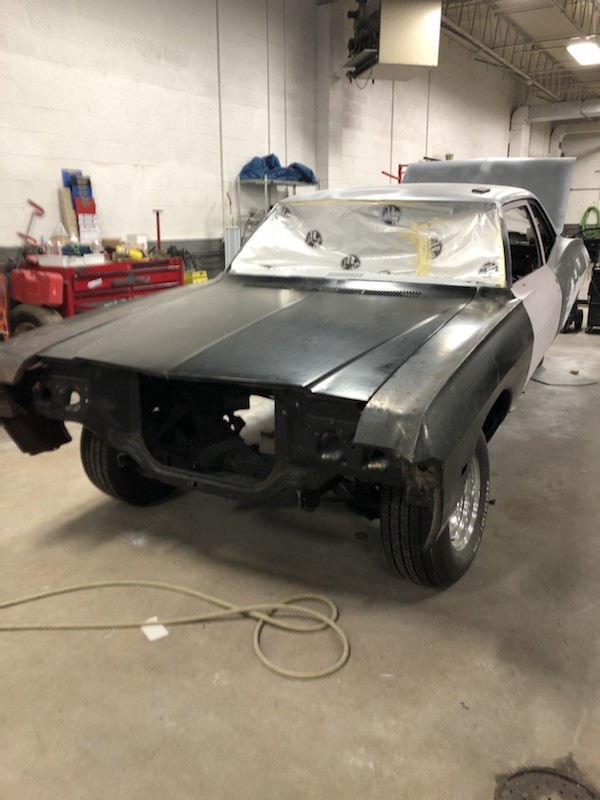

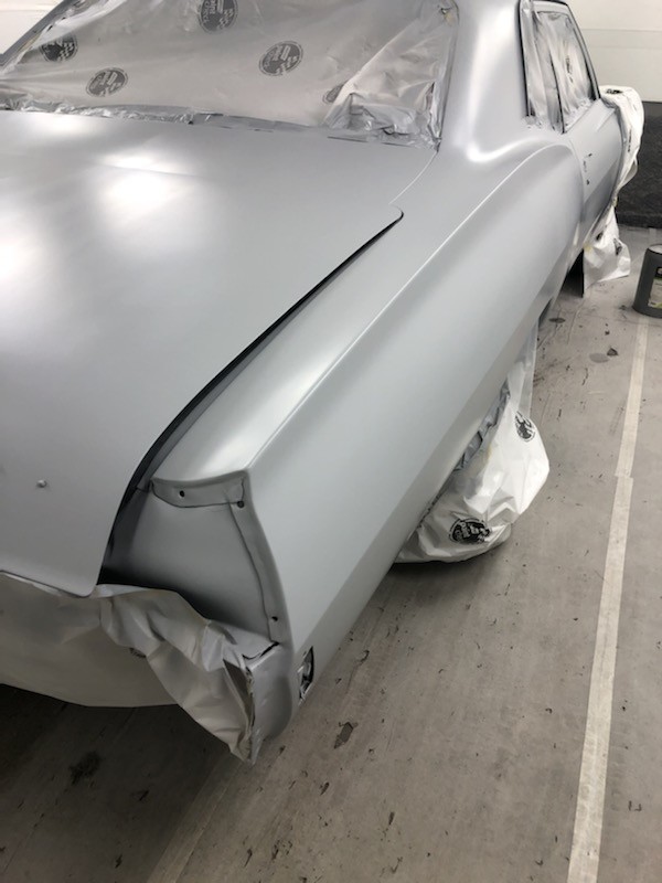

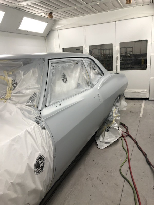

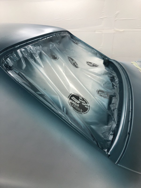

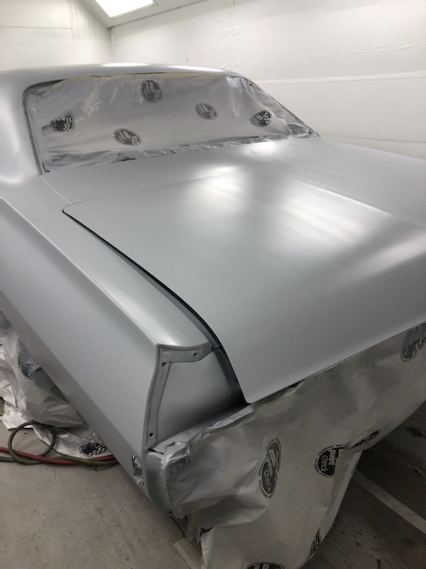

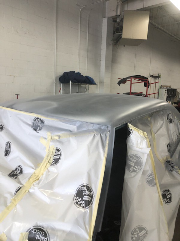

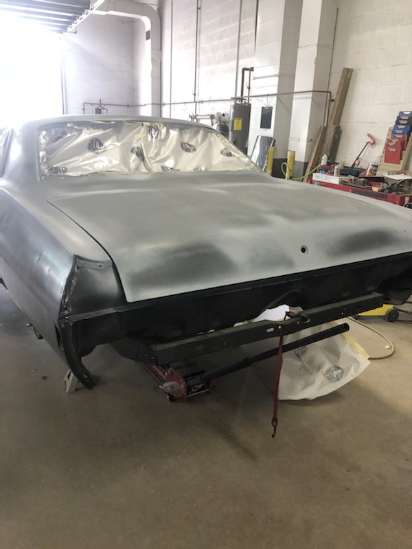

Body shell now in final primer surfacer.
After hood use verified and fitted, front will be disassembled, fenders and core support sent out for stripping.
Dash, upper doors, and rear window opening will be painted with low gloss medium blue.
Once that is done, body will go on rotisserie for outer floor detail.

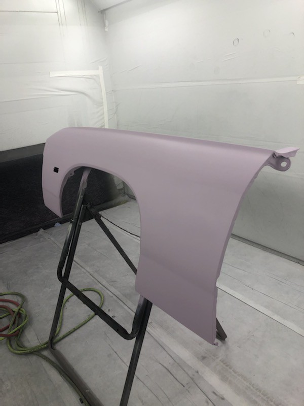

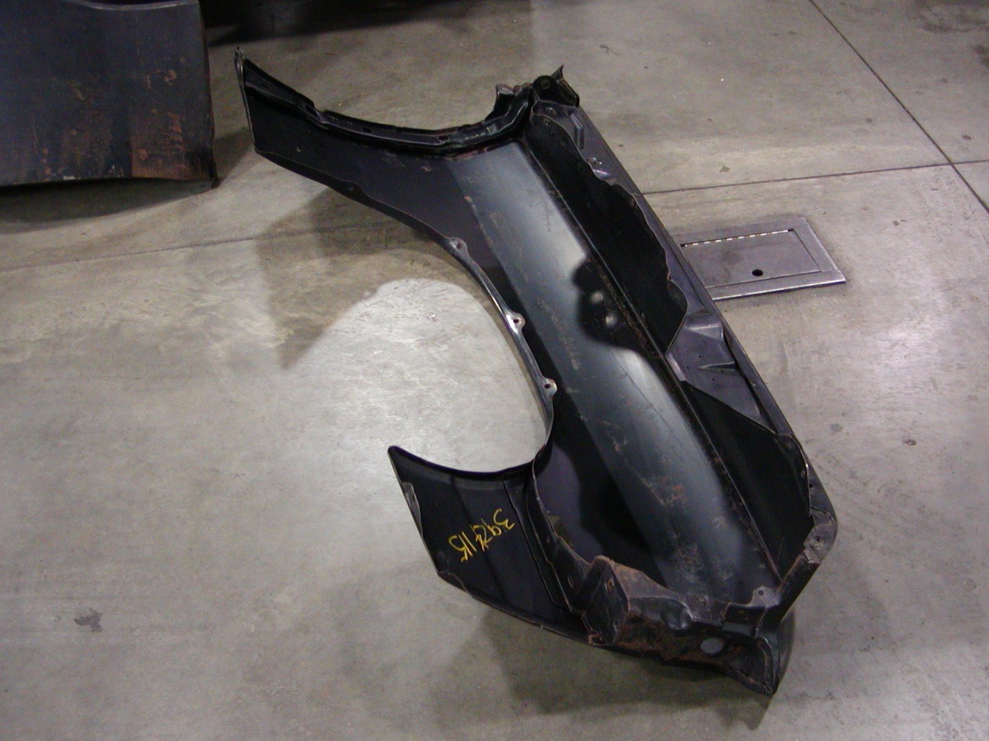

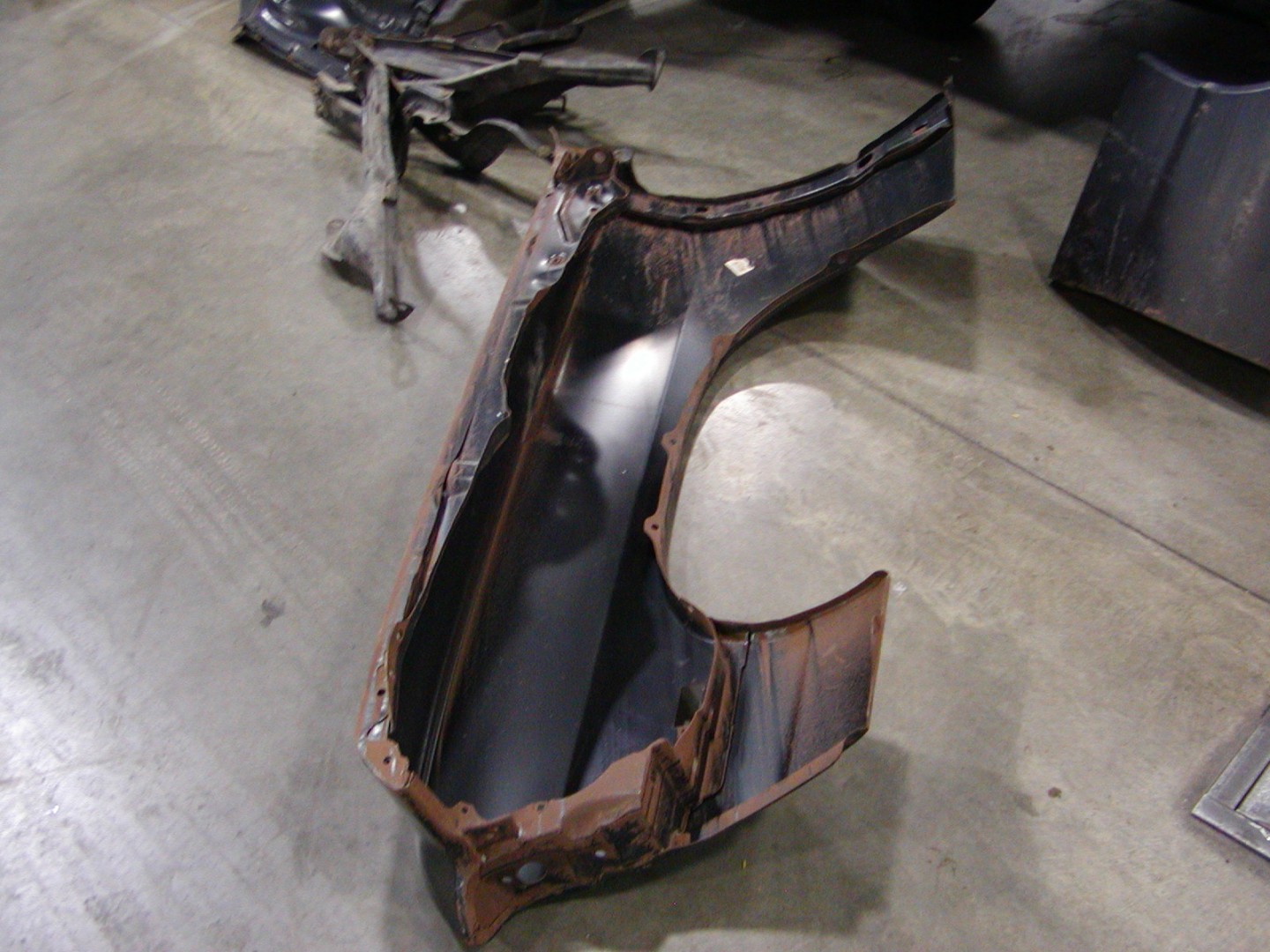

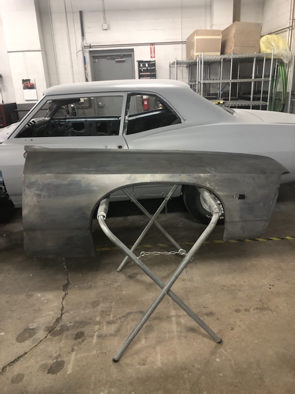

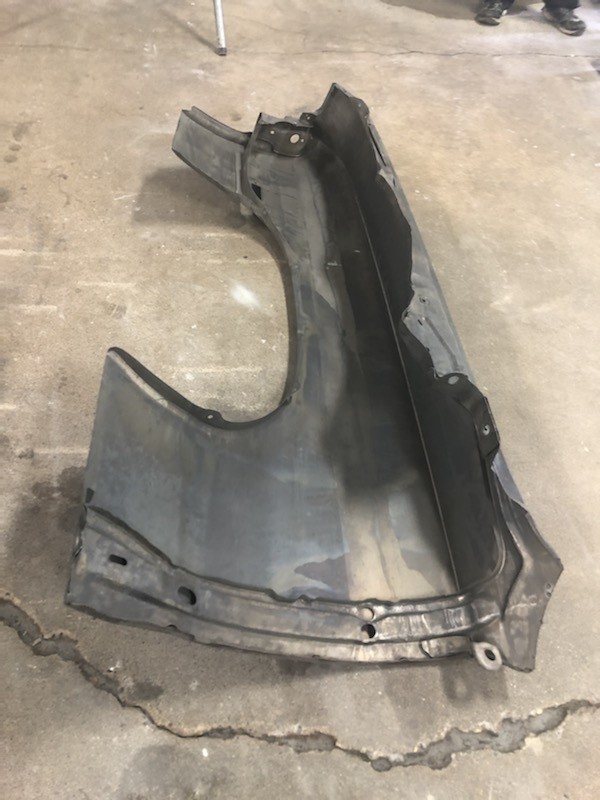

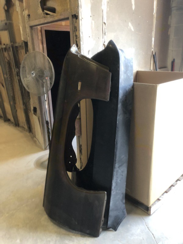

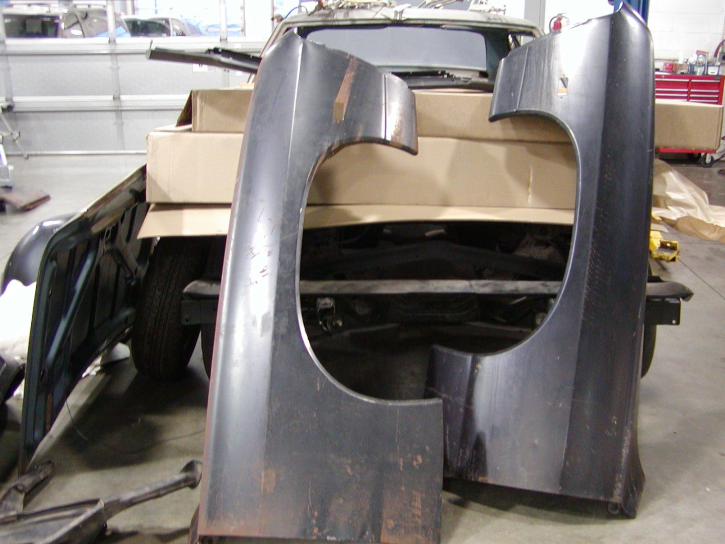

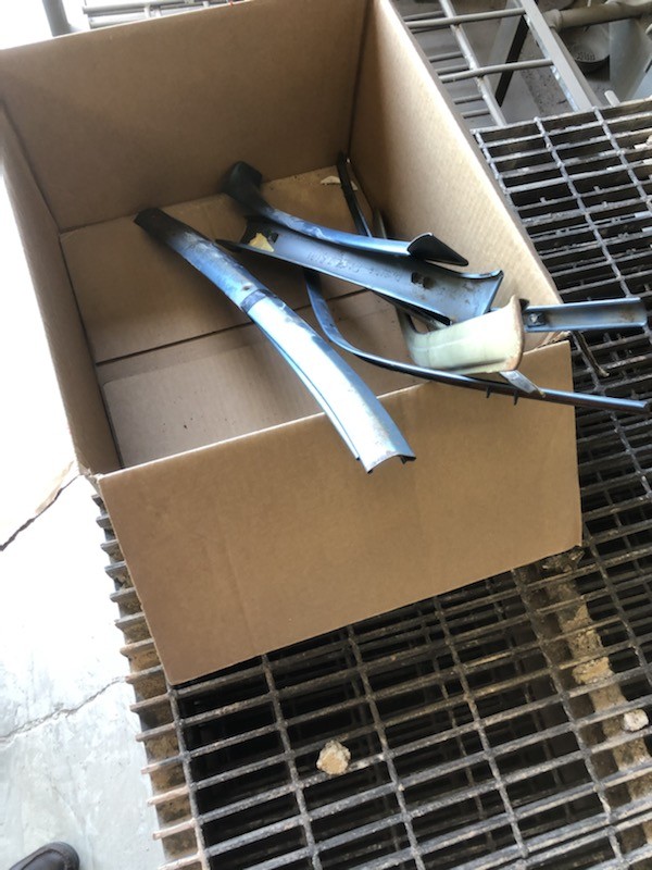

Fenders and some trim, sent out for stripping.
Pictures show before and after.
New old stock cleans up really well.
Now we epoxy, and fix dents as needed.

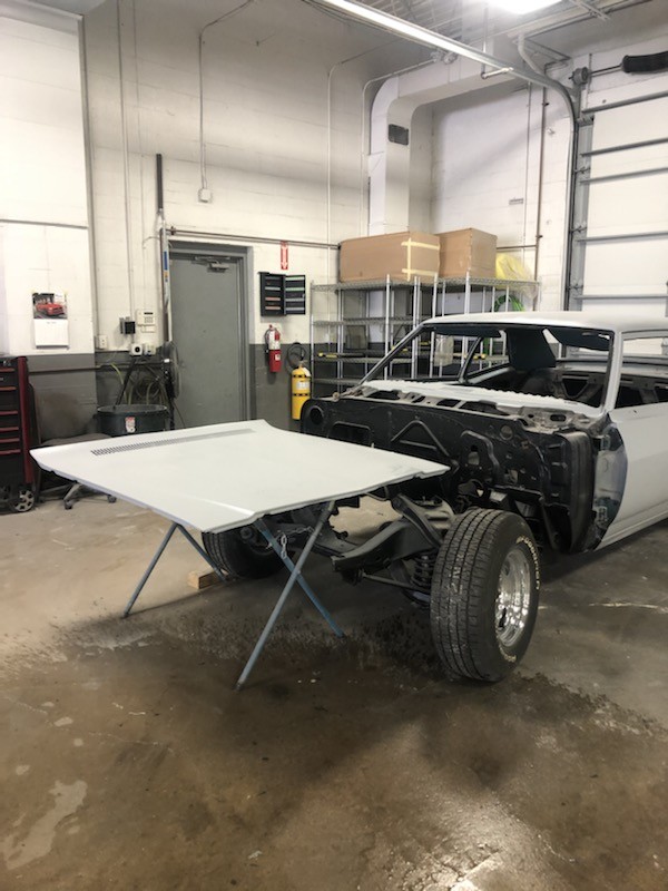

Ended up using a reconditioned hood, it is now in final prime.
Next batch for stripping will be: Core support, Wheel housings and some brackets.
Body can now go on Rotisserie once I get wheels on my body cart.

Very clean. Are you going to take the next batch to Blooming Prairie for powder coating ?
They did a REALLY nice job on the Camaro parts...
I really like the quality at Xtreme Powder Coating in Blooming Prairie.
They did the frame on the white Elky.
VERY nice outcome.
It will probably depend on how pitted the wheel housings are.
Business improving, however, still a long way from good.
Thinking these projects will end up back in the "Treasure Chest" in another month or so, hopefully.
In another month, they should be in paint and ready for assembly at the toy box...
Just some boring epoxy pictures.
Caulk this weekend.
Cut in after that.
Must be nice to be working with such nice steel
Looking good!
Caulked!
Blue doors, hinges and trunk!
Looking forward to seeing them done.
Result:
Fenders in sprayable polyester surfacer.
Detail floors.
Getting there!

Currently, 50-50 probability Basket Case will become all one color prior to re-joining the "MOTH BALL" fleet.
I would love to see it all one color after so many years, with no real plan.
As stated, Body shell by itself, maybe with deck lid on stand.
Leave it on rotisserie to paint.
Front Sheetmetal, doors, misc. in other booth, all at same time.
One way or the other pretty sure it is out of Burnsville shop by October.
Just Sayin,

This is why we do spray-outs (test panels)
Two panels, lighter on left, base color only.
Right clear coated with gloss reducer.
