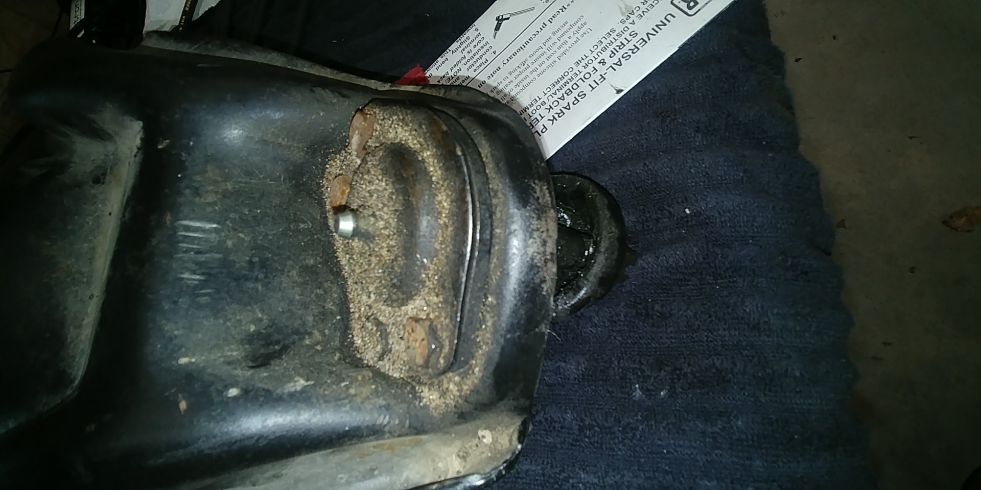

When I bought the 442, we saw the back driver's side upper control arm back bushing, washer, and nut were missing. I found the bushing melted on the header and the nut was down there too on top of the collector. No washer though.
Tore into it yesterday to replace the bushing/shaft assembly and swap in the QA1 coilovers while things were apart. I have disc brake conversion parts, but going to do that this winter.
I decided to replace the upper ball joints since the boot on the drivers side one is shot, and looks like they are due for replacement anyway.
Hope to have it all back together by next weekend to put some more miles on.

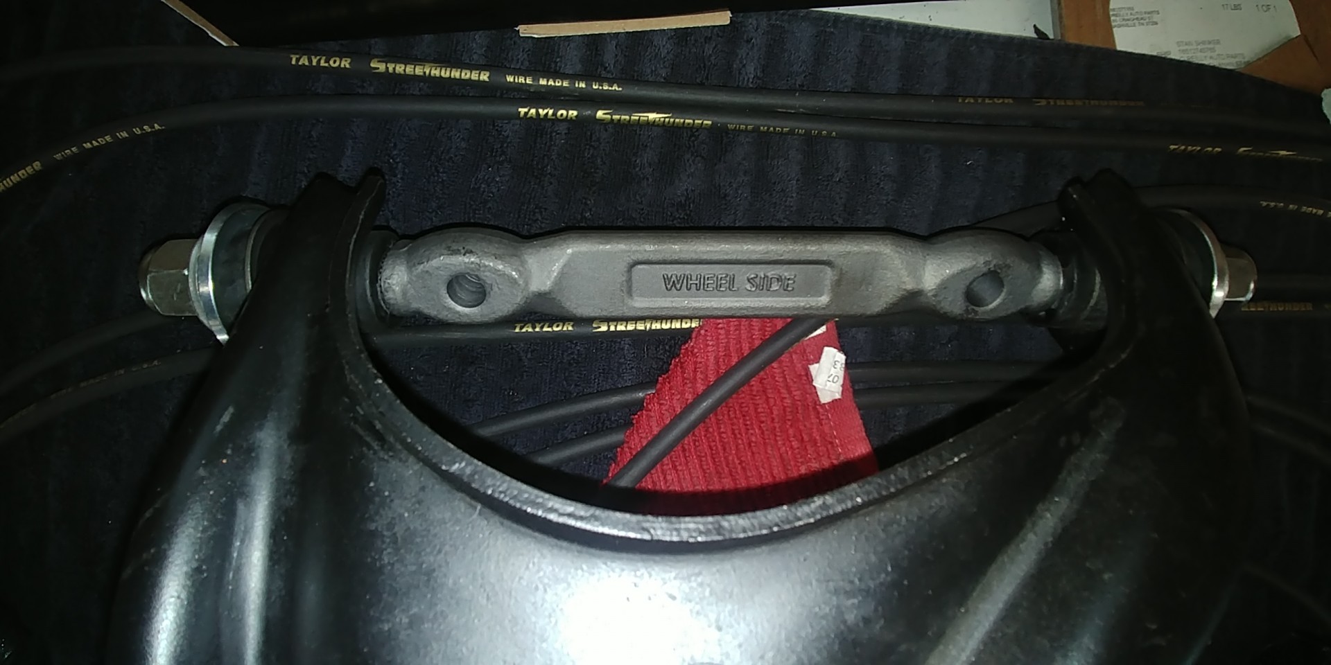

Got to bring this up, and you probably already know this, but did you install the coil-overs with the crossbar on top of the control arm ?

Yep, I installed the crossbar on top of the control arm.
Lastly, 90 degree plug wire boots = pita. The silicone assembly lube/corrosion preventive for ignition makes for a plenty slippery enough lube to allow the boot to slide on the wire with minimal frustration before you clamp on the terminal end. I bend the boot back as much as possible while pushing the wire thru. NOT getting the lube on your hands and having them all slicked up is the hard part. You have the sequence right, it's much easier to slide the boot back down than to try to force it over the, non-bendable, terminal after.
Here's the link to the offset upper control arm shaft I bought at AZ: LINK It doesn't really say how it's accomplished, but I'm guessing it's in the orientation/angle of the shaft casting when bolted in.

Almost finished up the passenger side last night and went to put the castle nut on the lower control arm ball joint shaft, and darn it if the top threads weren't bunged up enough that the nut won't even start to thread on.
Pretty sure I didn't damage it taking the hub arm off it, and it did fight me coming off so I'll blame the last guy to touch it. I tried filing the lead threads a bit, but that didn't help.
So now it's off to AutoZone to buy a new lower control arm ball joint to replace this one.
It's always something when working on old cars.
