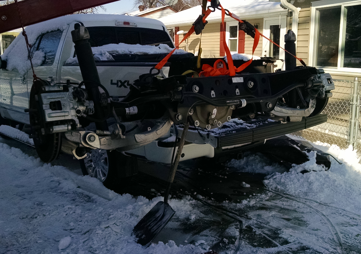

I got down there after work with my pickup, called in a favor or two for muscle, and got it in the truck and back home... enter Mother Nature. The pallet & axle is too long & tall for the bed - I have to leave the tailgate down, and the tonneau cover off. Good 'ol Ma decides to dump 5 to 7 that night. My plan was to use the engine hoist to pick it out of the truck and wheel it into the 40 Watt - but the hoist is in the shed... behind the garage... with a full-season's of snow (plus an extra 6") in my way.
Cleaned the driveway, and carved a path to the shed with Mr. Toro - 7 trips later the hoist is assembled and the IRS is dangling. It's rolled in the shop and tucked behind Blackie for a future day.

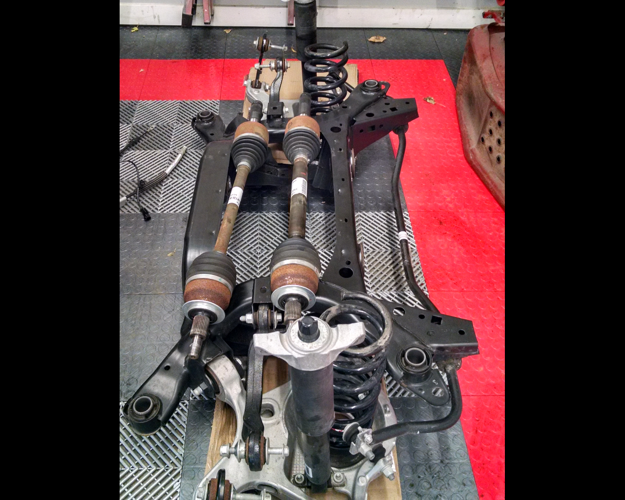

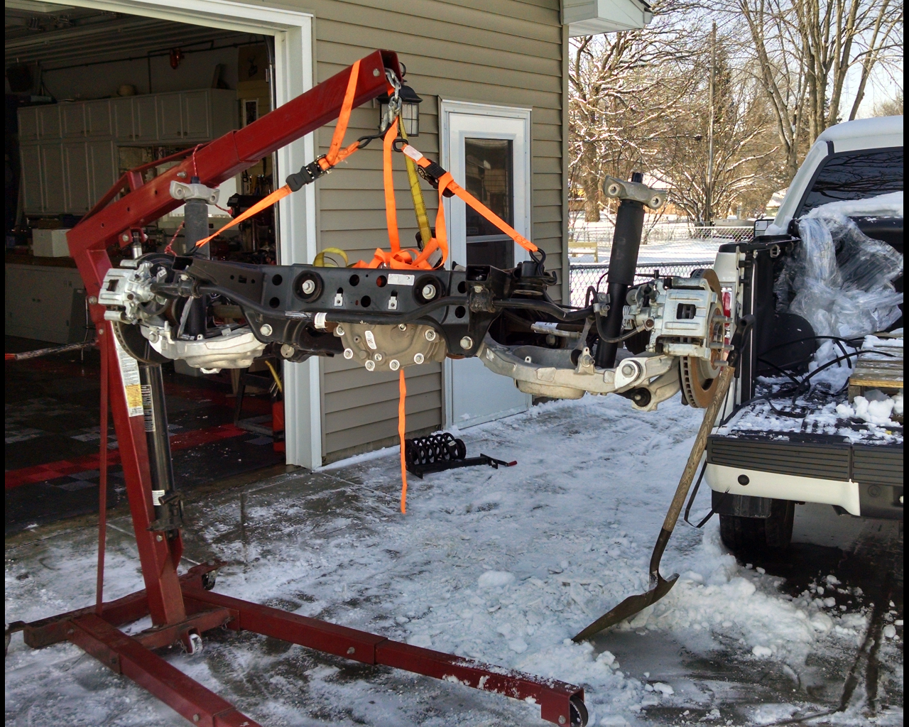

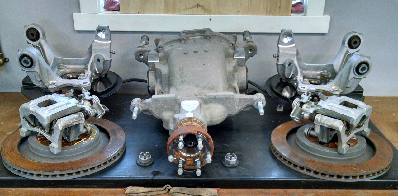

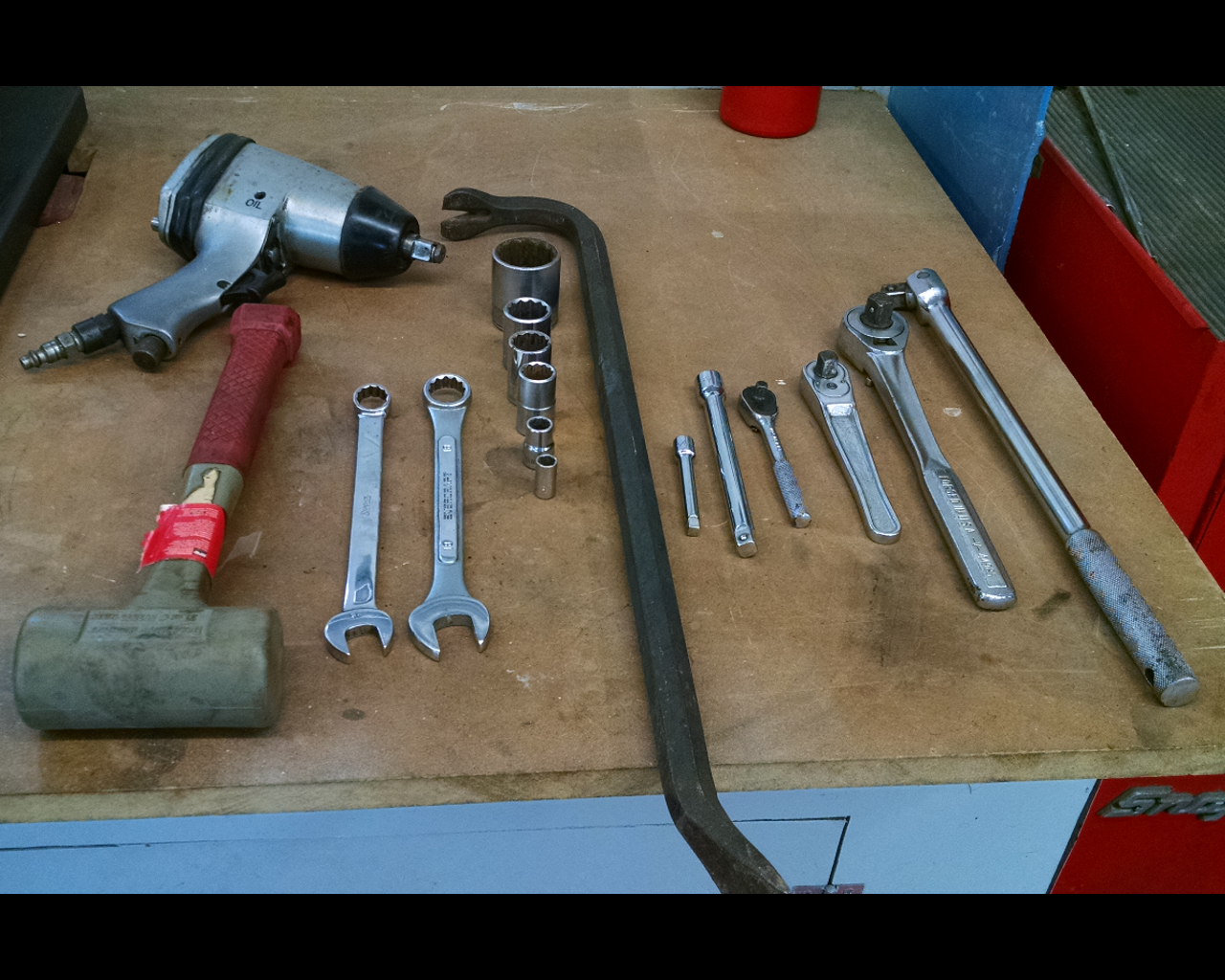

Since it's a soaring 40 above zero today, I decided to start breaking down the IRS cradle/assembly I got for the roadster. Switched on the shop heat, backed out Sheryl's daily driver, and got started.
I've really got to get my head wrapped around working on new or nearly new parts... I was done in an hour. It's just foreign to me for bolts to work like bolts, nuts to just spin off, and things to just pop loose with gravity or a "love-tap".
Having worked on 50+ year old stuff the last 10 years, I'm used to starting with 3/8" drive, then 1/2", then the breaker bar, then a cheater on the bar, then the gas-axe! Not being bathed in penetrating oil and getting totally filthy is also a new experience!
Tools used: 1/2" drive - Breaker Bar, Impact Wrench, Ratchet, 1-1/4", 13/16", 18mm, 15mm sockets 3/8" drive - Ratchet, 6" extension, 10mm socket 1/4" drive - Ratchet, 3" extension, 8mm socket 18mm & 15mm Combination wrenches Dead-Blow hammer (just to pop rotors off hubs) "Persuader" (wedged between lug studs to loosen axle nut, and pop axles out of diff)
Now you can see why I travel hundreds of miles for cars with far less rust than anything local. Even a 50 yr old car from down south still comes apart with hand wrenches...

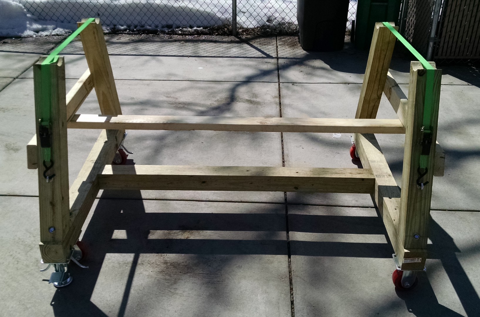

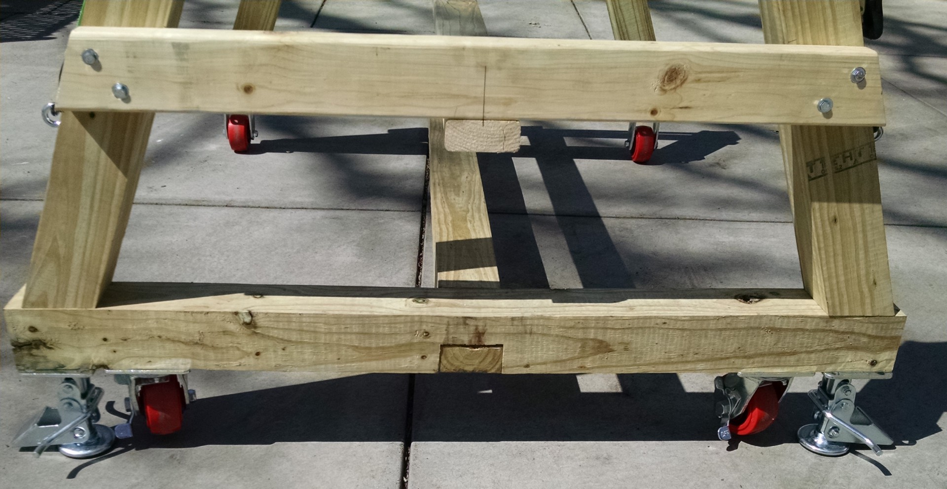

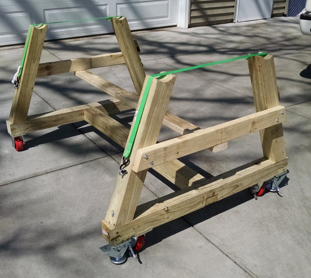

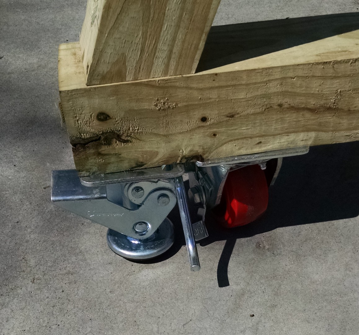

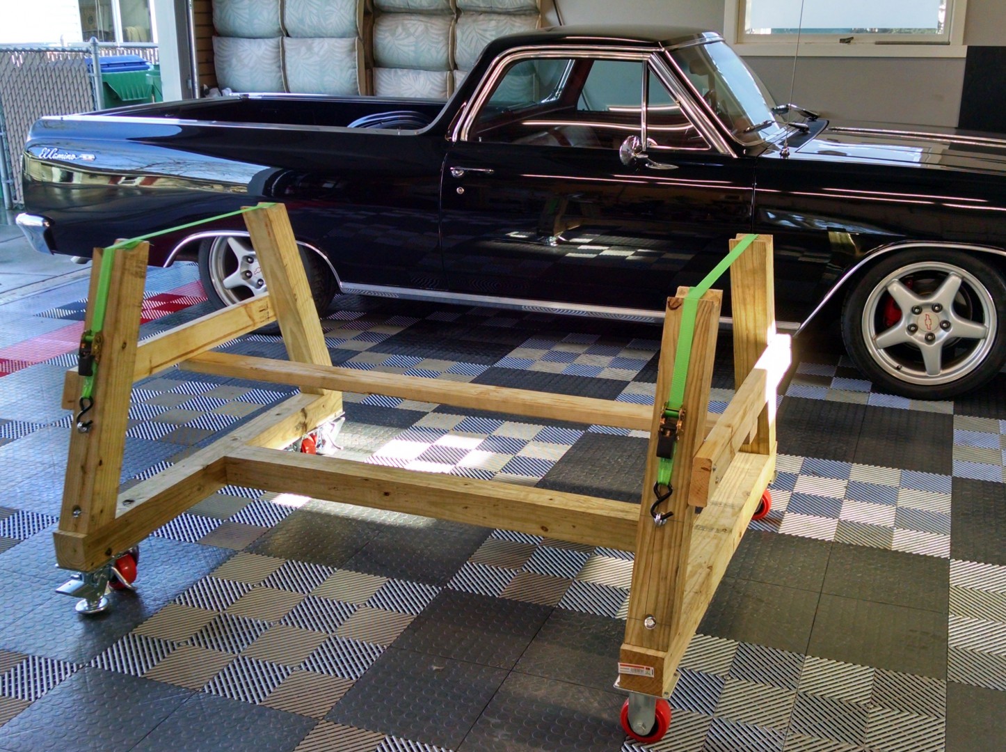

Spent the better part of Saturday and a few hours this morning building a dolly for the Roadster chassis.
Since this thing will take the better part of a year to assemble, I need something I can roll the chassis around on, and tuck it out of the way when not working on it.
Another requirement was to get the thing up to a comfortable working height where I'm not stooping over, or can roll under it easily. Also to be able to work SAFELY, without worrying about it falling off jack-stands or something.
The main chassis tubes will sit in the round "saddles", and the ratchet straps will snug the assembly down tight. The rear casters are fixed, the fronts are swivels. I added some lift-jack/locks to the front as well - stomp these down and the frame/dolly isn't moving anywhere.
Cool dolly, but you may want to consider having all 4 casters swivel to move it laterally and not have to wiggle it around...

Great idea to put it on a stand John, it should make the build much more enjoyable.

Trust me, I was thinking about steel & welding, but then what to do with it afterward? Now I can knock it down and throw it in the firepit.
My neighbor Cassie lent me her super-zoomie compound miter saw. Made short work of the angles and 4x4's!

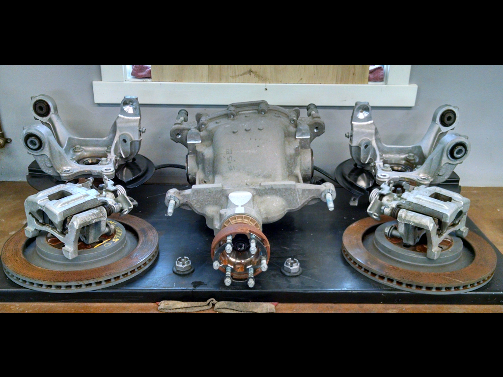

Been putzing in the shop the last few days, cleaning up the IRS diff and the brake calipers & brackets for paint.

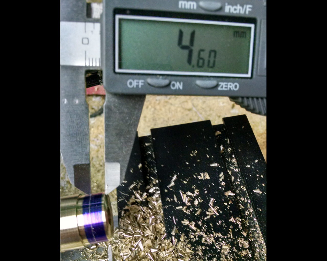

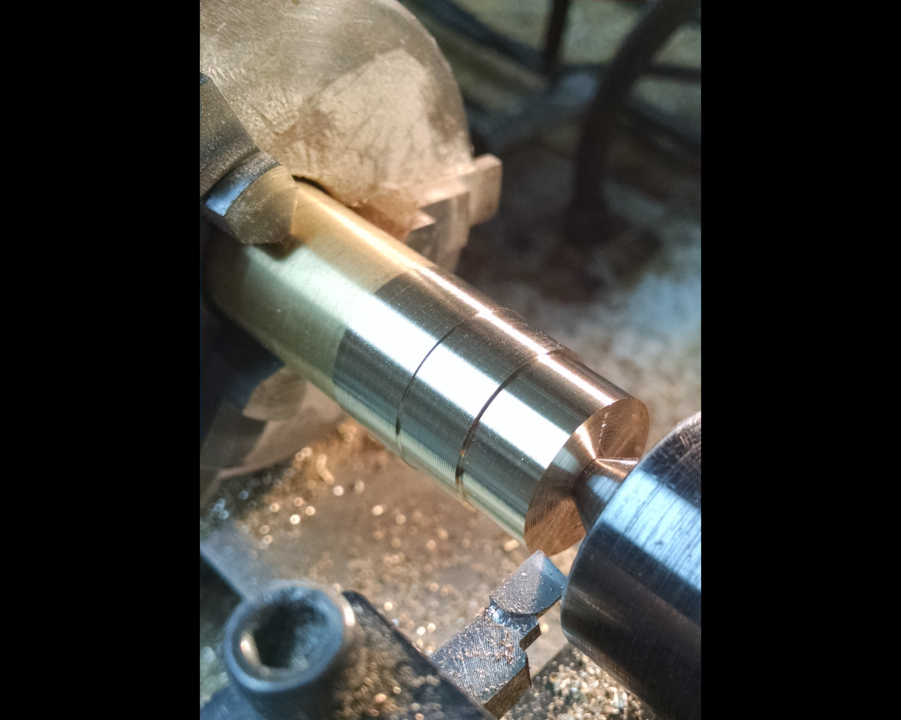

Been trying to figure out a way to positively/definitely plug the axle shaft holes in the diff so I can bead blast it. (Don't need SAND in the diff housing, or OIL in the cabinet!).
I mic'd the sealing surface of the axles and they are 46mm. That converts to about 1-13/16". As it turns out a PVC 1-1/4 to 1" pipe reducer is about 1-7/8" OD, and has enough "meat"/wall thickness to be turned down. So I chucked them up in the mini-lathe and took a few passes of material off to about 46.2mm. Some 400g to polish it down to 46.1mm, break the edge and I've got plugs!
(It took 2 more adapters each to really plug the "assembly", but it was down, dirty, and cheap... and adhered to the K.I.S.S. principle)
A session in the blast cabinet, and a few coats of rattle-can satin clear and the diff is ready!

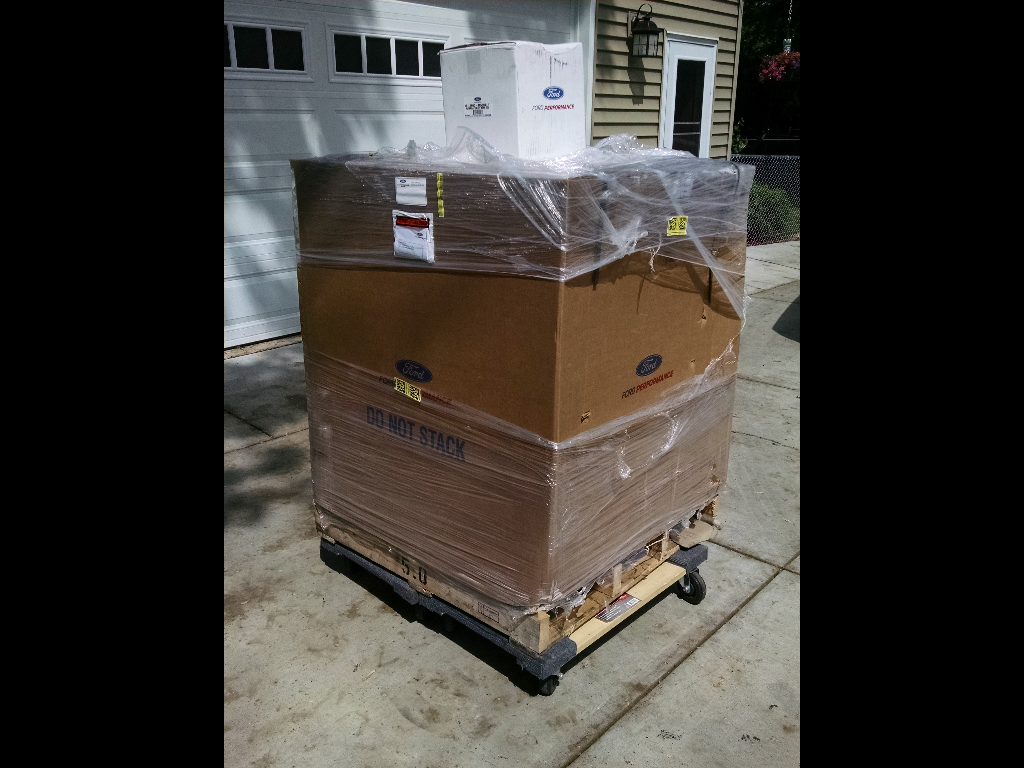

Shot off a call to my "engine guy" this afternoon when I got home from "up Nort".

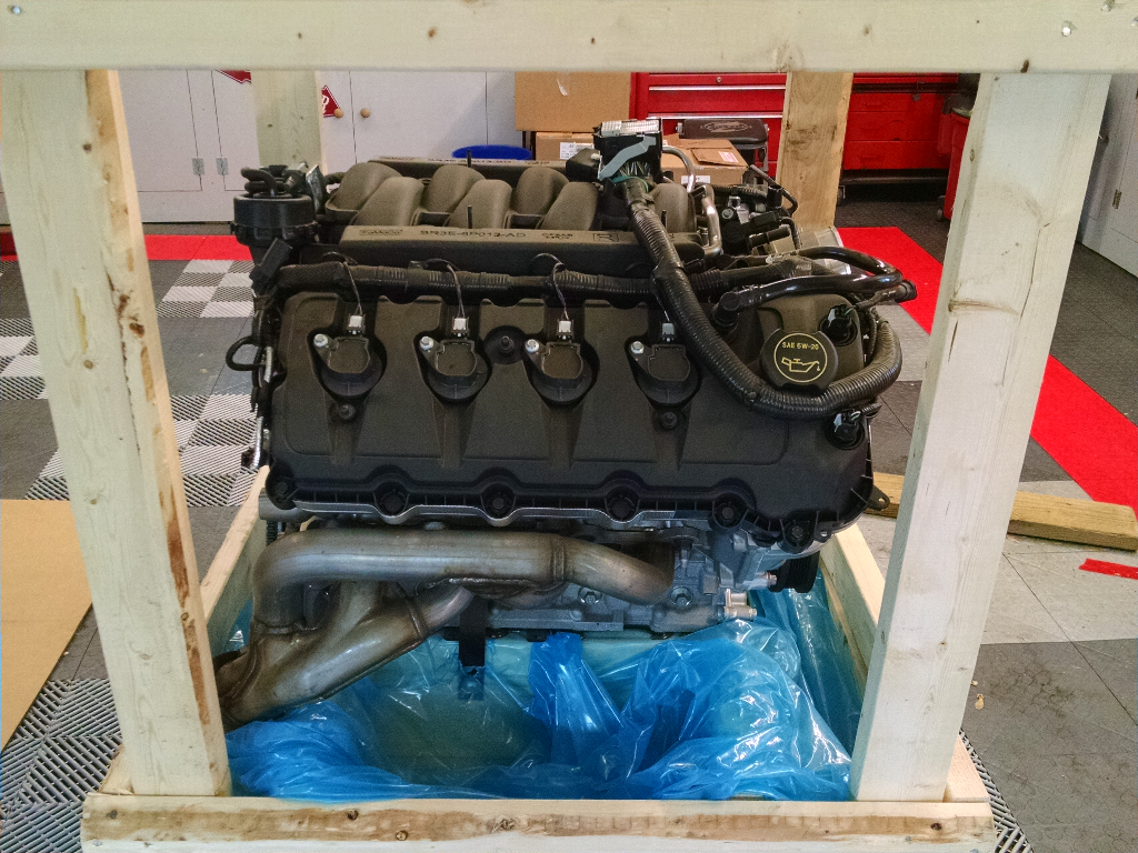

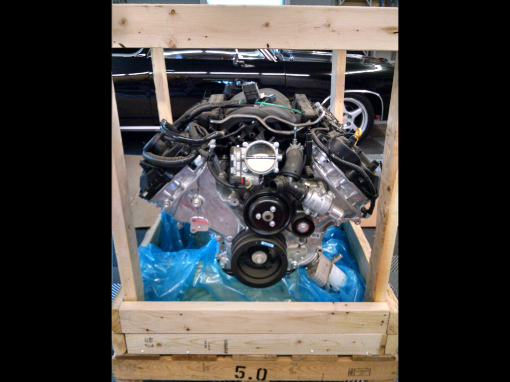

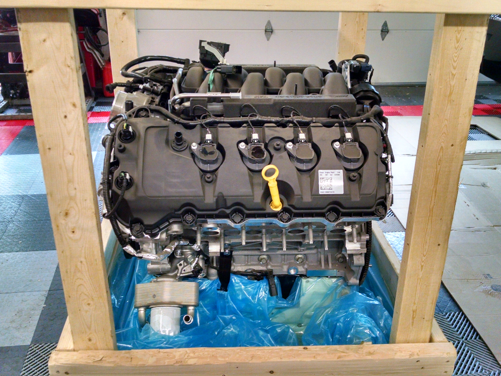

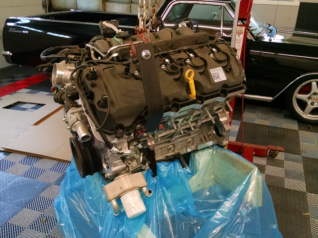

My very heavy box/pallet with a brand-spankin'-new Ford Coyote 5.0 - direct from the factory - is in Eagan. The Tremec and other toys will be arriving from MA. shortly afterward.

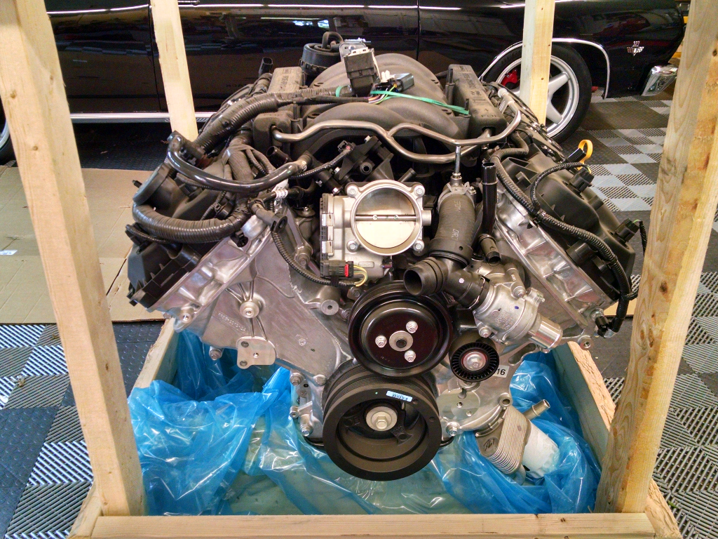

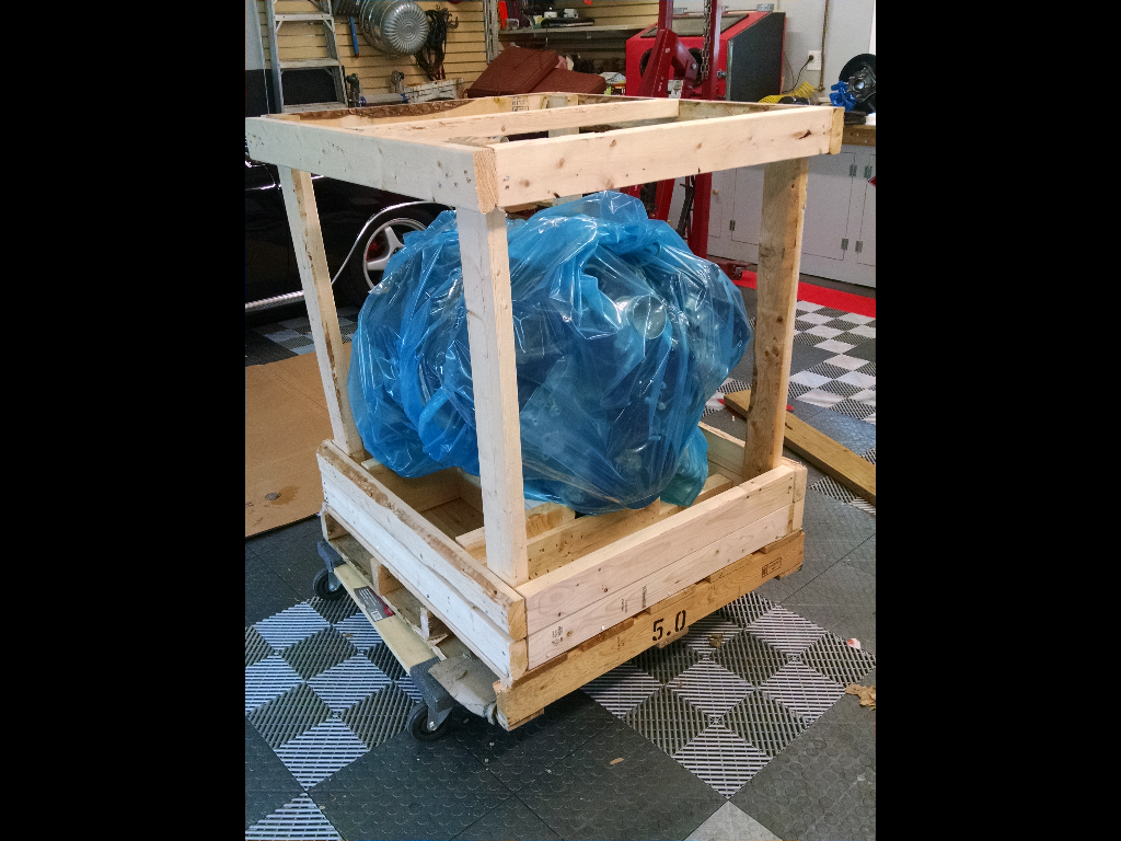

May 31, 2018

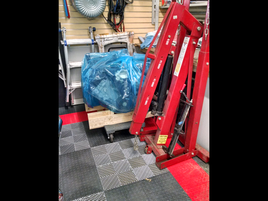

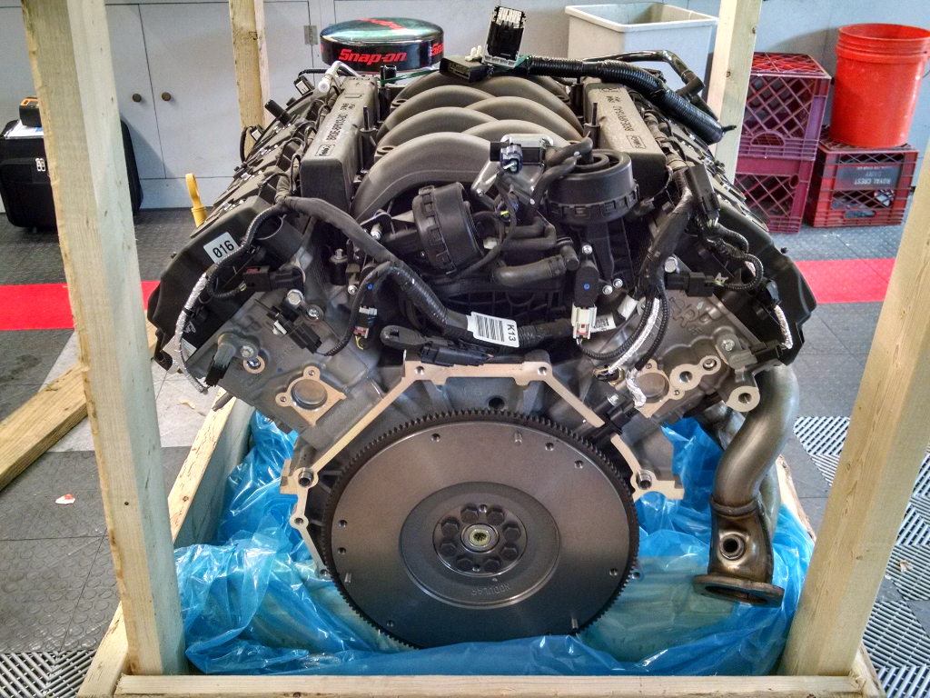

There's a Coyote in my garage! Very well packaged/crated by Ford. I was able to reuse the lower "saddles" and set it on a furniture dolly for ease of movement.
This thing is BIG - it's all cylinder head! It's all bagged up and rolled in the corner... now just to have a car to bolt it into!
Kinda fun getting piles of packages, as long as you don't think about the financial damage it took to get them there. I got a "few" things here and more on the way for the '62 Impala.

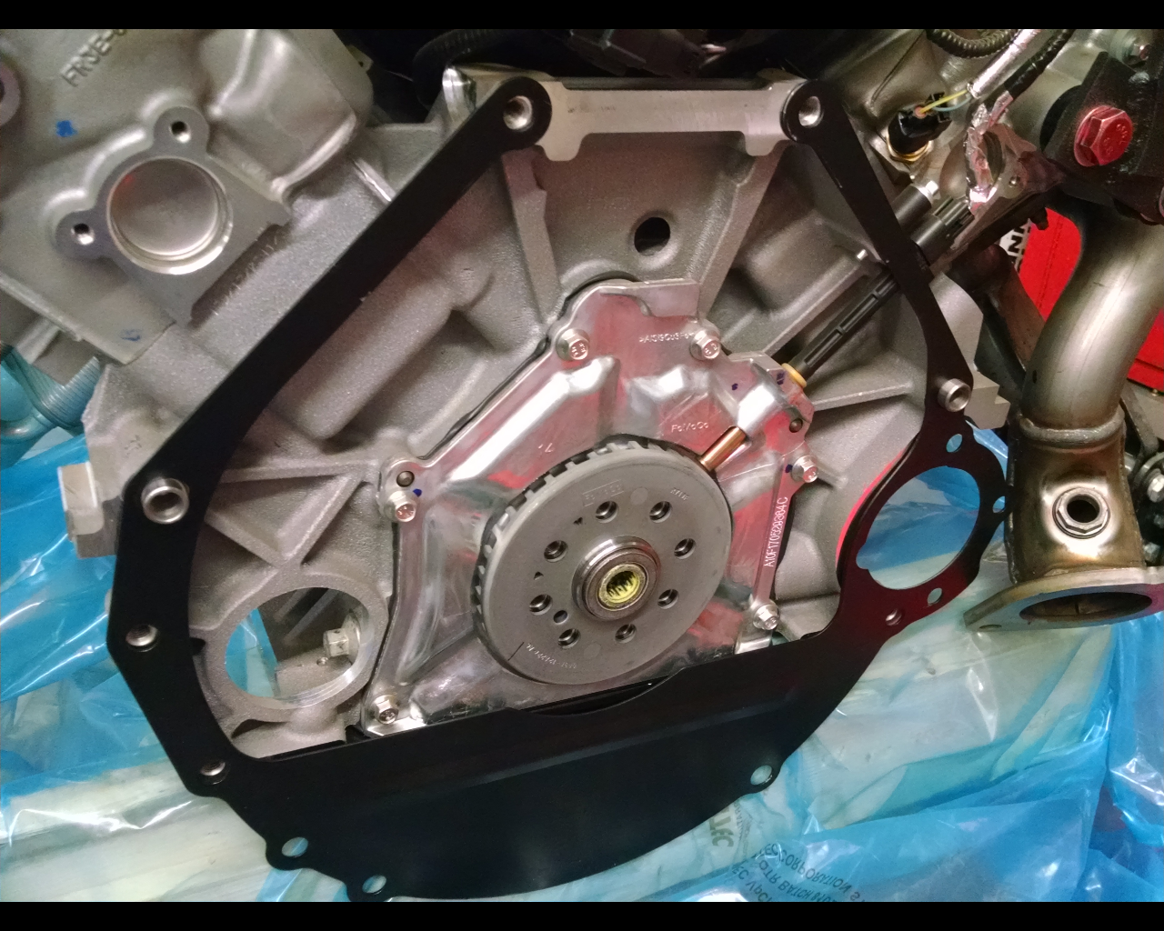

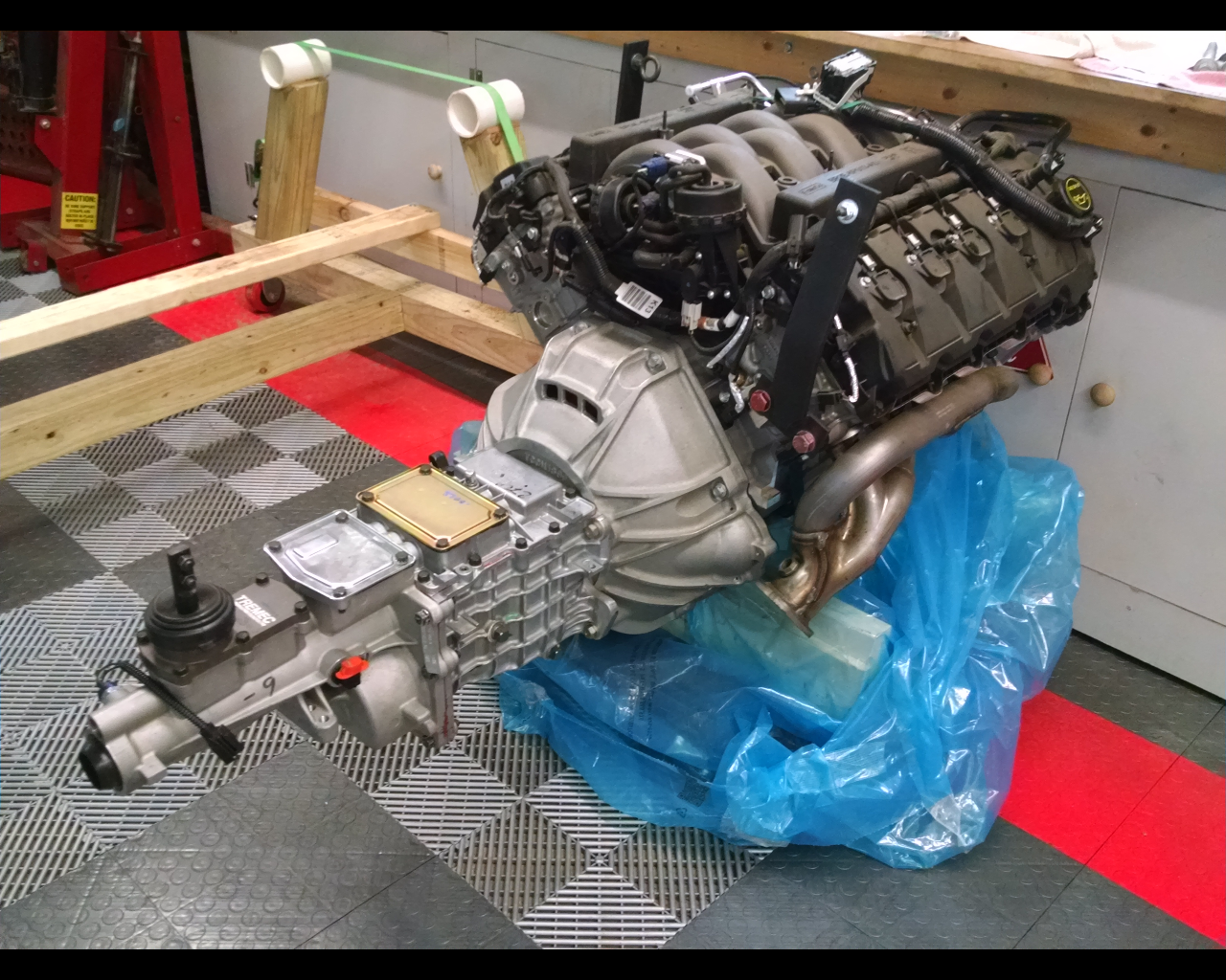

Since I don't have a chassis yet, why not work on some of the sub-assemblies and get things ready? The engine/trans package I got from Forte's Performance has been fabulous. So far everything fits perfectly, all hardware/fasteners included, and their hydraulic slave cylinder is really cool - but it has a minor flaw in the mounting to the clutch fork (more later).

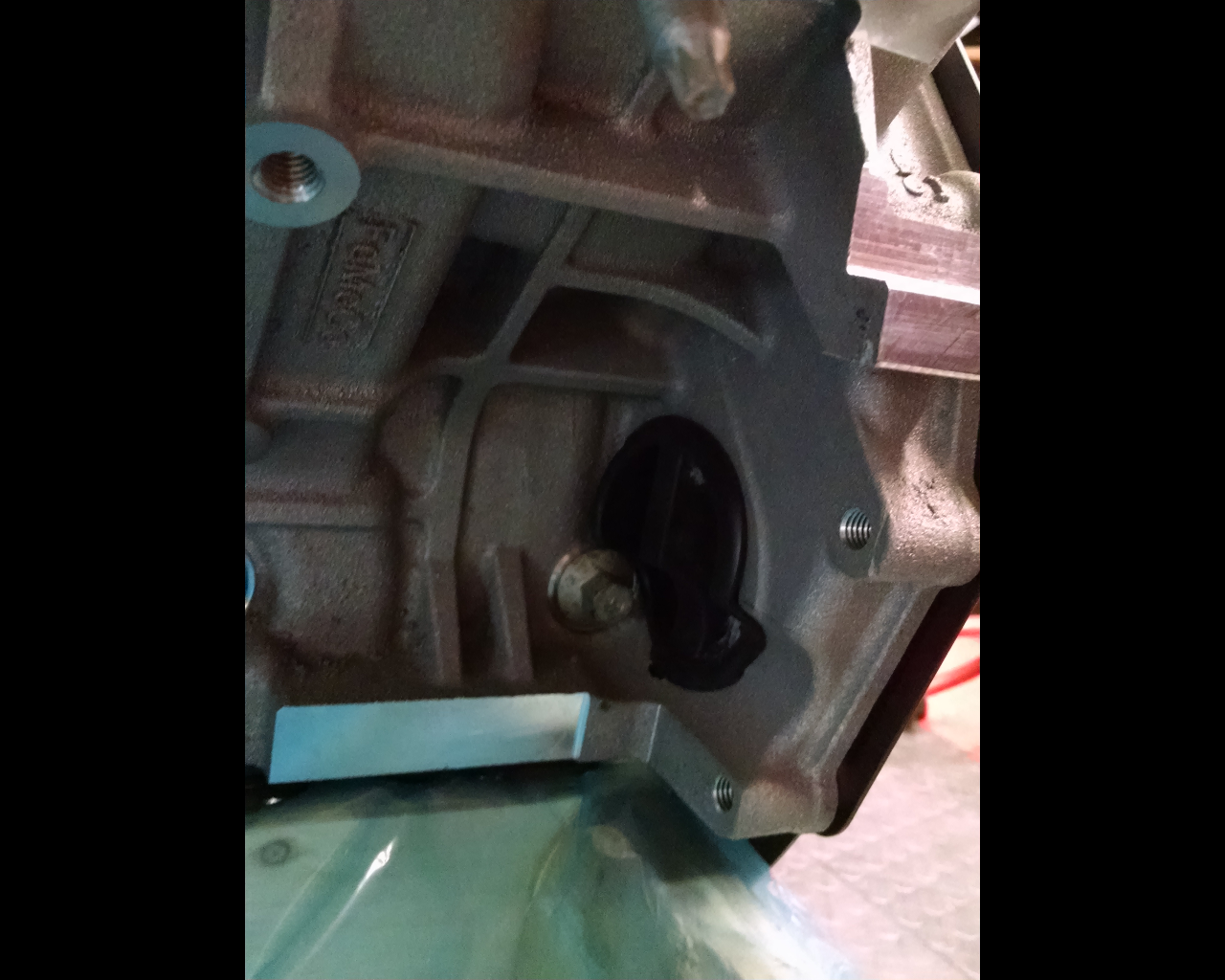

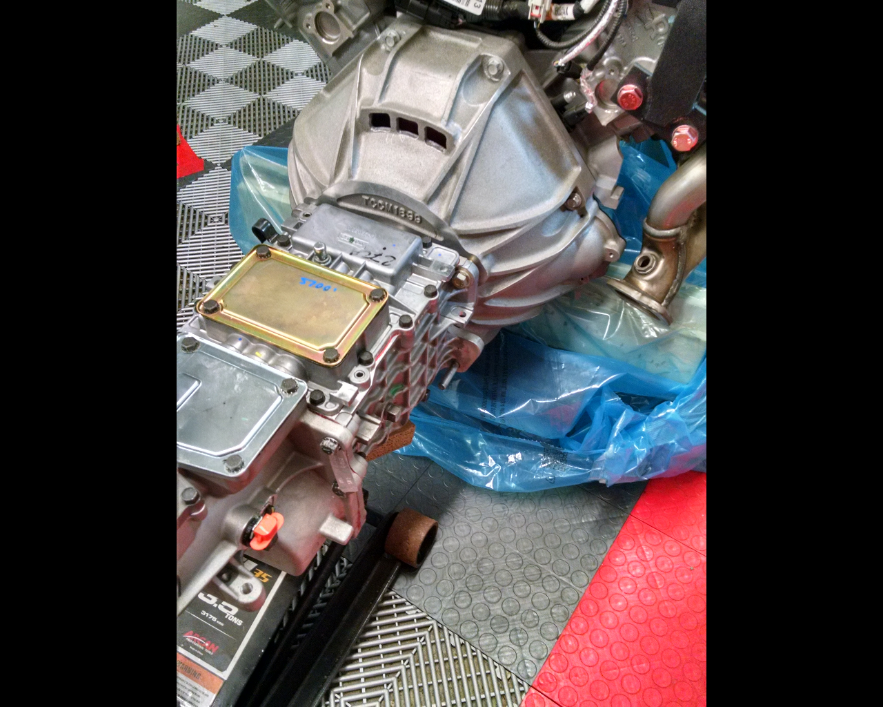

1st order of business was mounting the tin "cover plate" to the block. By far the easiest job of the day. Amounted to removing the flywheel, slipping it on, and rebolting the flywheel. While I was there I broke out the dial indicator and measured the flywheel runout. Ford did good - only +.001

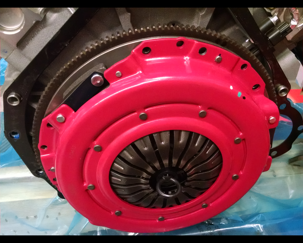

A simple job of bolting up the friction disc and pressure plate with the supplied alignment dowel. (Nice touch Ram Clutches!)

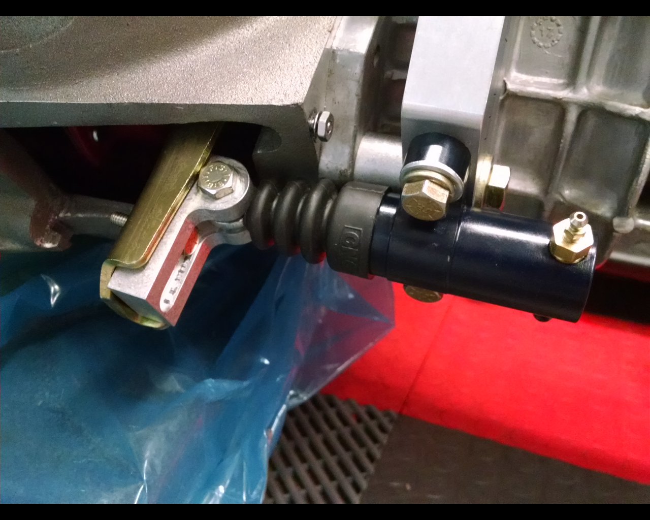

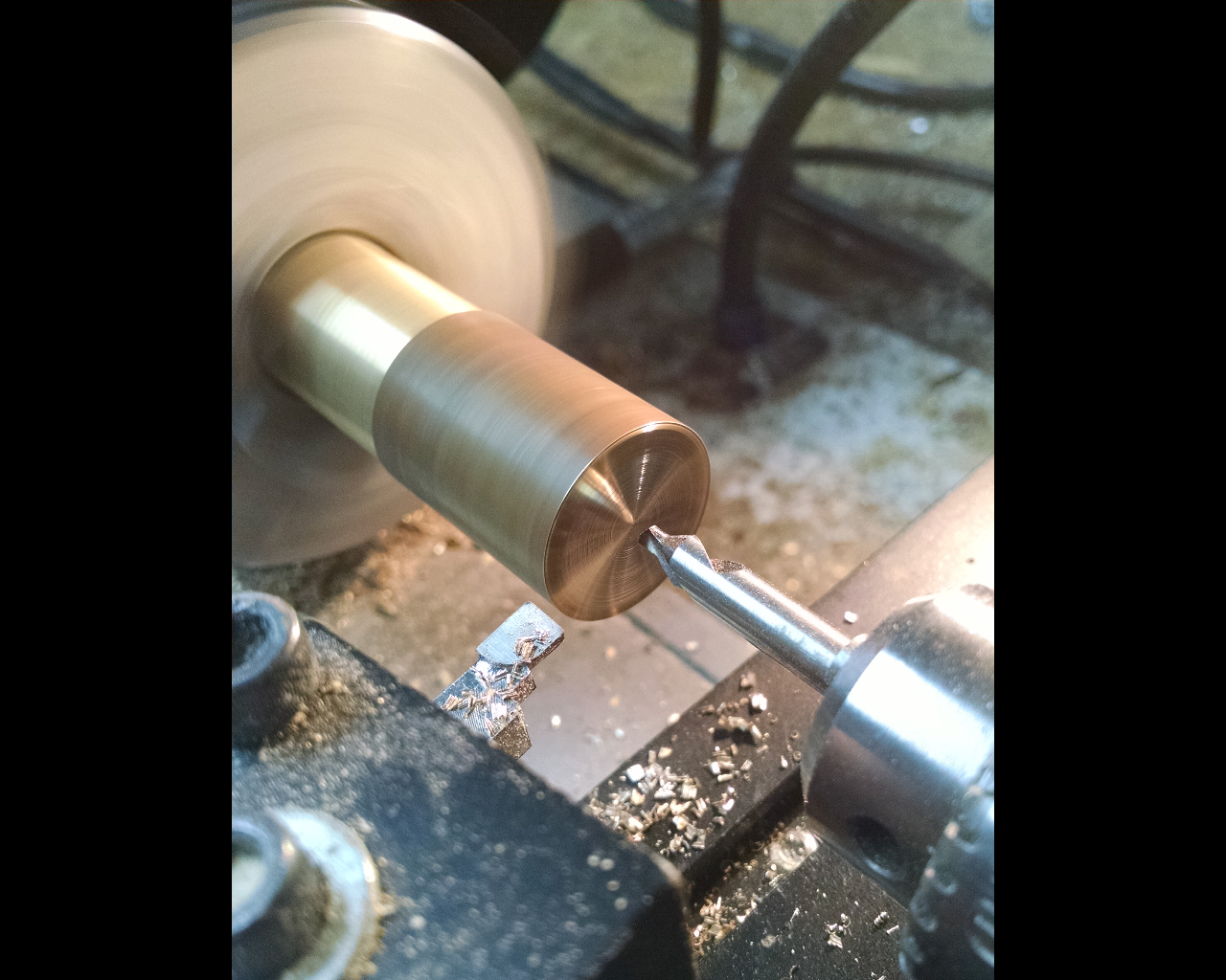

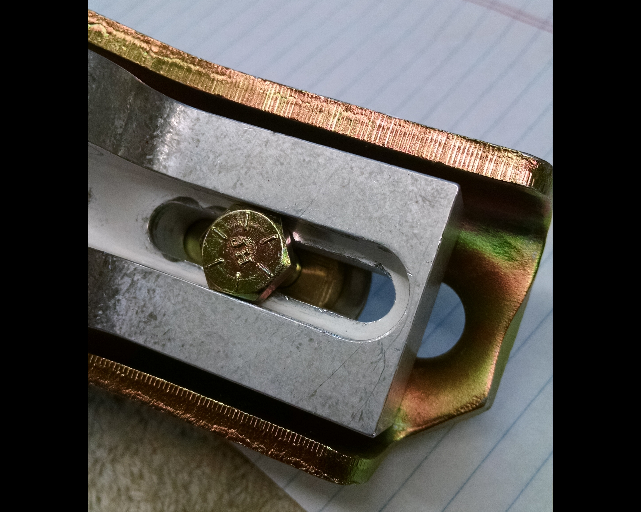

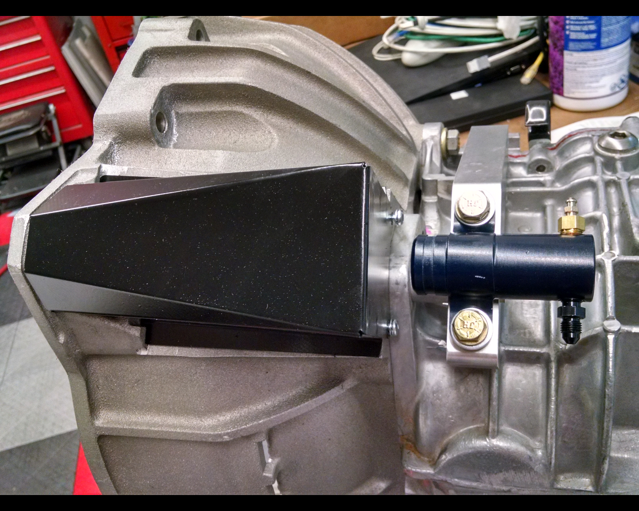

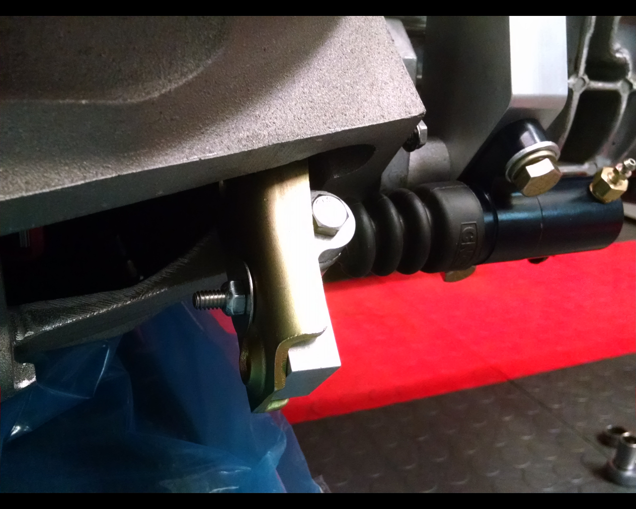

This is a great little setup! They supply a Wilwood master cylinder kit (with both a direct-mount, and remote-mount reservoir), braided stainless line with ends installed, a custom machined billet mounting bracket for the slave cylinder, a machined "clevis" adapter for the clutch fork, and a cool little slave cylinder with a Heim joint and actuator rod. Everything is really top-notch - except the attachment of the clevis to the fork.

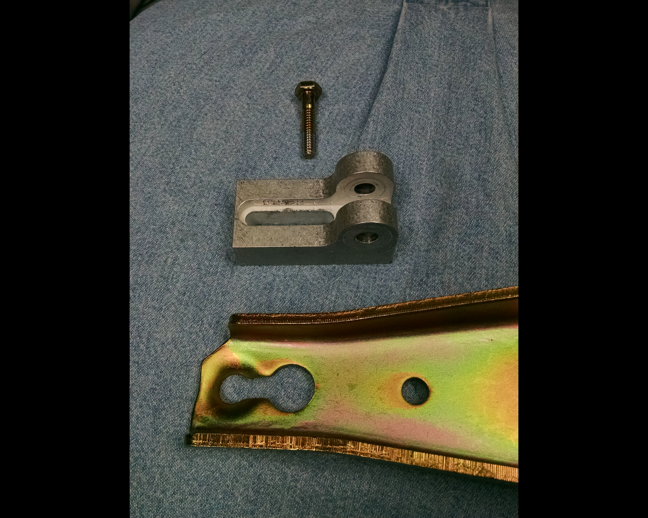

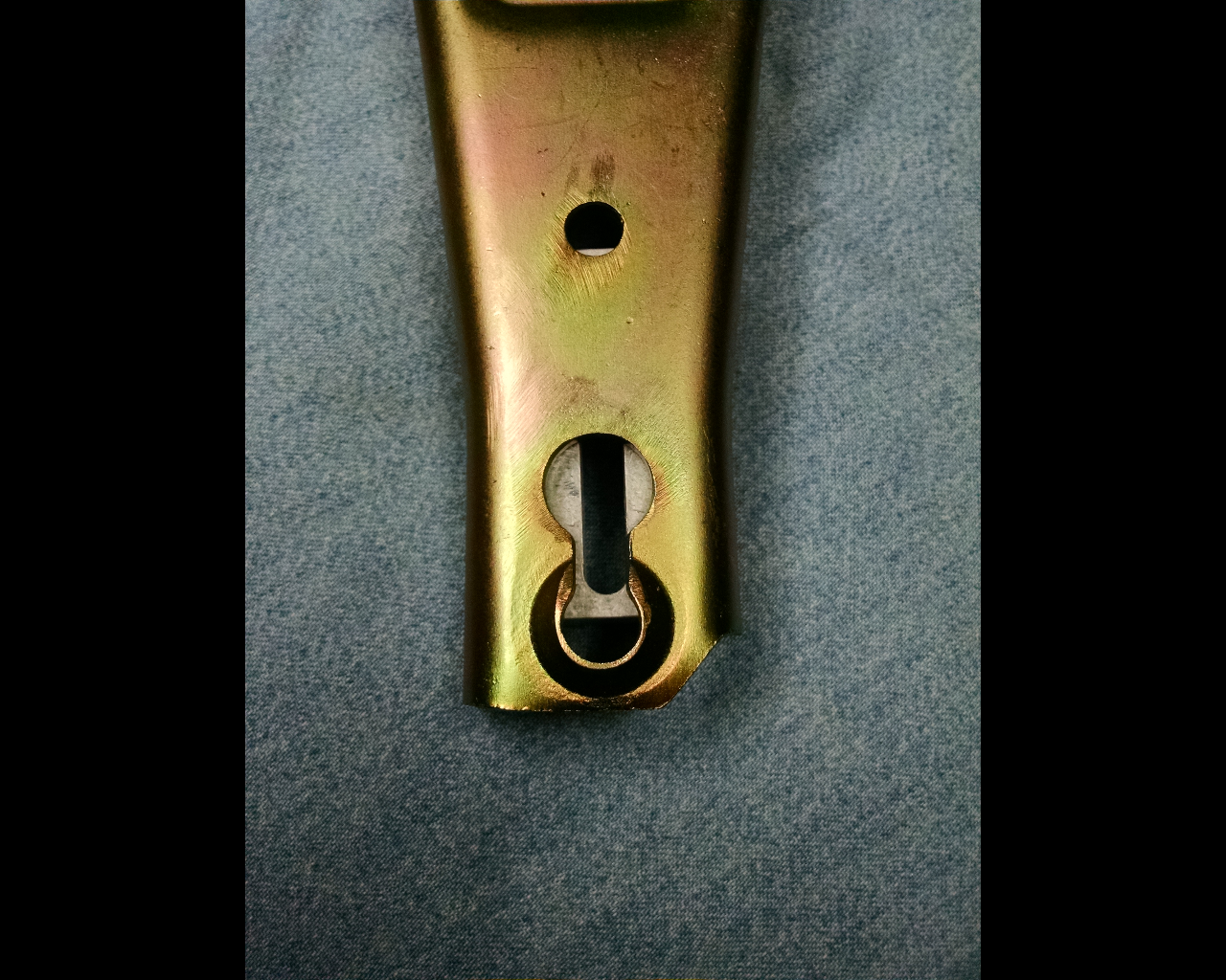

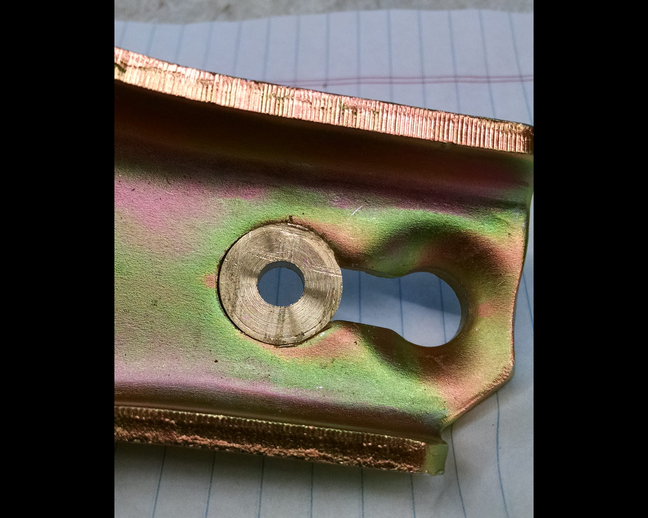

The clevis is machined to fit inside the recess of the fork, and utilize the pass-through hole for the Mustang clutch cable as a mounting point. This works, but IMO they could supply a bushing like the one I made for a better install.

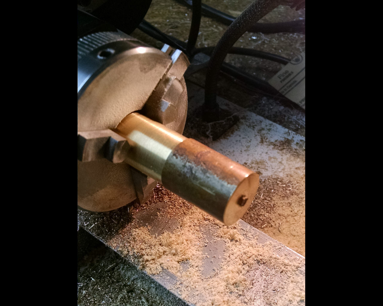

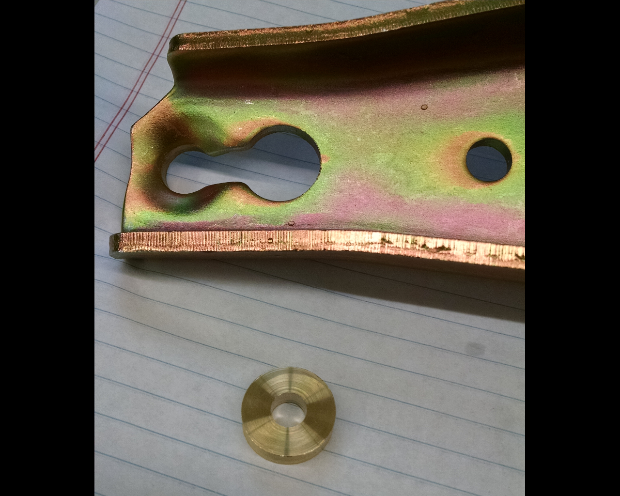

The hole in the fork is punched, and not-quite-round. I mic'd it and came up with an average. Off to the Sherline mini-lathe... chucked up a piece of brass rod and put on the Machinist Hat. After turning it to size, drilling it to 1/4", and parting it off, voila!... a reducing bushing that fit in the hole (with a few love-taps) and corrected the slop.

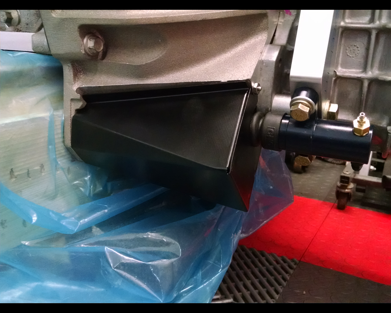

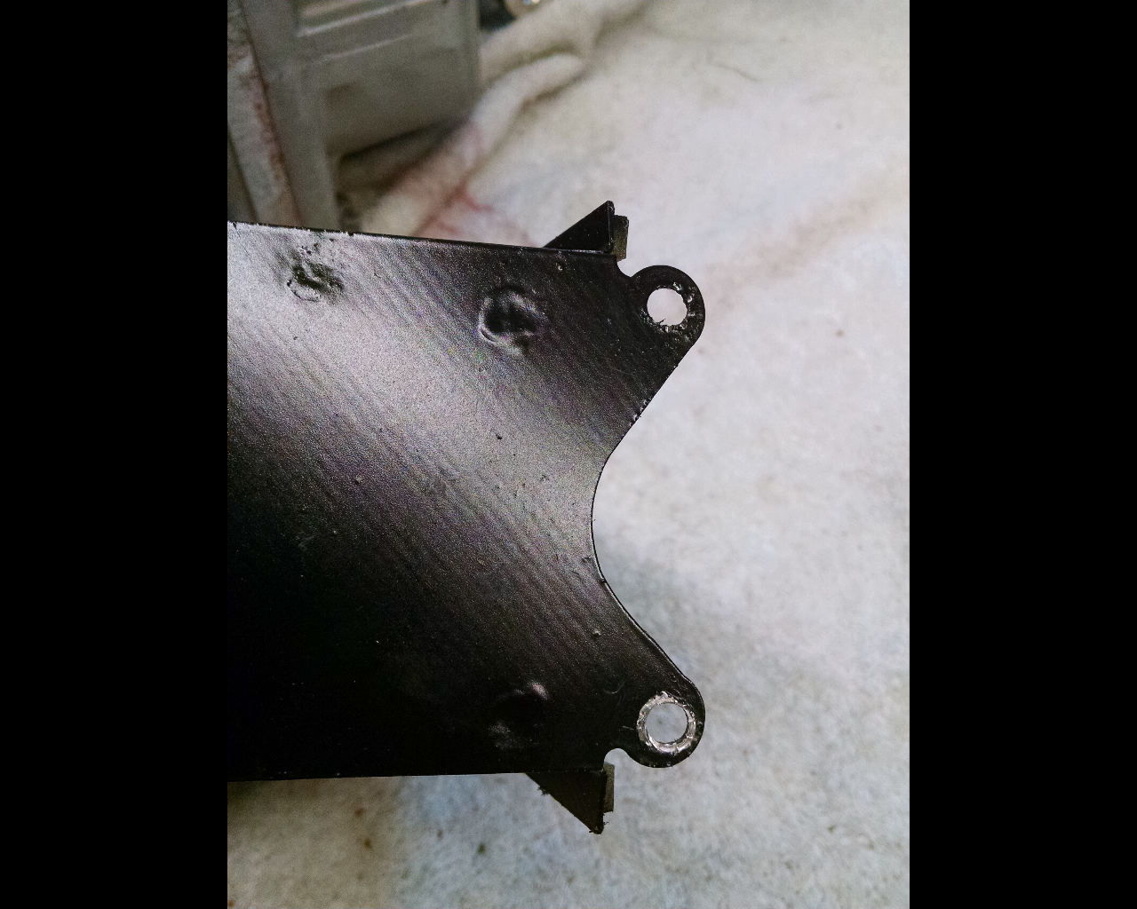

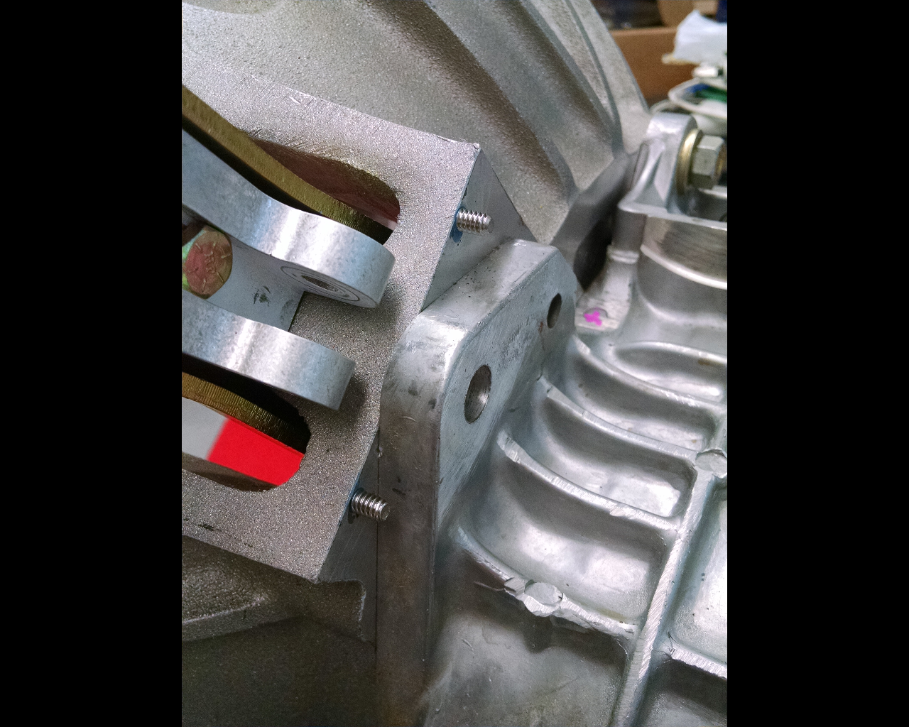

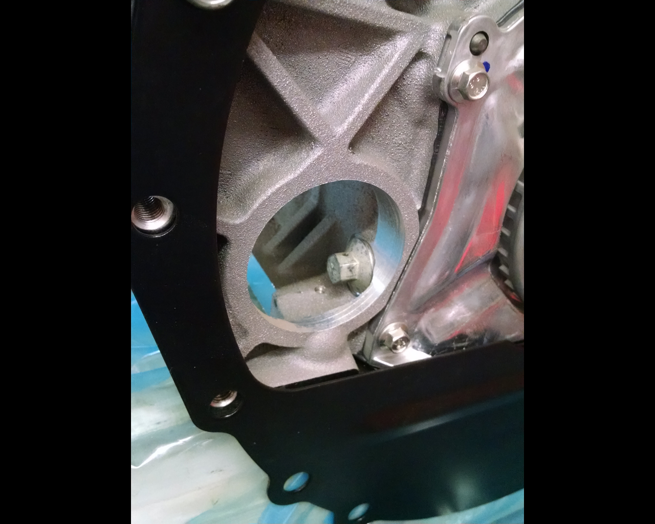

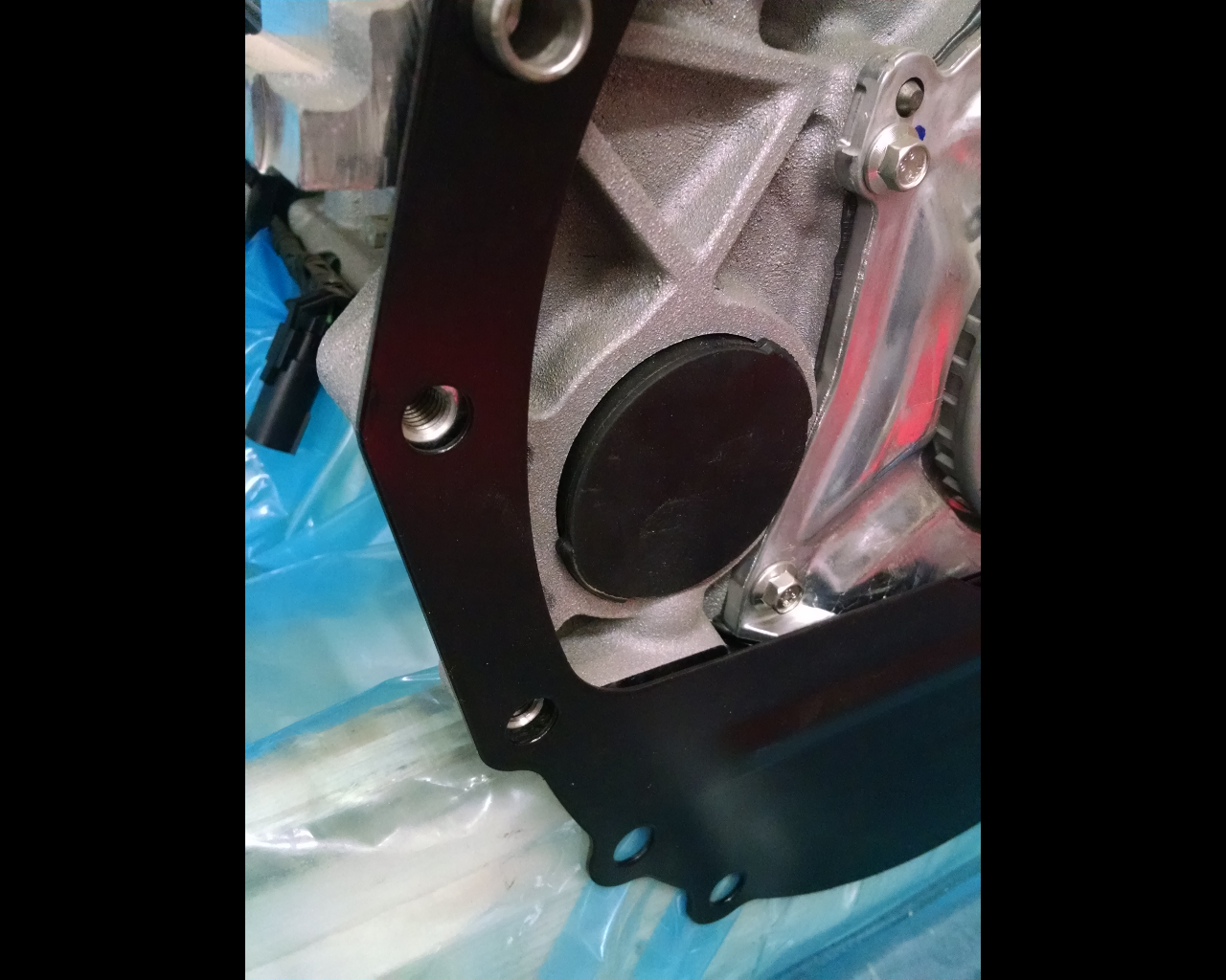

Since the bellhousing is really for a cable-clutch car, it comes with a neat little stamped tin cover "hat" for the clutch-fork opening. A few minor mods and I was able to use it with the hydraulic setup.
The slave cylinder bracket blocks access to the fastening screws. For (future) clutch adjustment I'll have to remove the cover, so... I snipped the mounting holes into slots, then punched a 1-1/8" hole in the end cap of the cover - then made the hole into a "U" to go over the actuator rod/bellows.
A couple of 1" 10-24 machine screws got the heads cut off, and now serve as studs in the bellhousing. I can now get at the hold-down nuts with a wrench to remove the cover.

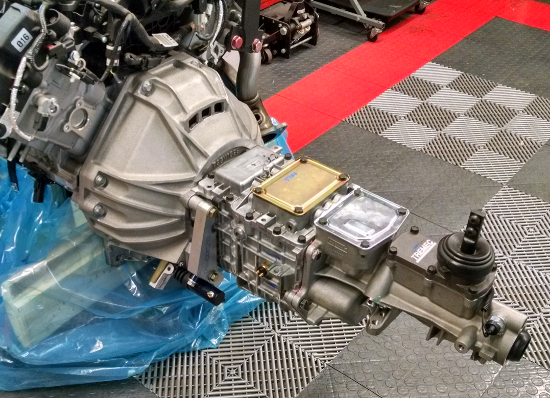

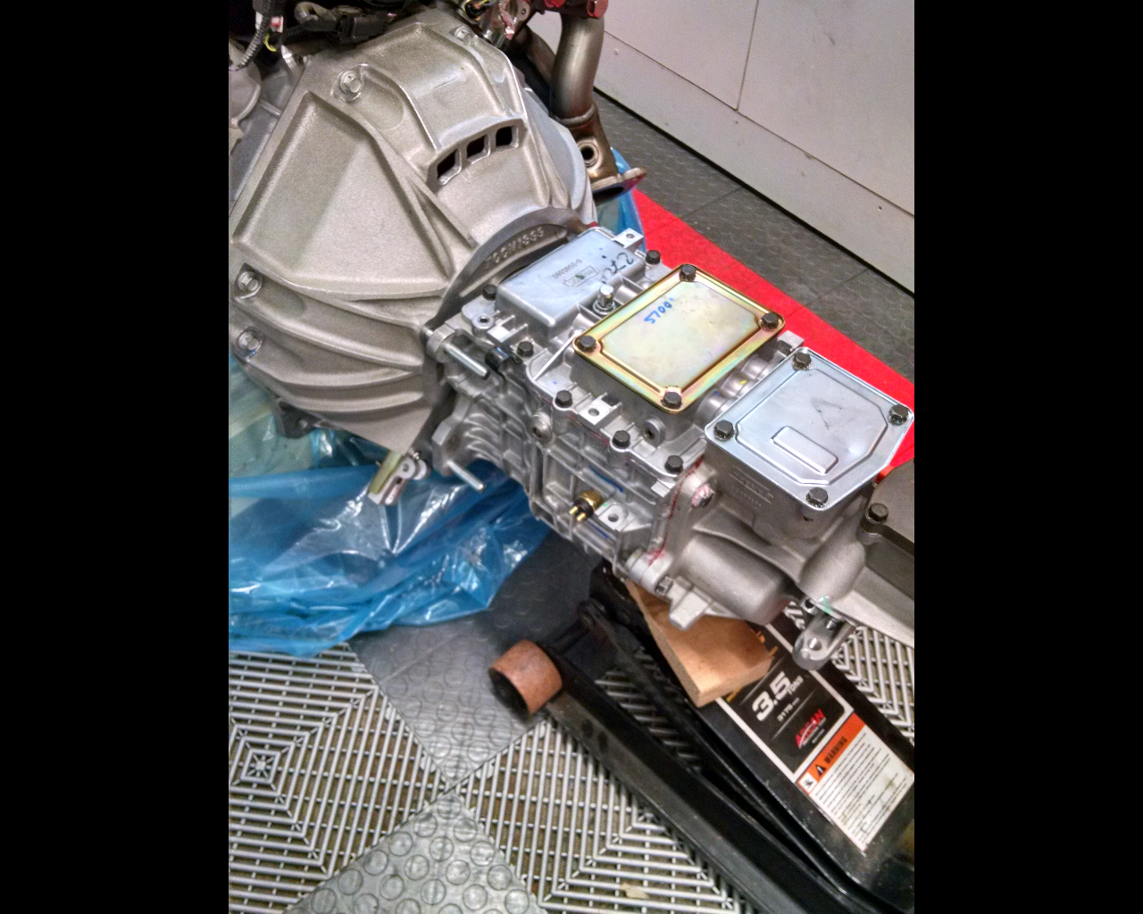

Last step was actually bolting up the transmission. This thing's a beast!
I picked up a few long bolts the same thread as the bellhousing, and cut off the heads to make alignment dowels/rods. A few passes in the end with the hacksaw and I've got screwdriver slots to remove them.

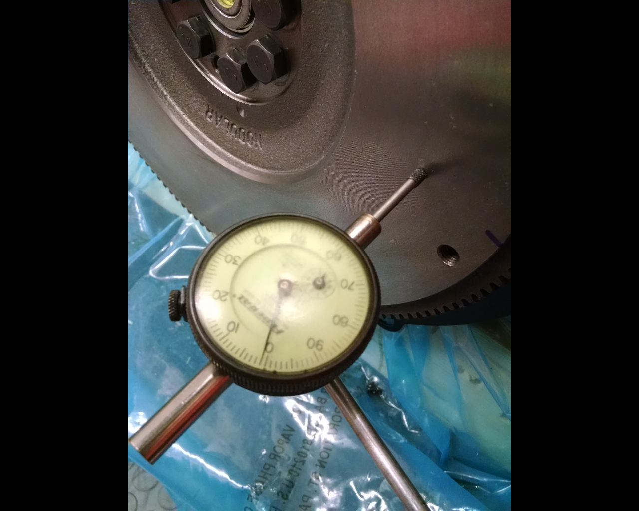

I purposely only did 3, leaving the last open for a bolt. After getting things all jigged up and started, I wanted a way to "hold onto" the progress I'd made using the bolt. After several choice cuss-words and a lot of fiddly/wiggling/jerking there was a satisfying THUNK - and the gearbox was mated up.
The actuator rod access cover was removed, and I started fitting the actuator rod itself. It's a universal-fit part, and requires trimming to length. I needed to shorten it by about an inch. I then set the freeplay of the throw-out bearing, locked it down, installed the cover and done.

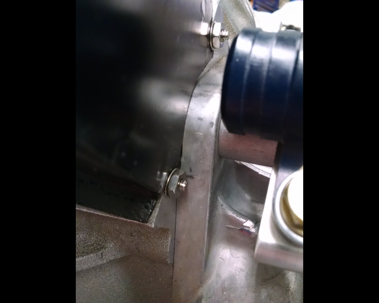

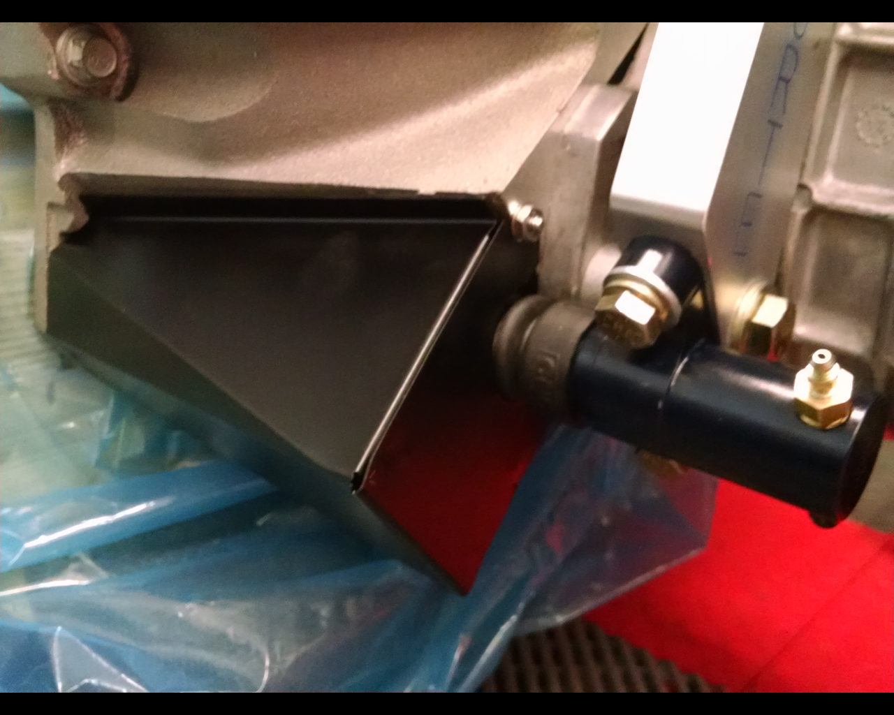

Don't want to bore you with more pics, but I swapped the stock Mustang oil pan with the "built to spec" Moroso pan for the FFR Roadsters. Pretty simple stuff, gotta love the new/modern gaskets. (And yes, I did the trick with the baggie on the pickup, and play-doh in the sump to check clearance... it's 3/8".)

I got a complete 2016 IRS setup (1000 mile take-out), from an outfit near Dubuque IA. Midway Mustangs (What was annoying is the shipping was almost 50% of the price of the assembly... but it's nearly 500 lbs, and had to come by truck)
What was funny is unbeknownst to the warehouse staff at work, I'd talked to the SCS (Supply Chain Services) manager at work, and got permission to have this thing shipped to the shop. (I couldn't deal with a "delivery window", me not being home or taking time off, and/or Sheryl unloading a 1/4-ton pallet of car parts). It was there in 2 days.
I get a call Wednesday from one of the SCS people... "Hey John, there's this BIG pallet with a shrink-wrapped car axle on it at the warehouse for you... it is really a pain - when are you coming to get it?!"
Tools used:
Now to try and get rid of/sell the leftovers...
There is definitely less frustration/mess working on newer cars/parts that come apart nicely.
Which parts will be re-used?
These are what's re-used.
The kit provides all the arms, coil-overs, and new half-shafts.
Dashboard will be proud of you using some wood on your project.
If Mopar hadn't already claimed the name, that's what I would call a 'wedge' motor!
A wedge FIT into the engine bay! It fits, but it's very tight - not a lot of wiggle-room.
Forte Performance hydraulic clutch setup...
