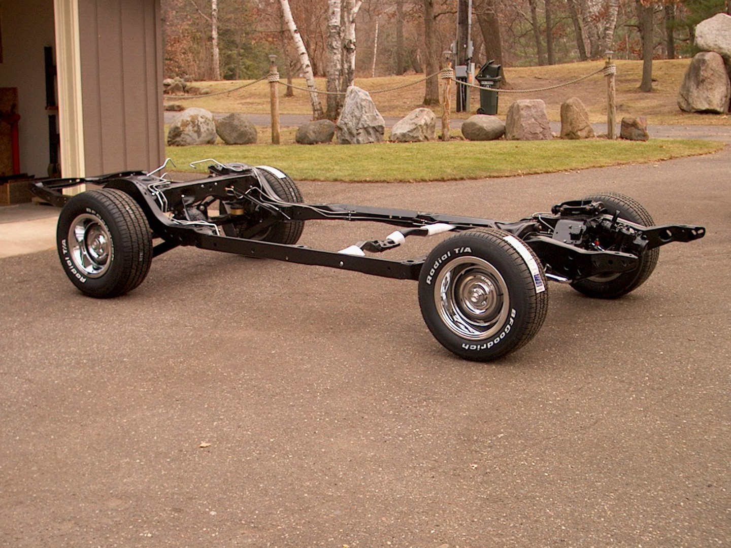

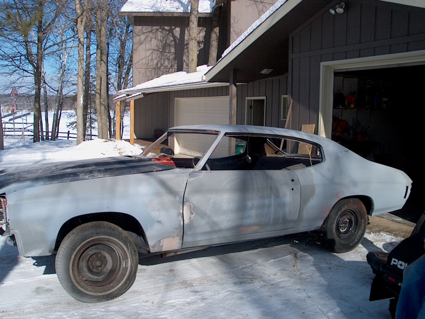

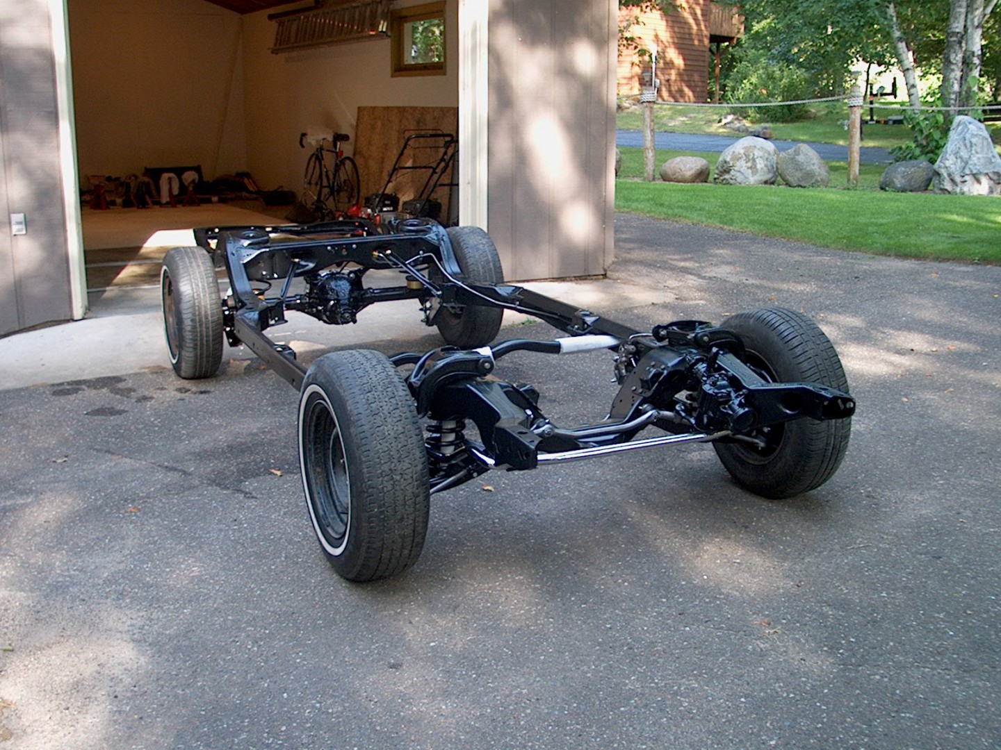

Bought this car in Feb '11. Had to go to Kansas City, MO to get it. I have the build sheet for it.
Car is a 402, 4 speed, 12 bolt posi with 3:31. It was originally Placer Gold, black vinyl top, with a black interior. It is now Midnight Blue Matallic. The original motor blew-up many years ago. But, it came with a year/car matching 402. Engine has been completely rebuilt and already fired.
Hoping to have it finished summer '14.
I have attached some pics to show my progress over the years.

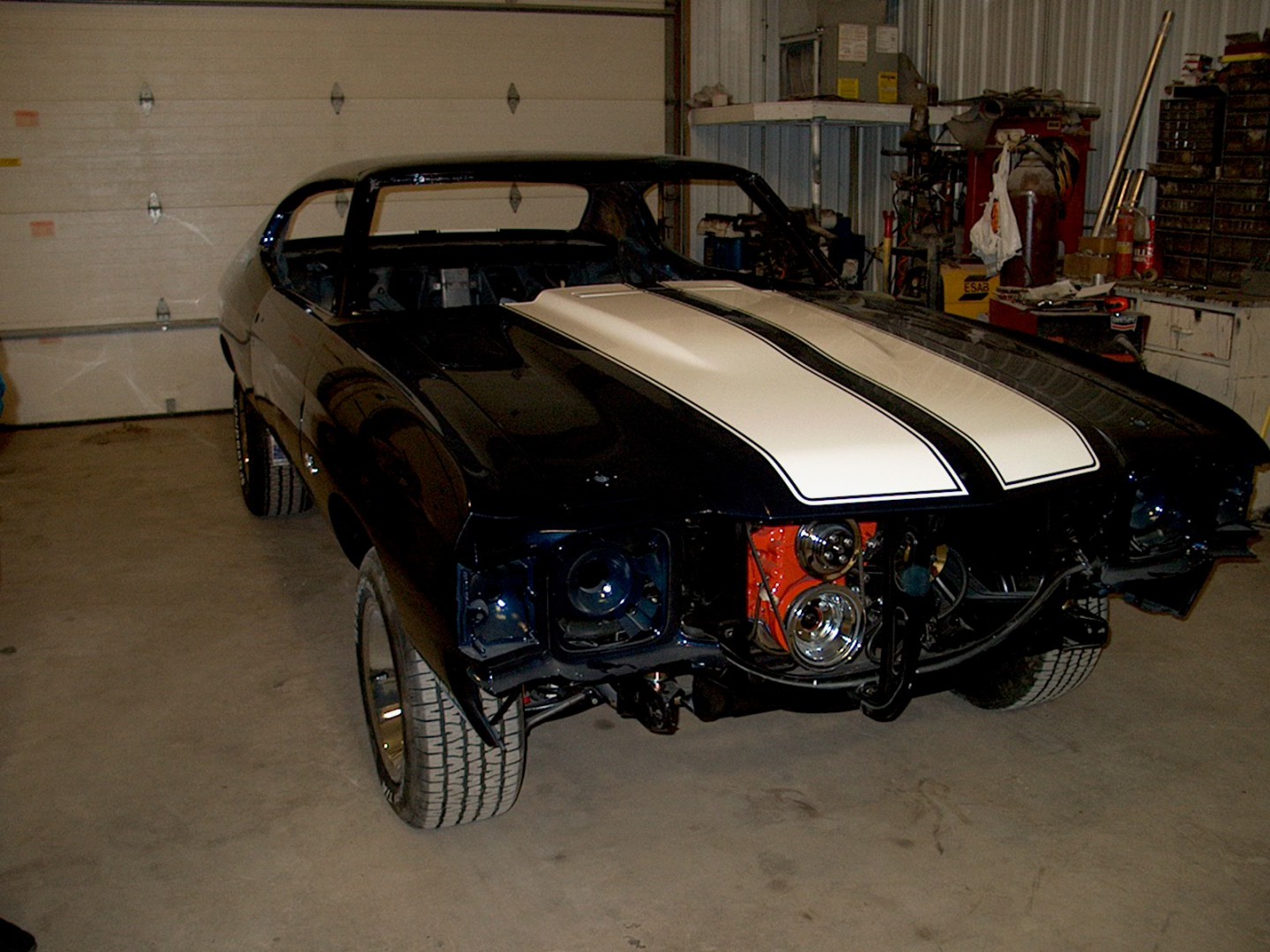

I don't see any pics of body work. Was it that clean that you could just shoot it ???
Nov 20, 2013
Thanks everyone for the positive comments. It has been a fun project.
The body was very solid. The rear fender wells and some small holes in the rear of the front fenders were the only parts of the car that needed repaired. The floor, trunk floor, trunk lid, doors firewall, etc. were all fine. There is the 'usual' surface fill for straightening purpose and you can see in the one pic.
The body man has some pics of the body work that was done. He will give them to me when the car is done.
What is left is painting the hood, striping the car, final alignment of the doors, fender and hood and final buffing.
Hoping it will be home the first week of December.
Then I get to put everything back on it.

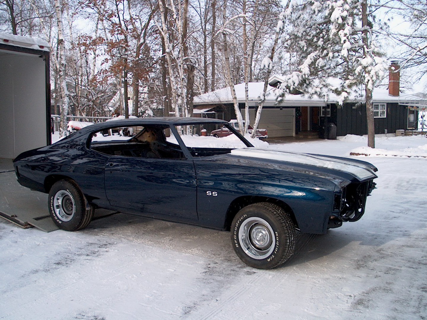

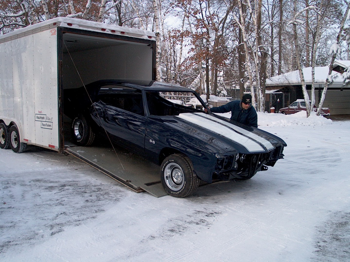

Went and looked at the car today. Progress has been made. Hopefully it will be home next weekend.
Lookin' good Hank! Especially like the white stripes, but then again I'm a bit biased!
I see you are in the Brainerd area, so curious if you will go to the Pequot Lakes show in June? Three of us have driven cars there, and spend the weekend in cabins, and it's a blast. Great car show venue in the city park. Last year was kind of a bust with cold, windy, and misting all weekend, but we made the best of it. I'm sure we will do it again next year, so watch the forum for announcements.
Otherwise, your car will go back together quickly once you get it back. And, you have 6 more months of winter to work on it if we have another Spring like this year...

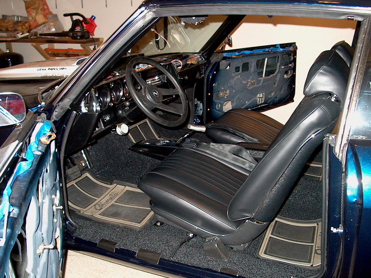

Off to the upholstery shop for headliner and carpet. When I got there, he had my door panels done. After the carpet/headliner, he will work on the seats.
What did the guy do with the door panels ? Did he build them from scratch ?
Oct 22, 2014
I bought the Original Parts Group Inc. Stage IV interior kit (https://www.opgi.com/chevelle/1971/interior-accessories/interior-kits/I411/).
The door and rear quarter panels come complete with the hard board already on the vinyl, but you have to transfer the metal piece that hooks into the body, from your old door panel. The panels have all the cut-outs for the various holes in the panels. You just pop out the hole insert and cut the panel. If you want to see a picture of the back, just let me know.
I elected to not transfer the emblem in the center of the door, because 1) the new panel was not cut out for it and 2) it would have required us to try and lift the vinyl on the new panel to get it installed. I did not want to chance ripping it, or stretching it so then it would not sit back down properly.
Oct 22, 2014
That's what I was thinking, you bought the unfinished panels and needed the upper mount installed.
Oct 22, 2014

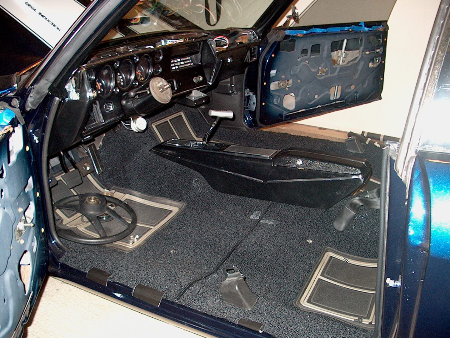

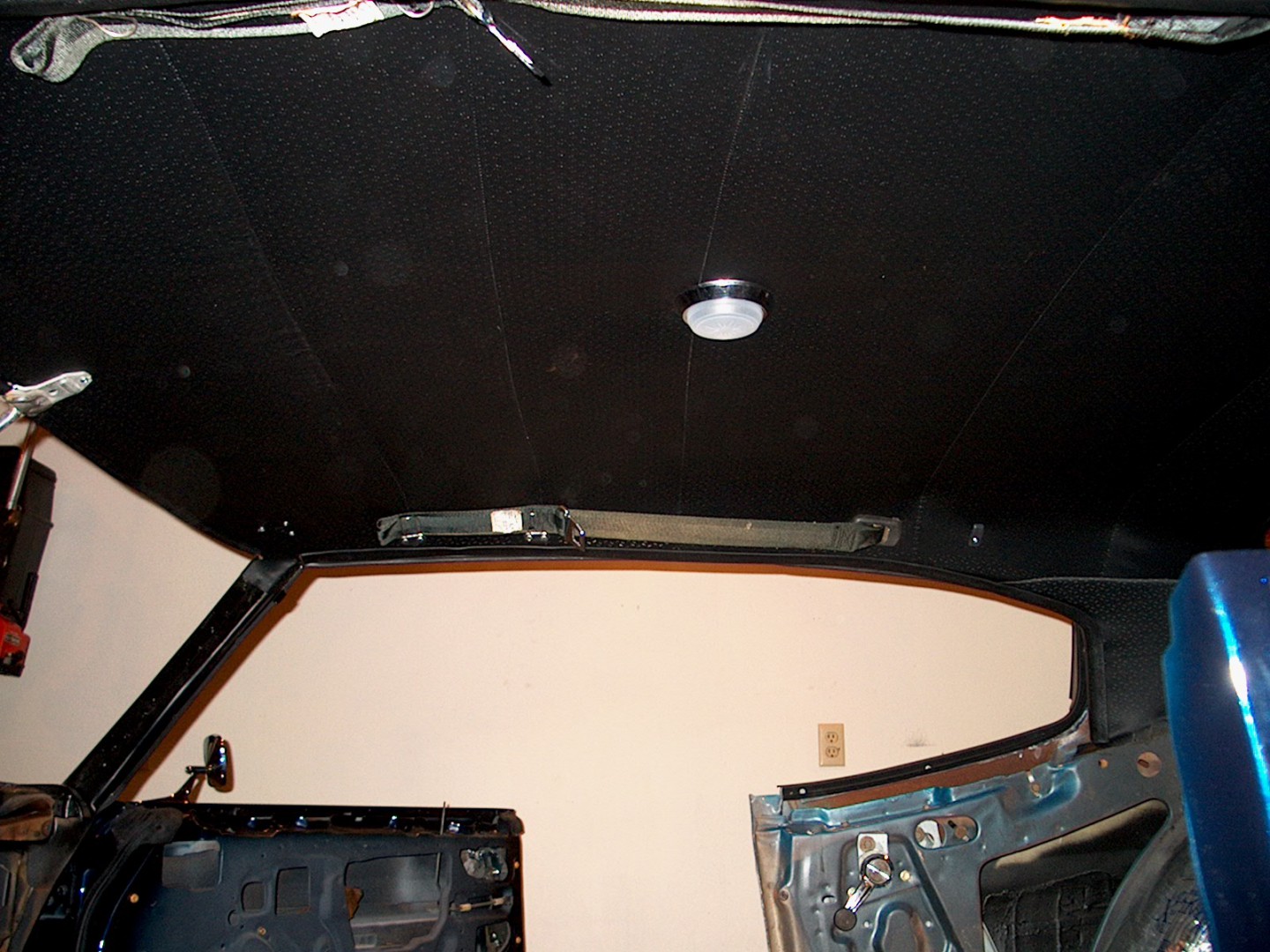

Just got the car back from the upholstery shop. Carpet, headliner, sail panels and package tray have been installed. Also had to check out the floor mats.
That's funny Hank... I saw your thread this morning, and was just wondering how you were coming. Keep up the good work, you are on the downhill slide now! Once it's time for the interior, it's not far from there!

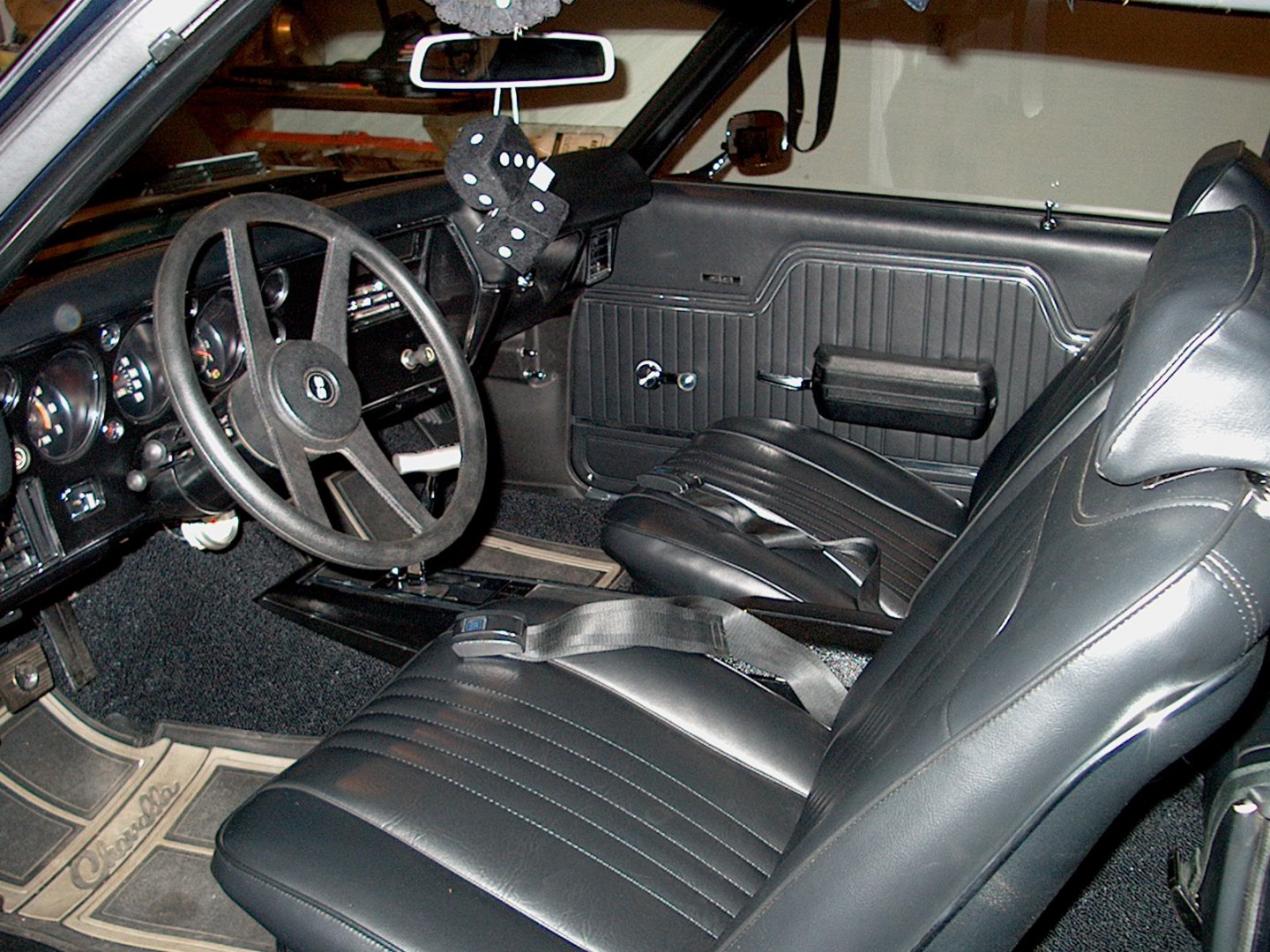

Got the seats back form the upholstery shop. Right now, the car can not get together fast enough, but I have learned to be patient. If I am not, mistakes will be made or corners will be cut. Besides, where am I going to drive it now.
Looks nice Hank. Did you install the upholstery yourself?
Feb 8, 2015
I had the upholstery shop install the headliner, carpet and assembly the seats and rear interior and door panels (need the metal transferred). I will be installing the rest.
This is the end of year 1
Here is year 2
This has been this summer.

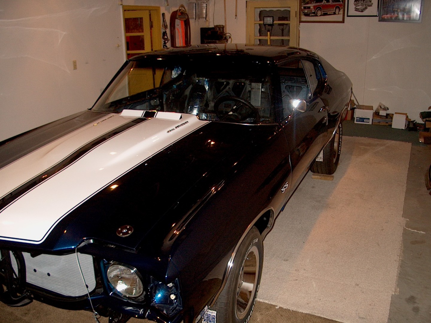

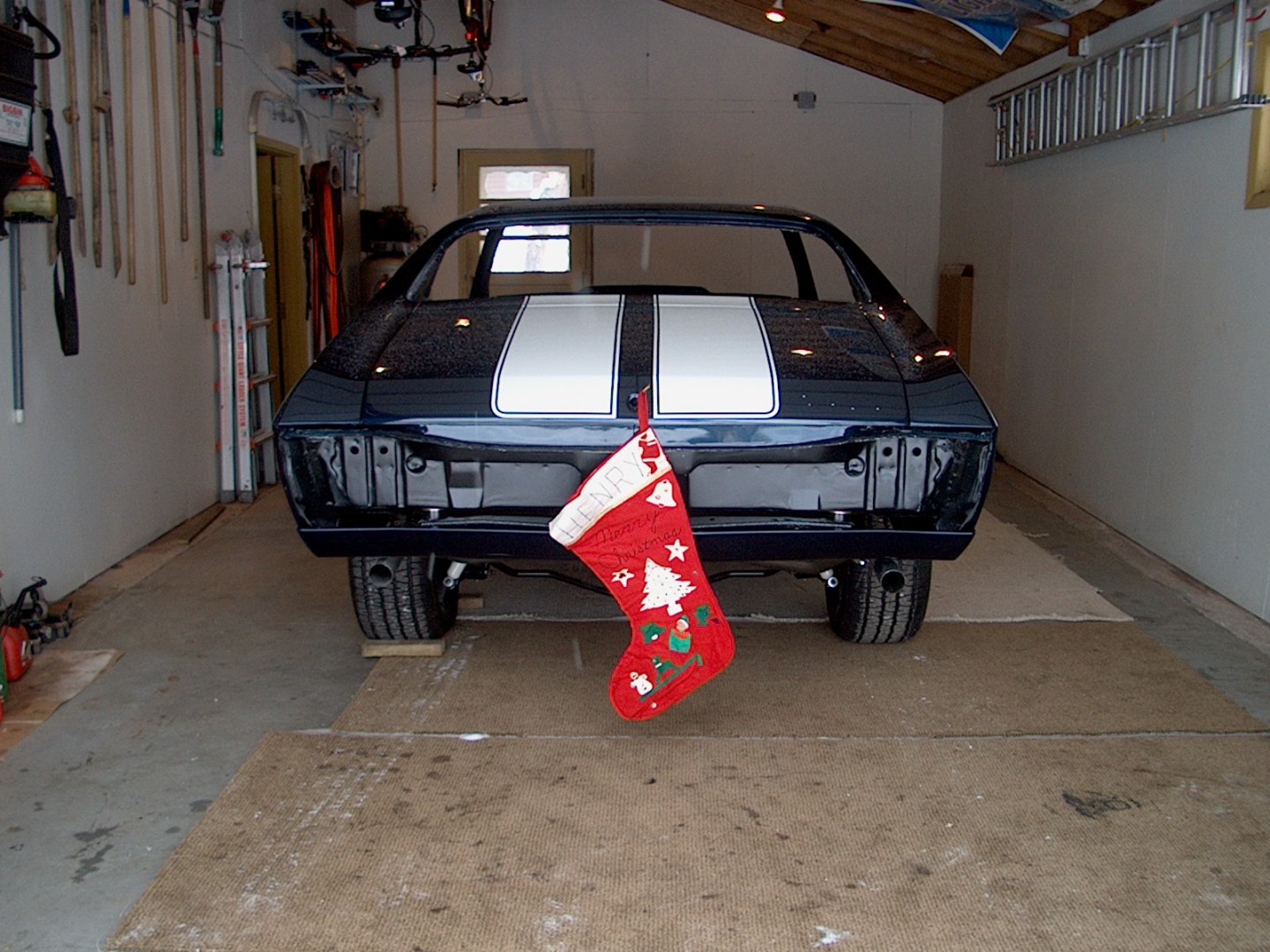

12-08-2013 Home from the body shop!
Santa must have thought you were very good this year!
That stocking could hold lots of parts!
