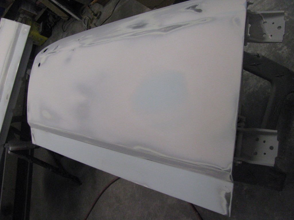

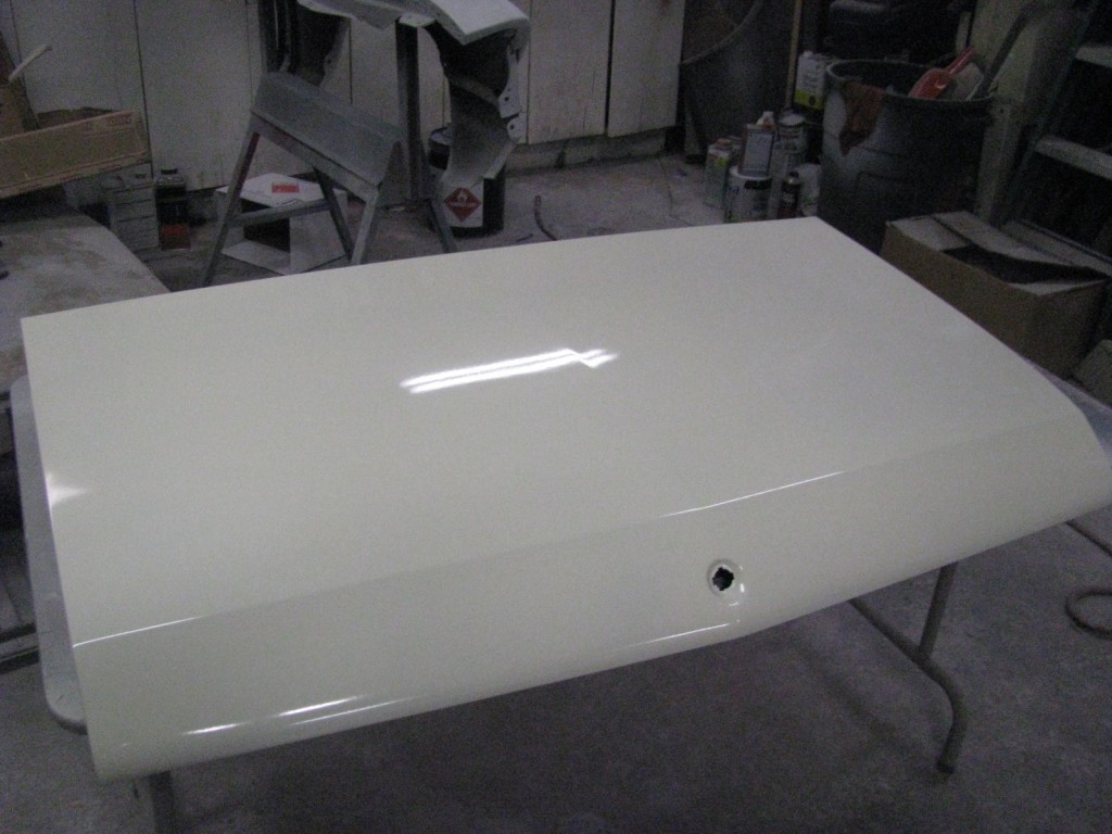

Busy weekend. The body is blocked again and again. I reshot the 2K this morming. Sanded the Ecoat off the new trunk lid and header panel Saturday. Made some adjustment to the header panel with the grinder and Unibit so it fits right. Put the lid and header in Epoxy Saturday and 2K today.
Dash is sanded and primered.
Body is back on the mockup frame and most of the panels are aligned but still need to do a bit more adjusting.

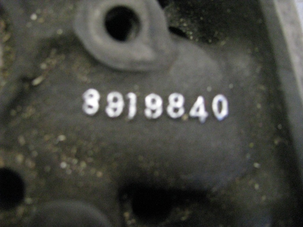

Worked on the 502 engine today. Finished the clearencing and checked the zero deck. Will be flow benching the heads maybe later this week and checking the cc's.

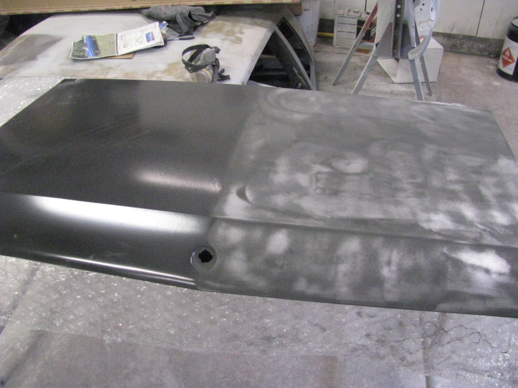

Another round of block and prime completed today.

I got a few OEM parts for it today as well. My car was built in the last week of January 1969 so the parts I got should be period and sequence correct I think.
also has a 7115 crank, 3870325 balancer and original oil pan.

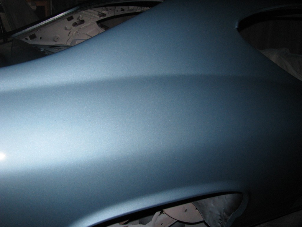

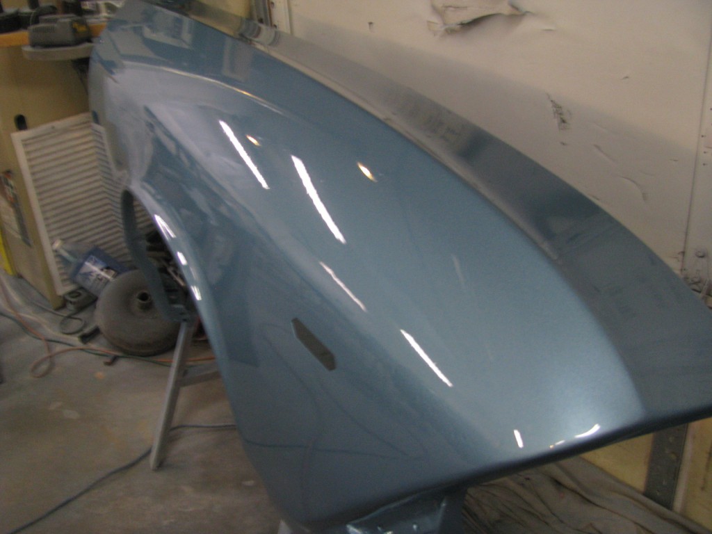

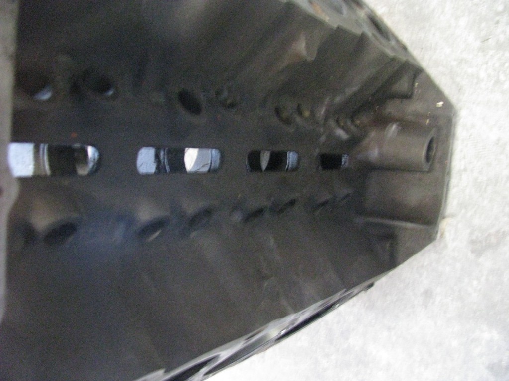

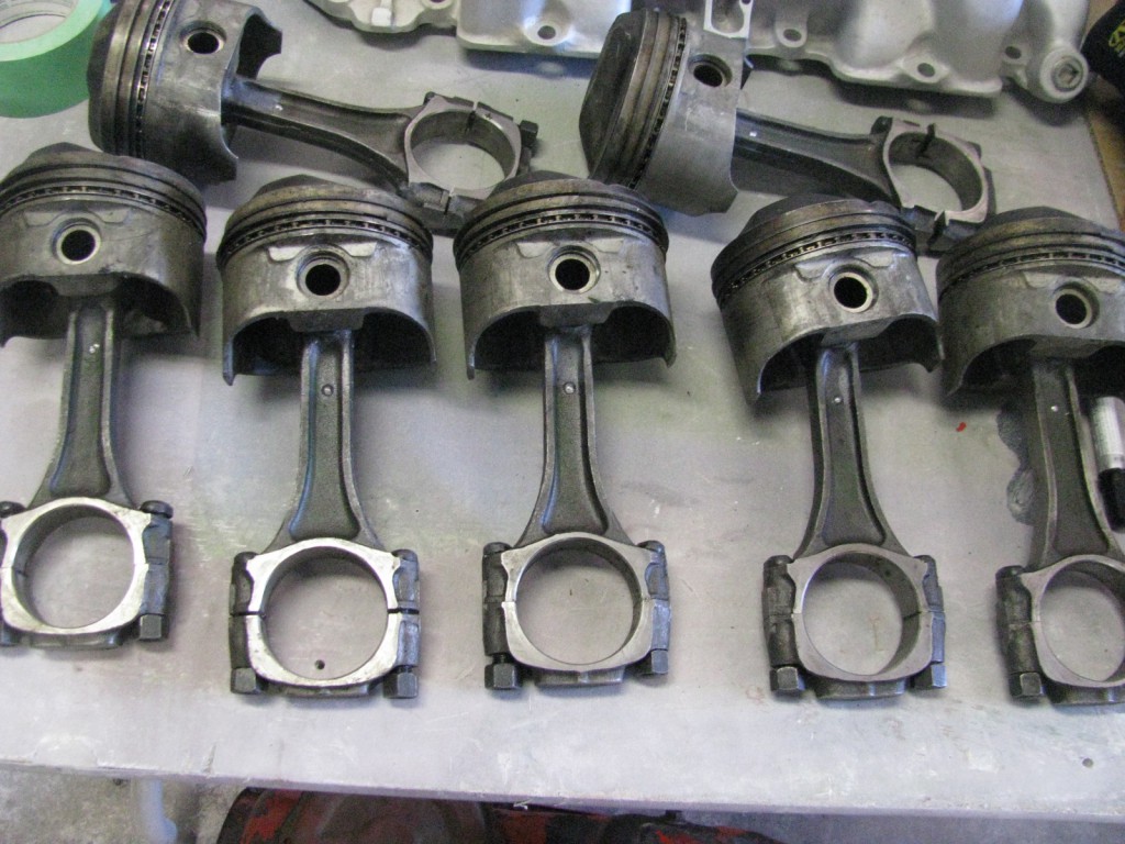

Shot a coat of epoxy sealer the other day, blocked it and then put on some Azure Turquoise and 3 coats of clear. We'll be sanding it with 600 and putting 2 or 3 more coats of clear on in a couple of days.

Thanks guys. To be completely honest with you I had no intention on painting it Azure Turquoise. After reading posts from 4 or 5 of you NCC guys I started really thinking about it. The color grew on me like mold. I am really happy with the color. The more I look at it the more I like it. It would have been black, red or orange if it wasn't for this site and the people on it.
Thanks to all of you who make this site and club happen. And to my Old buddy Rick for getting me to join
I can't wait until I take it out in the sun tomorrow. It is full of small metallic flakes.
