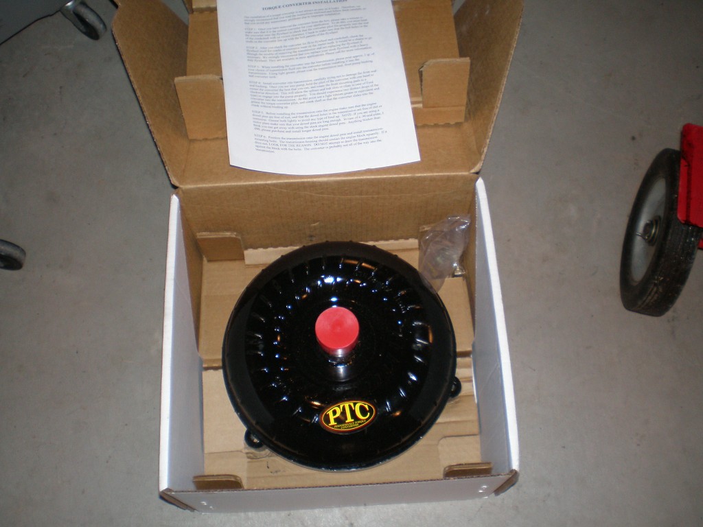

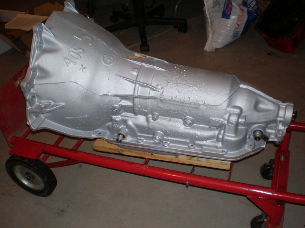

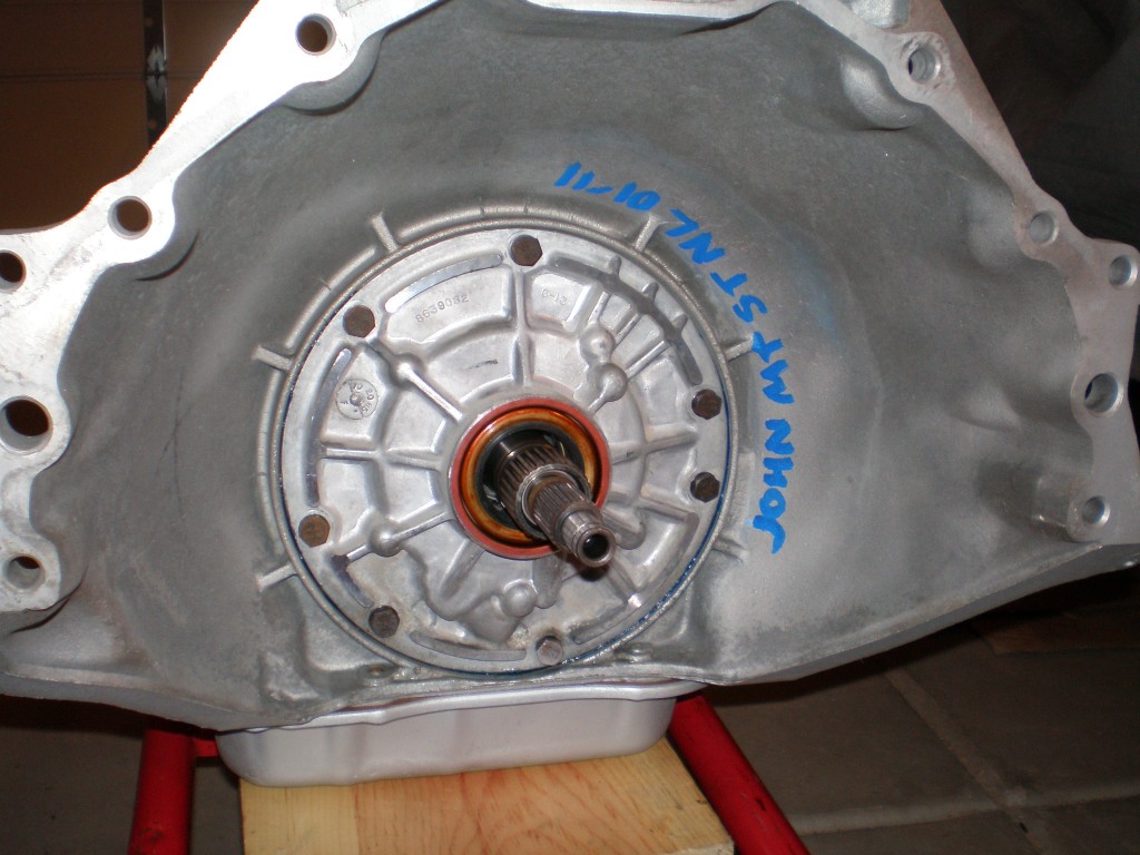

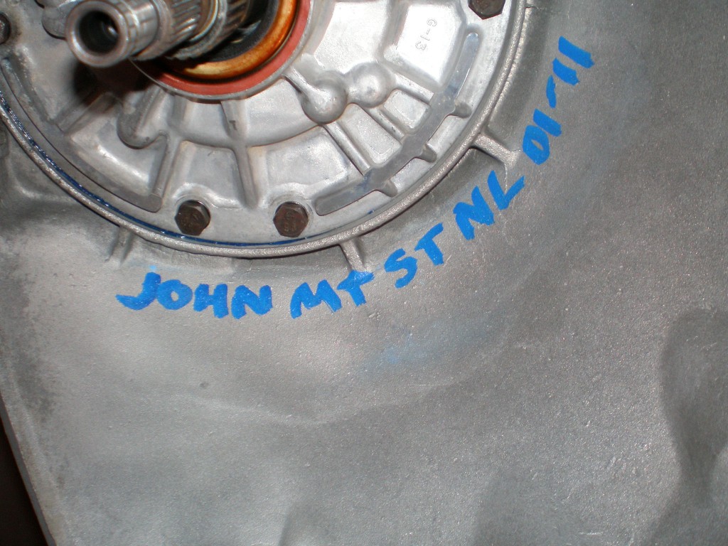

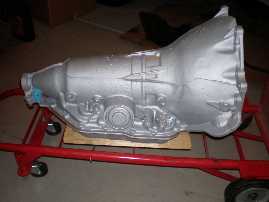

John from Master Trans called today and the 200-4R is done other than he ordered the 2400 rpm stall convertor from Bowtie Overdrives today!
Will pick it up next week.
Now I got to get moving cleaning up the engine, engine bay, etc. and getting ready for reassembly!!!

Picked up the 200-4R trans and torque converter from Master Trans tonight!!!
Here's a few of the things that were installed:
-Heat treated input drum (needed to strengthen it up to 500 hp) -Shift kit -Roller sprag low clutch -Valve kit 700-R4
The torque converter is an 11" 2400 rpm Performance Torque Converter non-lockup type.
John set it up as a non-lockup so there aren't any electronics required. Just hook up the TV cable, coolant lines, and it's ready to go. He even autographed it (see inside of housing).
He told me this should be a really nice setup with the 4.11 gears and the big block. He asked that I bring it by so when it's finished so that he can check it out and make sure everything is to my liking. I made the right decision going with him rather than having one shipped from across the country and dealing with that if there are any problems. If there are, he's 2 min. from my house!
I tried the yoke end from the driveshaft I got from Steve S., and it fits! All I need to do is swap the diff end u-joint from the old driveshaft to the TH350 shaft and it should be finished.
Now I have to get on the rest of the engine cleanup and painting so that I can start putting things together when the heads are done.
