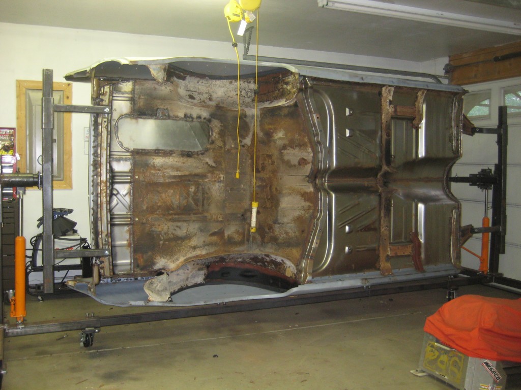

bwild70ss396 said
Oct 30, 2010
I forgot to add a quick pic of body on rotisserie. I went and got it last weekend.
